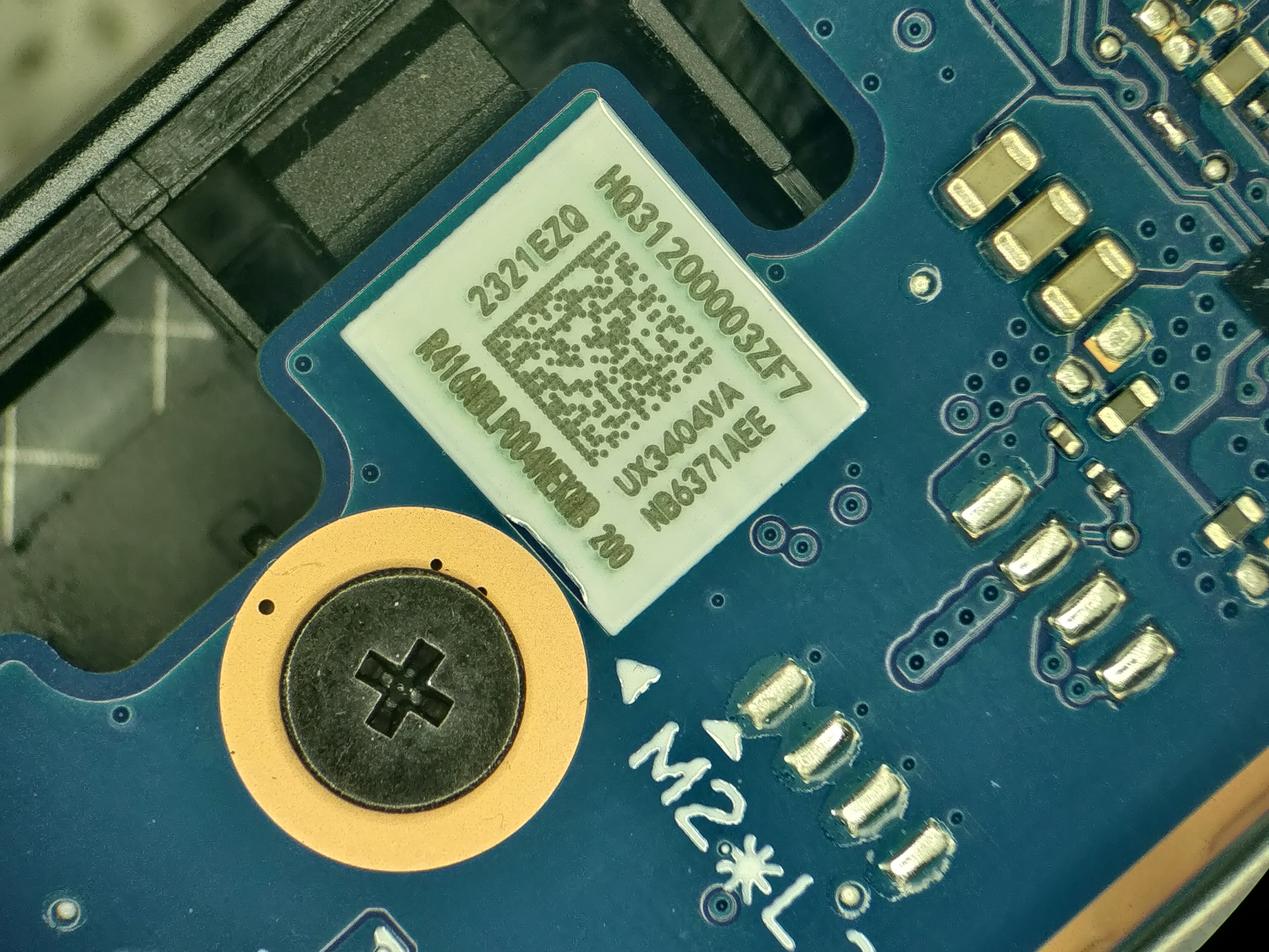

    Hello everyone! I am not looking for a ready-made solution, but I am looking for advice and help to understand the principles. We have a problem: UEFI password. We have a dump from the SPI BIOS (version .204) and an update file from the official website of the same version. In the BIOS region of the original dump, there are two NVRAM areas at the beginning that contain DMI and certificates (and most likely a password). In the BIOS region of the update file, the NVRAM area is only one. By what principle is a ready BIOS region formed from such an update file? When manually deleting the scripts in the HEX editor, I get a shift of 64 bytes to 00D376B0. I tried to use the BIOSUtilities scripts, but unfortunately nothing works, only errors appear in the console.

    Post the laptop serial number and your attachments again please, there`s a problem with your files, can`t download them.

      SN: R4N0LP03999317A

        Originally posted by Wolfrahm
        SN: R4N0LP03999317A
        Admin Password : Toxa1989L
          Thank you Legend! But this is a ready-made solution... I will not ask how the password is decrypted from the dump, but I have questions about how to asseble the BIOS region from such an update file? Since this is the first time I am dealing with the update on Raptor Lake and the file structure is not typical for me.
            This is the bios region I have cut out the extra parts, I'm not good at English so I can't explain more clearly. You can see it with UEFITool.
