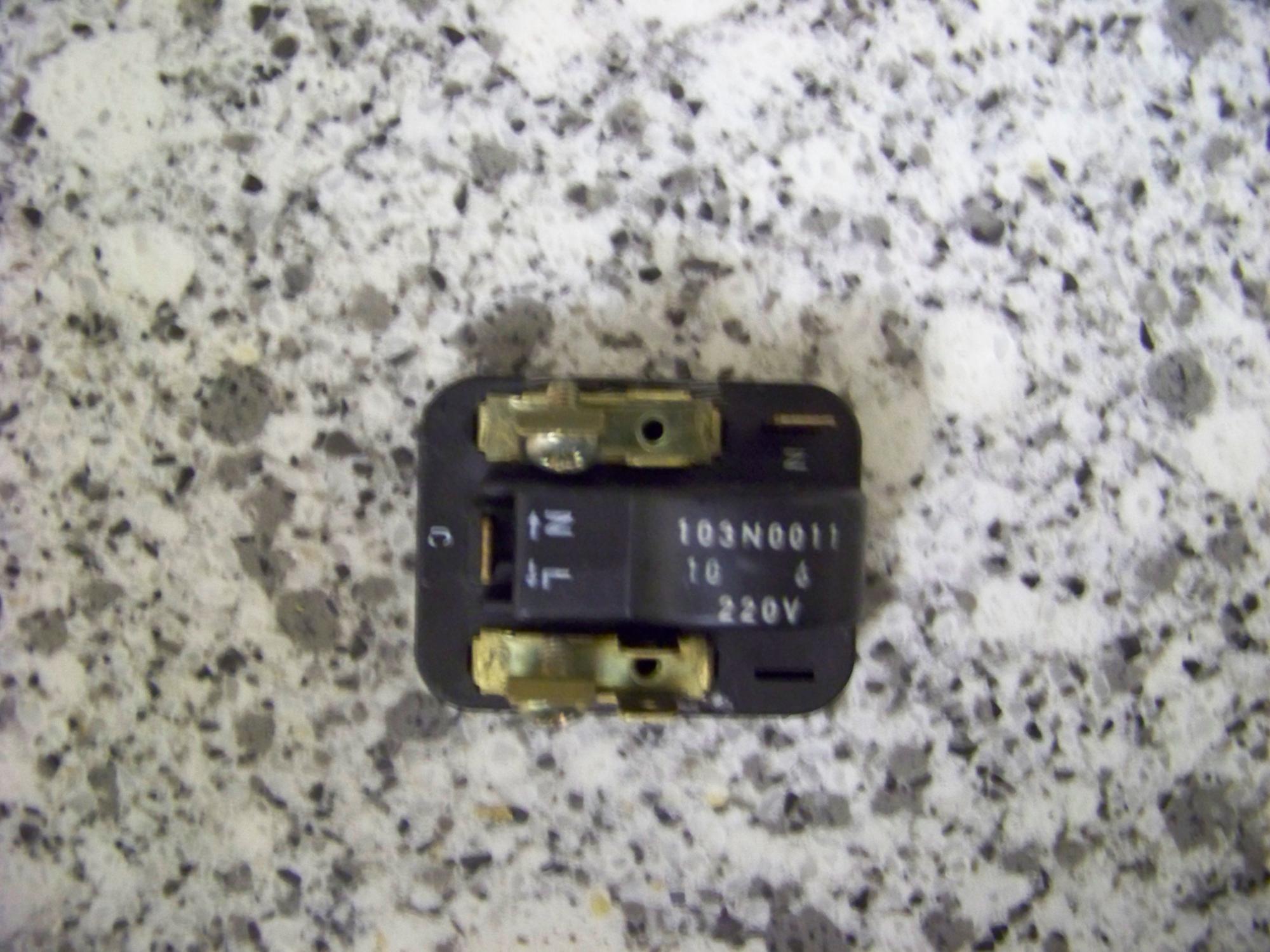

    Hi - One of my current projects is to get a freezer working. I semi understand the basics. Repair seems to be by full replacement of faulty items ie thermostat, compressor, door!.

    I believe the one I have is electronic so most of the above doesnt apply.
    I have also looked up "how to test a relay" which brings up various ways of testing the electronmechanical type but says the "electronic" one can only be tested by an expert.

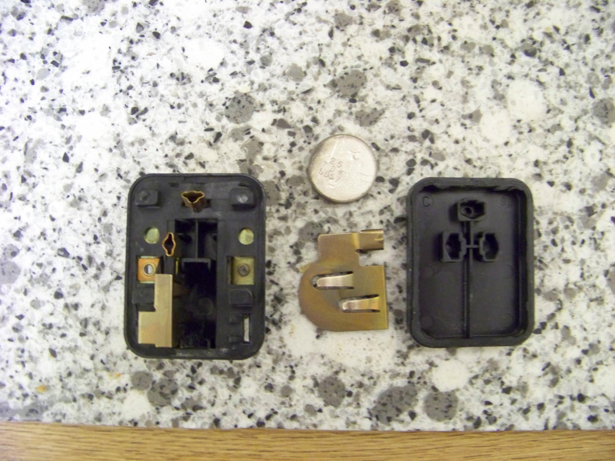

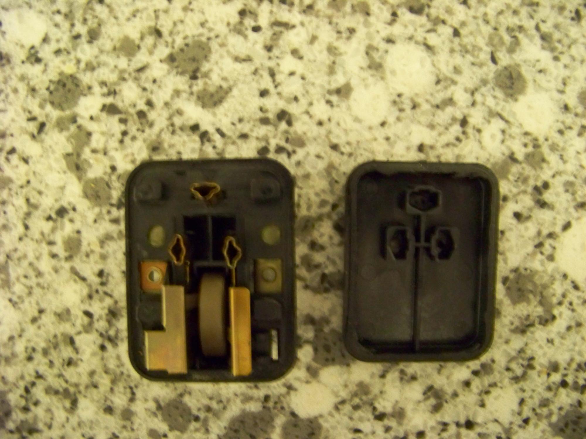

    They are not expensive to replace - probably cheaper than asking an expert to test it but being of an inquisitive nature and willing to have a bash at mending most things decided to take it to bits. I expected to find an array of small electronic components but it just seems to have two contacts with a disk of some sort between them - almost zero resistance according to my
    cheap vom. there is no internal connection to the common connector. I'd have thought +220vac to one side of a metallic disc and -220vac to the other would equal a big bang? I will have to investigate further where the common wire comes from- dont seem many wiring diagrams or schematics available on line. Might try the reference library.
    I attach photos of the relay and perhaps someone can tell me if it looks like it should work or if it looks broken. The disk may have a pale coating on it but has rubbed off where the contacts touch it.

    That disk looks like a ceramic capacitor.
    The actual electronics are probably embedded inside the body in plastic (potted).
      Re: Freezer Relay - how does it work
      That's a PTC thermistor. It give the start winding a kick, then as it warms up, current through start tapers off. Hopefully, the compressor is up to speed by then. Because of this, they are useless for 'hard-starting' or dealing with rapid cycling, such as when the power goes off and comes back on.

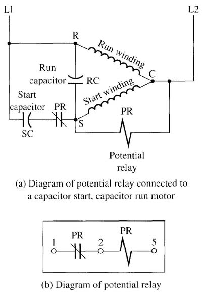

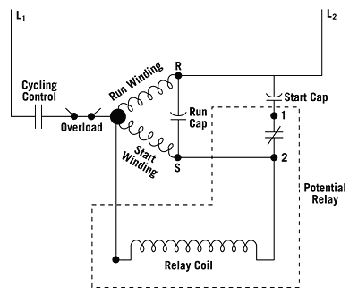

      A much better solution is a potential relay and start cap. AKA SuperBoost.
      In between the two is a relay coil that's in series with the run winding, and carries the run (and LRA) current. This relay has a normally open contact. When there's a call for cooling, the stat applies power to the compressor (and fans). LRA passes through the coil. The contacts close, putting the start winding and cap in. The compressor gets up to speed, the current through the run winding (and current-relay coil) drops. Once it drops low enough, the start contacts open. The starting means is removed. Run current won't quite be up to RLA, since head pressure hasn't yet developed. The diagram shows both the run and start windings going through the coil.
      -Paul

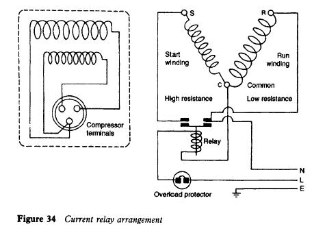

              Thanks for the info and the schematics Paul. If I understand the discussion, the PTC device may be a source of trouble with this setup? A common repair for all capacitor start/run HVAC motors is a bad capacitor. Just test it with your multimeter - ESR is of no concern. The description of the relay is a bit confusing, or perhaps it was misidentified? FYI, the neutral is not supposed to have any type of fuse or breaker - this line goes directly to the panel. As you see in the schematic, the breaker is correctly placed in the hot side marked "L".
