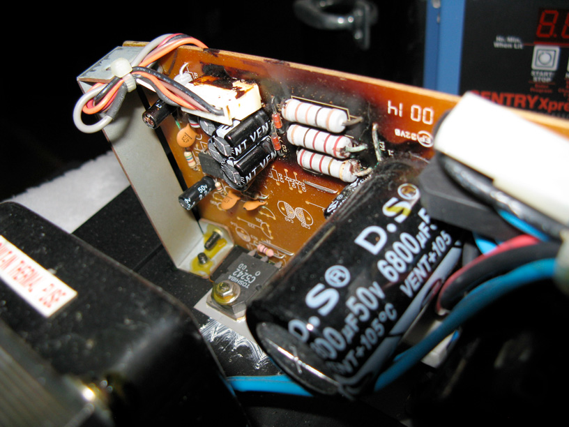

    The two big caps on this subwoofer plate amplifier leaked. I'm going to replace them, but I was advised to clean the electrolyte off first.
    Some of it's kind of flakey, but most of it is baked on. Rubbing alcohol seemed to have no effect on it. Is there any solution that can help remove it?

    That could be some lacquer from the board that is burnt also.
    A stiff toothbrush and elbow grease along with 91% isopropyl alcohol.
    Any stronger solvent and you risk removing the lettering from the board and damaging the other caps bungs. There are some flux removers out there that would work that have a tetrachloroethylene isopropyl alcohol. (Puretronics brand)
    Also, make a baking soda and water paste and scrub with the brush to deactivate the green corrosion around those component legs. Then flush it all with alcohol and allow to dry or use a hair dryer to speed the drying.

        I'd recap the whole bloody thing too.
        Looks like a linear supply with that big transformer, so caps don't -have to be- low ESR. But it wouldn't hurt either...

            Scrubbing Bubbles shower cleaner. Uses quaternary ammonium compound. Takes ionic compounds right off since the active ingredient acts as a phase transfer catalyst. Its very mild pH wise and rinses clean with no residue. I've used it on everything from PSU's to motherboards with great results, strips off all organic matter, even cig smoke residue like its nothing.

                I use CRC green-can brake cleaner to clean boards. Dries very fast, flammable (Acetone, Toluene, Methanol). Removes flux like crazy, I use it to deflux every board. Just be careful around plastics - will melt or deform plastic. I usually spray some on a cotton swab and clean the board with the swab.

                  >>I use CRC green-can brake cleaner to clean boards. Dries very fast, flammable (Acetone, Toluene, Methanol).<<
                  That will eat capacitor bungs like crazy too.
