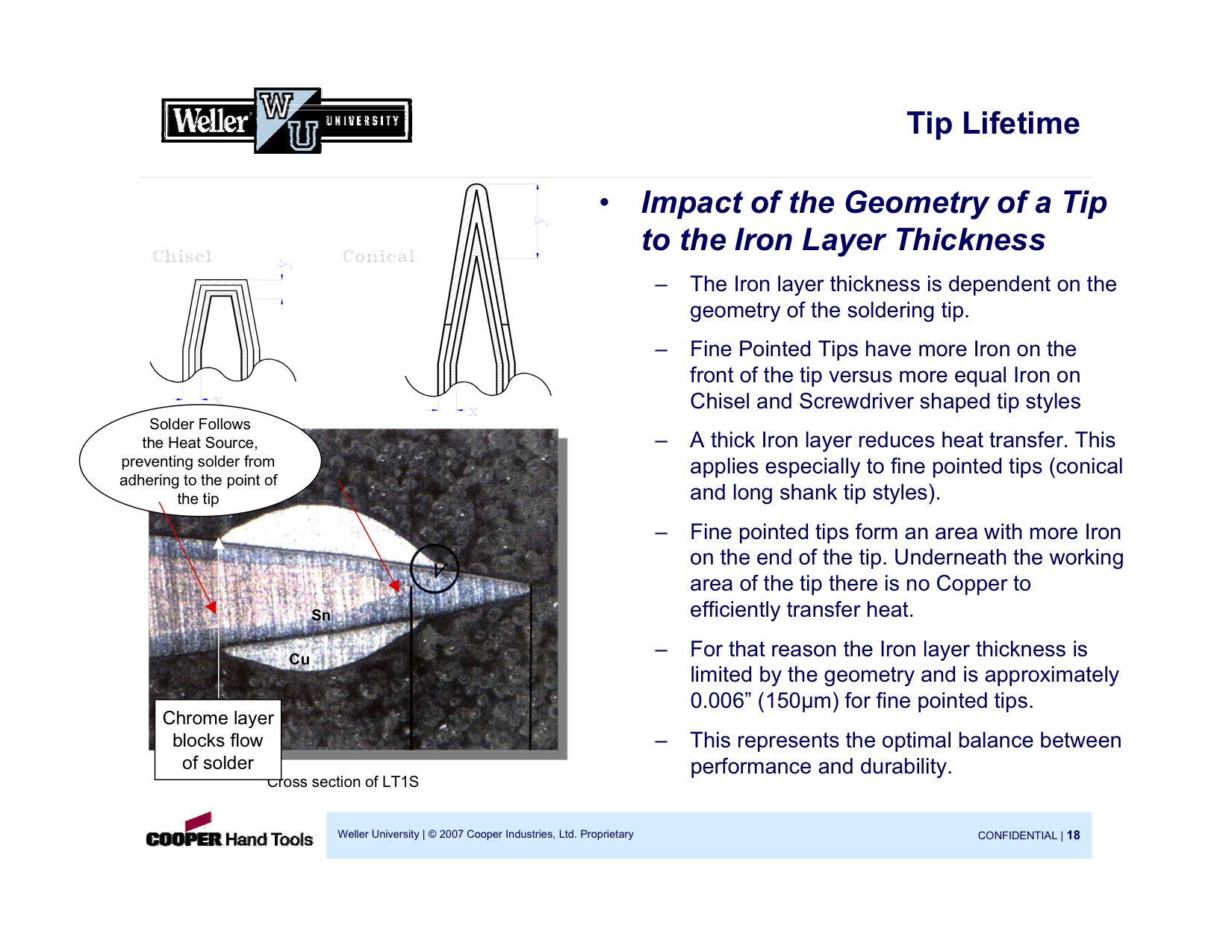

                                    My only problem with this station is the tip. Solder seems to ball up at the top of the tinned area, instead of at end where you need it.

                                      ^ That's usually a sign that it's time to clean the tip.

                                        Pardon me, balling was the wrong word to use. The tip is perfectly clean. The solder is just being attracted to the hottest part of the tip-- the copper core-- which is thicker further away from the tip. Good for tip life, not so good for wettability. It's not bad at 350degC but it gets worse if you have to turn the heat up.
