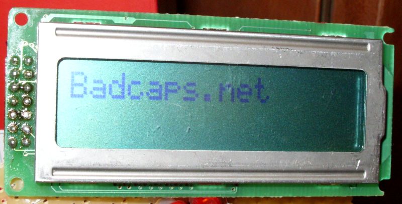

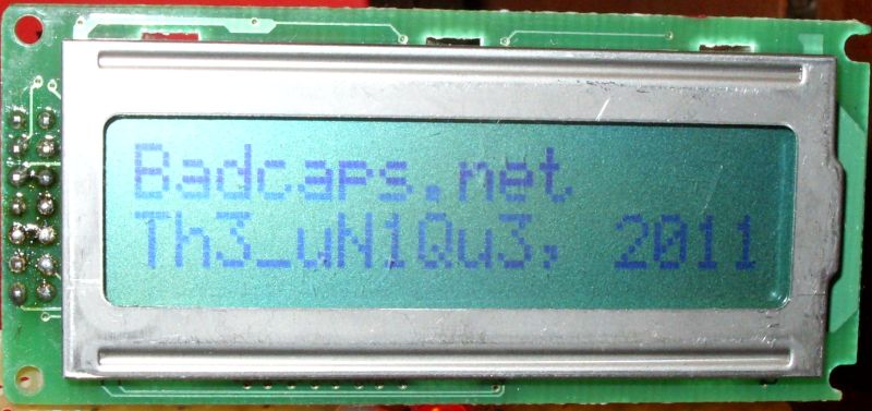

                    I'm back on it... I have switched to a larger PIC btw, a 16LF876A. More outputs, more ADC channels, a built-in PWM module... neat. That's old news though - i bought that PIC like a month ago - but i think i posted about it in another thread not in this one.
                    I've written my own LCD routine out of bits and pieces i found on the internet (since none of the ones i found actually worked by themselves), but i hadn't figured out how to deal with strings, and sending data letter by letter (and in ASCII codes at that), quickly got annoying.
                    That is, until now. Looky what i've accomplished.
