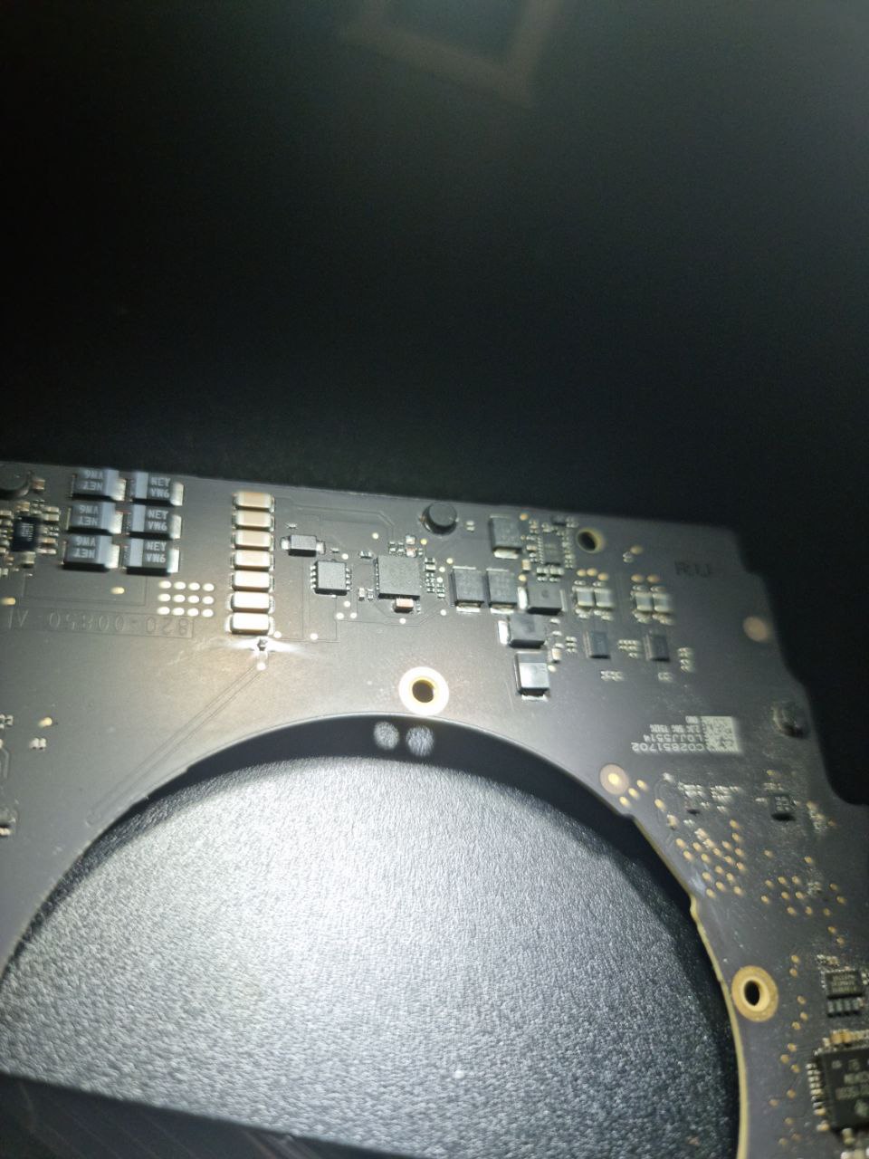

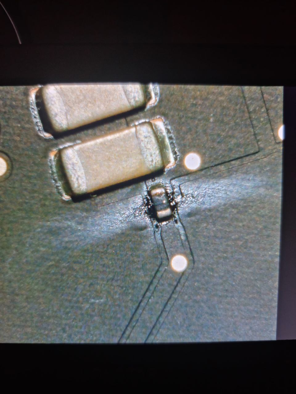

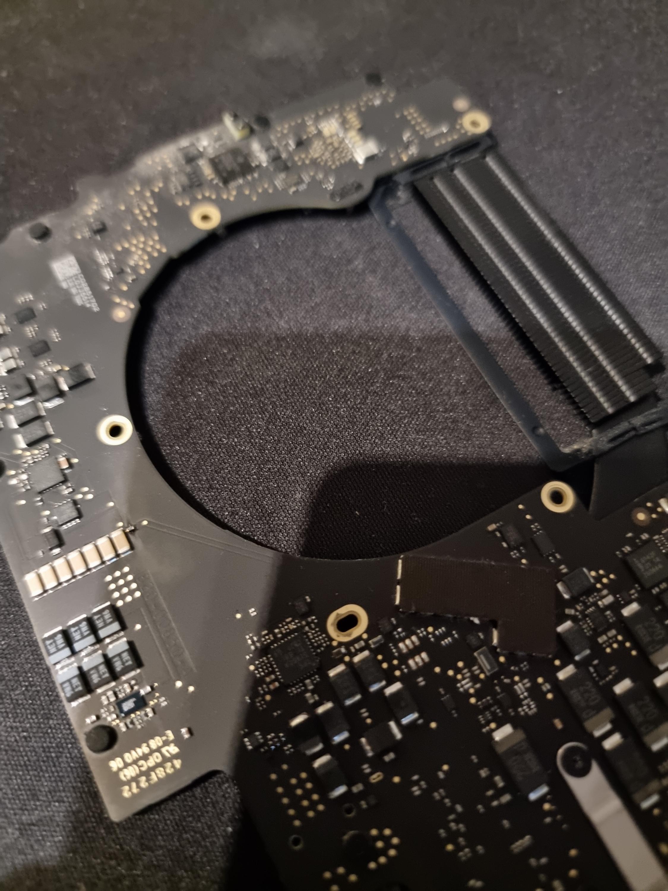

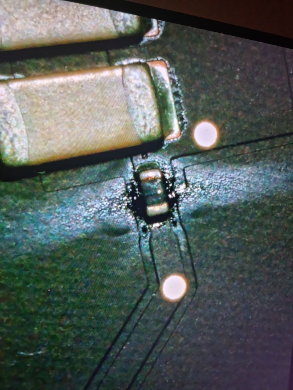

macbook pro a1989 macbook started But no screen on extern or intern display.
  • SaYHell0
    • Jun 2023
    • 9

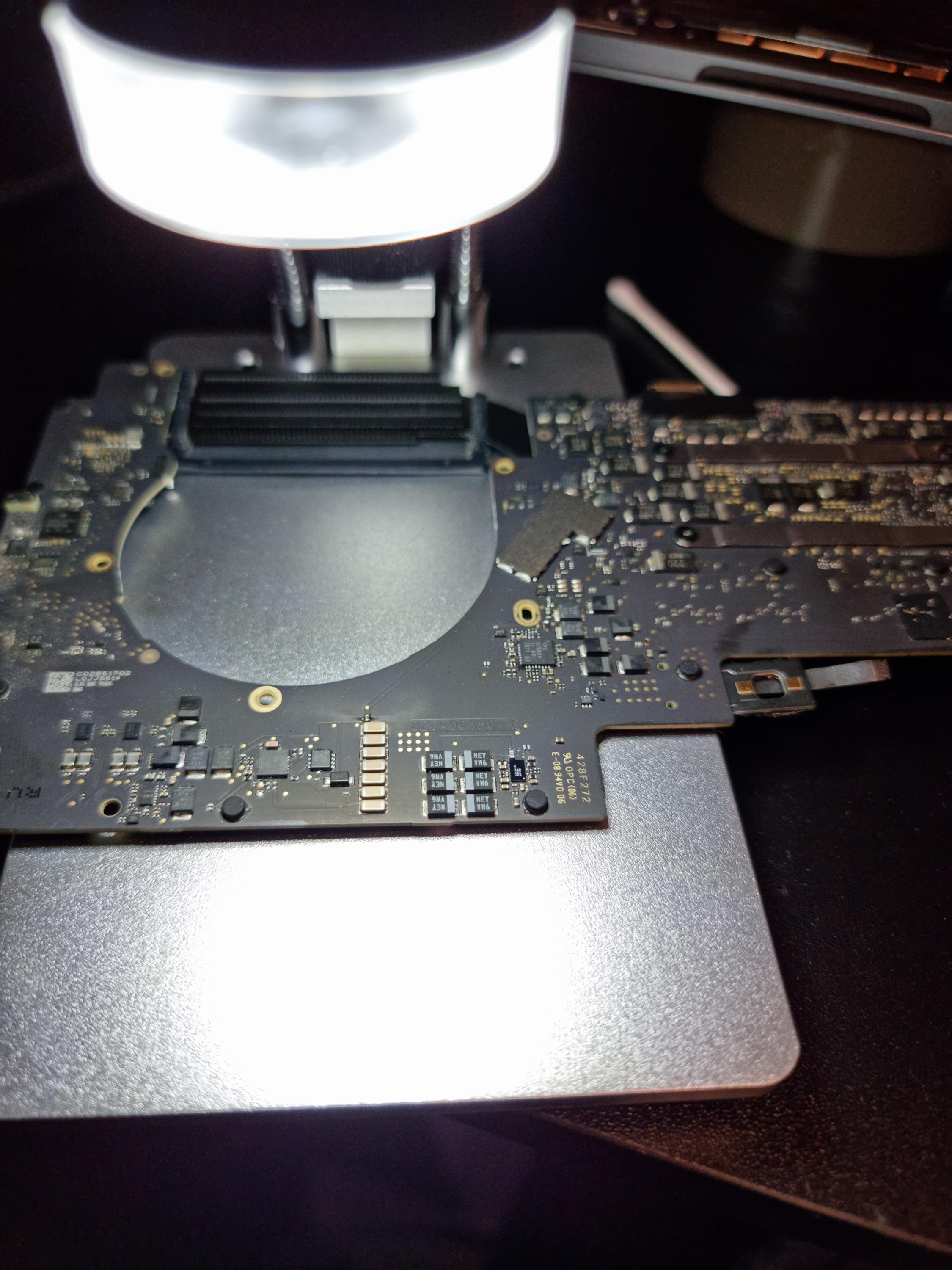

    Hello i guess i have another logic board as the usual a1989?
    Iam new into smd fixing but i want to learn That because that makes so much fun
    I guess i Found my Problem?
    Problem was: macbook started But no screen on extern or intern display.
    Cpu/gpu was very Hot after trying a few commands with reboot

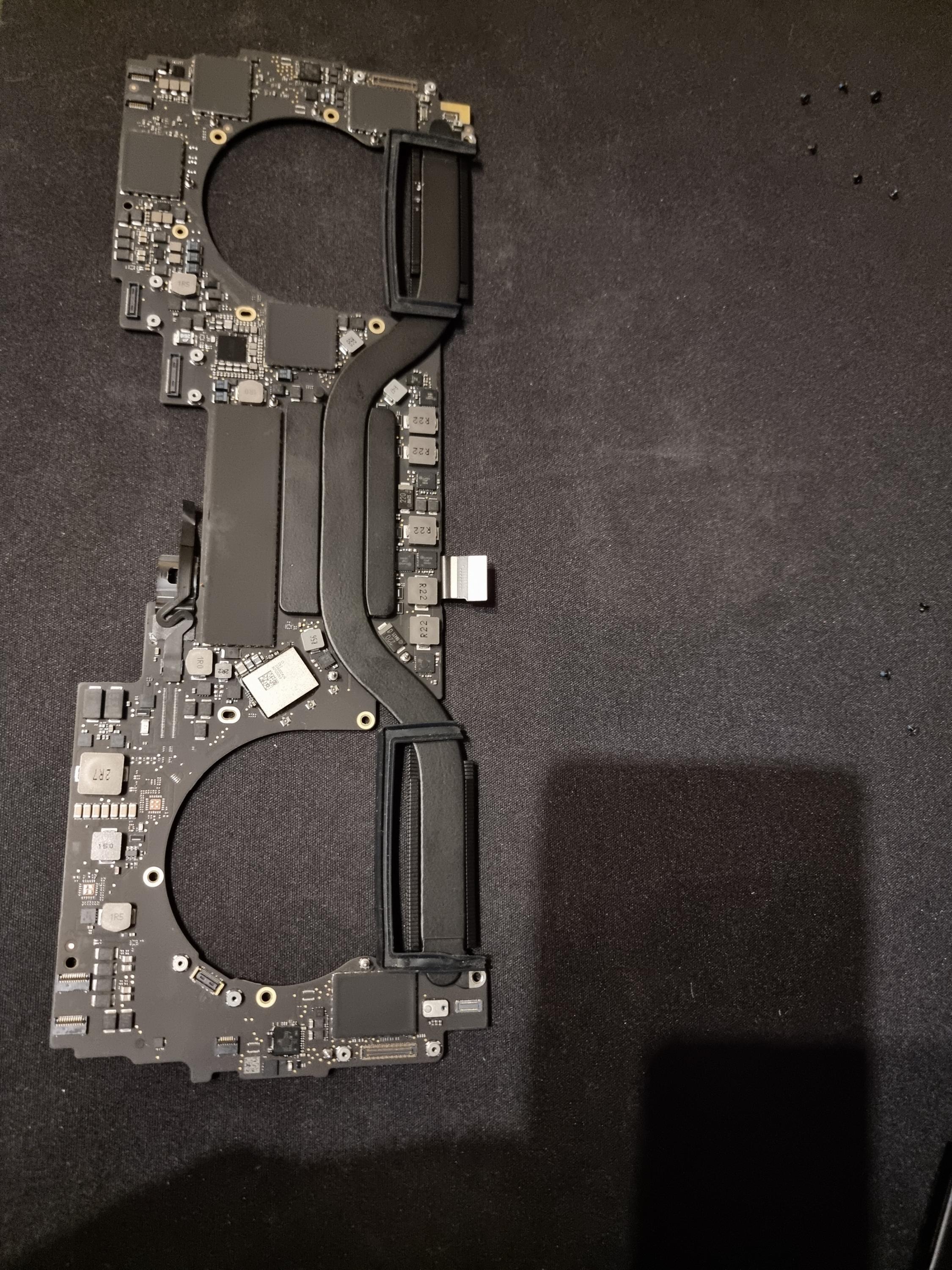

    Re: macbook pro a1989 macbook started But no screen on extern or intern display.

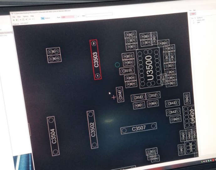

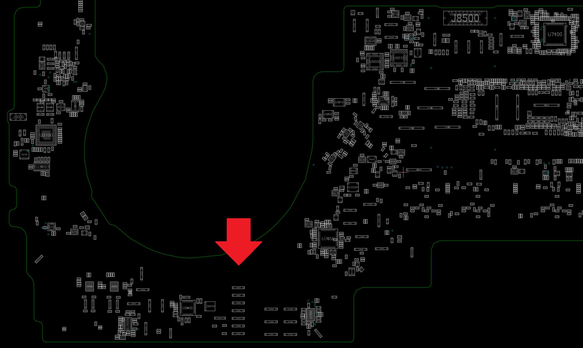

    i could not find any brd file for my logic board...
    after replacing the thermal paste of the cpu and gpu the macbook starts with full rpm of both fans...
    Anyone any clues?
      • 21960
      Schematc & Boardview -> https://www.badcaps.net/forum/showthread.php?t=76497

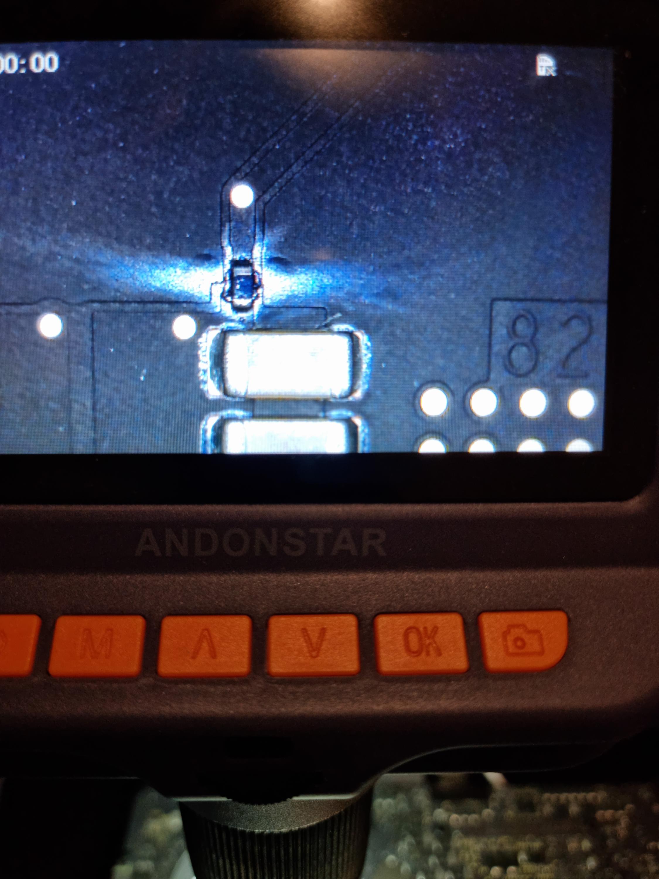

        Edit: On Windows i can see everything
        Thank you!
        The "burned" part on my logic board is missing on the schematic... Could that be from the U5710?
                Each logic board from Apple / Foxconn has a 820-**** part number etched onto the PCB itself. Using this as a guide, you may be able to locate the schematic on this forum.
                For example, A1989 = 820-00850 and the schematic is posted here in post # 33:
                https://www.badcaps.net/forum/showth...0-00850&page=2
