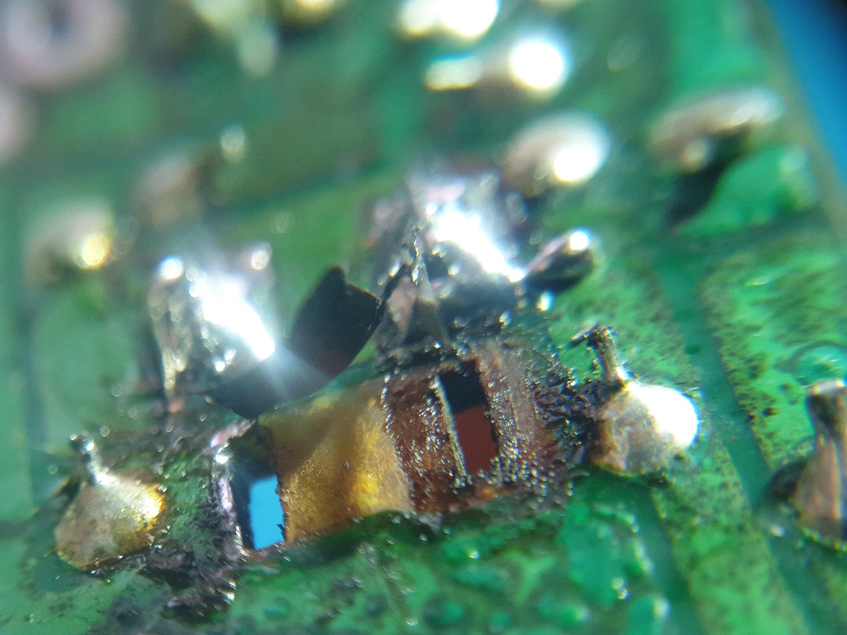

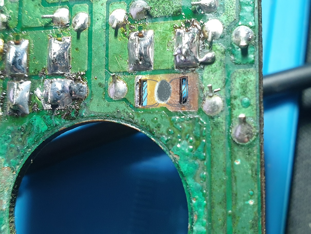

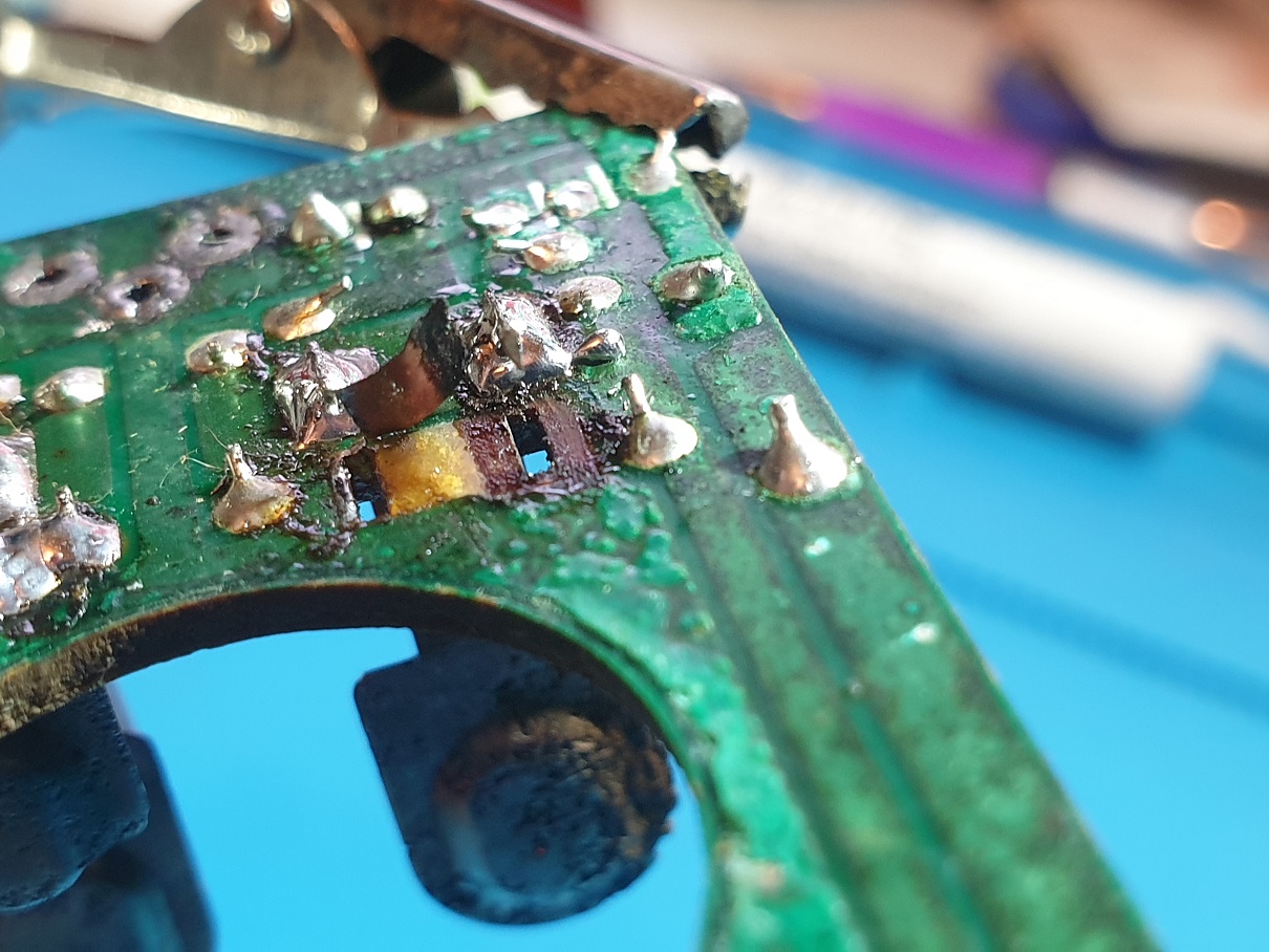

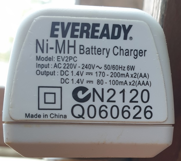

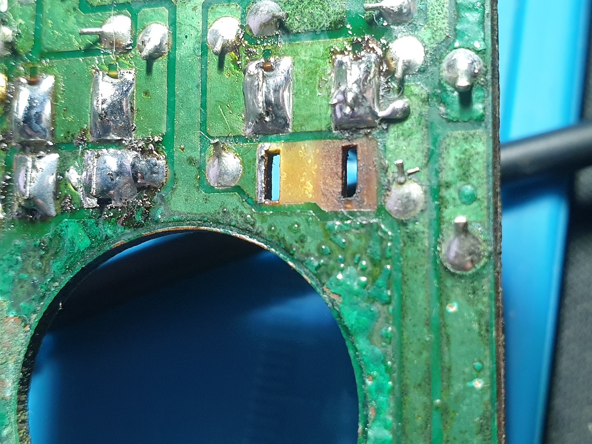

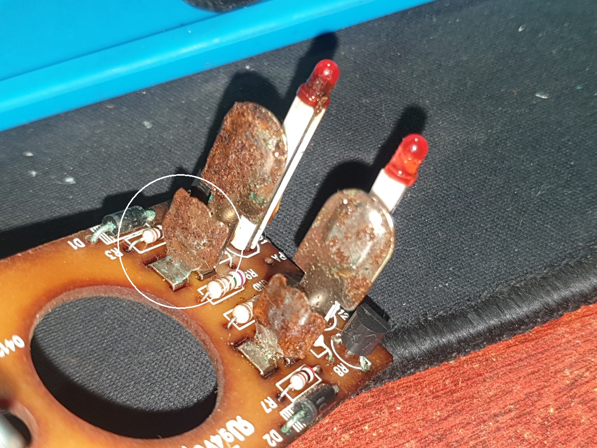

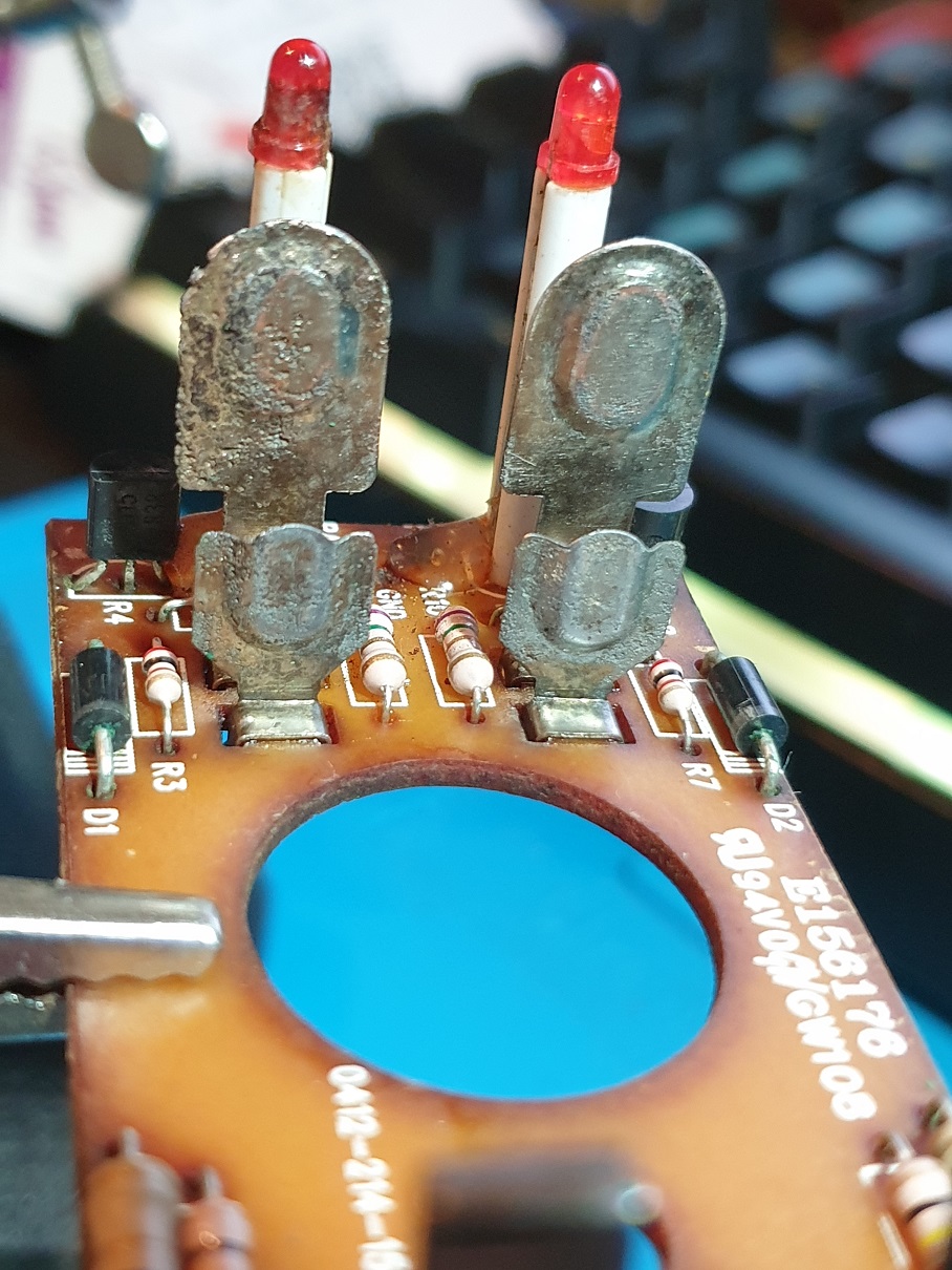

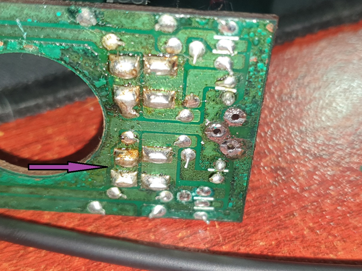

Lifted trace, how to glue back down?
  • Widget
    • Aug 2015
    • 74
    Lifted trace, how to glue back down?
    I have a PCB and one of the tracks lifted. I tried using superglue but no good, didn't stick.
    What have you had success with at gluing down traces/tracks ?
  • petehall347
    • Jan 2015
    • 4448
    • United Kingdom
    Re: Lifted trace, how to glue back down?
    clean it first ..i have used superglue no problem
    • SluggerB
      • Aug 2020
      • 747
      • US
      Re: Lifted trace, how to glue back down?
      I usually replace the trace/pad with a small piece of copper tape that is a little larger than the original trace/pad, then apply conformal coating around the edge of it to bond it to the board.
      I've had bad luck with Superglue, I can get it to stick but when I try and solder to whatever I glued down it usually comes back off again. But that's probably me just doing it wrong
      • diif
        • Feb 2014
        • 6978
        • England
        Re: Lifted trace, how to glue back down?
        Superglue is broken by heat, not sure why that is being suggested.
        Get rid of the ripped trace and replace it with copper wire.
        SluggerB conformal coating is a coating not an adhesive.
        • mentholflash
          • Mar 2013
          • 36
          • Western Australia
          Re: Lifted trace, how to glue back down?
          It is Heatproof epoxy i think. I was told to mix ceramic dust and normal epoxy together and form it yourself but i didnt think this would work
          https://www.circuitrework.com/guides/4-7-2.html
          https://www.intertronics.co.uk/produ...nd-repair-kit/
          https://www.ebay.com.au/itm/35491563...iABEgInR_D_BwE
          • harp
            • Jun 2022
            • 647
            • Planet Earth
            Re: Lifted trace, how to glue back down?
            Originally posted by Widget
            I have a PCB and one of the tracks lifted. I tried using superglue but no good, didn't stick.
            What have you had success with at gluing down traces/tracks ?
            On one layer pcb board usually is used very weak glue to hold traces... must be careful in future.
            In this case, there is no point to use glue to hold track, just place track on board, put back legs of element to solder again, and wrap legs over track with thin copper wire few times. All that soak with solder tin to confirm it to one solid piece with track.
            Superglue is cyanacril, and dissolve to hazard vapour when heating, protect lunge and eye when working with it.
            • CapLeaker
              Leaking Member
              • Dec 2014
              • 8350
              Re: Lifted trace, how to glue back down?
              I use UV cure resin for just about anything that needs to be glued to a PCB.
                • 31277
                Re: Lifted trace, how to glue back down?
                superglue/cyanocrylate is something that should never be used in electronics or anything that has a translucent area/window.
                it will give off vapor that ruins windows in things.
                wd40 is another thing that should be kept in a seperate building from electronics too.
                • Widget
                  • Aug 2015
                  • 74
                  Re: Lifted trace, how to glue back down?
                  Thanks everyone for the feedback.
                  I bumped the pad and it broke off (see attached image) , so I'll have to try a method of replacing the pad as others suggested.
                  Hole-to-hole is 4mm, I'm not sure how to properly secure the battery contact. If I use a pad that isn't secured to the board, the contact is going to be loose and possibly pull at the new joint?
                  • diif
                    • Feb 2014
                    • 6978
                    • England
                    Re: Lifted trace, how to glue back down?
                    Forget trying to replace the pad, use copper wire instead.
                      • Jul 2011
                      • 6070
                      Re: Lifted trace, how to glue back down?
                      Originally posted by diif
                      Forget trying to replace the pad, use copper wire instead.
                      I second this second this suggestion for repairing this board soldering joints to each other or if desoldering braid would also work as well and maybe even easier to use because it would lay flat if you used a couple of pieces next to each other for surface area contact
                      You really need to clean those metal pieces that contact the batttery as well
                      • Widget
                        • Aug 2015
                        • 74
                        Re: Lifted trace, how to glue back down?
                        Originally posted by diif
                        Forget trying to replace the pad, use copper wire instead.
                        Originally posted by sam_sam_sam
                        I second this suggestion for repairing this board soldering joints to each other or if desoldering braid would also work as well and maybe even easier to use because it would lay flat if you used a couple of pieces next to each other for surface area contact
                        I understand soldering the legs together and to the track, but the contact itself would be wobbly. I could pickup some of that UV cure green PCB stuff, or even hot blue & glue down the contact itself from both sides & using a piece of wire, though I'm not sure how secure the contact would be.
                        So, besides trying some hi-heat resistant epoxy, there's no way of securing a new pad / copper tape to the board itself (that's soldering iron heat resistant)?
                        You really need to clean those metal pieces that contact the batttery as well
                        Already done. It's not perfect but heaps better than the images above.
                        • R_J
                          • Jun 2012
                          • 9621
                          Re: Lifted trace, how to glue back down?
                          Install the connector through the pc board holes then bent the tabs inward to secure it to the pc board, then just solder the tabs together for more support, then solder a wire from the connector to the broken trace
                          Last edited by R_J; 07-29-2023, 12:00 PM.
                          • Widget
                            • Aug 2015
                            • 74
                            Re: Lifted trace, how to glue back down?
                            Thanks guys. I ended up just sticking the contact in and putting a blog of solder onto each leg & bridging to the resistor. The contacts I cleaned up, pretty beaten up but working.
                            One thing I noticed, the sticker on the bottom says DC output 1.4v but when I plug in the charger and probe the positive and negative contacts, the left contacts read 1.5v +/- and the right contact 2.3v +/- with voltages fluctuating a bit. I don't know much about chargers, I know they charge batteries at a slightly higher voltage than the batteries output, but does it sound like there's an issue there or is it just me?
                              • 31277
                              Re: Lifted trace, how to glue back down?
                              the numbers mean nothing, it's a piece of junk that regulates the current and voltage with a resistor!
                              it relies on the presence of a discharged battery for those figures.
                                Lift Master Garage Door wall switch display / motion sensor controller display disappeared no back light
                                by sam_sam_sam
                                This happened last Saturday and today I finally had time this morning before I went to work to replace two non brand capacitors
                                I will let you be the judge weather or not these are bad or not according to the blue ESR meter that I am using
                                I am comparing them to a brand new one that I installed
                                The display came back on and the programming was not lost which I was surprised by I would have thought that when the display went blank that so did the memory as well
                                I going to let it run for several days before I remount back on the wall next to the...
                                09-05-2024, 06:48 PM
                              • mrdevil
                                Crest Smart Home Single Power Adaptor SHSPM1 (rebadged Tuya device) - bad cap causing failure, how to repair
                                by mrdevil
                                Wanted to share this as I couldn't find anything on the internet about this problem, so pulled one apart and found the problem myself. Years ago I bought approx 20 or so Crest Smart Home Single Power Adapter smart switches - small 240v Tuya-compatible (rebranded) smart switch devices with power monitoring, which Big W had on sale for half price. Paid $7.50 each for these, and they've been incredibly useful for turning things on and off remotely... and monitoring how much power each device uses.
                                However, after about 12 months, I had a number of these stop working...
                                01-08-2025, 03:19 AM
                              • acedogblast
                                by acedogblast
                                11-02-2024, 05:13 PM
                              • chth96
                                Is it possible bridging tiny broken trace
                                by chth96
                                When I assembled dreamcast I mistakenly fastened long bolt and It resulted in
                                cutting tiny trace.
                                This tiny trace(Total width of white coating is 5.5mm) is between R337,R343 and IC101 and it is covered with white coating in the below screenshot.
                                Firstly I tried to bridging tiny broken trace with my own eyes...But it is totally impossible..So a week ago, I ordered G1200 Digital Microscope and I magnified this tiny broken trace with it.
                                But It seems that It is really very tiny trace So I plan to order 0.1mm coper wire from aliexpress in order to bridging...
                                12-03-2022, 11:32 PM
                                HP ProDesk 600 G5 + APC Back-UPS 700VA ProDesk 600 i7-9700 Specification for Upgrade or Repair
                                This specification for the HP ProDesk 600 G5 + APC Back-UPS 700VA can be useful for upgrading or repairing a desktop PC that is not working. As a community we are working through our specifications to add valuable data like the ProDesk 600 G5 + APC Back-UPS 700VA boardview and ProDesk 600 G5 + APC Back-UPS 700VA schematic. Our users have donated over 1 million documents which are being added to the site. This page will be updated soon with additional information. Alternatively you can request additional help from our users directly on the relevant badcaps forum. Please note that we offer no warranties...
                                09-12-2024, 02:30 PM
