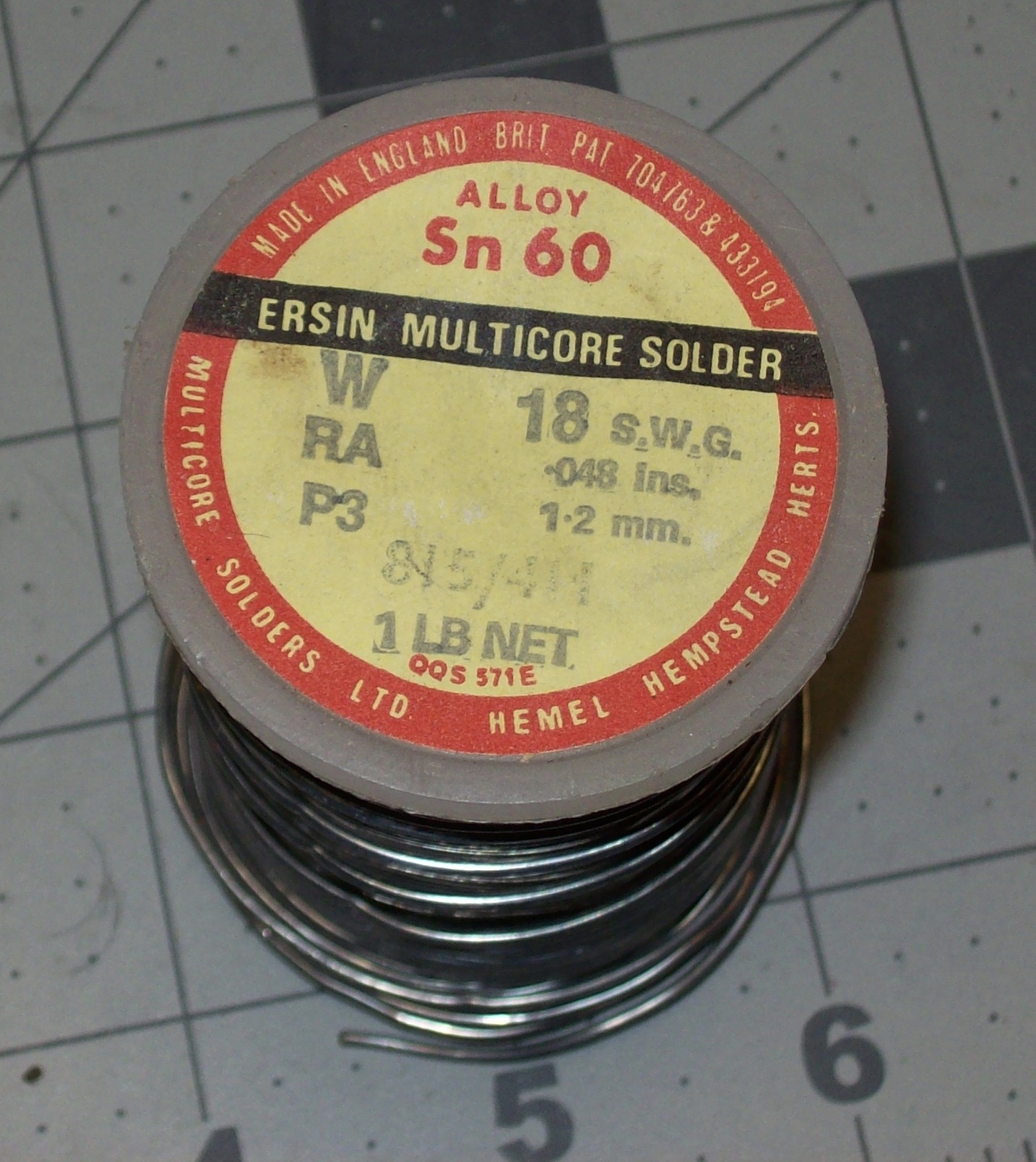

    Should I use this solder?
    I inherited this old spool of Ersin Multicore. I'm about to recap a KRK VXT6 powered reference speaker. From what I've read, this solder is better for the job than the others I've got on hand, Kester 50/50 or Tandy 60/40.
    I'm asking though, because I don't understand much of the label and haven't been able to find a datasheet for this exact product.
    Thanks for your input.
    • 31214
    Re: Should I use this solder?
    it's re-datasheet
    label says 1.2mm 60/40 with mildly activated rosin flux
    throw away the first few inches - the flux will have absorbed moisture.
      Thank you! I've been reading a ton of articles on soldering recently and you're the first person to mention the flux absorbing moisture.
            I have a feeling only the water soluble fluxes could absorb water... the rosin/colophony fluxes ("brown stuff" versus the water soluble and no-clean fluxes) I have a hard time seeing them absorbing water?
                perhaps the question is how old is old.
                Real *rosin/colophony* (brown flux usually) core solders are not water soluble and can't turn white. These need IPA to remove, water won't clean them off. (Ever have really old point to point soldered electronics? they don't have white deposits, just brown sh*t at the joints and they stay that way even after 50 years!)
                RoHS no-clean and water soluble fluxes use organic acids that should vaporize but if there is any residue that you can't see, it will turn white after being exposed to water as it crystallizes.
                Zinc Chloride (inorganic acid flux) should never be used on electronics... and this is white from the start.
                I think my RoHS solder (lead free) probably has the white organic acid flux, if I chop off a bit of the solder I can see the center flux is white instead of dark brown.
                    Still think something is very fishy here.
                    Colophony/rosin does not absorb water, it was meant to repel water in pine trees. If it really did absorb water, then there would be this white mess on these ancient 1950s radios that were using them exclusively. But instead we see the brown residue which is still as active as a flux as it was when it was applied...
                      Colophony/rosin does not absorb water, it was meant to repel water in pine trees. If it really did absorb water...
                      Old flux generaly are made from colophony (destilated rosin), the alcohol aka Isopropil or etanol and some other aditives like castor oil (mix with water), glicerine (also alcohol), camphor...
                      Till pure colophony is not melted in water, if is mixed with any alcohol, alcohol will allow to apsorb water. If alcohol evaporate, the rossin stay firm. Glicerine can not evaporate at all in standard electronic work, and white color might be from that reason.
                        Okay, now we're getting somewhere. Glycerin could be involved. But it itself or water does not give white deposits, it must be something mixed in the glycerin. However I'd say glycerin is more recent "new" RoHS type flux component that's not used with pine resin?
