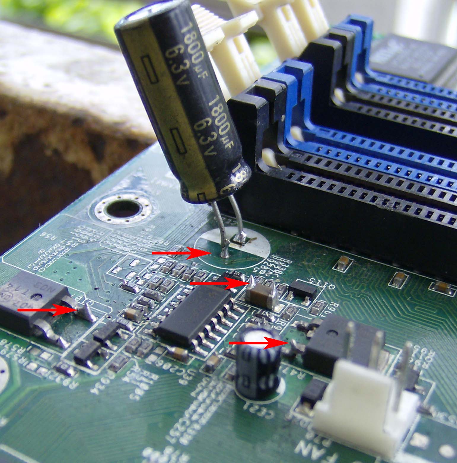

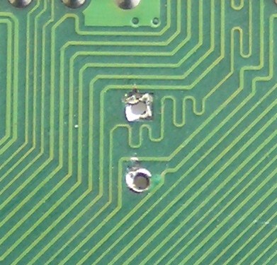

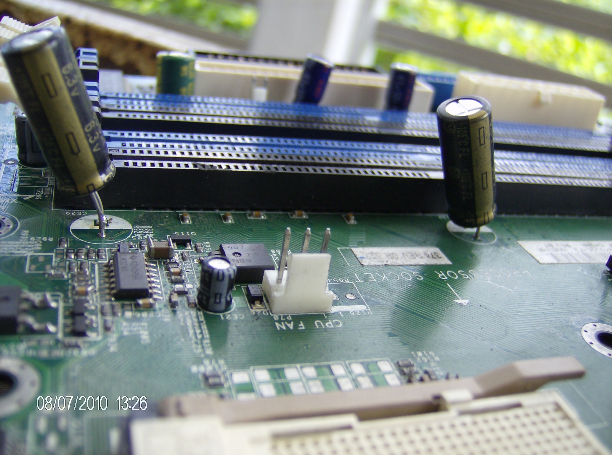

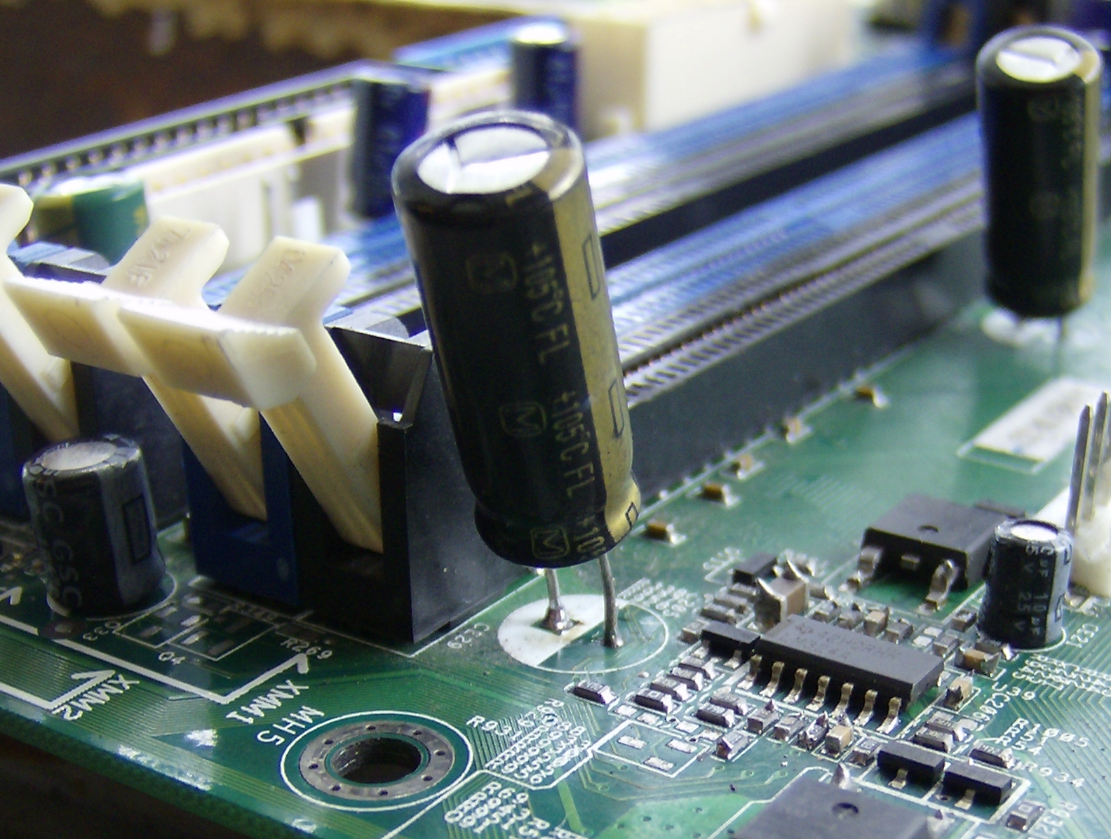

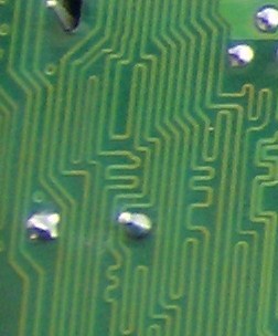

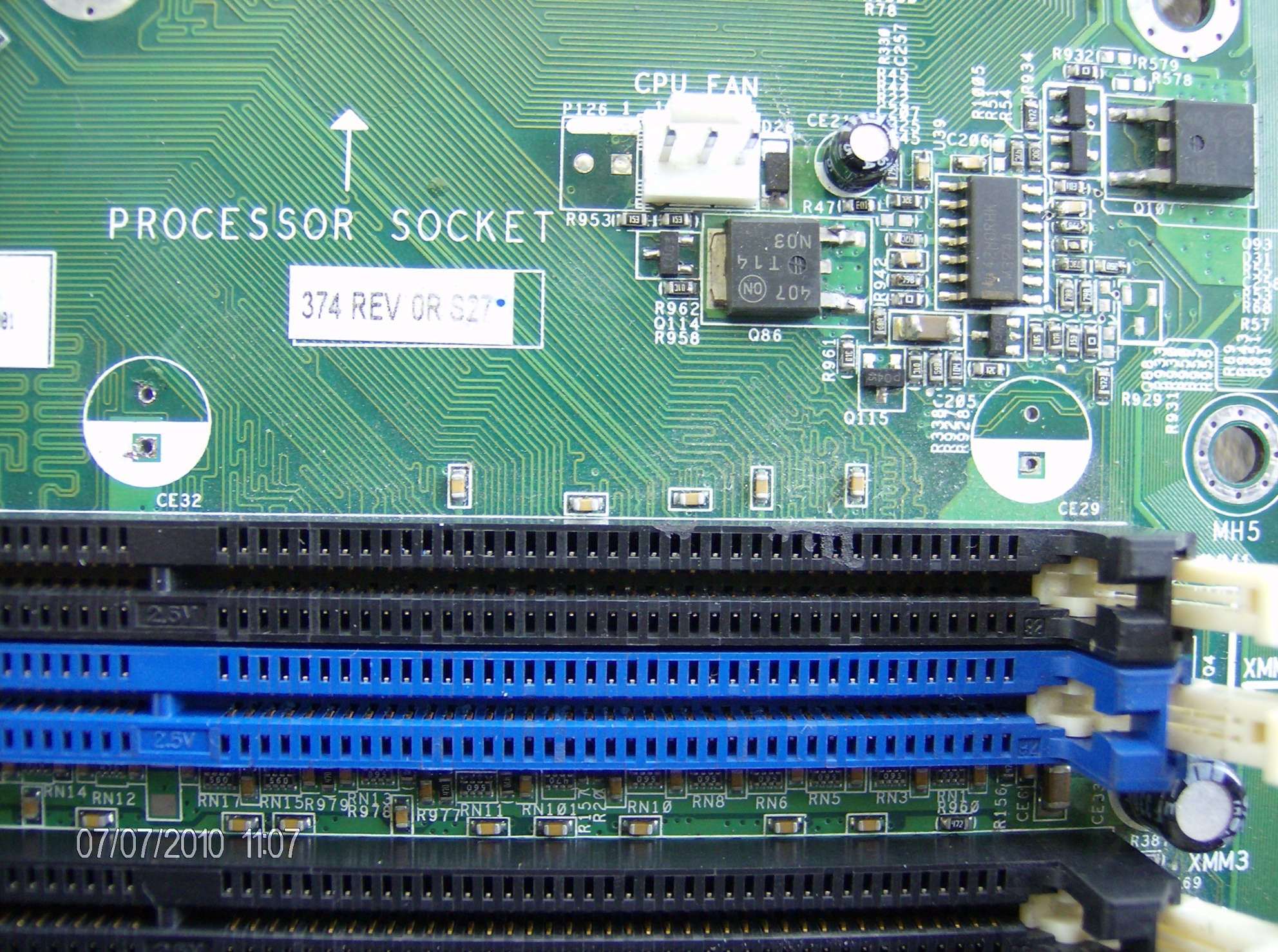

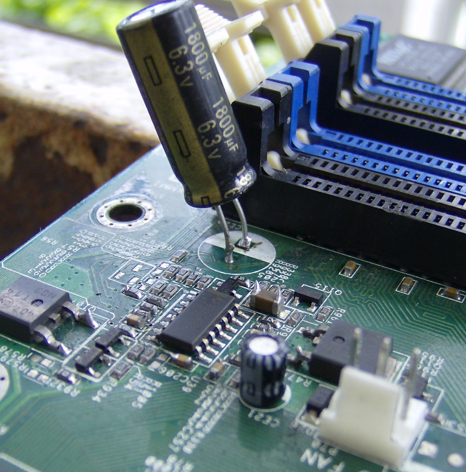

    Hello everybody, i messed up this board i was in the middle of fixing
    (we could also name this thread: "this is how NOT to do it")
    top:
    https://www.badcaps.net/forum/attach...id=16727&stc=1
    https://www.badcaps.net/forum/attach...id=16728&stc=1

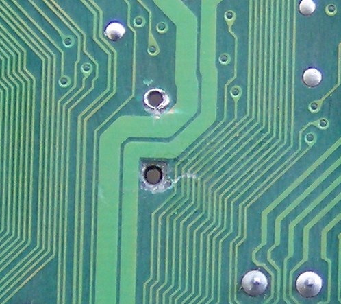

    looks like my solder sucker sucked this time, dont blame it, my fault all the way, so i was wondering if anyone could help me out in this and point me to a good solution, cause i really am in the urge of fixing these &%&#)$)%&$ boards
    on the top i have tested for contuinity and still does it (among the positives and negatives of the three caps), the worst seems to me the positve on the cap of the side bottom part (first thread pic), -but the one in the middle also looks bad. (second pic)

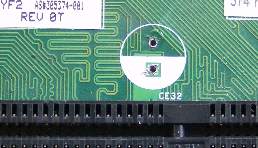

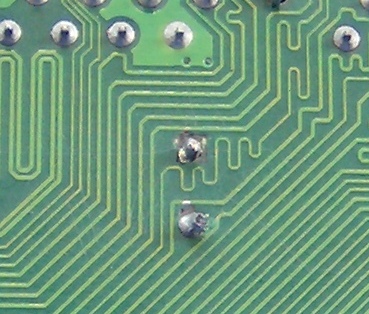

    https://www.badcaps.net/forum/attach...id=16731&stc=1
    do you think that by the continuity kept on the top solder spots it should keep on working? or you think i should 'bridge' positive pin from those two caps to the third cap (i havent touched this third cause its a rubycon, it looks fine imo and its solder joints look fine) ? or u think i should just call it dead?

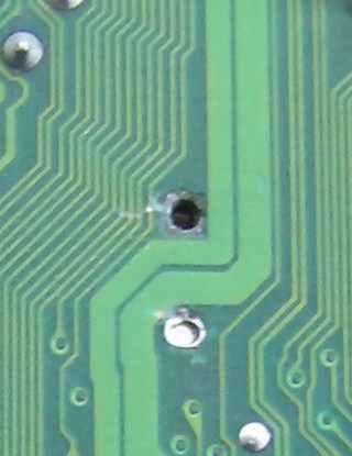

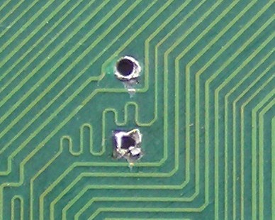

    https://www.badcaps.net/forum/attach...id=16732&stc=1
    https://www.badcaps.net/forum/attach...id=16733&stc=1
    Any idea is welcome. and really appreciated.

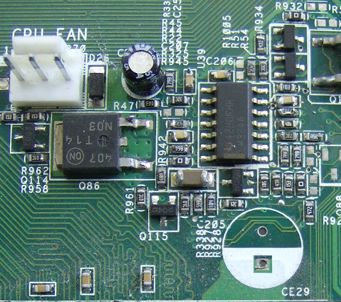

    first, i would check to see if you damaged any of the power circuit lines (the mini data or power lines just under the surface of the coating) on the motherboard. with how many scrapes that there are on the motherboard, i would worry more about them being damaged then about if the cap is going to get a good connection.. as for the caps.. i would just try soldering them in place.. if it does not work, then you know that you dont have a good connection and easy to fix after that.. on th condition that none of the other main circuits are damaged..
    and just out of curiosity, did someone do some soldering of the little mini caps?? on the board.. the ones that are something like 1mm thick and wide and 2mm long..?? Im just wondering because some of the solder joints one them look not that great to have come from the factory like that.. they have rough looks, solder spikes coming up, and the one looks like it either has, or almost has a completed circuit on top of it from the excess solder on top of the mini capacitor.. its the one that is on the right side of that chip that has the code "42H0RHK" on it.

      thanks for the reply, so bad im kinda workin on/off today cause its my bosses bday i did some manual resoldering of certain areas, do you advise me to do it again? with more care? lemme update a little with pics, as of right now i have already cleaned it with iso, the board booted but close to the minute running mtest got stuck again. this time it just froze without weird characters showing. i tried to see if itd boot again and it did not, no POST, so i went to eat -bday- and came back and tested again and it booted, then i turned it off and is where i am right now, im gonna take pics so u can see the mess i did this time. last time on test: booting, but still gets stuck.
      thanks for your time. will put pics asap.

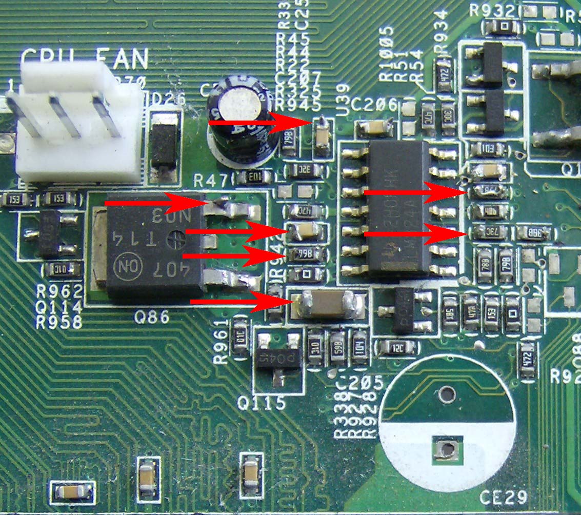

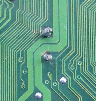

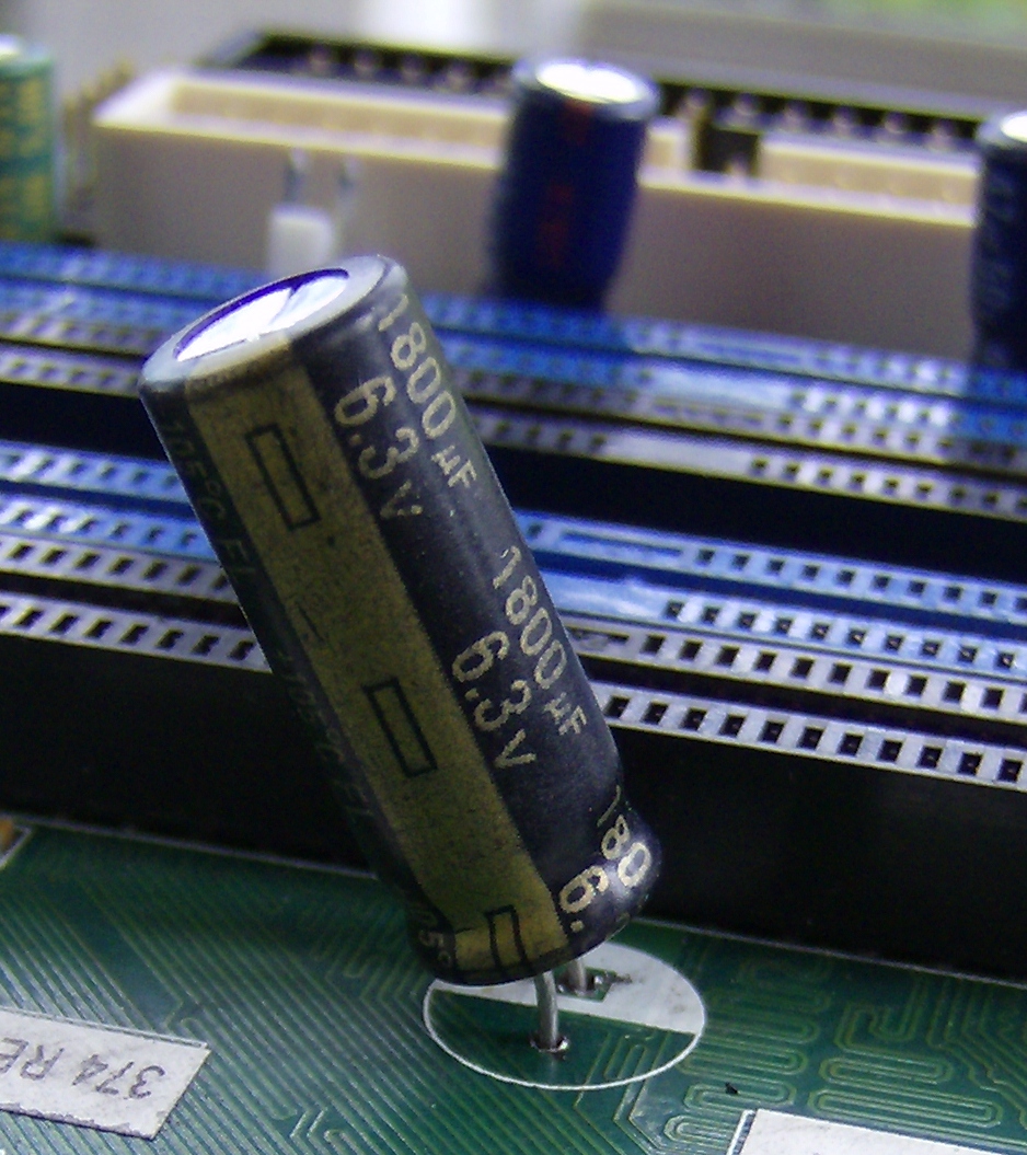

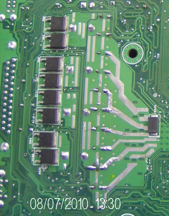

        UPDATE: Wel, continuing the whole "this is not how to do it" thread , this is how i managed to solder the mentioned area... i am sorry about my poor quality at work, i just have no excuse for that but the fact that i work under a lot of pressure
        i also applied some soldering to the top, with the idea of making sure the contact is made at least somewhere, do you think this is correct?
        https://www.badcaps.net/forum/attach...id=16761&stc=1
        https://www.badcaps.net/forum/attach...id=16762&stc=1
        https://www.badcaps.net/forum/attach...id=16763&stc=1
        https://www.badcaps.net/forum/attach...id=16764&stc=1
        as i mentioned, the board managed to boot, first try got stuck really quick and then it didnt boot right after, then it rested for a while and then booted again, I also would like to know if theres a spot where i could bridge the caps on the VMR to make sure of their contact too? i have checked for continuity on their positivo leads within those rails in the middle but then again the negative also gives some so i am not sure if its safe to bridge -and who- that way....
        https://www.badcaps.net/forum/attach...id=16767&stc=1
        https://www.badcaps.net/forum/attach...id=16768&stc=1
        Any idea, suggestion, tip, direction is really welcome and appreciated,.

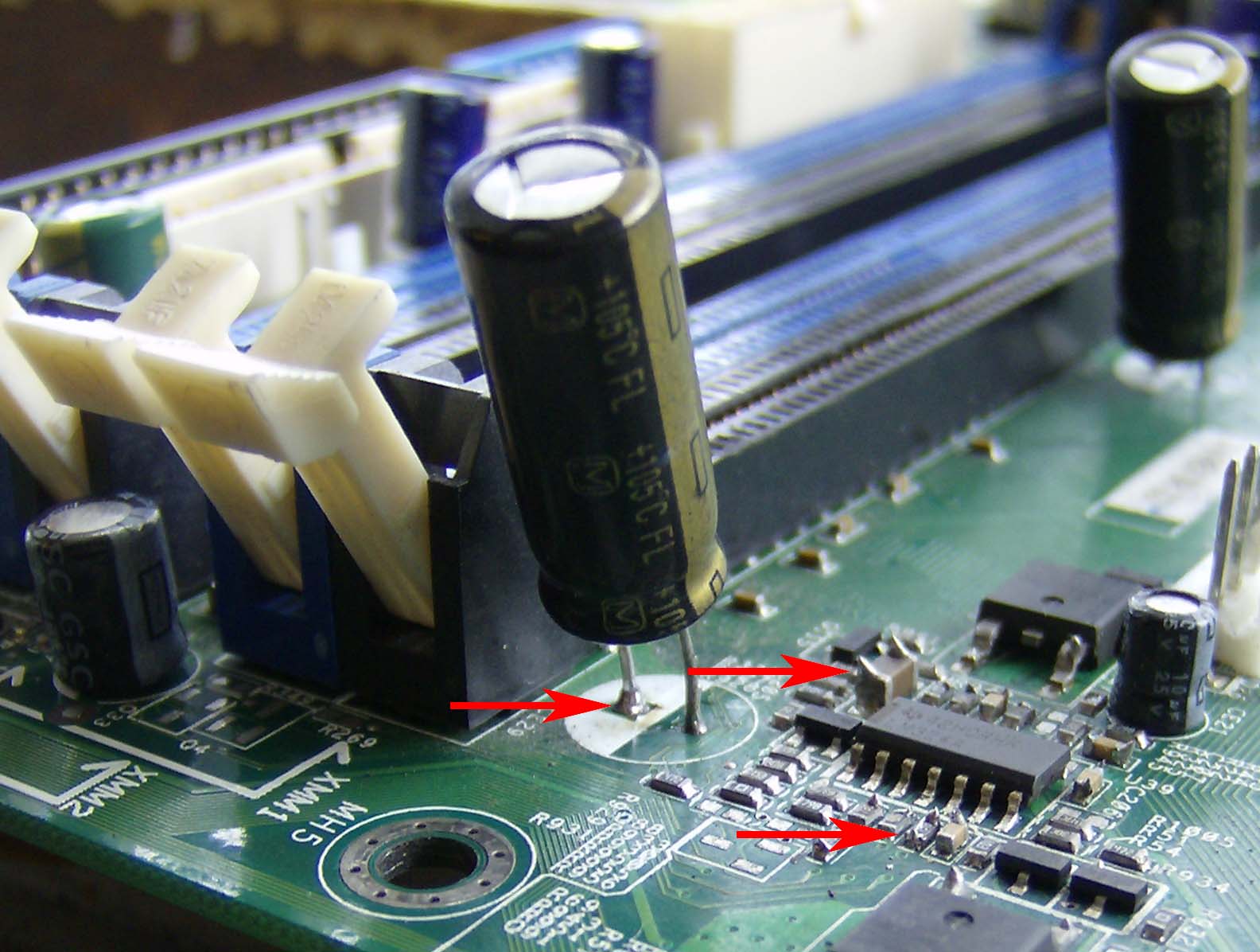

          Re: Help! Recapping Gone Bad...
          You didn't get any solder into the vias.
          Look at pic 2.
          I think your iron is too cold.
              You should get a hotter iron before anything else.
              A hot iron heats a small area [ideally just the joint] very fast so you are on-off quick.
              Too cold an iron heats a large area slowly and might never get the joint to the proper temp because the heat 'runs off' through the board faster than the iron can heat the joint.
              Hot iron - like using a branding iron on leather.
              Cold iron - like trying to brand leather with a light bulb.
                Once you have a hotter iron I'd just wick off the blobs and apply new solder.

                        Ok. here are a few things. First, I agree. Either the solder gun is not getting hot enough or you are reheating the solder way too many times. If solder has only been heated 1 or 2 times and and is heated hot enough, then it should have a nice even flow to its look. You see how yours has this really rough look that almost makes it look brittle. That only happens if the solder gun is not hot enough or the solder is heated too many times..
                        As for the the caps, is there some reason that you have them pulled way out of the socket and did not solder the caps flush with the board? Personally i prefer flush unless you plan on bending them, say 45 or 90 degrees because of space restraints. If you just leave them up in the air and straight, then that makes more of a chance that someone will hit or bump them later and possibly damage the cap.
                        Did you do the really small ones that are like 1mm or 1 1/16 inch high.. A lot of them have a really rough look too and did not know if you bumped them or soldered them too.
                        When you do solder, you usually try to keep the solder on the back of the board with standard caps. the one that you have has the solder on the top and bottom of the board with a little blob on both sides.. You dont need to solder the cap lead on the cap side of the motherboard, just the back side. A little of the solder should run into the joint to fill in the space between the cap lead and the board when you solder it from the back. that should be all you need.

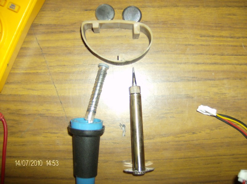

                              hello and thanks for the replies, i bought one of those cheap irons and wel it was too damn cheap it broke in the middle of resoldering
                              and wel i managed to get the temp a little up in here and the last days ive been doing a manual resoldering of all the board, im done, didnt finish the whole board but most of its top part. still it is not working. i blame it on some defective vias -since i cant track that i guess-
                                How does one break a soldering iron?

                                  • MXM
                                    • 430
                                    • Unknown
                                    like from the base, were the handle ends and the iron starts. i guess the plastic couldnt handle it haha... i said it broke cause you know i was using it, and out of the sudden at the middle of soldering..... it split in two the only bad was the small burnt i got, but nothing for the ER
                                    mi internet is being a bitch took me 3 hours to upload the pics for my other thread on this board today... but lemme give it a new try on this.

                                      i think the iron wasnt getting the desired temp, i managed to get temp little up here since in the morning no one is and i took advantage of that, besides the person who likes lowering the ac temp comes in the afternoon and she does it cause shes on the change anyways,
                                      the reason why i soldered those caps with some roon was to put some solder em from the top side of the board instead of the bottom, why, cause as u can see in the pics i really fucked the wholes on the bottom, like there was nothing to stick the solder in.
                                      As for the other caps yeah i tried to resolder the board, there are newer pics on the board thread, and looks a liiiiittle different.

                                        just an idea, but if you are leaving them up to solder from the bottom, i dont think that it will help much. since the solder joint is supposed to be on the bottom of the board, then there is not always anything on the top of it to get any kind of a connection to. If you want to make sure that it gets as good a connection as possible, what i would do is this. before you put the cap in, make a quick solder layer on both of the cap leads to make sure that the solder will stick good. Then solder them into place. while soldering them in, keep the heat on the solder and slightly pull the cap out and then push it back in which will/should pull the cap lead partly out of the hole and then back in. You dont need to pull it all the way out. Having the little bit of extra solder on the back of the board and keeping heat on it while you partly pull it out and then push it back in should pull solder into the hole to make a good connection and fill any air holes around the cap lead to the board to make a good solder connection all the way through the board and that should make as good a connection as the one that you did having it pulled way out. Pre-soldering the leads will make sure that the leads will hold the solder good too and since they were just done, the need for flux should not be needed because there should be no build up of dirt/oils on any of the solder connections so the solder will hold good too.
