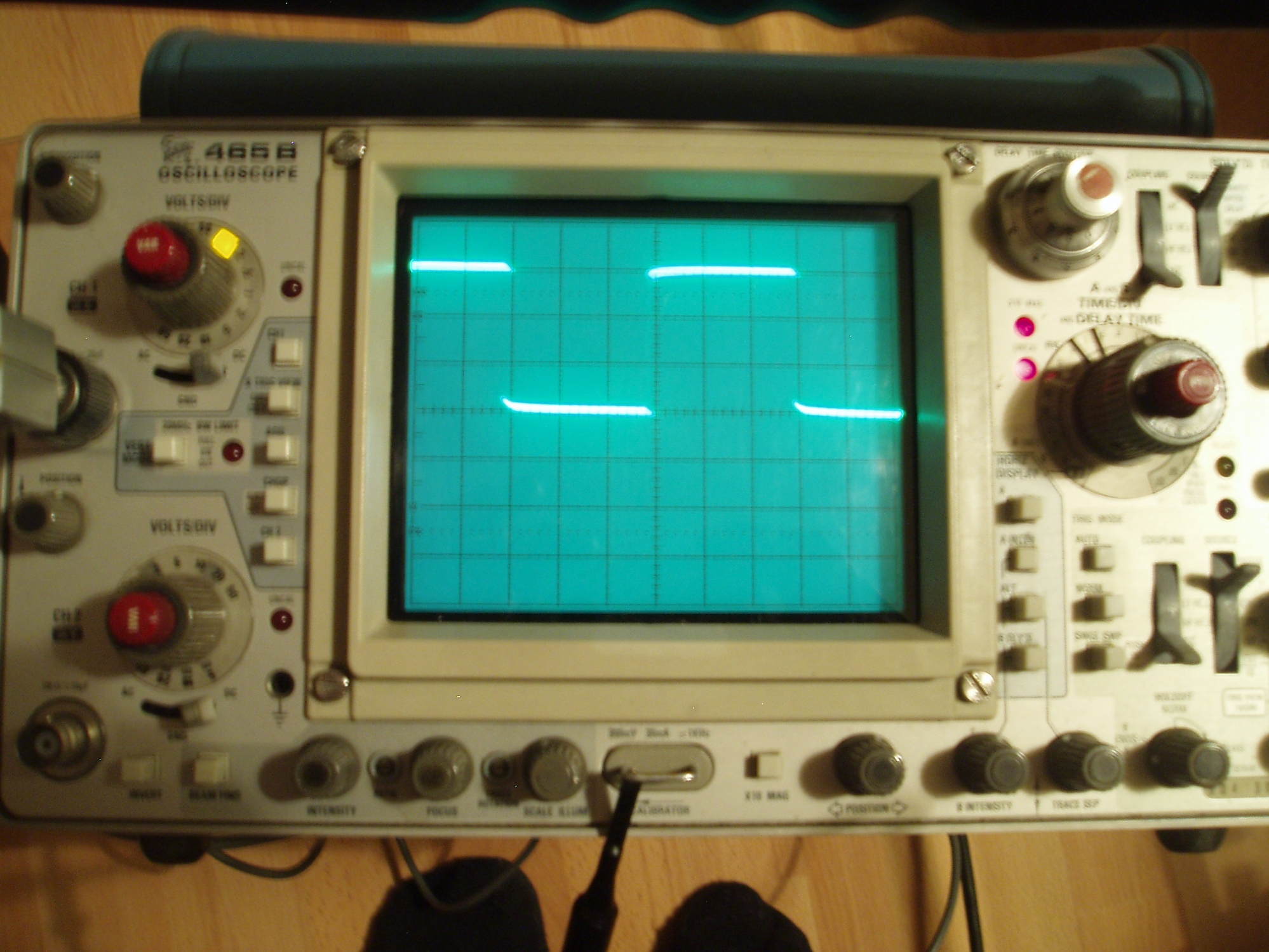

    Re: Help with techtronix 465B scope what to do
    Hi Radio Fox,
    Here is the pic of the waveform ..any ideas appreciated
      Tweak the trimmer in the probe?
      Clean the mechanical switch of the attenuator?

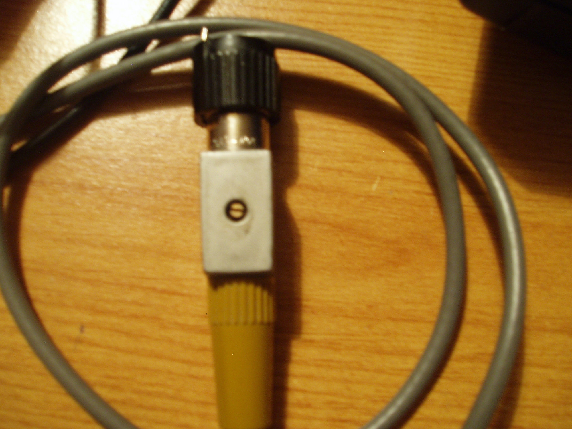

        Hi i do not see a trimmer on the probe so not really sure what you mean ...this probe is p6105 x10 100mhz 13pf 10m ohm 2 meter tek ..now i only see a button for the gnd ref..so am at a loss at the moment.Thanks
        • sam67
          • 256
          Just noticed this ..Would this be the trimmer that you mention..if so what do i need to do ..do i turn it while the probe is in channel 1 and connected to calibrated bar ?
          • PlainBill
            • Feb 2009
            • 7034
            Yup, you got it in one. The objective is to eliminate the curve at the beginning of the horizontal traces.
                If you were wondering why the verticle edges were faint, the simple answer is: this is perfectly normal for most tube scopes. This is a picture of an LCD scope. You're not doing anything wrong.....yet. Once you smooth out the edges of your calibration square wave, then you'll be ready to move on.
                • Radio Fox
                  • Jan 2010
                  • 281
                  Yep.
                  The "problem" with CRT's when looking at square waves, is that the vertical transitions are so fast that the beam of electrons doesn't strike the phosphor for long enough to make them glow.
                  If you were to look at a sine wave, or triangle wave, then the whole waveform would be visible.
