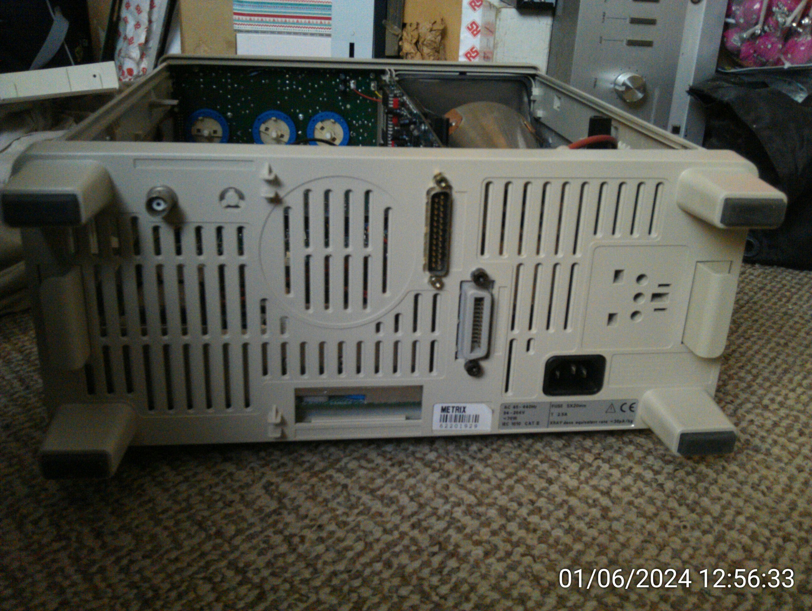

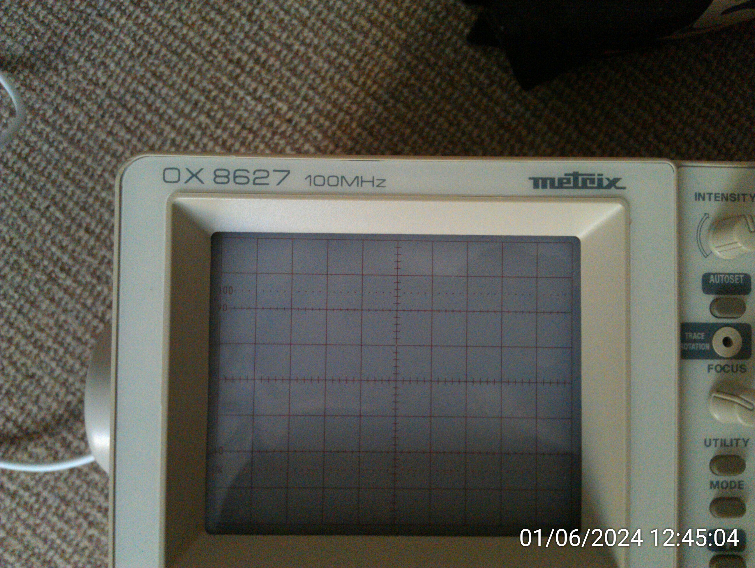

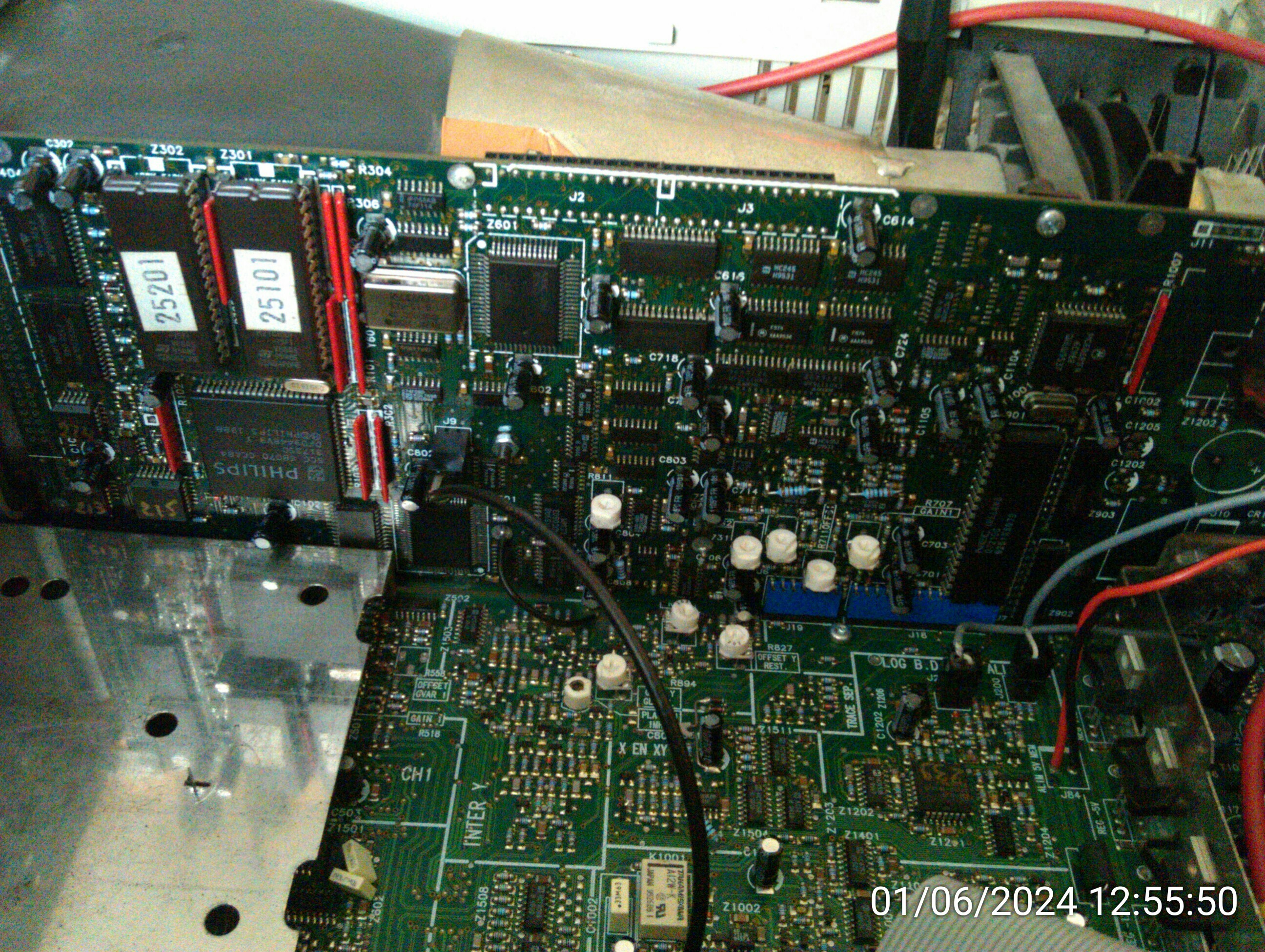

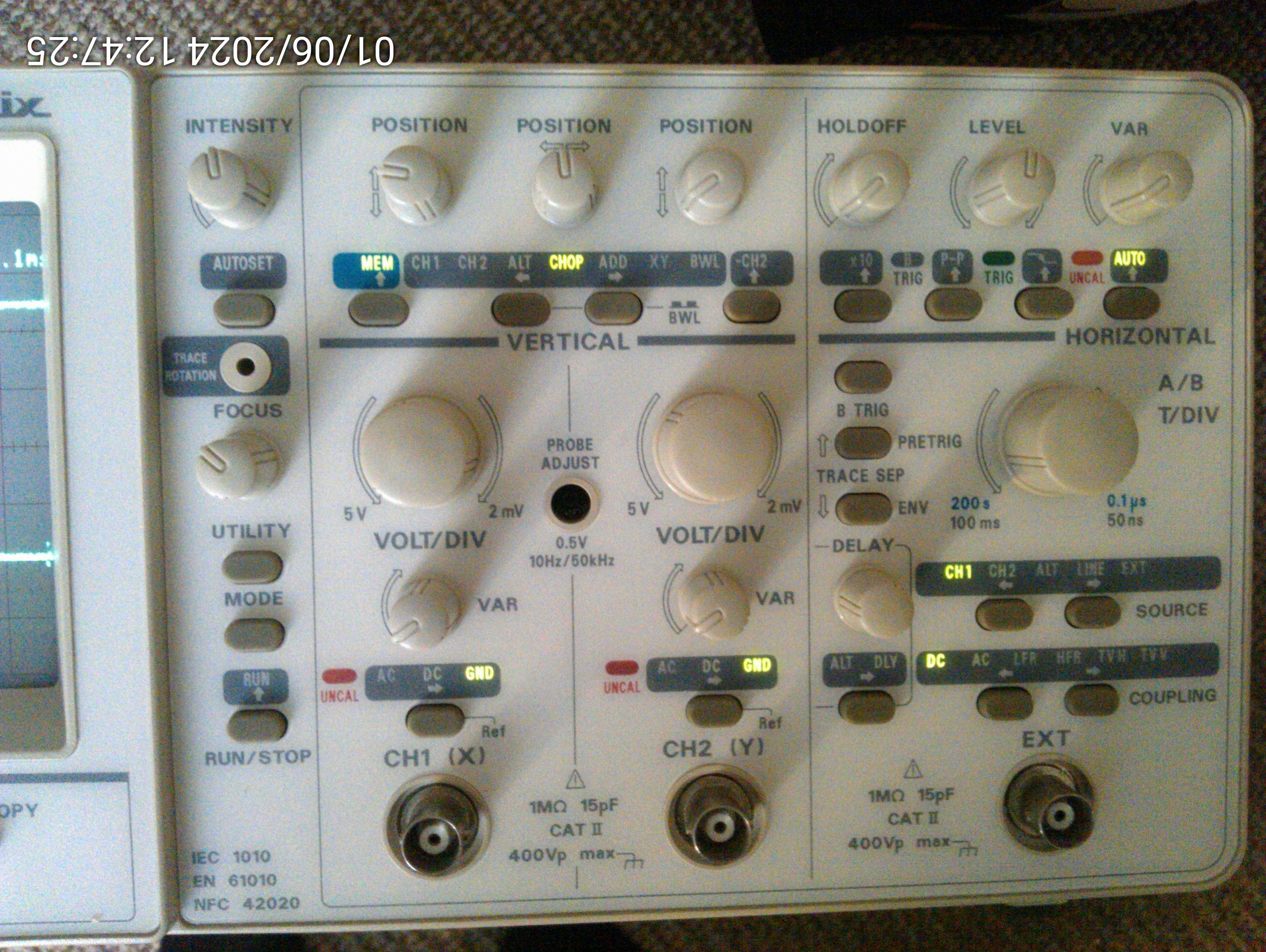

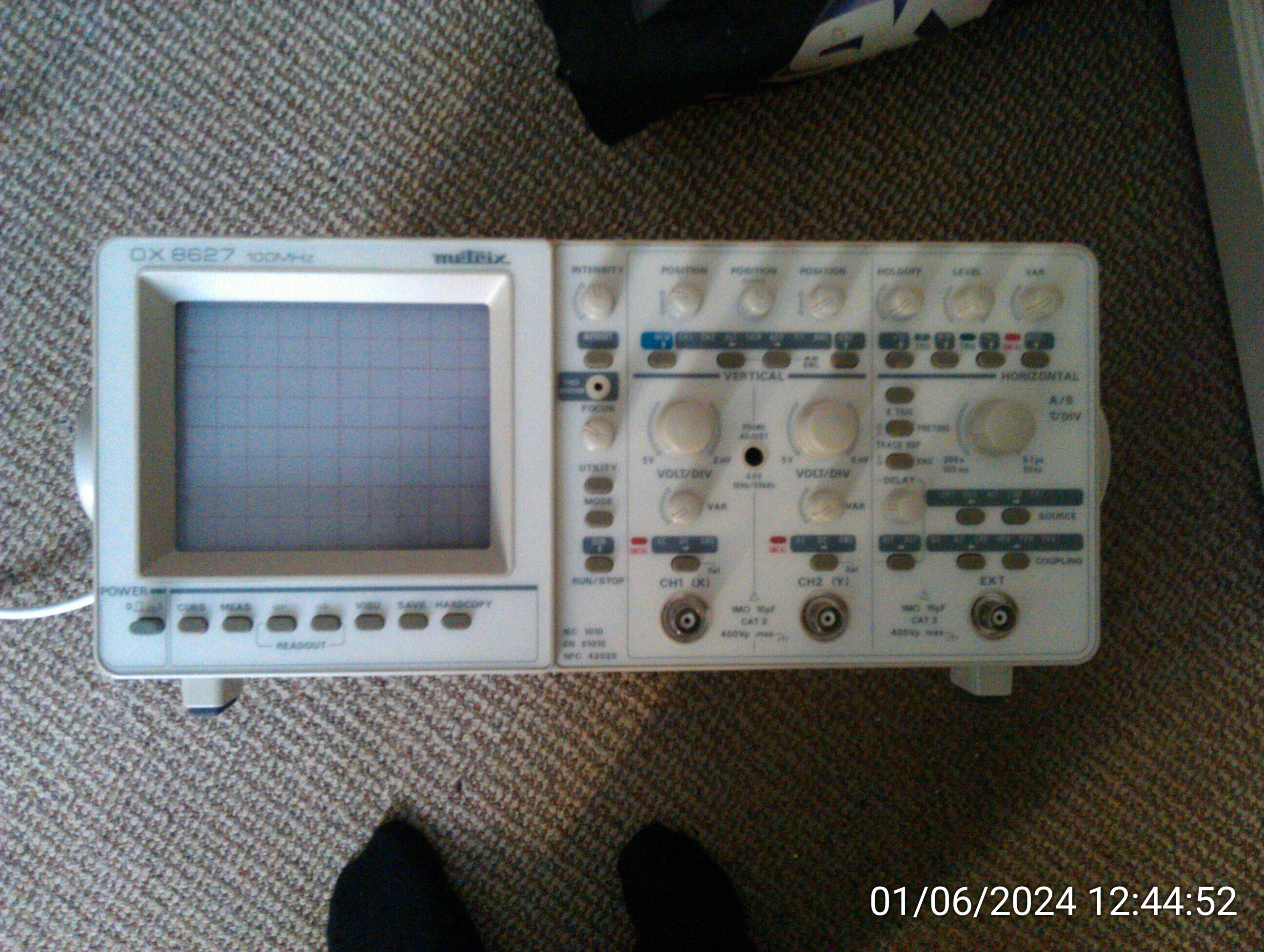

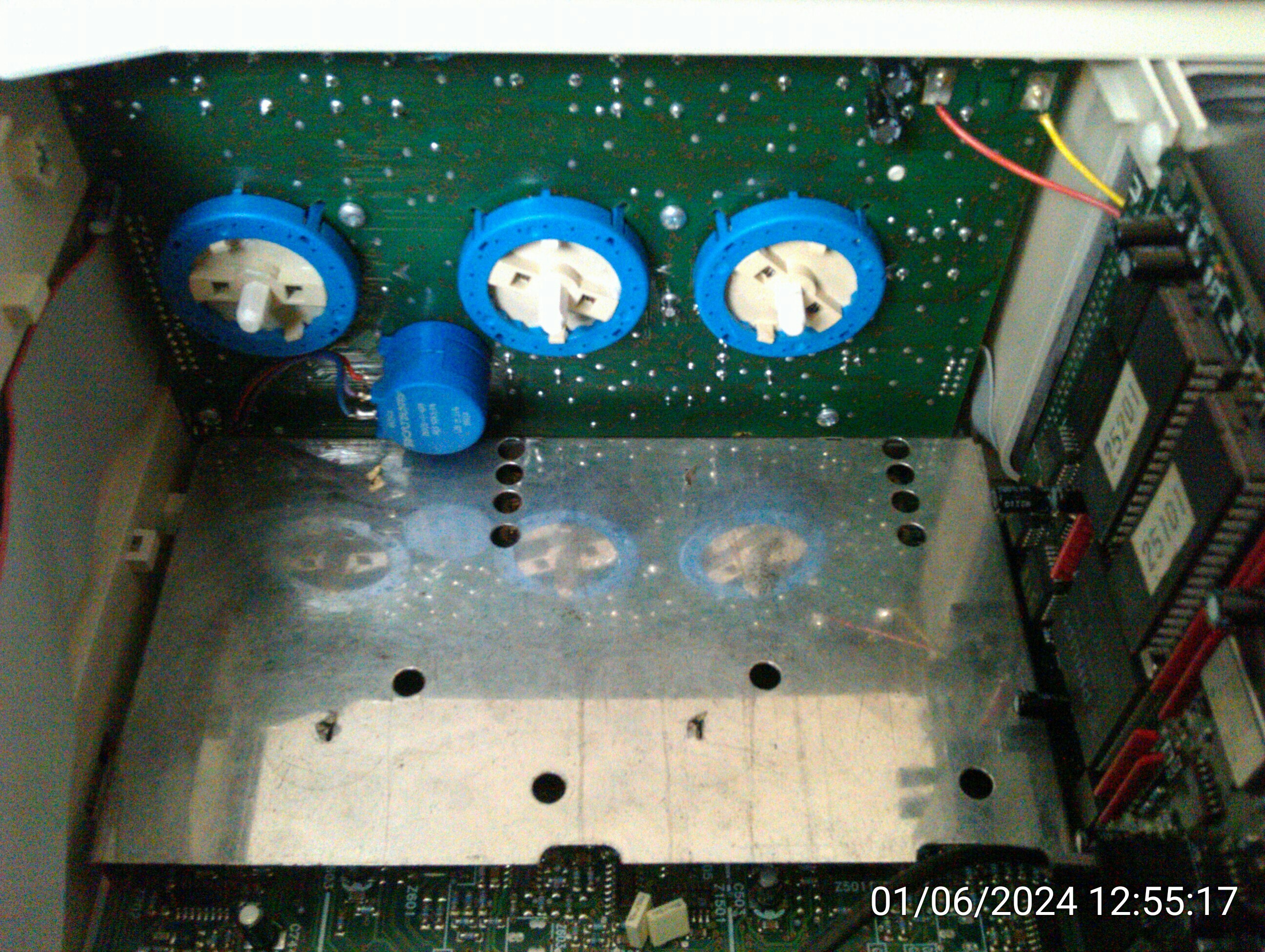

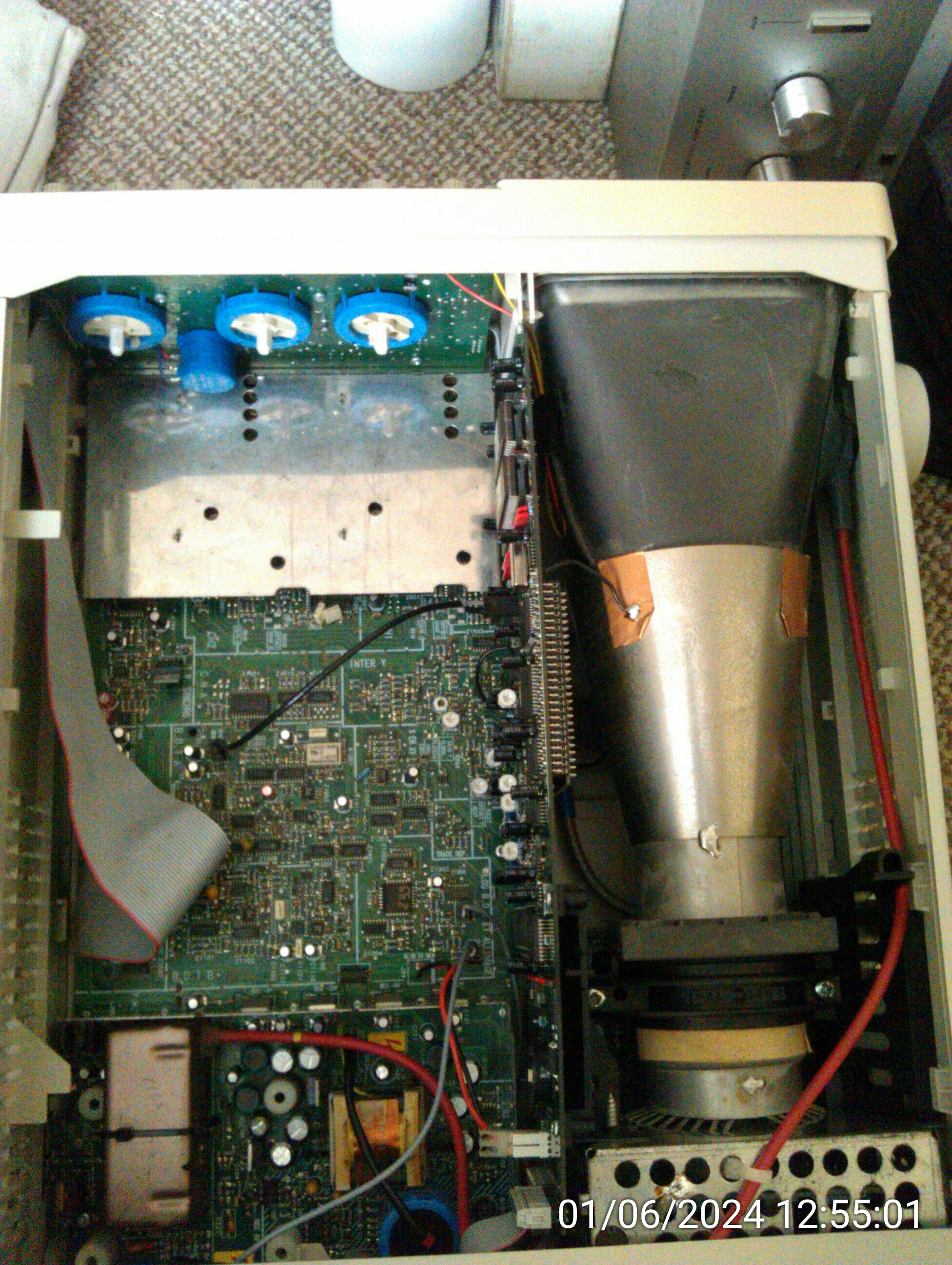

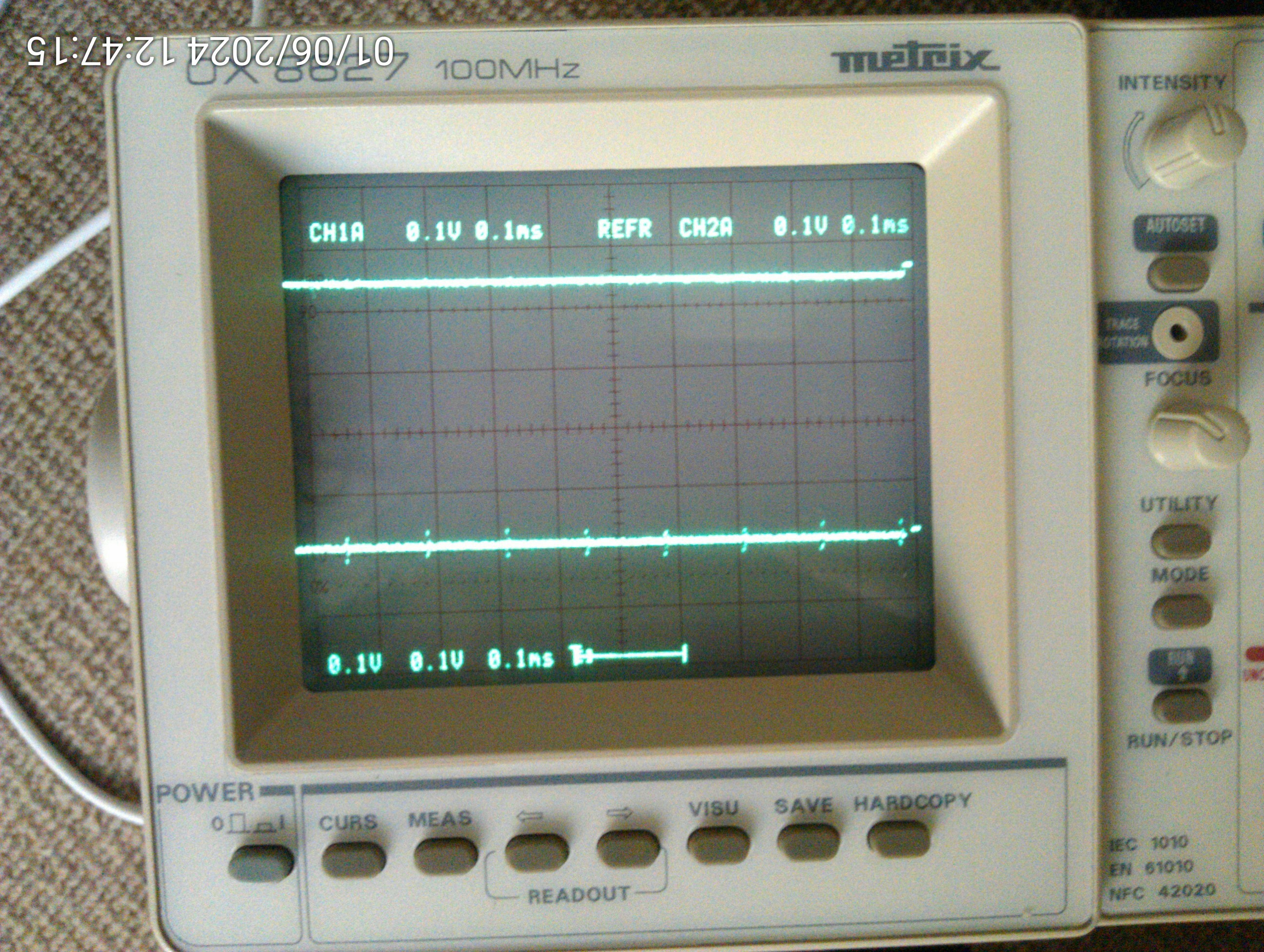

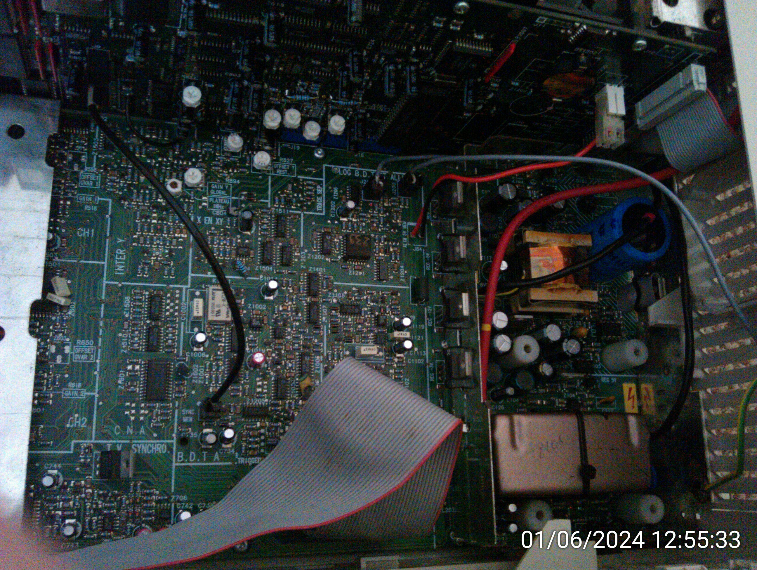

    Metrix OX-8627
    100Mhz dual-trace digital storage CRT scope.
    all controls are digital and it has full remote via IEE488 bus
    very fucking rare and hard to find any info on
    some pics after a recap using about 90 new caps!!

        Wow what a nightmare to recap this device
        Do you have it working correctly now or do you still have to do more work on it
          • 31277
          it's been in bits about 5 times.
          my fault - i should have just done all the caps and cleaned all the front switches in one go!
          it's 99.9% now.
          when i got it it was dead,
          so i stripped and cleaned it and replaced the caps in the psu.
          then it ran but was jumping all over the screen, so i stripped and cleaned the front panel.
          then it was o.k. but one channel seemed off - so i stripped it and recapped the whole baseboard.
          finally i recapped the digital board just because i was getting pissed off tearing down and re-assembking it.
          now the switch on the pot for manual timebase override is touchy, but thats sealed.
          so i need to ignore it or replace the pot.
          other than that i think it's good now.
          original caps were 98% MARCON junk btw!
          if anybody finds this thread in 2030 or something - here is a gift
          the temptation to try to remove and read the pld's and mcu are pretty strong, but i'm resisting for now
