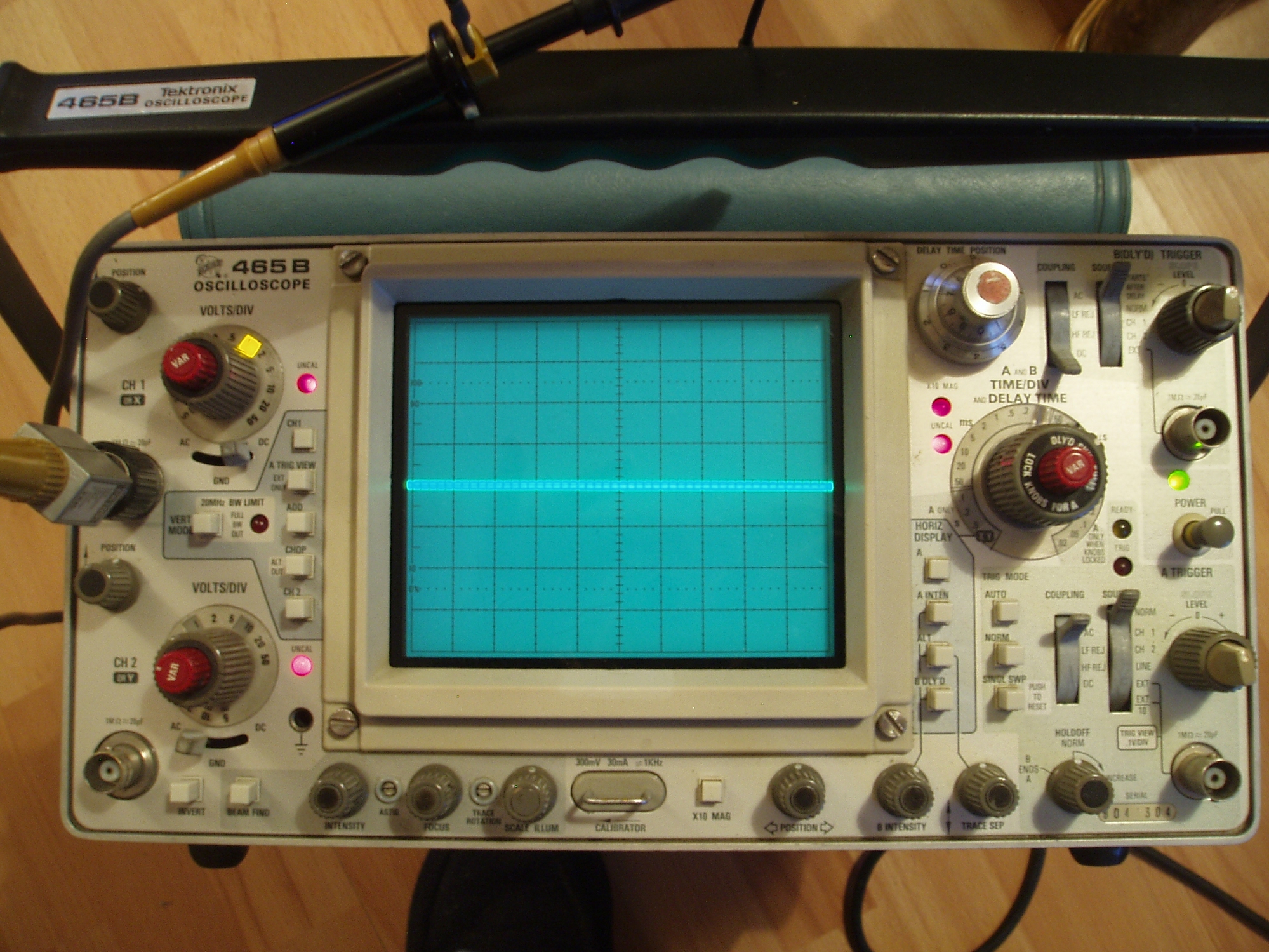

    Just got a techtronix 465B scope with a x10 probe but don't have a clue how to set it up right to get a trace..
    I feel gutted as i thought i would try to see how a scope works and thought i would be able to set this up correctly but to be honest i don't have a clue with it and feel i have got in way over my head .
    I have the manual and set some of the controls but there are so many dials that i am not 100% it's set right and the manual is not that helpful for me..
    I am not to bad usually at following things but for some reason i feel a right dumb ass with this .
    I did read up on scopes before i got this but thought i would be able to work one,well that just shows you how wrong i was.
    So i am now at a loss because i would like to make sure this is working correctly which i think it is as the ebayer shown it to be working and it is just me that does not know how to work it correctly..

      I have now managed to get the trace looking at the link you provided ,Here is a pic of the scope ...The trace looks better than in the pic due to the light...But if anyone can help me to set this up better if i have missed some thing then it would be great.
      Now what would be the recommended settings to look at some of the components in my faulty psu that has intermittent problem..Can i use these settings in the pic to look at the main filter cap for ripple or check on the pwm ic that i have the data sheet ? just so i can get an idea how the scope is doing.
      Any help appreciated as i am trying not to give up even with my limited knowledge .
      ps i have changed the setting to DC coupling on the left side which is in AC on the pic..i only noticed once i looked at the pic lol

                Sam67...have you tried connecting the probe to the "calibrator" bar? This will give you a waveform to play around with, so you get a feel for the time/div & volts/div controls.
                It will also let you trim your probe on the X10 setting for the best waveform.

                  Put the probe on the calibrator bar.
                  You want to adjust the calibrating screw with a non metallic tool so the edge of the square wave is straight.

                            Page 2-10 of the manual shows you how to set the scope controls for basic measurements. Set the CH 1 volts/div knob to 0.1V. Where it says "connect a signal to the CH 1 input connector", plug your probe into CH 1 & clip the hook of the probe onto the calibrator bar.
                            To start, make sure all the red var knobs are turned fully clockwise to extinguish the "uncal" lights.
                            You should see a tightly spaced square wave. Turn the time/div control clockwise to widen it out. Turn the CH 1 volts/div to alter the amplitude. Play with the red "var" knobs to see what they do (but remember to always have them fully clockwise if you want to take accurate readings).
                            As Krankshaft says, there is normally a trimmer on the body of the probe that you can adjust for the best waveform. Too far one way & the edge of the squarewave will be rounded. Too far the other way, & the edge of the squarewave will overshoot, producing a spike. Adjust it to give a near a square edge as possible.

                                Thanks for the info..i can get sort of a squarish waveform but the the vertical side of the square is faintish but the top and bottom are very clear if you can understand what i mean..I cannot see a trimmer that you mention ? the probe i have does have a kind of button but that just says GND REF and when pressed just goes to a single line..
                                Also when i eventually try some tests i have to make sure none of the VAR knobs are turned on meaning the uncal lights are all extinguished right ? The only dial i don't know what setting should be is the delay time position ,it reminds me of a dial that you see on a safe lol.

                                  I mistakenly thought that all X10 probes had a compensation trimmer. Obviously not.
                                  The GND REF button on the probe is handy for checking the reference position of the trace when taking voltage (Y axis) measurements.
                                  If you want to use the scope to take accurate measurements, then the red VAR knobs must be turned to extinguish the uncal lights. Normally it is fully CW. You will probably notice a slight "click" when it's in the right position.
                                  Dont bother with the Delay knob yet. That comes under the heading of "advanced tutorials". LOL.
                                  btw...did you try connecting the earth clip to the front panel earth socket?
                                  Also, I am wondering if the astig & focus controls might need adjusting to help in giving a clearer display of the waveform.

                                        I'm not sure what you mean by a full square waveform. If you alter the volts/div & time/div controls then you should be able to make it look square (i.e the same number of vertical & horizontal divisions).
                                        Setting your time/div knob to 0.5mS will give you 1 square wave cycle every 2 divisions. So you should see a high (top of waveform) for 1 division, then a low (bottom of waveform) for 1 division across the screen.
                                        From your photo, the trace rotation looks OK, so don't touch that.
                                        From the description of your waveform, I am wondering if the astig & focus controls are set correctly. The usual way to set the astig, is to set the time/div to the X-Y position (fully anticlockwise) to give a dot on the screen. Use the horizontal "position" knob, if necessary to move it nearer the centre of the screen. Do not connect anything to the CH 1 input. The astig control is adjusted to give a perfectly rounded dot. Adjusting the astig too far one way will produce a wide oval, too far the other way will give a tall oval. If the dot is too small to see the astig adjustment clearly, then you can adjust the focus control to unfocus the dot to make it a bit bigger.
                                        After adjusting the astig, readjust the focus (if necessary) to give a sharp dot.
                                        Can you post another photo showing the waveform you are getting.
