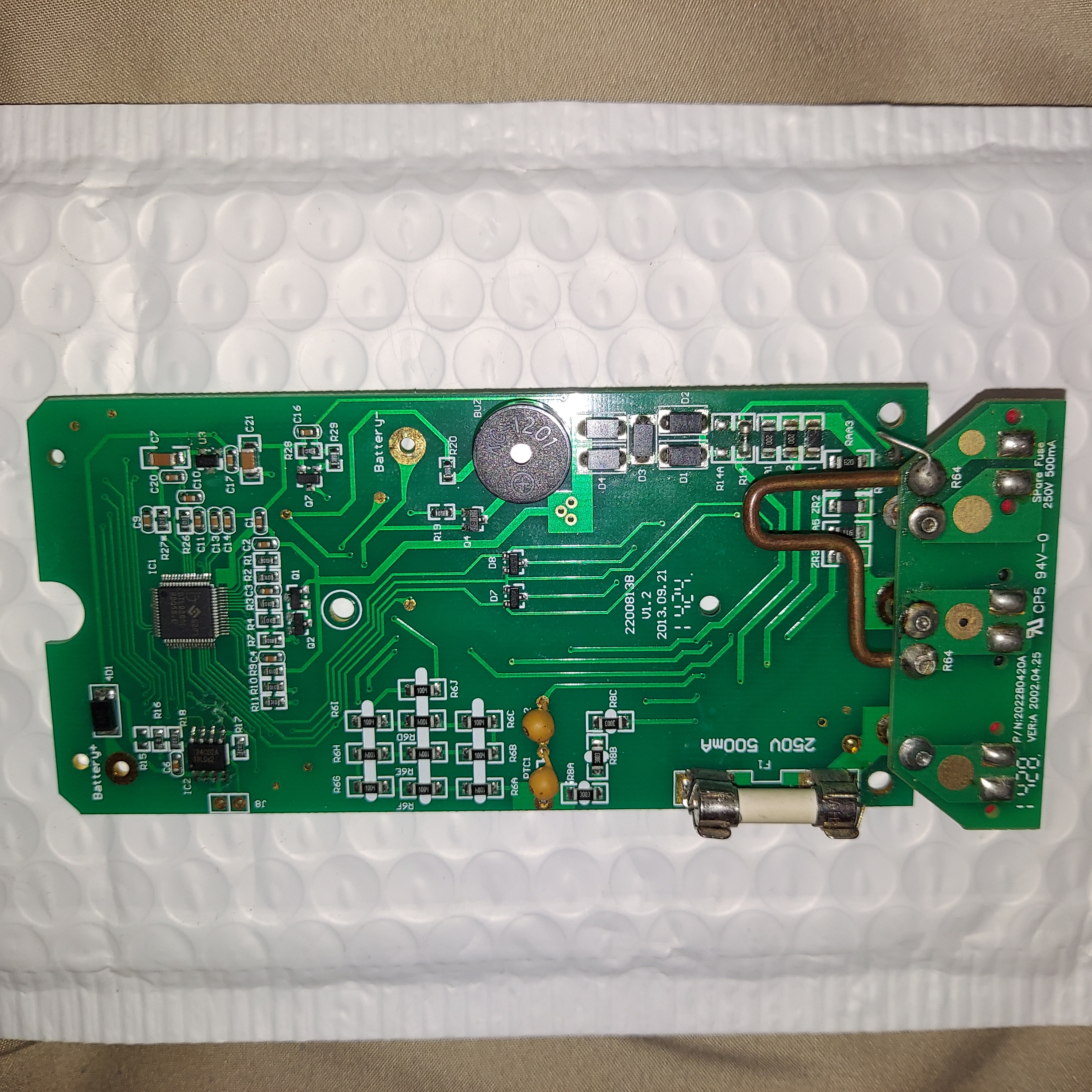

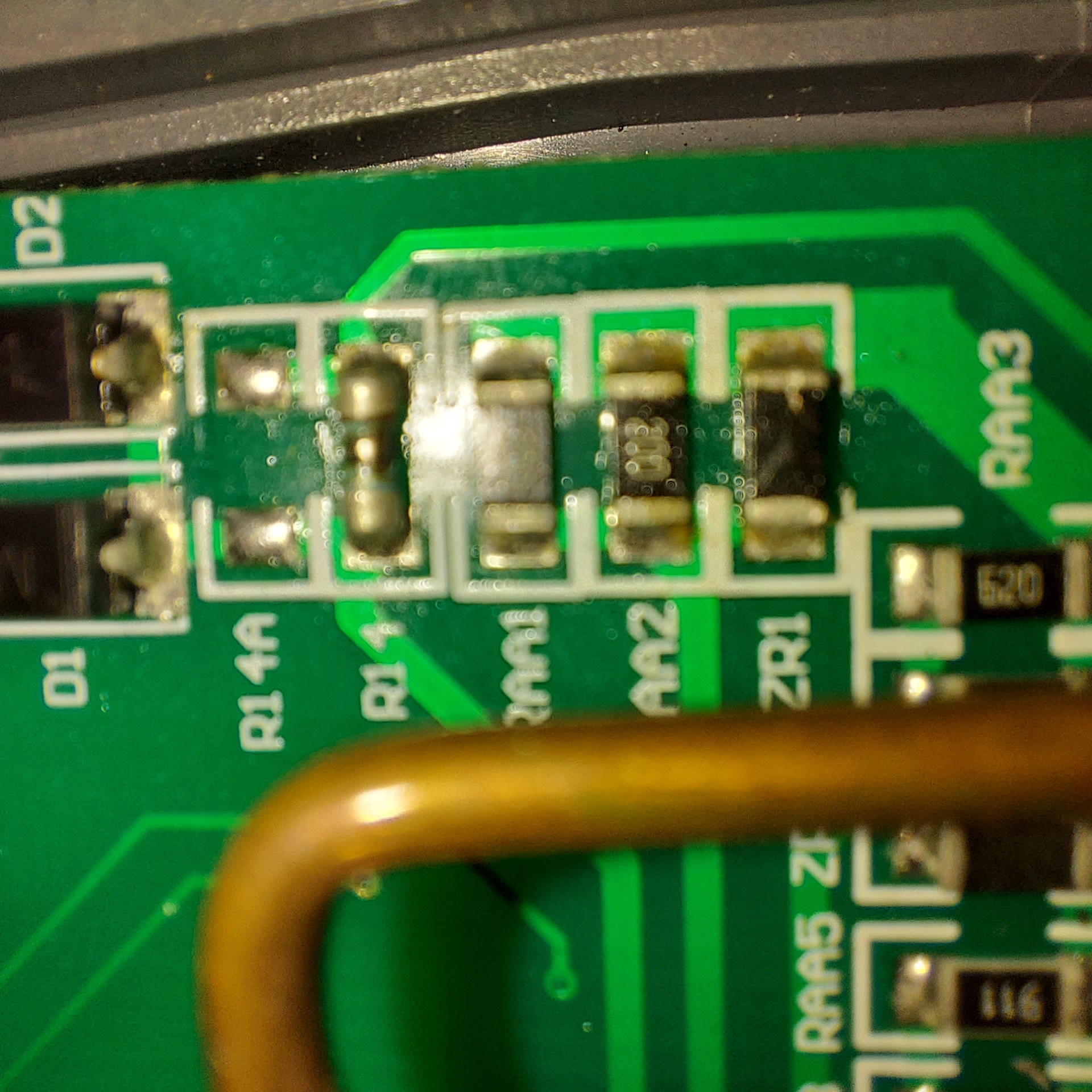

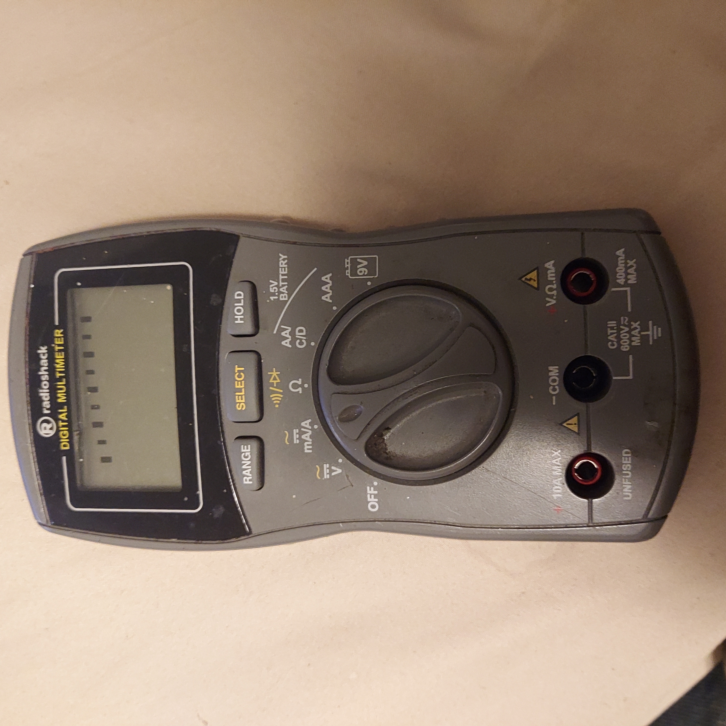

    Does anyone have any information for a Radio Shack 2200813 meter. I need to know what value R14 was. Mine is measuring 90 ohms. My meter did have a blown fuse F1 rated at 250V @ 500mA. Symptoms are meter doesn't measure DC mA correctly and beeps above 40 mA range if it is even giving proper current measurements. Below I have included some pictures and a macro shot of R14 on the pc board.

    Does the meter otherwise work on voltage, resistance modes?
    Is that 90 ohms measured out of circuit?
    What does the meter read if you pass 20mA in it with that 90 ohm resistor in it?
    Without any additional information or schematic my guess is 10 ohms.

      show the whole board so we can see the chips

        Yes the other ranges seem to work. I don't see any way to zero the ohms out as the meter reads about 46.7 ohms when leads are shorted. I'll send some more pictures of the main motherboard and some LCD readings.

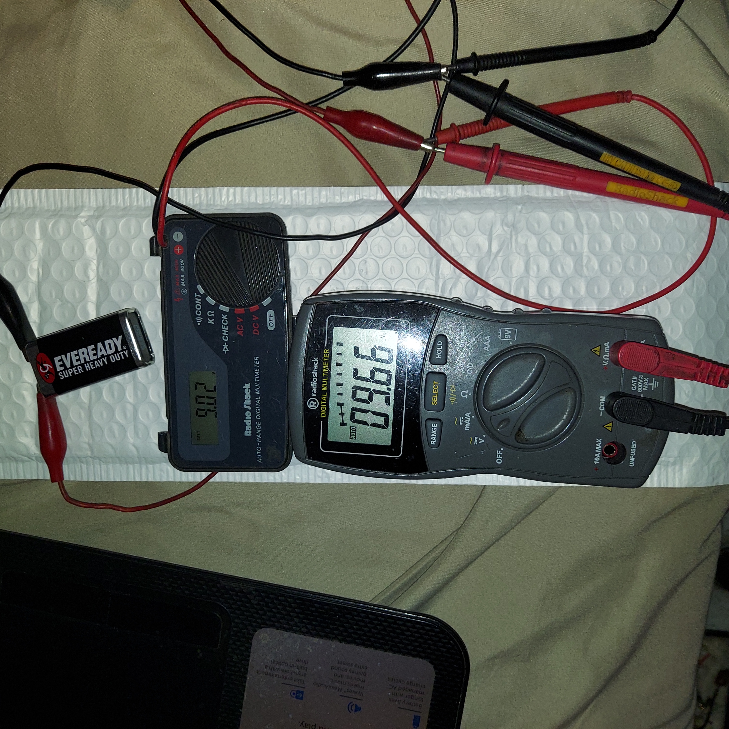

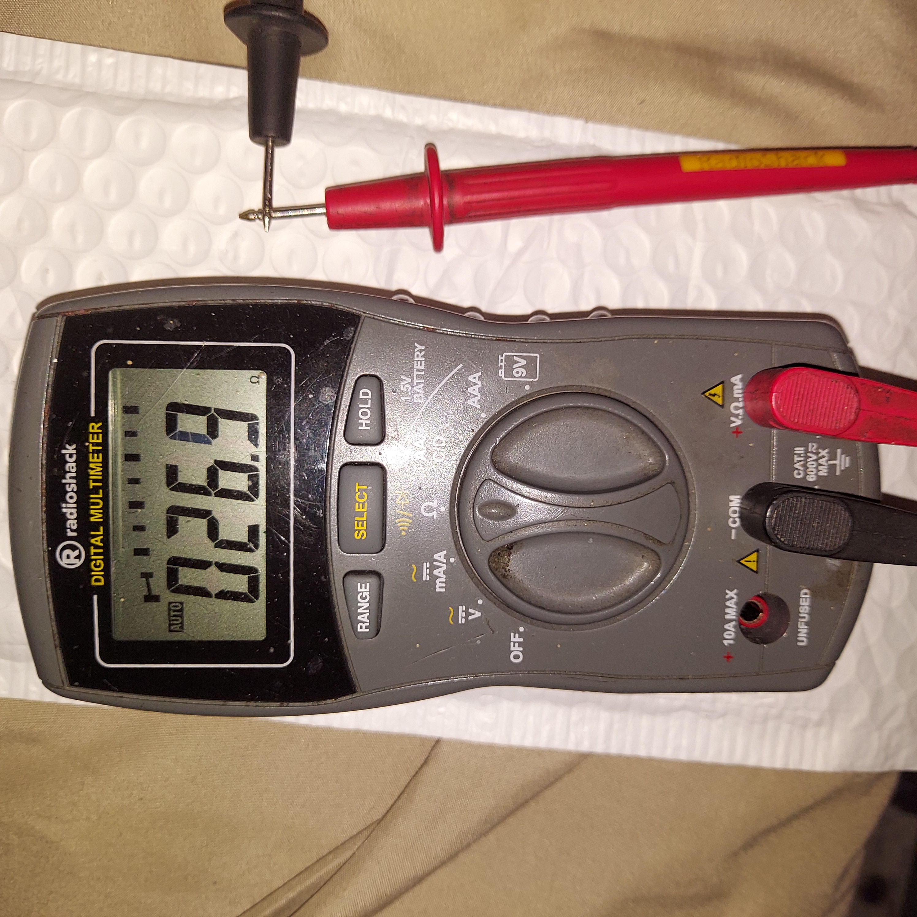

          I have included photos of the main board and some tests using a known good meter and it isn't good.

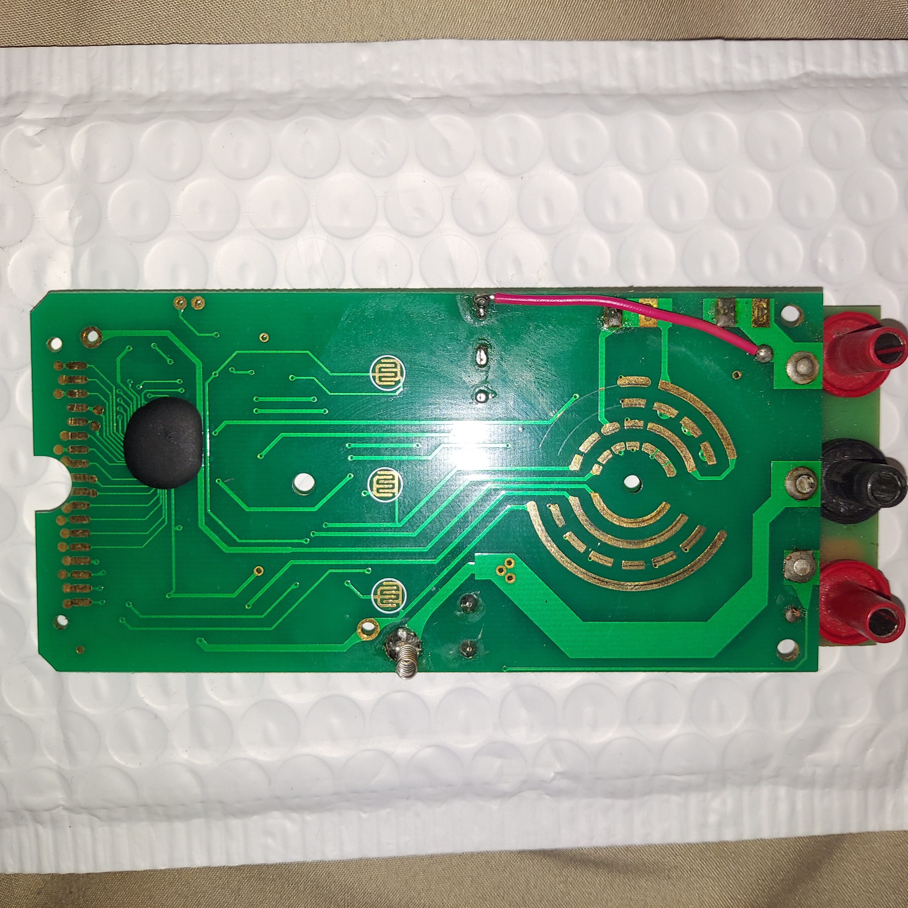

            Adding complete picture of main board component side.

              When you have an offset like that with the probes shorted, I would try the simple things first.
              1. Try a fresh batteries first. Some meters give incorrect readings before they show a low battery indicator (if they even have one).
              2. Give the entire PCB a good IPA clean with a clean toothbrush and let it dry overnight. Any unseen dirt, debris to the naked eye can affect the readings and give non zero ohms readings when the probes are shorted.

                Strange it has only one switch position for the mA/A function, so the shunt R14 is very likely 1R. 99R is typically used for a uA function.
                RAA1, RAA2 give 10R but there's no switch position to use them? some of the resistors appear to be loads for the battery test function.
                It looks like earlier Dream Tech Taiwan DMM IC used and a COB LCD driver.
                DTL02001 but I could not find a datasheet. Very similar to the ubiquitous DTM0660L. The multimeter's right part number is Radio Shack 22-813 similar to 22-812 etc.
                I would check voltage regulator U3 is 3.0-3.6V output across C7. You should get half its voltage between BATT(-) and input jack COM.
                The voltage reference is across C2 and I believe 1.2V
                Maybe measure these in the DCV function to see if the IC has hope.

                  It could be the picture it self but I see some soldering joints that do not look very good I would check each and every soldering joint under a magnifying glass and reflow anything that does not look good
