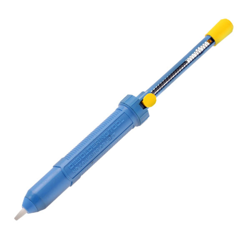

    how to clean manual solder suction that becomes sluggish tin mixed with extra flux have tried with alcohol but it is not enough any tip

          pull out the piston and put silicone based grease on the rubber o-ring(s)
          also, put some on the inside of the barrel.

            Yes, for the handheld solder suckers e.g. Edsyn Soldapullt like pic we used to clean them, and then lube them up with Lubriplate and the suction got much better. It was a weekly routine in the repair shop. That is a light petroleum grease.
            The smaller metal tube solder suckers never performed any good, they are crap. If they don't have poor tolerances and sloppy piston seal, they have a wimp spring and it's just a waste of time.

              That's exactly what I do. Works like a charm every time.

                Yeah, you have to take them apart, it's a messy process. Do it in a pan or on cardboard or something.
