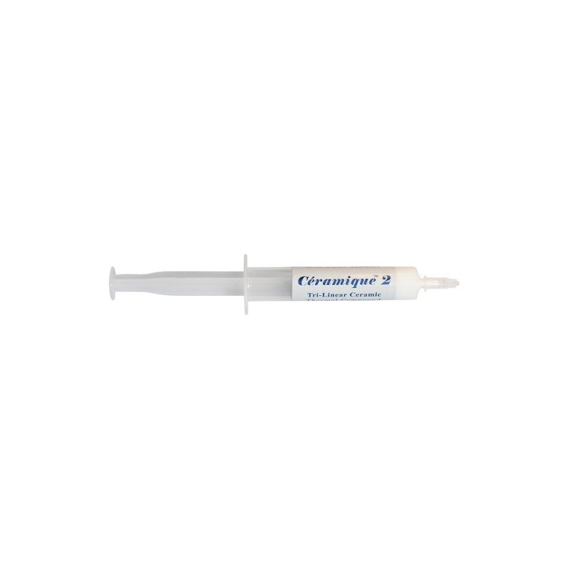

        Arctic Silver Ceramique 2

          No silver. They discontinued Ceramique 1, and here we have 2. More zinc oxide, some aluminum oxide and boron nitride. Same as usual ingredients, different proportions.
          Arctic Silver Inc. is using Polyol Ester as a base, somer Polyether Glycol to make it fluid.​

                      Céramique 2 does not contain any metal or other electrically conductive materials. It is a pure electrical insulator, neither electrically conductive nor capacitive.
                        25-gram syringe. (Approximately 9.2cc)
                        At a layer 0.003" thick, one syringe will cover about 200 square inches.​
