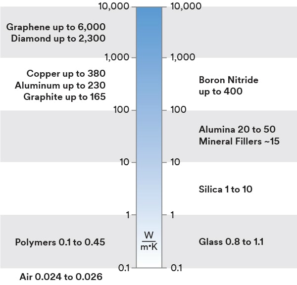

                                Look at the ingredients, I find the base is also important for the stuff drying out. Most (electronics) thermal compounds are zinc oxide in silicone oil like:
                                MG Chemicals 860 Silicon Heat Transfer Compound
                                70% Zinc Oxide
                                3% Silica Powder
                                Base silicone oil?
                                Thermal Grizzly Kryonaut
                                65% Aluminum Powder
                                25% Zinc Oxide
                                10% Silicones
                                Non-silicone, like older Arctic Silver just ages like a paste clay, I'm not impressed with how long it lasts. 3 years is Noctua's spec.
                                Arctic Silver 5
                                ?% Silver
                                5% Boron Nitride (aka white graphite, a ceramic powder, 3M comparison chart
                                30-40% Zinc Oxide
                                5% Aluminum Oxide
                                Base DiPhenylamine as "Synthetic polymer" Polyol Ester
                                Noctua NT-H1
                                60-80% Aluminum Powder
                                15-20% Zinc Oxide
                                Synthetic Oil Base
                                Coolermaster HTK-002-U1
                                30% Aluminum Oxide
                                20% Zinc Oxide
                                14% Silicon dioxide
                                3% Titanium Dioxide
                                1.2% Calcium carbonate
                                3% Magnesium Oxide
                                Base steric acid, palmitic acid
                                • eccerr0r
                                  Solder Sloth
                                  • Nov 2012
                                  • 8703
                                  #36
                                  Re: cheap but good thermal paste?
                                  hmm... interesting. I'd expect aluminum powder to oxidize quickly and therefore become aluminum oxide.
                                  How does MG Chemicals 860 work for most people anyway? I suspect my "white" heatsink compound is the same or at least similar to this...
                                  And there's also the oddity that zinc oxide's thermal conductivity is higher than of aluminum oxide... so somehow it must be the aluminum that's conducting heat. The trick is to prevent the aluminum from oxidizing.
                                  • redwire
                                    • Dec 2010
                                    • 3912
                                    #37
                                    MG860 is the old familiar silicone thermal grease, lowest performance because it's only zinc oxide I guess. MG Thermal grease flyer shows aluminum oxide is much better, get over twice the heat transfer with MG 8616.
                                    Aluminum doesn't oxidize inside the grease (that keeps air out?) and it might be aluminum hydroxide particles already. It's something to do with the shape of the particles, spherical forms a longer path compared to anisotropic like boron nitride.
                                    MG860 rated 0.66 W/m·K
                                    MG8616 rated 1.8 W/m·K
                                    Berquist TGR4000 4 W/m·K
                                    Arctic Silver 5 rated 8.5 W/m·K (1-mil thick layer)
                                    Thermal Grizzly rated 12.5 W/m·K
                                    Noctua says the ratings are usually fake so they don't give any numbers for (Watts per meter-Kelvin).
                                    standard ASTM test is with glass balls as a spacer.
                                    I think for low cost, it's added aluminum to the zinc oxide. Copper is very good apparently but expensive and compatibility with metals on the heatsink/CPU is an issue.
                                    Not sure why silicone vs polymer base is an issue, both seem to dry out.
                                    • eccerr0r
                                      Solder Sloth
                                      • Nov 2012
                                      • 8703
                                      #38
                                      pure ZnO should be around 60 W/(m°K). Pure Al2O3 is closer to 45ish and I think it's probably silly to use it. But yes it depends on the particle shapes, and the grease itself is probably the limiting factor - unfortunately it's needed else it wouldn't be spreadable.
                                      Anyway it does look like it's probably the aluminum. I'm surprised graphite is not used. I guess I'm pretty convinced that gray > white at least for now, until I see some more consistently crappy samples.
