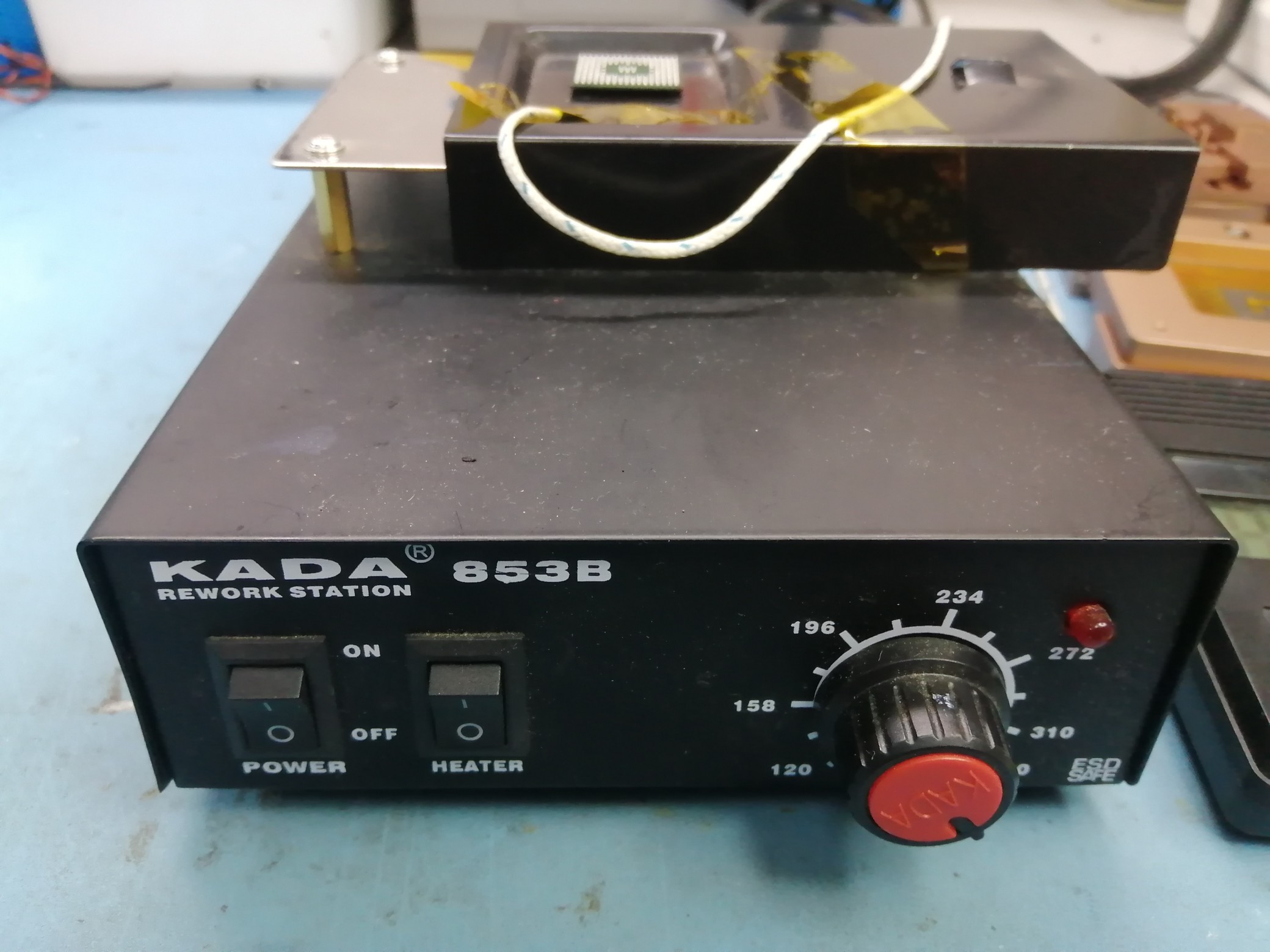

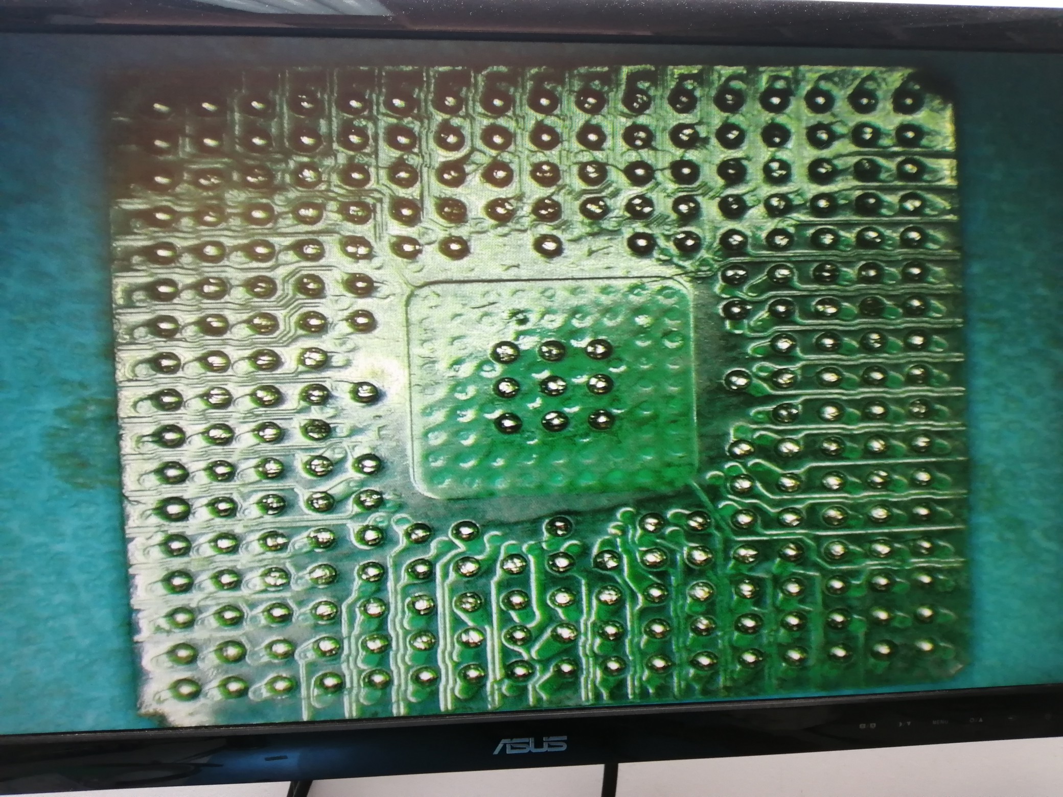

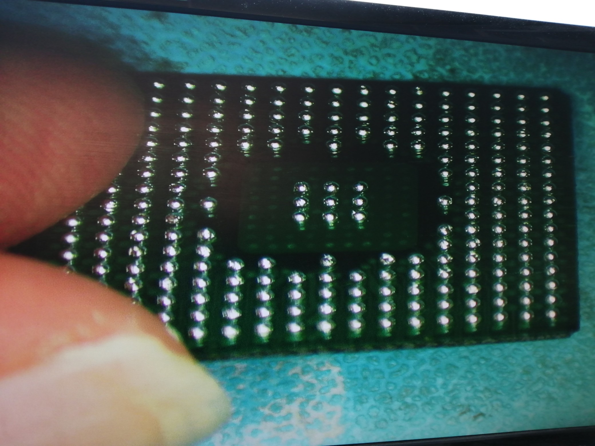

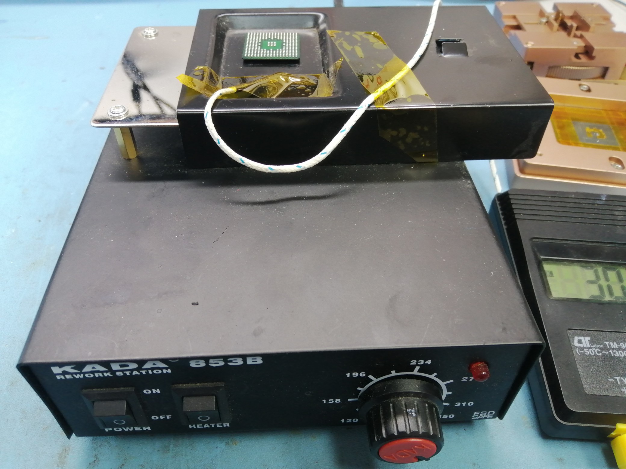

              I did it
              I used the indirect heat stencil and jig.
              I used the Kada 853B and NC-559-ASM flux applied with a small paint brush
              I used the base off an old el cheapo soldering iron stand, with the springy soldering iron holder removed, and it just fitted exactly over the KADA hot air plate with about 2mm spare each side. I used the little indent where the sponge should go as a tray for my BGA.
              Even with the KADA on the highest setting, I couldn't get the thermocouple to read over 182C, but I noticed around that point all the balls seemed to have aligned fully on the pads and were looking shiny, so I turned off the heater and left the fan running to cool it down - and found that the BGA was reballed.
              Possibly the thermal mass of the soldering iron base was too high for the heater to get it any hotter or maybe it was because the thermocouple was not on the hottest part directly above the hot air. It's possible these are 0.76mm 60:40 lead balls as 183 is the melting point for leaded solder
              Anyway - regardless - I had success the first time round... this time round.... LoL. It's not the biggest BGA in the world but I feel pretty good about it.

                      Out of interest (or anyone else trying this) I think the reason that balancing a metal sheet on top of the hot air pre-heater failed when I tried it before (the balls moved and some joined together) was because I used a very thin piece of metal which was the top from some RF section of an old PCB I was stripping down. This was like very thin tin or something.
                      And I think with such a light piece of metal the vibration from the pre-heater was moving the solder balls. This time I used something fairly hefty, and possibly the pre-heater struggled a little bit with the thermal mass but it definitely worked.
                      Anyway that's my best guess on it - FWIW
                      Rich

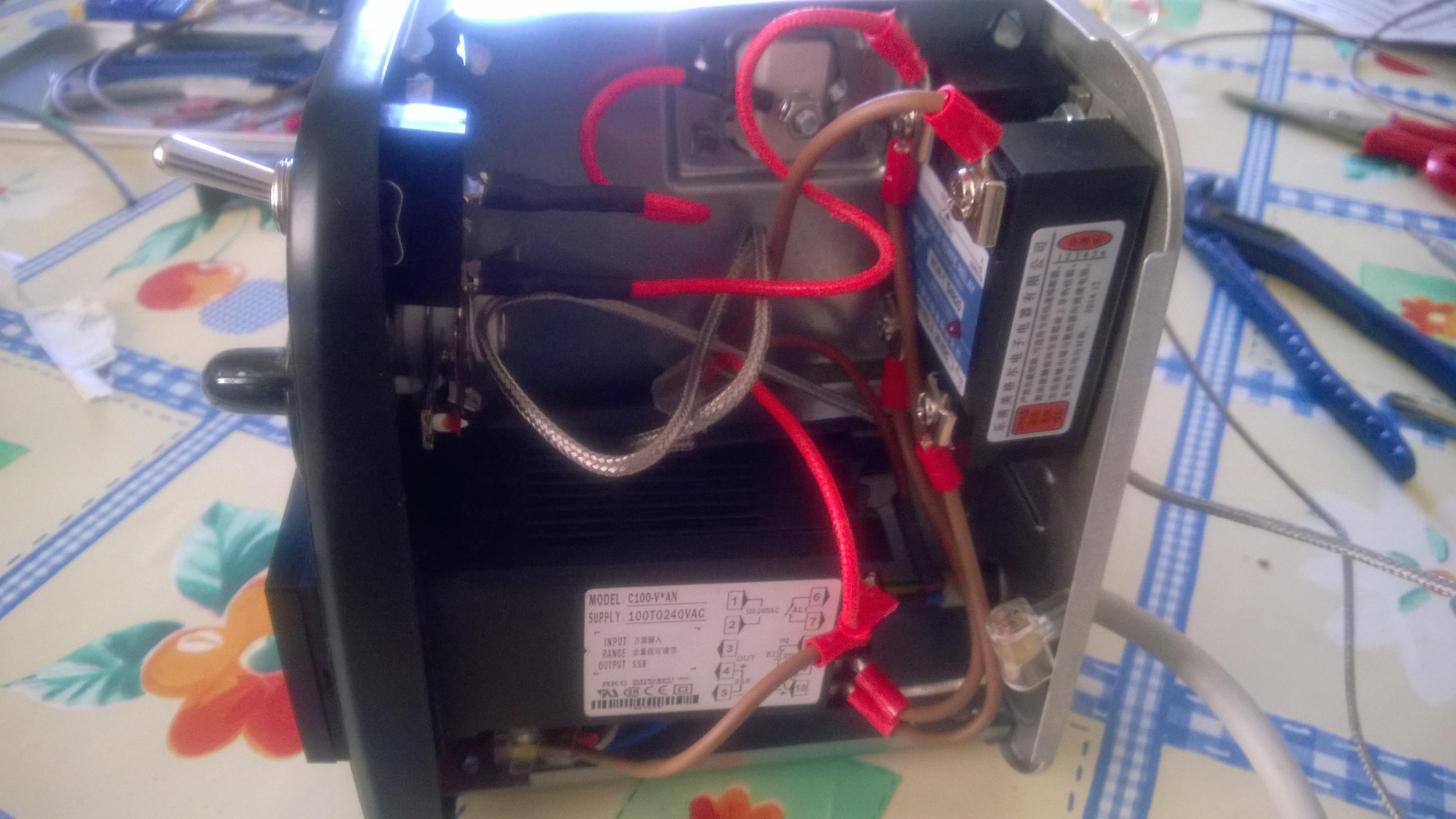

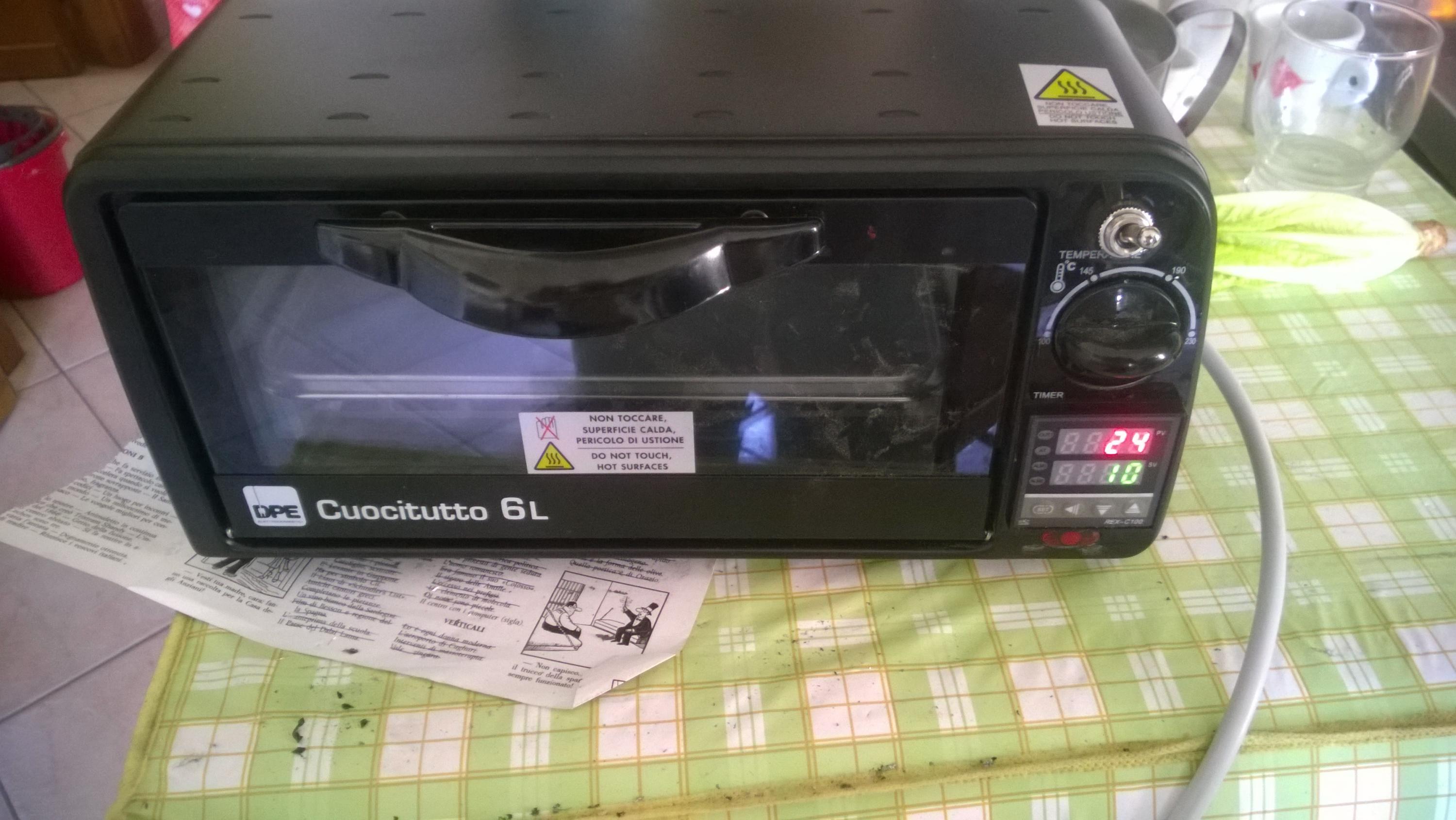

                          if u are not satisfied with hot air, u can make a homemade reballing station using cooking hooven modified witl a pc100 rex controller.
