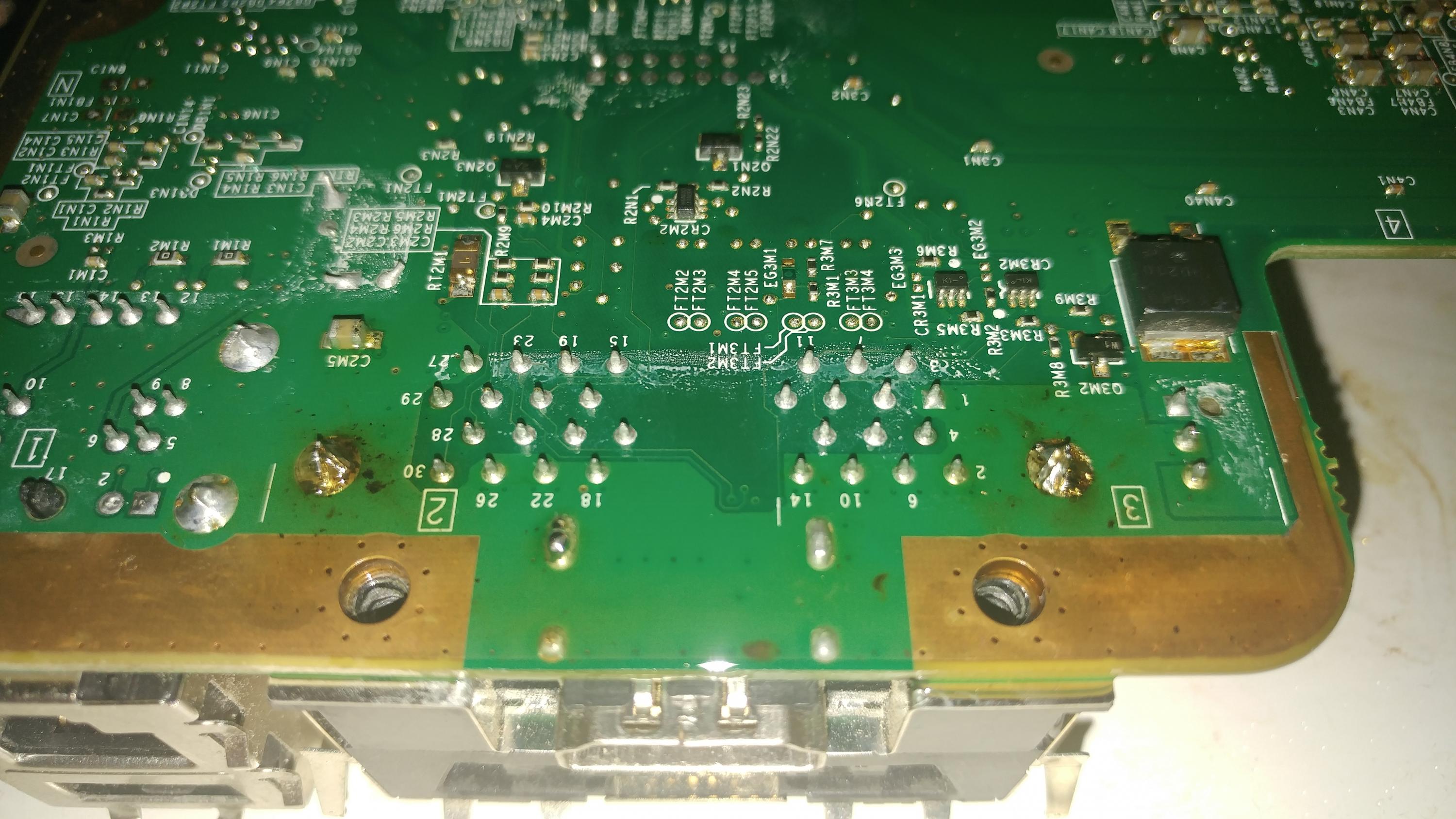

Beginner, practicing to unsolder on a lead free xbox 360 board, it is hell.
  • Eh546
    • May 2020
    • 17
    Don't hesitate to tell me what i do wrong and if you have any tips and tricks, because i want to learn and improve.
    I have a 60w iron that can go up to 450c, cone tip, i usually set it at 400. I applied flux on solder, tinning the tip then applying new lead solder to the joint so that it can mix with the lead free and lower the melting point, then i tried to suck up the melted solder with the solder sucker. But that didn't work since the lead solder doesn't seems to mix with the lead free one. I also tried applying flux to a wick and the board, then tinning the tip of the iron and trying to remove the solder, it also doesn't work because the lead free solder doesn't get sucked into the wick, only the lead one does.
    Here's what the solders looks like after trying the methods above.

    Re: Beginner, practicing to unsolder on a lead free xbox 360 board, it is hell.
    1: your soldering iron is too hot - set for 300(lead solder) or 350(lead-free).
    2: to make wick work better add flux to it - the powder in it is crap.
    if your iron is too hot you just burn the flux and nothing will solder at all.
      That's a job for a hot air station not a 60W iron with a cone tip.
        Cone tips are pretty much useless for these kind of work. What you want is a chisel tip.
        The part you are trying to desolder is on a big ground plane which sucks and dissipates the heat faster and therefore the solder (unleaded) cannot reach melting temperature. This explains "But that didn't work since the lead solder doesn't seems to mix with the lead free one."
        You need to preheat the board first (using hot air) and then try to desolder. It is important that you preheat the area of interest as well as surrounding components to prevent warping the board. (Also do not spot heat, rather heat in a circular motion)
          I see, no wonder why it's so difficult, i'll just use a heat gun for that board.

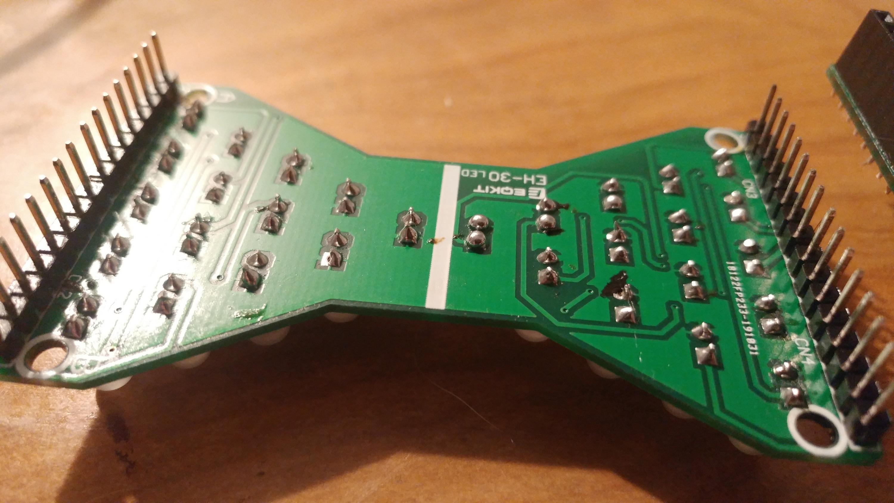

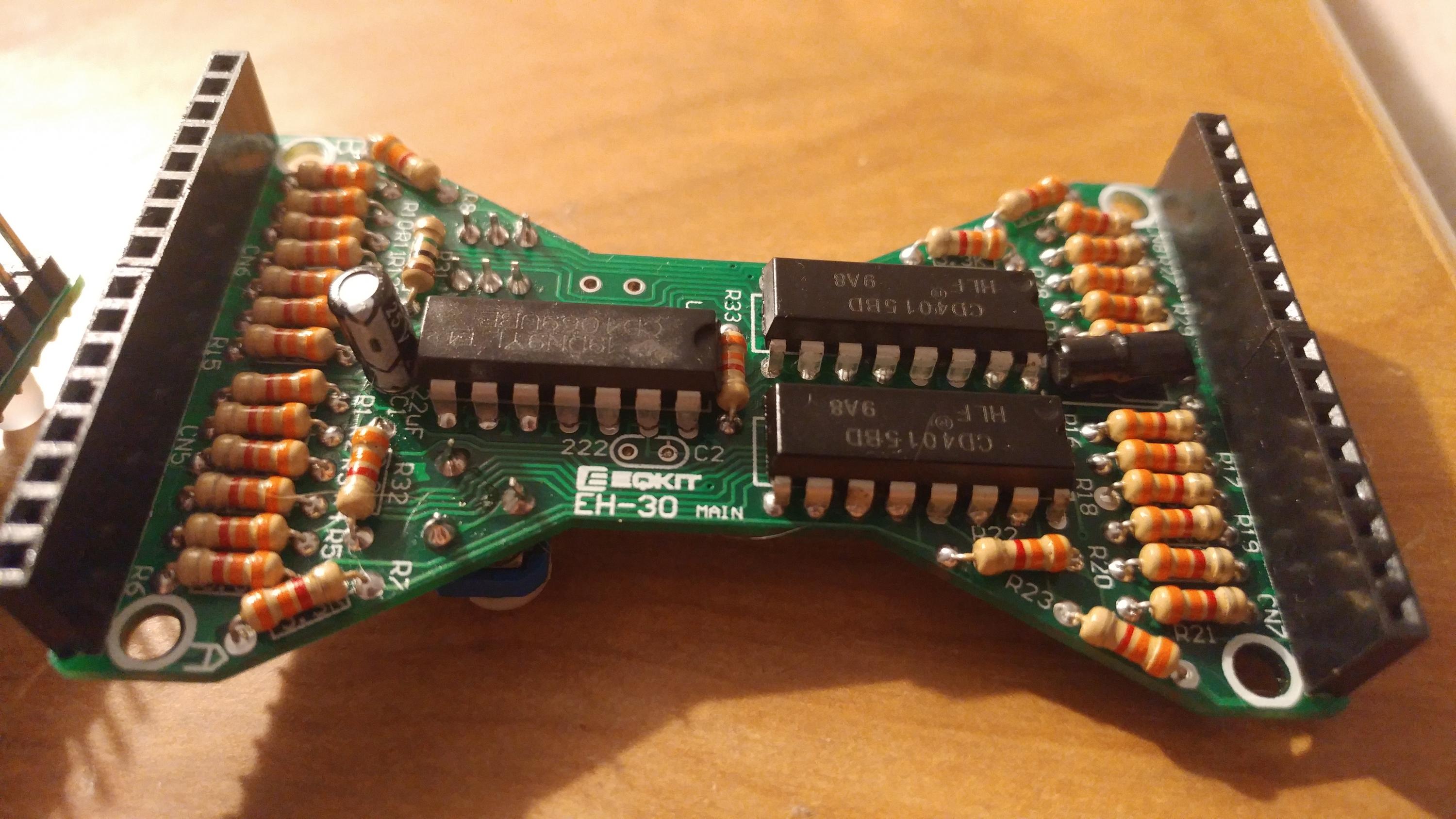

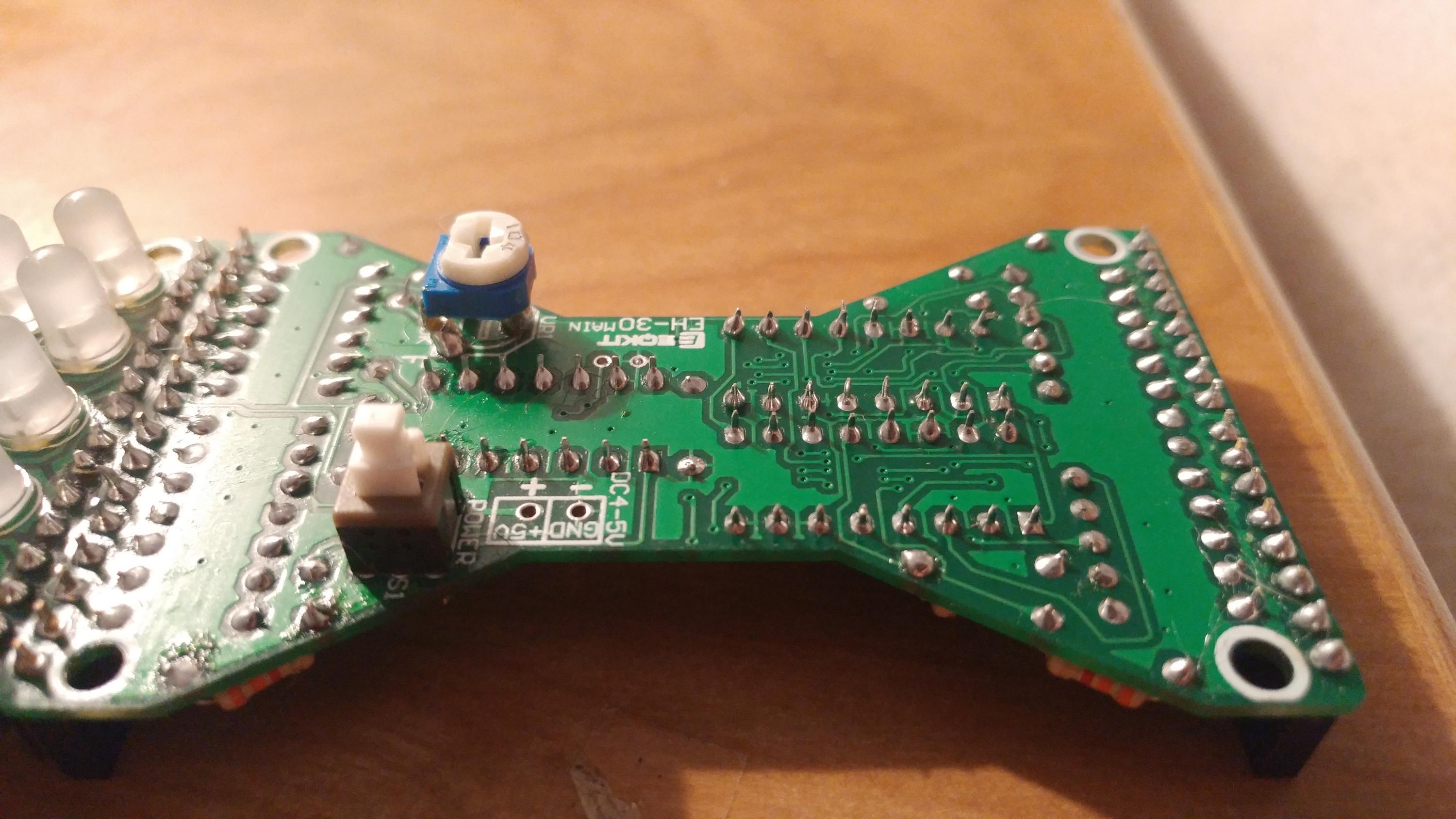

                                  So here's some pic of the diy kit i practiced on, far left ones on the first are very ugly because i thought i needed to bend the leads way apart for the components to hold on to the board.
                                  I'm also missing a 2.2nf 50v ceramic radial capacitor from the kit that go in C2, i'll probably order from aliexpress or digikey.
