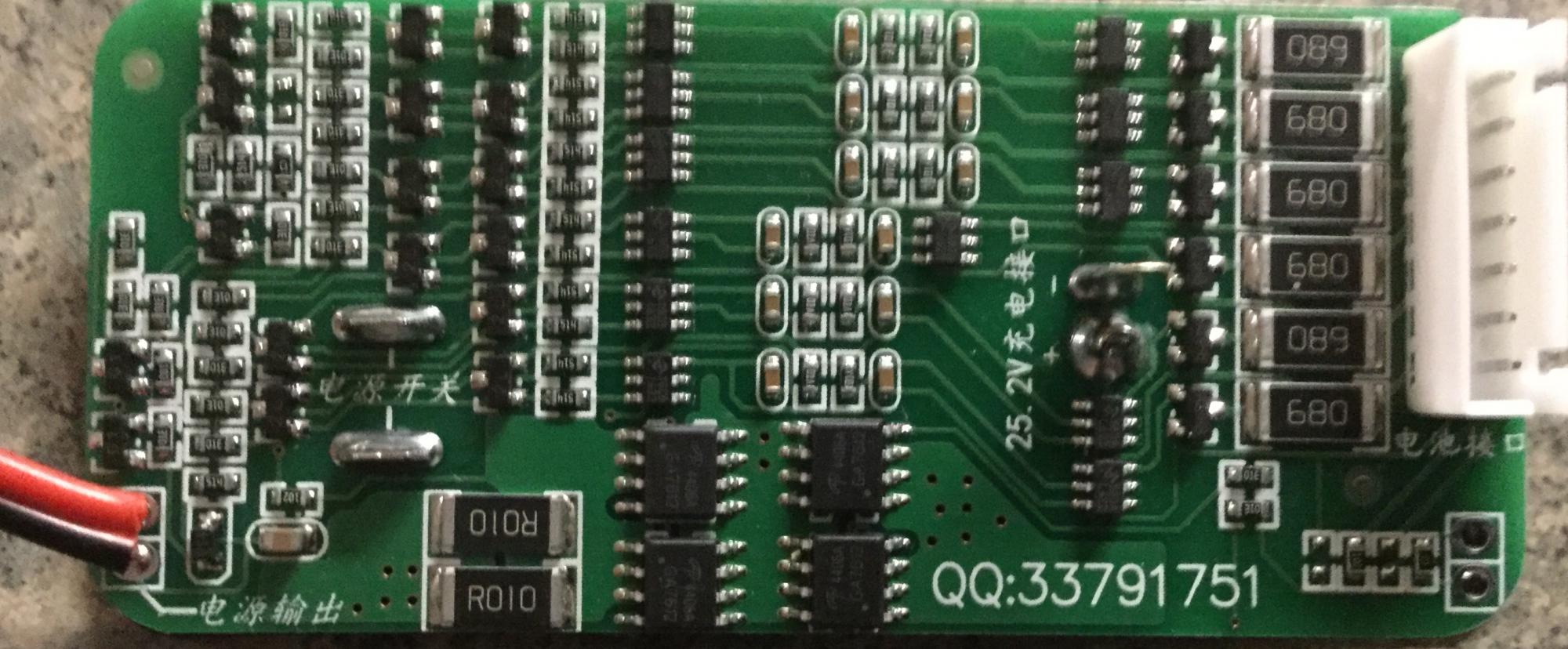

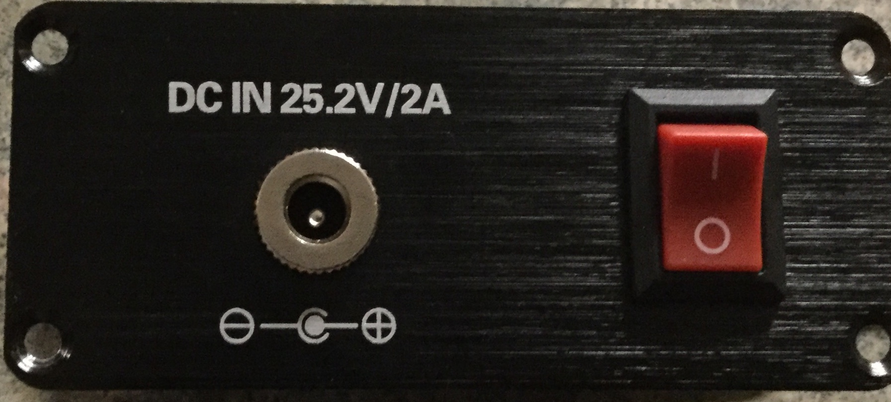

    This BMS board has promise it made like most BMS battery board I seen before but this one is made to use the power supply input jack and the power supply supply switch
    The first dispointment is the batteries that are used are no brand name batteries they claim 2 amp hour maybe this might be the case but I have not done a battery charge and discharge cycle yet so I can not comment on this yet so we will see if this claim is true or not
    But I going to use the Samsung battery out of a Kobalt battery from Lowe’s for $20.00
    The charger that comes with it says 2 amps @ 25.2 volts we will see what is inside this switching power supply and let you know if it worth a shit or not

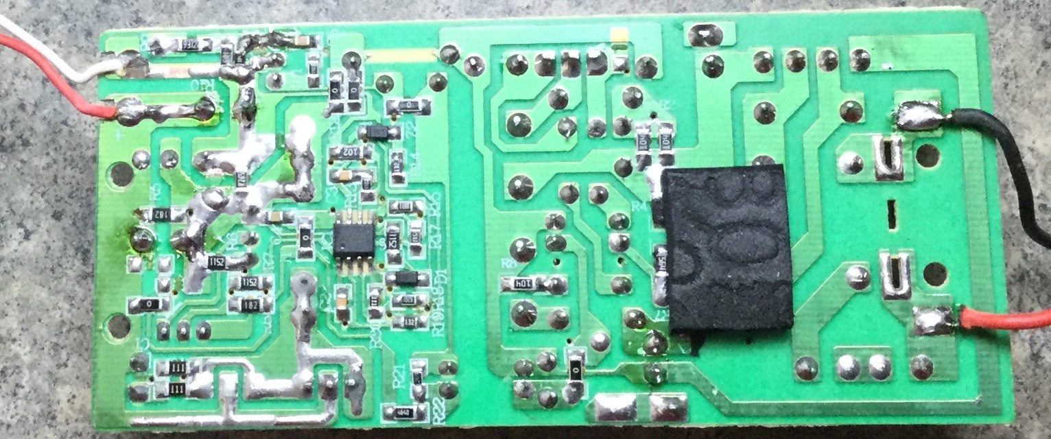

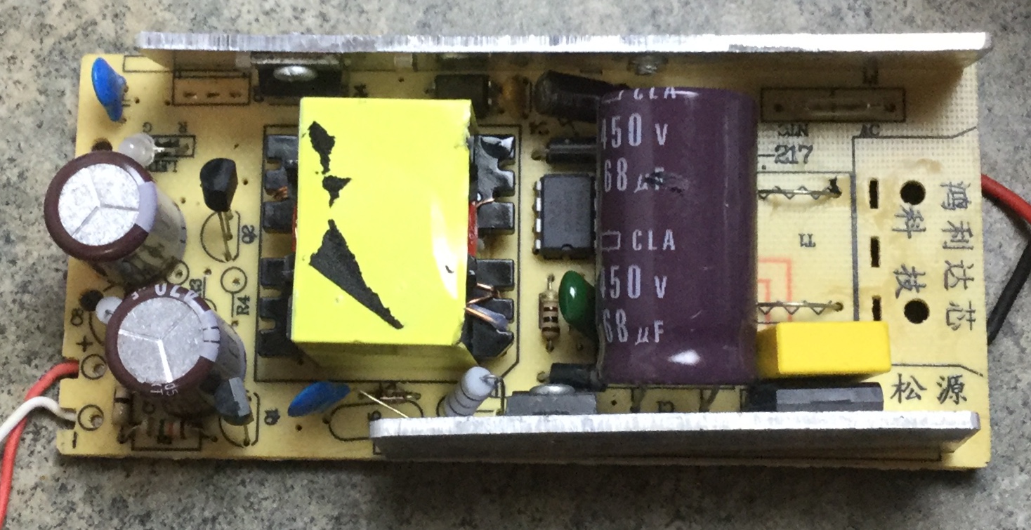

          Here are some pictures of the switching power supply board
          I have some comments about this charging board the first thing is that the temperature of the case does not any warmer than 102*F which I like
          The other thing is that the battery pack for soldering station battery voltage was at 24 volts on the soldering station controller which very close to my Radio Shack meter that I use all the time the charger brought the battery voltage to 25.3 volts and stop charging very good results
          What do you think about this charging board

            Re: KSGER New Battery BMS Version Review
            It looks like six of a single cell charge controller/balancer circuits.
            At least the form-factor is better to fit inside an enclosure.
            I don't like the small chinese copy JST connector because they're crap and not rated for high currents or fatter wire. I would expect it to give problems.

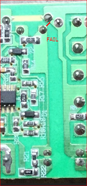

              I would say the PSU has good bad and ugly.
              Good - heatsinks and lots of electronics, the board looks like a modified LED or laptop design.
              Missing common-mode choke for EMC and PTC for inrush current.
              Fail - primary to secondary spacings. The PCB board is a bad design for clearance, so ensure the DC output is earth-grounded for safety.
              I would say it's OK, medium quality.

                Thank you for your comments about this charger I will not leave plugged in when not charging batteries and will keep an eye on it when using it
                The component is a switching device and a power resistor and a diode of some type and a cap between the primary and secondary of the switching power supply board

                                  • Jul 2011
                                  • 6064
                                  Well I have an update
                                  I hook up the BMS protection board and it charged batteries up evenly but the balancing resistors became very warm to the touch which is not unusual for this type of board
                                  But I have use it a few times to see how well it keeps the batteries balanced so we shall see what the results are later
