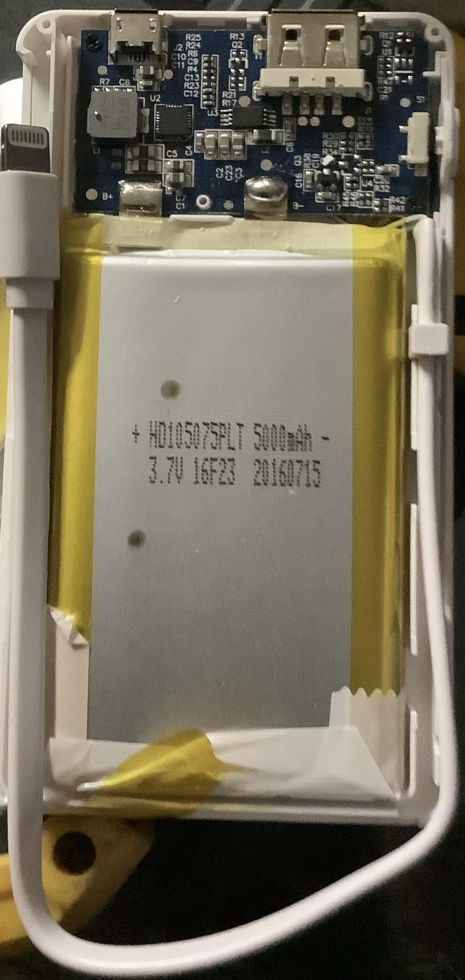

    Well I have had some time to put this battery pack together today and I am about half way done with tabbing the battery cells together
    About 2 years ago I bought some battery power banks that were made with the lighting cable built in but the battery is only a 5 amp hour pouch battery cell and drain very quickly if your phone or tablet is down to 20% of charge left
    So I figured out how to put a longer lighting cable on it and put it on a battery power bank that I made for some other phones and tablets that do not have the lighting cable built in and the running time was a lot better but it still runs down the battery pack quickly but what I am building is a 1S27P battery pack and let's see how fast this one down the the battery pack
    I will post some pictures when I have it together maybe tomorrow sometime

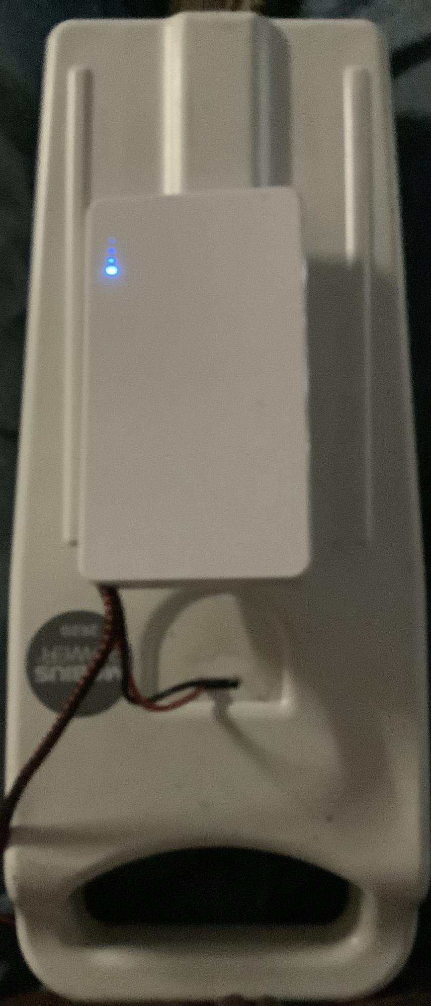

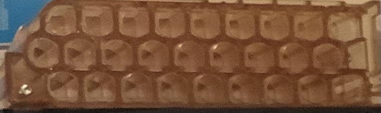

          Re: DIY IPhone and IPad battery power bank with batteries from Battery Hookup and sup
          Well I have used this battery pack for charging one of my tablet and still has power to keep charging the tablet battery even with only one led light on the fuel gauge
          Very impressed with the results of this battery pack with this battery charger made for this iPad

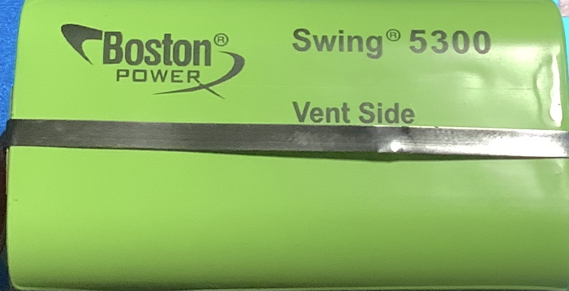

          The first picture is battery pack enclosure and the last picture is the battery cells holder enclosure the second picture is of the battery charger controller board the way that it is before I modify it to work correctly in this battery pack case
          I going to make several more of these battery packs with this enclosures that I have
          Once the battery pack is completely discharged I will put on the usb battery tester that uses the same software that is used for the battery testing machine and I will post the results of these tests
          One note these battery packs that have the lighting cable on it was sold at Walmart but are no longer available for sale as far as I know I have not seen them anymore but I bought a bunch of them when they were being clearance out but did not have a project in mind when I originally bought them
          The output of this battery pack that has the lighting cable on it put out a little more than 2 amps which is unusual for battery pack to output this amperage to charge an iPad one nice thing about this charger controller is it only get slightly warm to the touch when putting out this amperage which is very nice

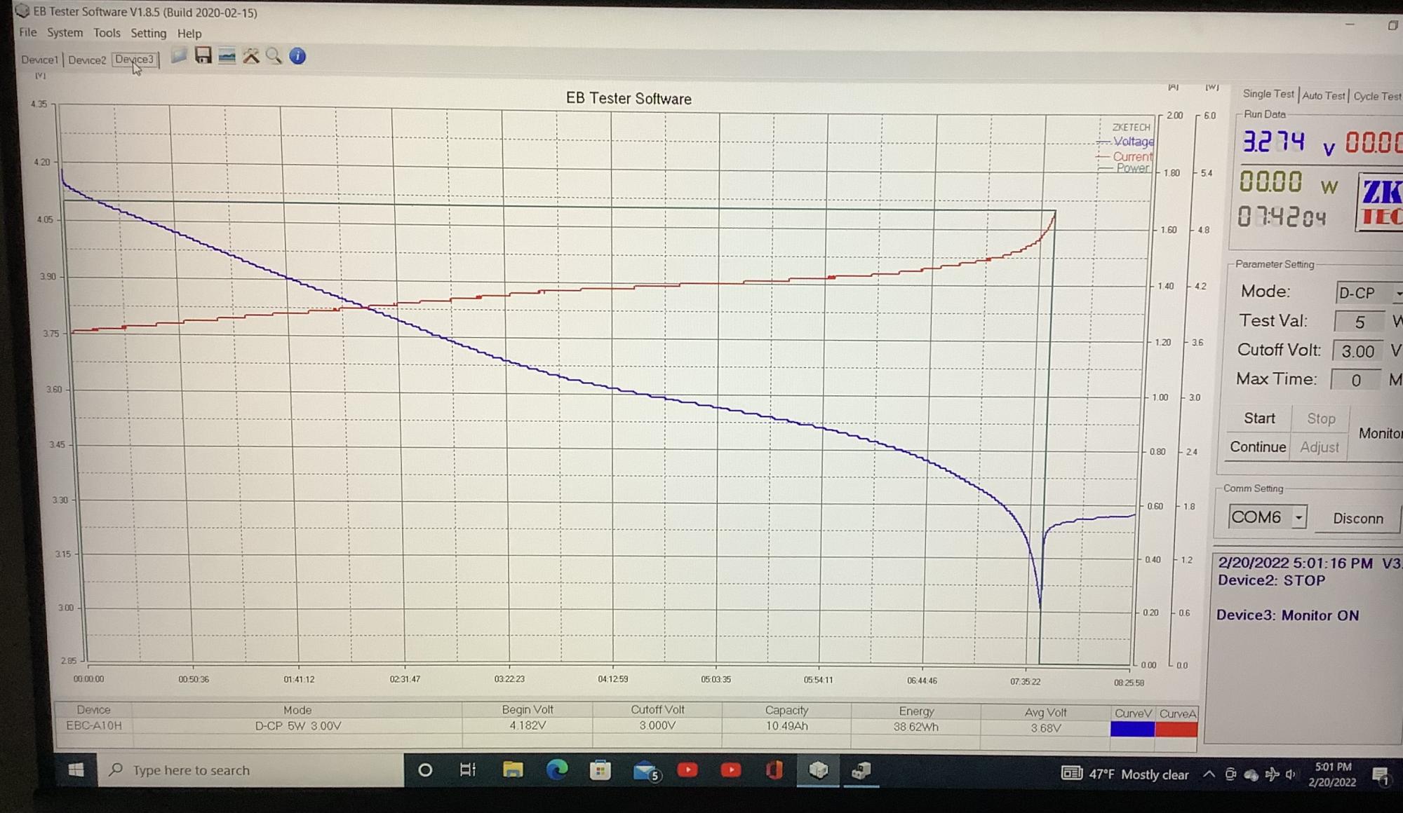

              Well this battery pack still has one LED light still on and has not died yet
              Which when it does I have to put it on the battery tester and measure just how many amp hours this battery pack has
              On another note I just found out that the battery tester that I have been using has a function that I really did not understand correctly how it works but I used this setting today and found out DCP is for if you want to measure the a contentious watt on the load
              For example let say that you want to put a 5 watt load on your battery
              Well at 4.2 volts it started at 1.20 amp but as the voltage goes down the current goes up as high as 1.660 amp
              I might have to post this repair in the ghetto post on this forum but it works and I need a longer cable for the EBC-B20H tester that is so much longer than the other battery testing machines that I have and the cord was just as tight that is how it broke because I had to get to the back of the computer to change the wires less mouse that stopped working
              So this battery pack has a little bit over 38.6 watt hours which I think is more accurate than when you use the DCC that I normally use for getting amp hours rating
              Because most battery packs that are made for charging phones and tablets are rated by watt hours then amp hours
              The battery in the picture is where the testing results came from this battery was made in Taiwan and was bought from Battery Hookup recently I just got around to testing one yesterday and today
              I also bought some of same batteries that were made in China and the test results were very similar in amp hours so the quality seems to very similar
              So from now on I going to run both tests when I want to know what the battery packs that I am building for charging phones and tablets can really do

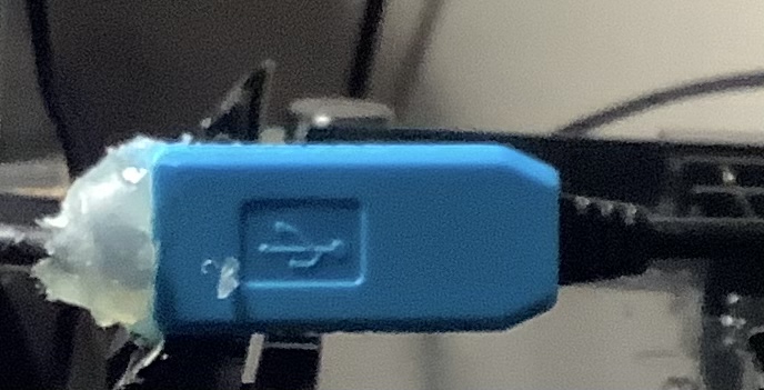

              On one more note I had an issue with the USB TTL controller the USB female connectors are shit they have no plastic backing so after you unplug then plug it in a few times it works when it wants to well I fix this issue as well

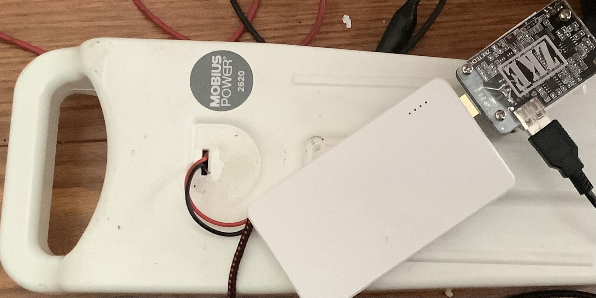

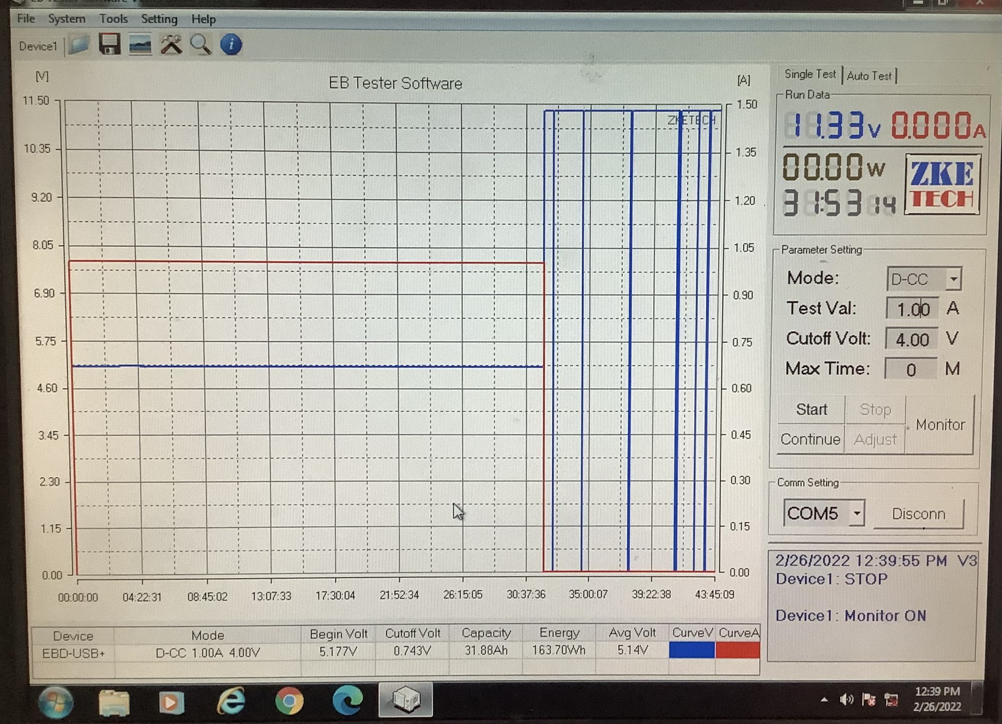

                  Well I had some issues with this usb battery tester it has a tendency ( but it not predictable when this happens ) to time out and when you hit continue it sometimes it recalibrate the controller and error out ( but does not give you any error messages ) and you can not trust the data that you see
                  It was showing 48 amp hours but I not exactly sure that this was correct the graph was like it just continued but the hours were way off so I can not trust the results
                    • Jul 2011
                    • 6070
                    Well I finally got some believe able data results and they are not as good I would like them to be
                    I did get 32 hours of running time with a one amp load which is not to bad I guess

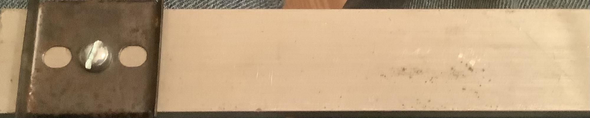

                          Originally posted by eccerr0r
                          Really should re-cell my Atom laptop battery pack but couldn't figure out how to crack the plastic case without destroying it.
                          This is what I use to open plastic case with
                          Anvil
                          2-1/2 in. 4 Edge Scraper Blade (2-Pack) <— you can get this item from Home Depot
                          I have gone to DuckDuckGo so I will be limiting the direct website links in the future
                          This is the tool that I made with the scraper blade to open plastic case and it works very good the bar is a aluminum bar that I got from a machine shop that I know the owner which was left over from a customer order that was completely done with and was scrap the threads were made in the aluminum bar to hold the the scraper blade to the bar

                                    Now I have design this battery pack to be within this limitation of this charging controller
                                    This is the reason I have pointed out in another post that I am modify
                                    [ this is to be able to monitor the amperage going into the battery under charge ]
                                    ( I can monitor the voltage right now with out modify the battery testing machine )
                                    { this to compare the amp hours of the boost converter and the charging controller effectively easily }
                                    one of my battery testing machine to be able to see the limitations of charging controller that I plan on using in the future
                                    One note on a comment that I made earlier about
                                    “ The reason I know this is I did a test where I ran the other battery tester on it and keep the charging controller on it and the battery voltage is at 3.67 which would make at about 50% remaining but all 4 fuel gauge lights are on it is not measuring the battery voltage it counting wattage that is going through it current sensor ”
                                    It turns out that if you put a load on the charging controller it then reacts to the voltage of the battery to recalibrate the fuel gauge results ( but this is crap that it is designed this way )
