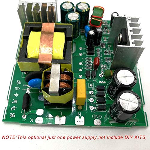

      Here's the schematic I drew of the KSGER soldering station 24V PSU for service and repair.
      Soldering Power V2.04 and pig with bull horns icon on the silkscreen.
      KSGER 96W 24V 5A Electric Power Supply Unit For STM32 STC OLED T12 Digital DIY Soldering Station Controller.
      It has some clearance mistakes running +HV trace underneath heatsink and a thin PE ground trace, no connection to the chassis
      The TL431 is set to over 25VDC output and it has no bias resistor. The snubber cap is pretty cheap. Could not find datasheets on the CR8642S PWM controller.
      Earlier version PSU's like V2.01, V2.02, V2.03 are the same but no pads for a mystery DPAK part or different DC connector.

        are the heatsinks insulated? the semi's are.
        it's a good design - caps well away from the sinks - unlike japanese shit i used to fix.

          Semi's are isolated TO-220 parts (fullpack), but the heatsink mounting pin pads have very little clearance to the fills. So the path is PCB trace->heatsink->mounting pads-> nearby pours.
          I'll put Kapton tape over the two traces if I can fit that in.
          The older version 24VDC PSU (left) is apparently not very good. Primary capacitors are low value 2x22uF, 1A diodes instead of 8A bridge, no 3A fuse but a 1R resistor in heatshrink. The Schottky rectifier runs 112C at steady 3A. Quicko sells them too.
          But it has to put out 3A for short periods.

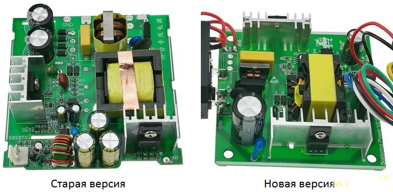

                Which of one of photos is a good quality one let see if the one I have is a good one or I should use the medical grade switching power supply that I just bought and change the low voltage power cord on
                • redwire
                  • Dec 2010
                  • 3900
                  Re: KSGER STM32 T12 soldering stations
                  Left is the lower quality one, right is the better quality one.
                  Before I was mentioning the right better quality one that had a few weaknesses.

                        I have the version the one on the right side of the photo
                        • redwire
                          • Dec 2010
                          • 3900
                          That's the better one, it's still pretty good for stuff out of china, with the usual couple of weak points.
                          I think most important is adding a PE ground wire from the IEC outlet to the chassis.

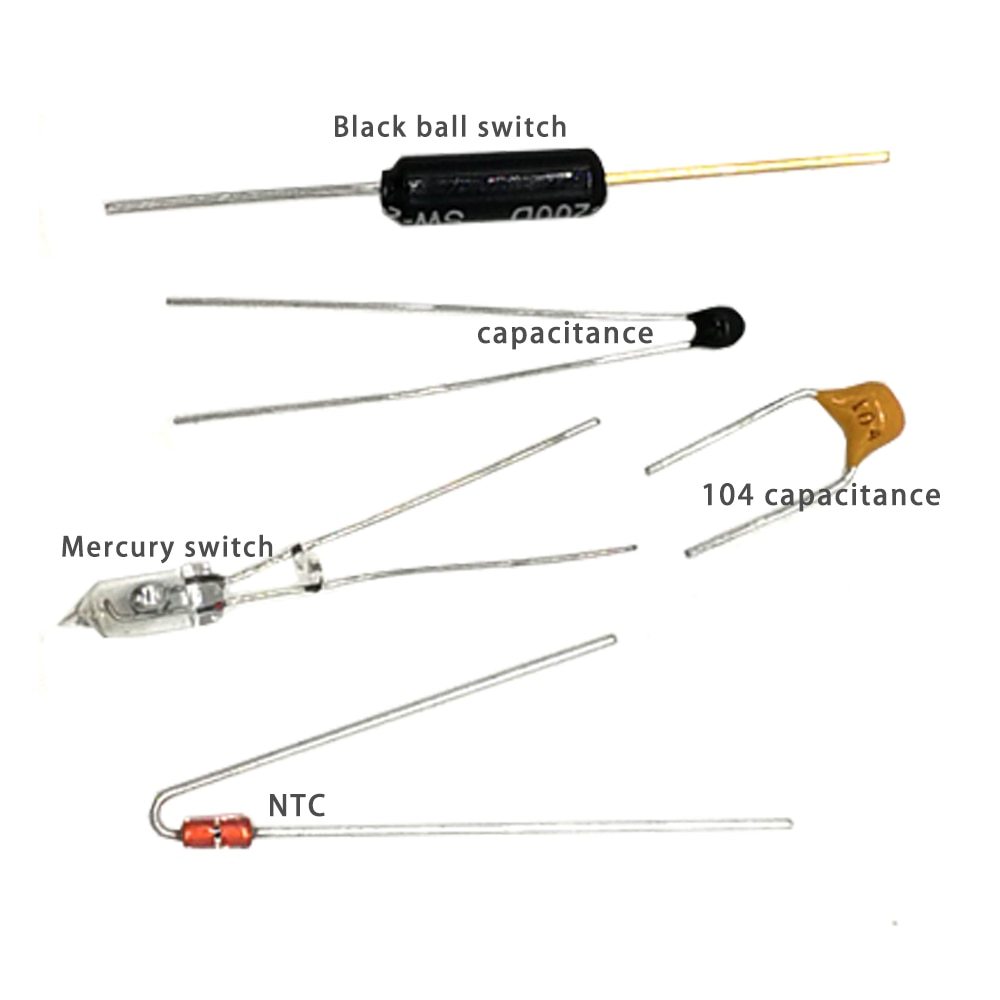

                              Anyone know the T12 handle components? They ship two NTC thermistors and two different motion switches, a ball shake switch and a mercury switch.
                              The black blob NTC I have only seen on a controller board and the glass MF58 part I used. The 0.1uF cap sometimes across the NTC, other times across the heater, the handle wiring is always different.

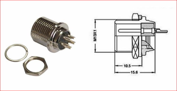

                              Impossible to desolder the GX12 connector, I had to trash it to get the board out.

                                Are you talking about the connector that the soldering iron connects to the controller board
                                Because I was able to remove the one on one of mine it was a little bit difficult but not impossible to do I had to more solder on the joints a couple times and then I was able to remove it
                                But come to think about I also think I had to use a temperature controlled hot air gun to help it along as well

                                  The GX12 has 1.6mm pins and the desoldering tools I have couldn't clear the holes. No tips fit over the pins close spacing. I thought hot air would melt everything around it like the JST power connector and capacitor, buzzer?
                                    When I remove that connector I use my Desoldiering Gun (ZD-917 ) and a temperature hot air gun and with this setup it still took some doing
                                    But if you have a hot air gun put a very small nose cone on air gun and point it away from the main controller board and go around in a circle until the solder melts and bang on the table to nock most of solder off it you might have to do a few times or when the solder melts pry up on the board until you clear the board

                                      When I pried, the pins slid right out of the GX12. They do not have collars (like in pic) to grab the epoxy, it's a cheap connector from KSGER.
