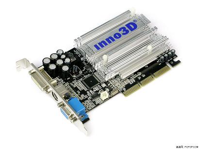

    Hi guys,
    Does anyone has experience in desoldering this kind of transistor in the centre?

                  Hi, the picture is for illustration purpose only. I have a faulty graphic card, there are 2 transistors side-by-side. I tested onboard, one of it seems to be shorted. After reading, there is so much investment to revive this really old graphic card, I feel not worth it. Maybe I will give it a miss. Thanks.

                      Hi, the picture is for illustration purpose only. I have a faulty graphic card, there are 2 transistors side-by-side. I tested on board, one of it seems to be shorted. After reading, there is so much investment to revive this really old graphic card, I feel not worth it. Maybe I will give it a miss. Thanks.
                      How about some info on what you are working on? A picture of the card and problem area, the model & type. Someone may have this same card and help.
                      On checking transistors in circuit- you really can't unless you know the surrounding components are not giving false readings.
                      I asked what makes you think this is bad. Card symptoms? No output? Incorrect display?

                        Hi, the soldering iron I owned now is only 30W. I will need to buy a new 80W soldering iron to practice desoldering the SMT. I also have a faulty P3 motherboard to practice on SMT once I get hold of the 80W soldering iron.
                        The graphic card is Inno3D FX5700, it does not have output. Had checked all the caps ESR, all are good.

                          Desolder the 2 legs of the suspected transistor for testing. Be VERY careful as it is easy to tear the board pads/traces where they attach. If it still shows shorted, then you likely have the correct component.
                          Did the fan on this card ever stop working perhaps causing the chip to overheat?
                          What did you use to check caps ESR?

                            I have tried desolder the 2 legs, it still shows shorted on my DMM. It is a passive heat sink, not fan type for this graphic card.
                            I used EVB ESR meter to test the caps.

                              Re: Help on desoldering transistor
                              gobbler
                              This your card? I found using Google images..

                                If you have already desoldered the legs off, just heat the metal tab/heatsink/metal plate of the transistor with your iron and pry it up with a small screwdriver. This should remove if off the PCB. At least that's how I did it with my limited experience for a few similar transistors without damaging the PCB.
                                Done with 60watt RadioShack iron by the way. Your 30 watt iron might work if it has a good tip (if not, add a little solder to the tip for a better heat transfer).

                                  lucky13, yes that the one.
                                  momaka, let me try with my 30W solder iron.

                                    Hi momaka, I managed to remove the SMT with my 30W solder iron. I used alot of solder and managed to remove it fairly easily. Now the problem is, my local stores does not sell this transistor, SDB60N03L. Maybe will KIV for awhile. Thanks.

                                      Hi Guys, I have got good news. I happened to have a faulty P3 mobo, it has 2 transistors CET CEB6030L. Specifications wise quite close to the SDB60N03L transistor. I desoldered it this time quite easily since I had experienced with the previous one. I soldered it on the Inno3D FX5700, it looks ugly though. Viola, the FX5700 is revived! It can display now but the passive heat sink is damn hot. Maybe when I have time, I will let it run for a couple of hours. Thanks for all the help given.
                                        Nice job! Glad everything worked out fine .
                                        Just check the transistor to make sure it isn't running too hot. As for the card running hot, bolt on a fan on the heatsink and run it at 5v. If it's still hot, run the fan on 12v.
