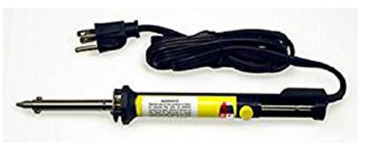

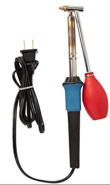

              • evilkitty
                • Nov 2017
                • 299
                Re: What is a good de-soldiering iron/tool?
                I have found 2 common designs (* see attached images)
                is there something made like this that will has replacement tips made for it at a reasonable price (not paying 1/2 the price of them iron for a low single quality tip)
                id like to keep the cost of the iron under $50
                  • 31086
                  the one on the left, the recoil can damage tracks.
                  the one on the right, if you have one then remove the bulb and fit a heatproof container with a filter followed by a hose - put an electric pump on the end.
                  better yet, dont buy them.
                  get a real desoldering unit.
                  they can be found new for 60-100$ if you look - the part number starts with ZD
                  https://www.youtube.com/watch?v=Ft50m8UU5WQ

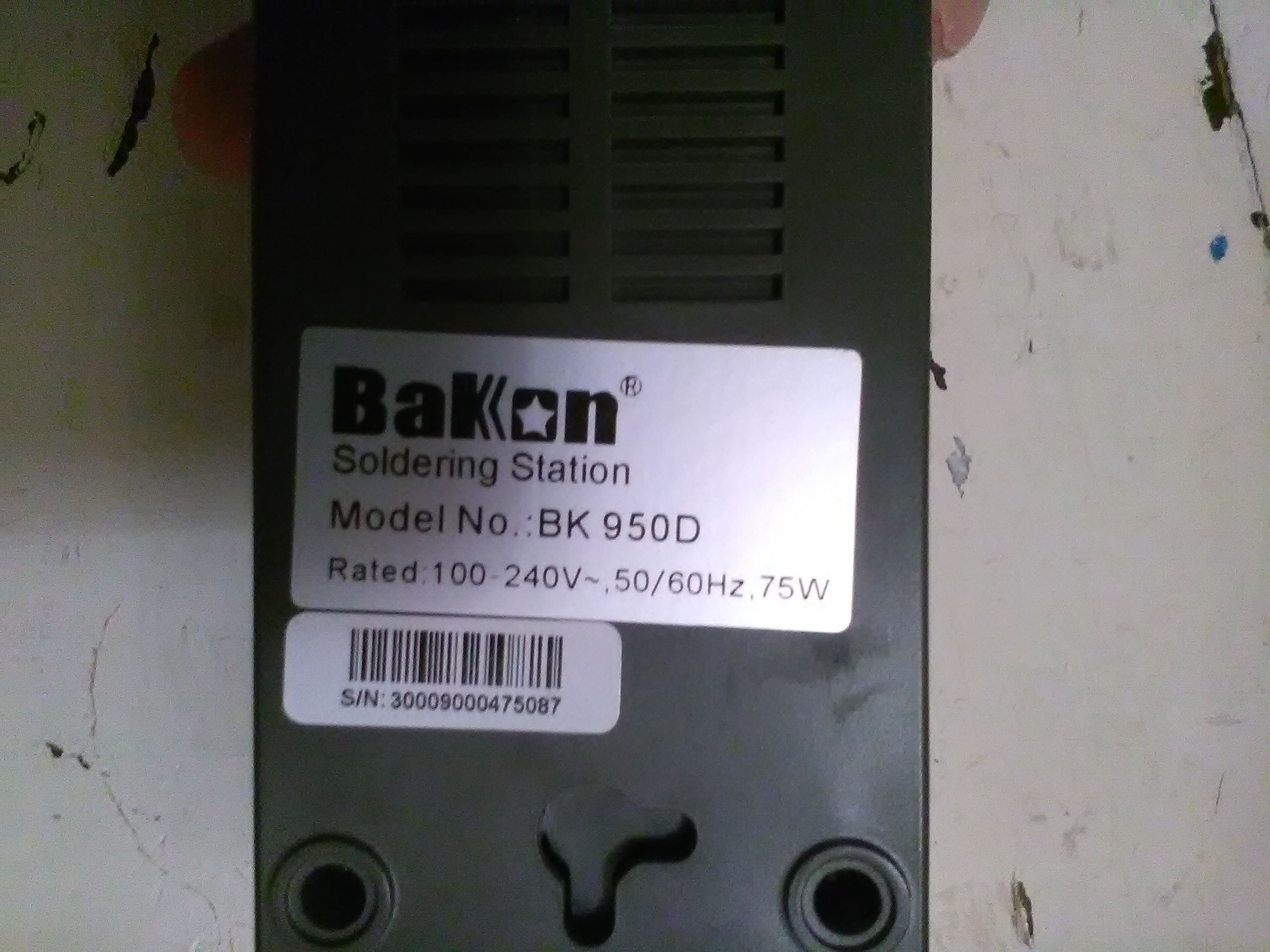

                          Originally posted by diif
                          I use a £20 Bakon 950D £2/£3 T12 tips and Chemtronics braid.
                          I used that on caps on a motherboard MS6340 ver5, and it did not do anything to the solder, I used the braid. I got no transfer of heat.
                          http://uk.farnell.com/chemtronics/40...5mm/dp/9599509
                          This for use with lead free solder ?

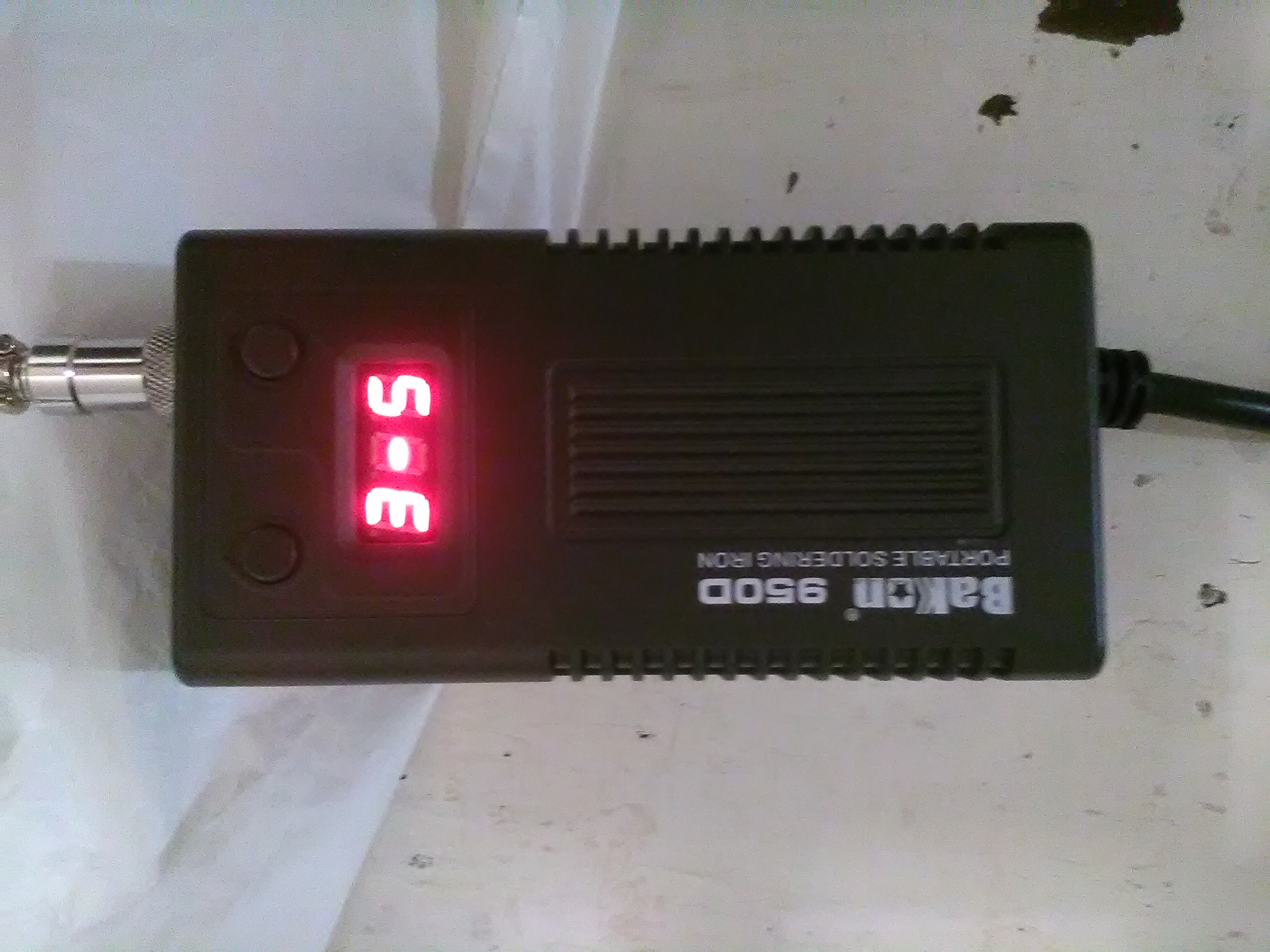

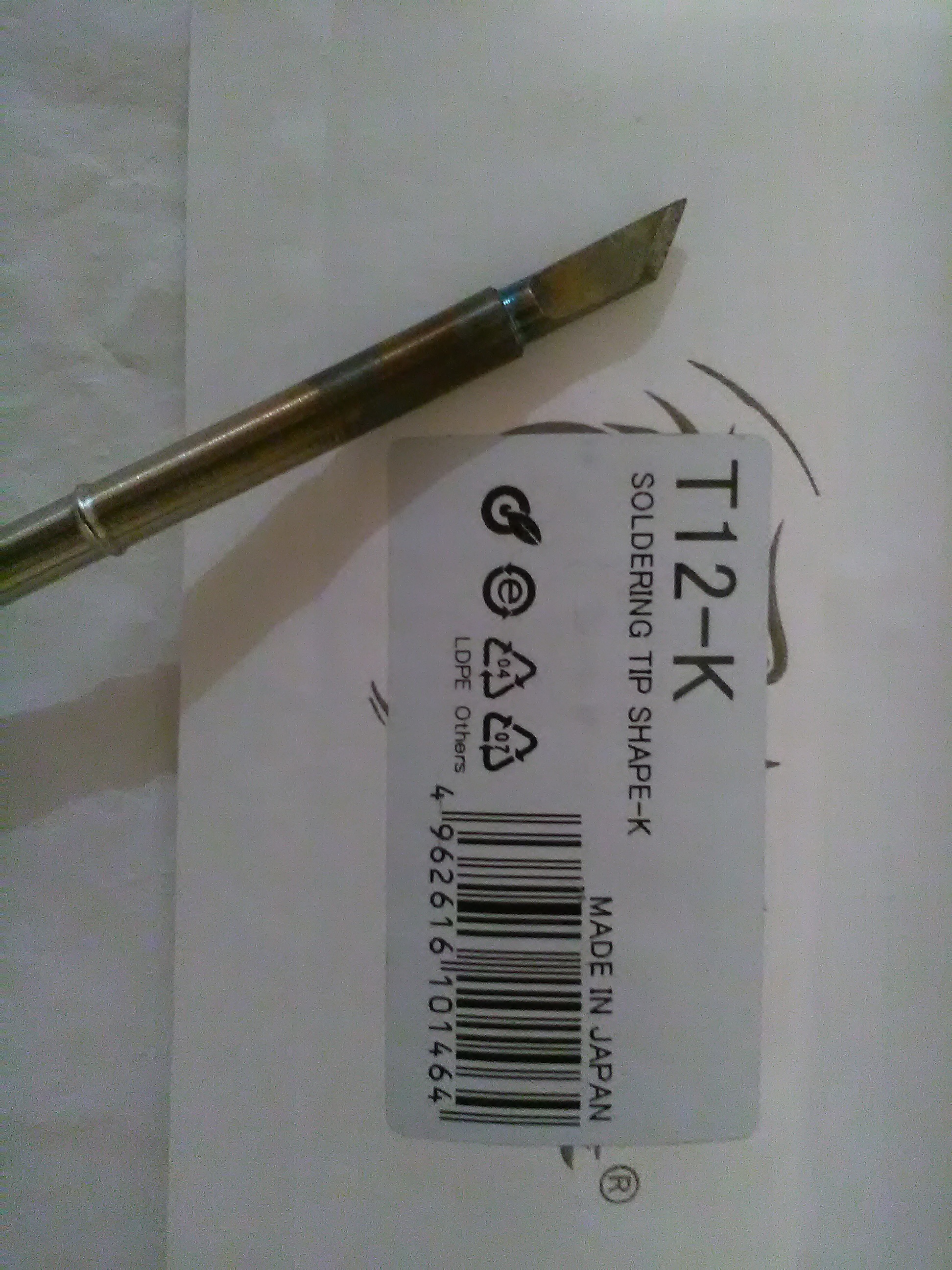

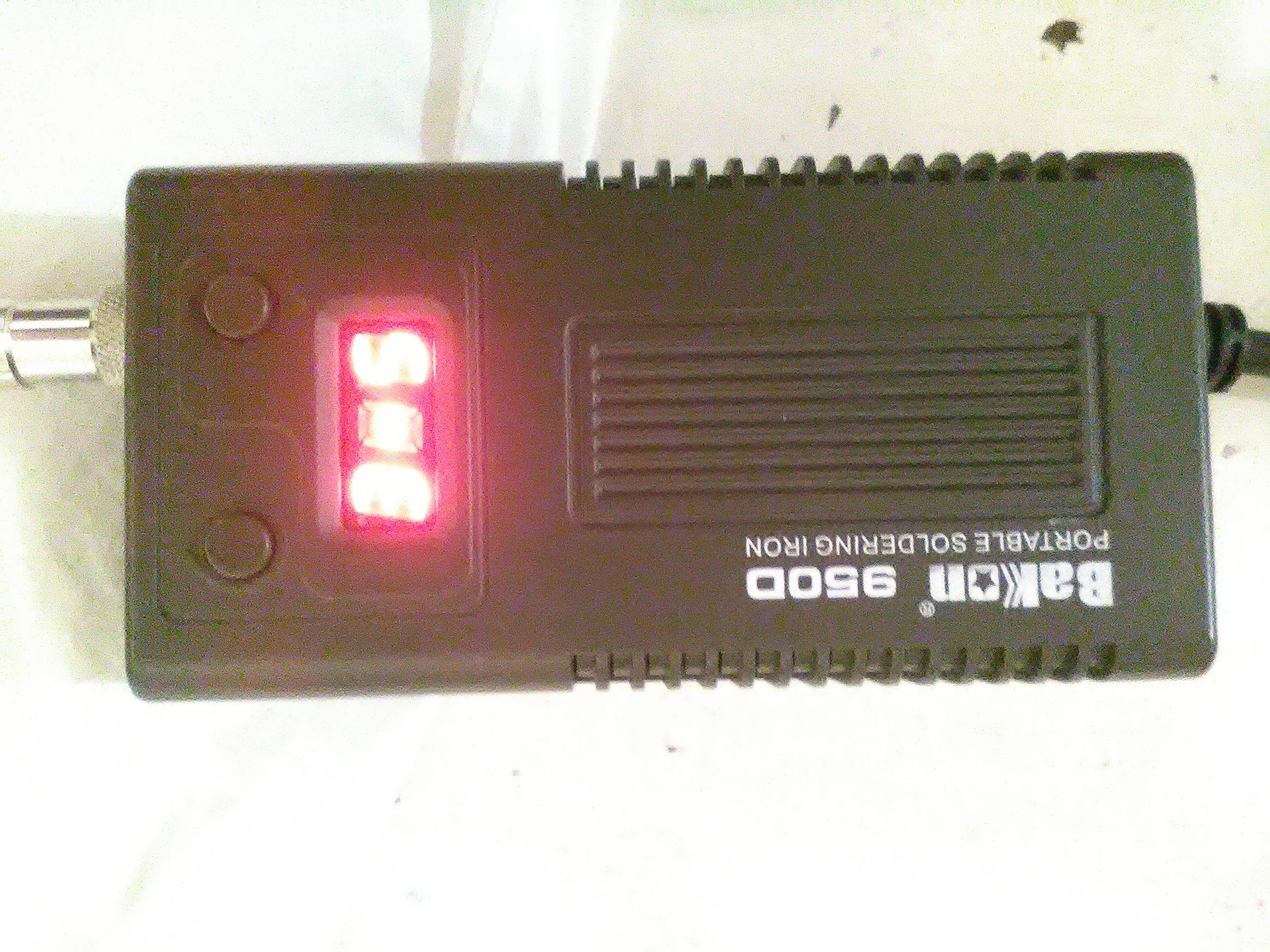

                              Here are pictures of the tip and some how the soldering station is now showing this error code 5-E/S-E!!!!!
                              I had the temp to 450c
                              https://www.youtube.com/watch?v=TiuQHn115UY
                              Looks faulty product.
                              From another forum
                              bakon 950d, isnt that pretty much a repurposed laptop power supply with small t12 controller added?
                              open it up and measure voltages
                              I also have the chip quik flux.
                              http://www.hse.gov.uk/pubns/indg305.pdf

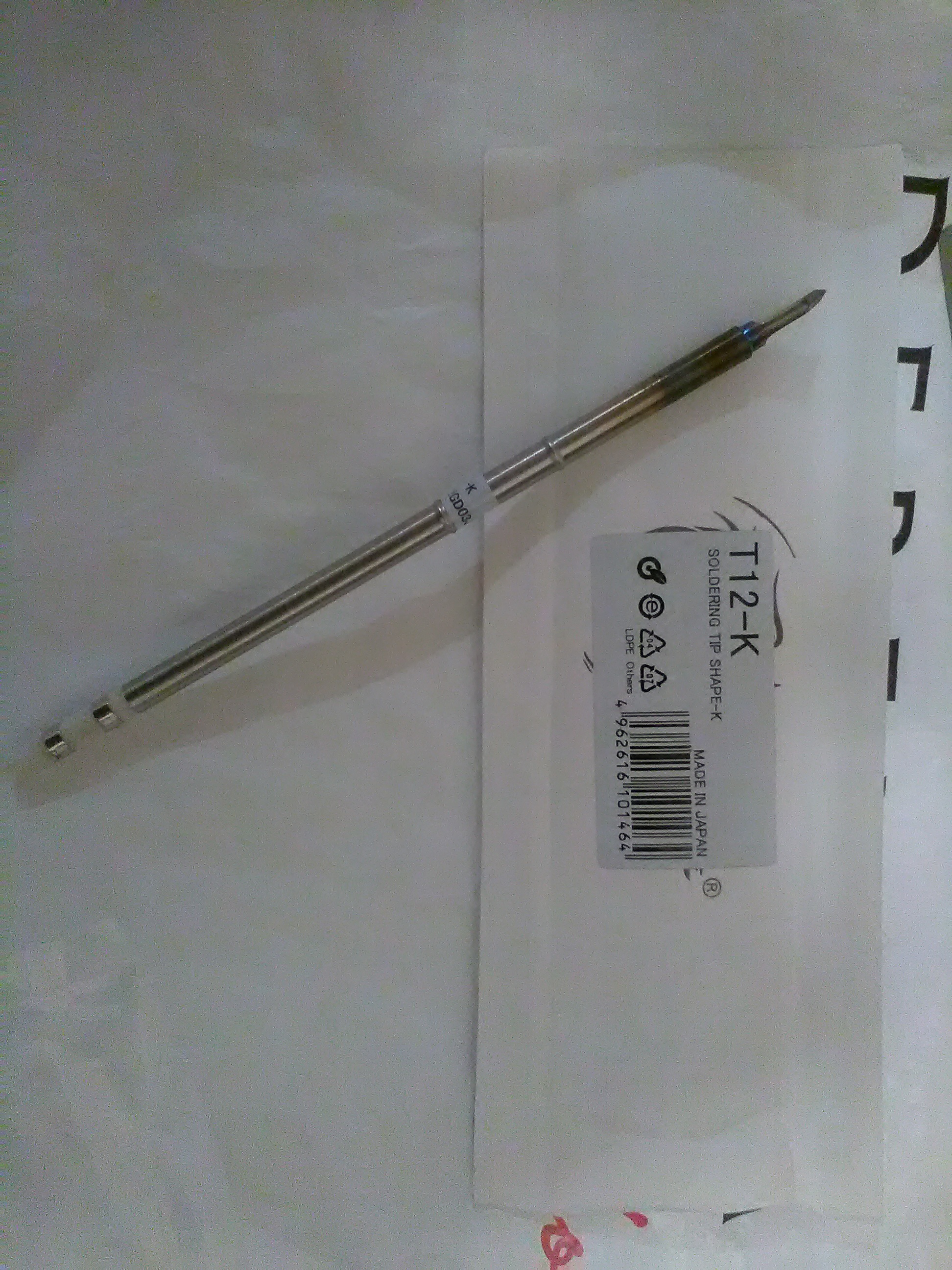

                                • 31086
                                K tip,
                                wrong tip for the job.
                                the error means a poor connection between the tip & handle usually.
                                far too hot too - 330-380 is enough.

                                    • 31086
                                    i know K tip, i have one - and 6 other tips too.
                                    K is good for use with desoldering braid, but not throwing a lot of heat into one place.
                                        So I need to use a pencil tip, not the one with it. Is it faulty the soldering station. Looks like a laptop power supply unit.
                                        What about that flux, how do you use it on the sticks on the motherboard.
                                        Any help or advice you can give. I soldered and repaired my speakers with a 3.5mm jack plug. It was okay for that.
                                        What is happening?
