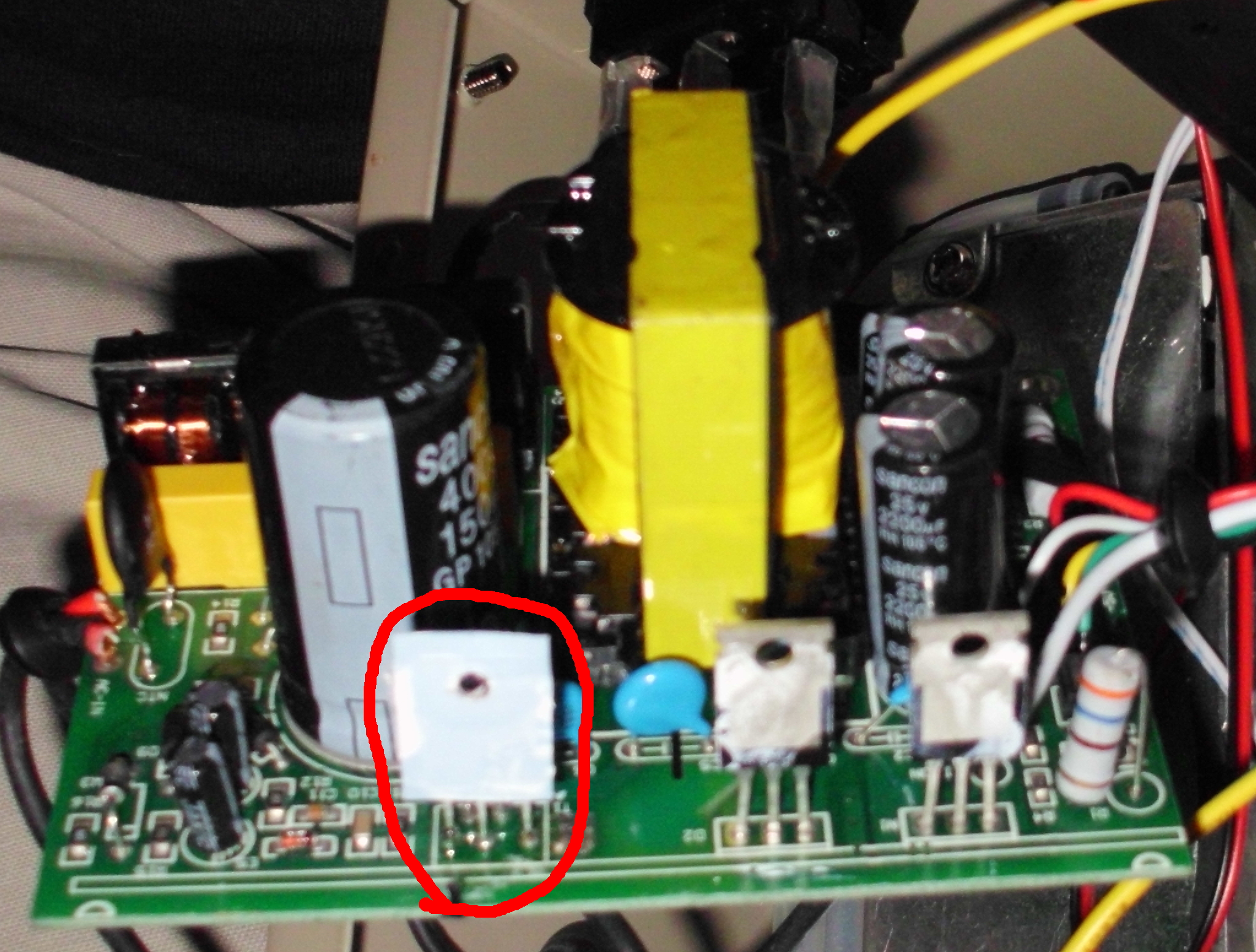

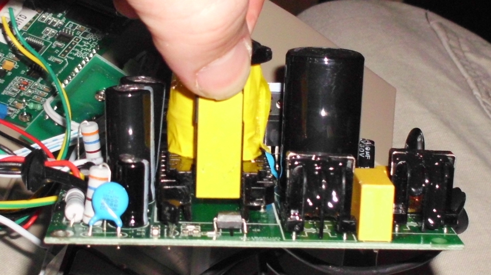

                            looks like the same unit sam sam sam has with those 25v 2200uf caps that should be 35v
                            which component should be +120v ac, the black disk or the yellow brick? (center image left side)
                                That is the switching power transformer and the component with either 5 or 8 pin that is the switching power supply regulator IC chip in the first photo it is one on the left the one in the middle and the one on the right are for the heater and the other one is for the vacuum pump but I can not remember which one is which without looking at the board again
                                The black one is the choke coil for electrical noise filtering with the caps that are near it

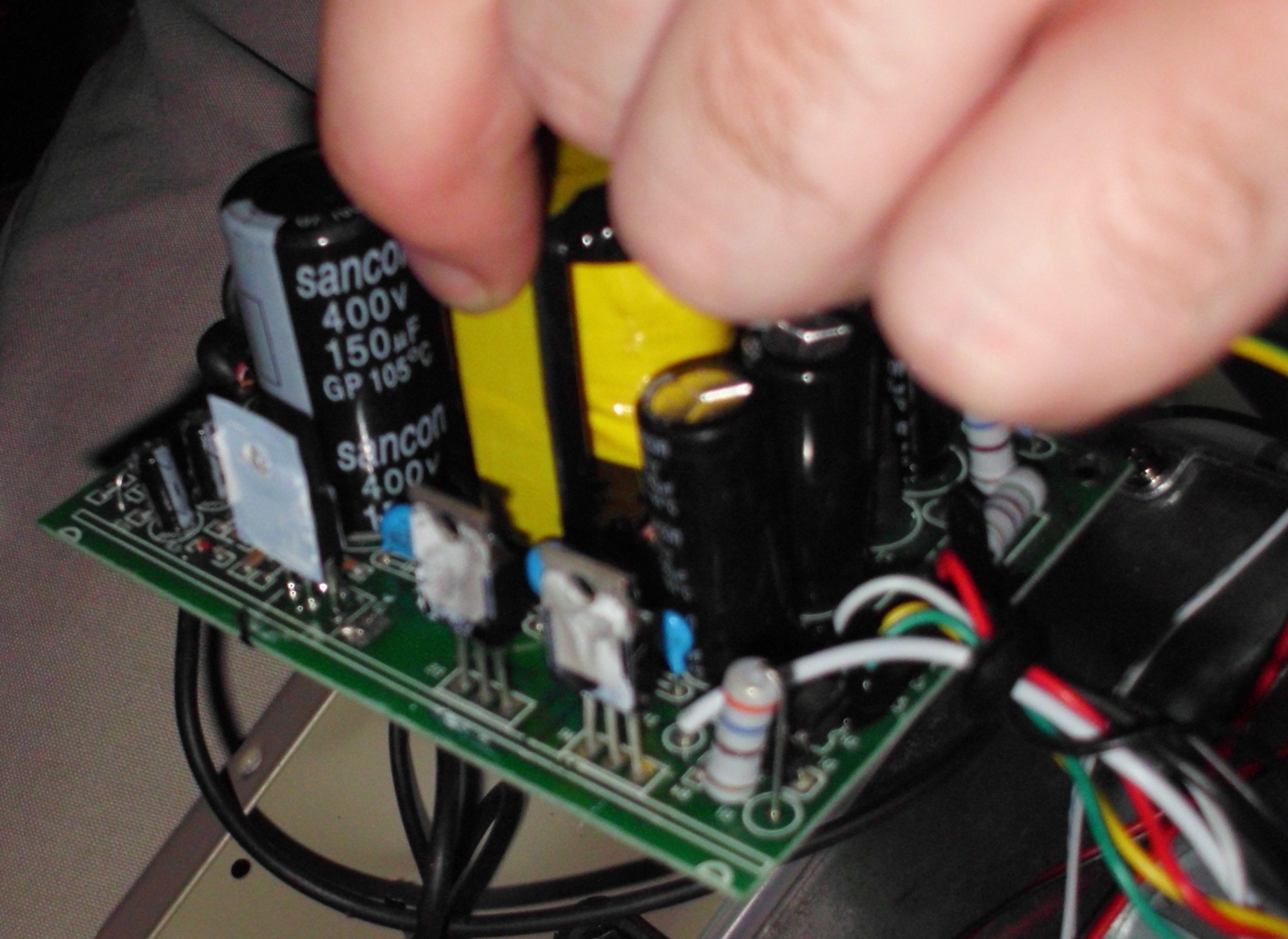

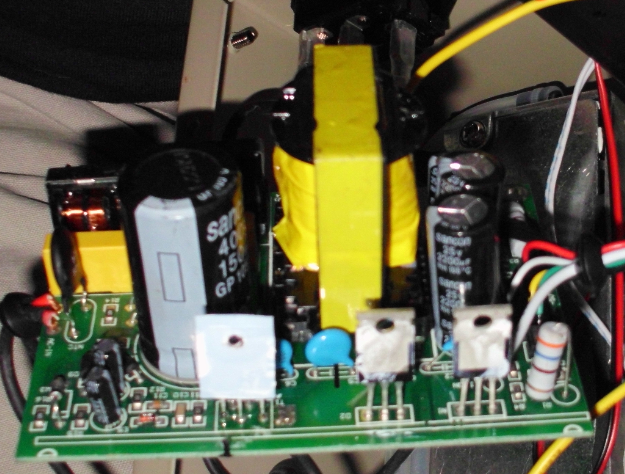

                                  And that you put heat sink compound on those three components on the heat sink and make sure the insulation disk are in place and the screws are tight
                                  On that note is the back one by the large cap hot or ground, i would expect the bolt going through it could have the threads touch the heat sync
                                  let me circle it, that one had 3 disk between the IC and the nut
                                  Nut -> Red pad -> red pad -> red pad -> IC -> paste -> pad -> Heat sync -> lock washer -> bolt
                                  i put it back like this
                                  Nut -> red pad -> red pad -> IC -> paste -> pad -> Heat sync -> Red pad -> lock washer -> bolt
                                  should i clean of and apply new paste like i would for a CPU's heat sync?
                                    The black one is on the hot side of power supply to the outlet

                                    The insulation disk (which is gray in color) goes between the IC chip and the heat sink
                                    The screw should have a plastic washer on the heat sink side and chip the washer and lock washer and then the nut make sure that chip has these parts on it
