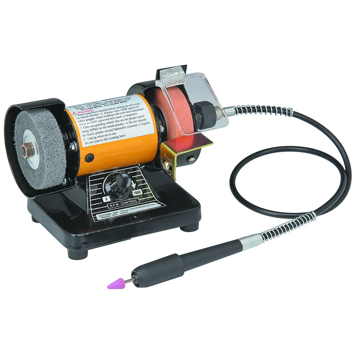

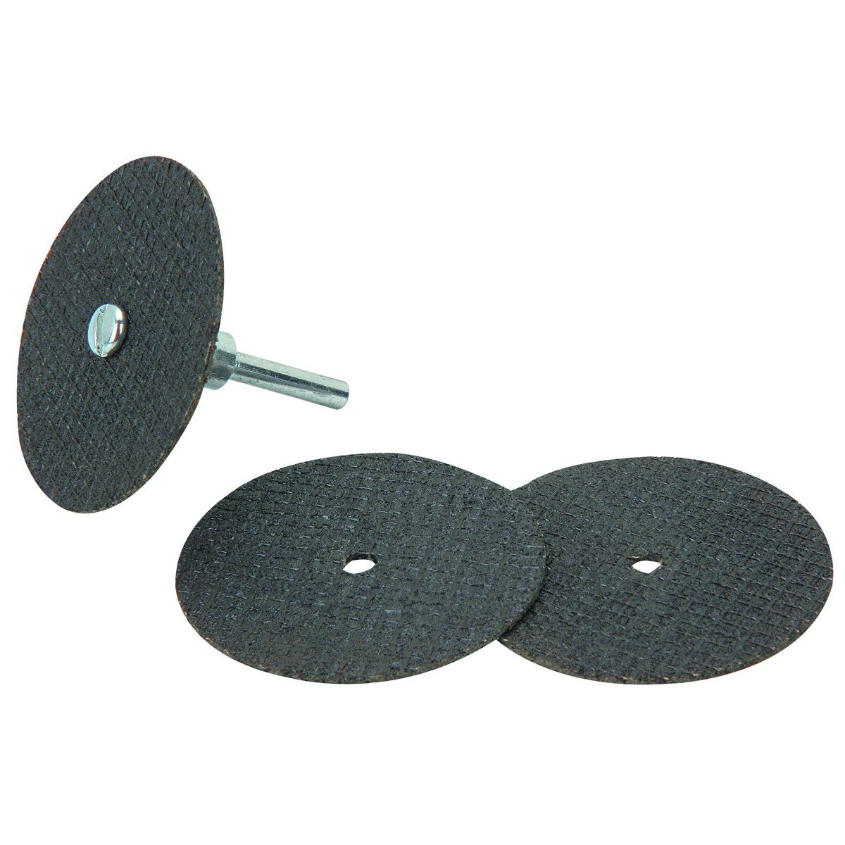

              • Jul 2011
              • 6069
              #106
              Re: What is a good de-soldiering iron/tool?
              Originally posted by evilkitty
              I had to change (not replace) the tip once so far for some large pins, and it was a tight fit; lucky i do not mess with that size pin often (1mm square pin)
              If the tip becomes uneven or a piece breaks off just grind the tip flat and ready to go again
              A dermal tool with a 1.5” cut off disk work good for this or a very small grinder from Harbor Freight also works very well for this just use the side of the wheel for this
              ******I know you should never use the side of a grinder wheel but this grinder does not spins that fast and you can control it speed ********
              Take the largest tip and drill the tip hole bigger to fit the pin
              or save your broken tips—-> and grind the tip flat and use it on devices that have bigger pins
              Or have more than one gun and have different tips on each one I have done this before
              The guns fail in one of two ways either it does not heat or you will see this “——— or error “ which means that the temperature sensor failed
              If the temperature sensor fails when it is ON the gun will become red hot where the heater element is and will not control the temperature
              Both items are from Harbor Freight
