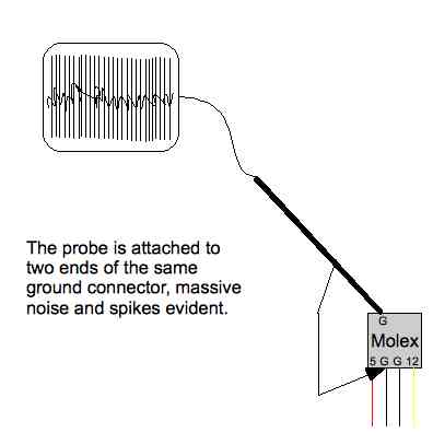

                        Here was my first clue that I might be experiencing some kind of interference...
                        I grounded the probe to a molex connector, then probed the other end of the same terminal to verify a 0v reading.
                        Surprise!
                        Giant spikes and lotsa ripple.
                        Grounded the probe tip to itself (with the clip thing) 0v as expected.
                        Here's a nice drawing to demonstrate>
                        Arrrgh! head hurt after that one!

                                Just a quick comment... if you're getting a bunch of noise in the scope that's still there with everything switched off, you could be picking up something from elsewhere in the building. We have a TV set here that completely kills the ability to do my load testing when turned on, simply because it spews so much interference into the mains.
                                I don't use an isolation transformer. Reason being, I don't have one. Since the load tester is on a different circuit than the PSU being tested, I'd actually need two. I say that because when that TV set is on, the noise gets in there no matter which one is unplugged. Only if I unplug both load tester and PSU being tested does the garbage from that set go away, and of course that makes it hard to get any work done
                                I've learned to just make sure that TV is off whenever I start load testing something.

                                    Thank You JPDoe.
                                    Now THAT's an explanation I can understand!
                                    Apparently they want to shunt the irrelevant noise away from the probe tip and the capacitor pair seems to do a great job of that.
                                    Hi Oklahoma Wolf!
                                    Oh, I forgot to mention that the molex ground noise was only with the PSU "ON" not when it was off. "Off" resulted in no major interference on any wire including the ground ones.
                                    Other circuits that I've tested here have had no such interference, including the PSU inside my LCD TV set. (I was looking at that for coil whine) Maybe that PSU works at different frequencies or power levels?

                                      Re: Let's teach Keri how to use an Oscilloscope!
                                      Originally posted by PCBONEZ
                                      I don't know.
                                      You thought they were using a great scope too.
                                      I can't speak for other sites, but I use two scopes. There's the Stingray that gets all my screenshots for me and there's the big Matrix that sits on a table just below the load tester.
                                      I've actually stopped using the Matrix for the most part. It never disagrees with the Stingray, and has largely become redundant. Most of the time I use it to burn in a PSU I've just taken apart and put back together because I don't want to waste time firing up the office computer just to get the Stingray online.
                                      One more suggestion - if going by the ATX spec, set the scope for 10uS/sec or so. For reviews, I usually measure and capture at 25kS/sec on purpose just because it's easier to find and show low frequency ripple that way, but that's not to ATX spec. I'll often change it when I need to to show off oddities in the unit being tested, but the reality is that if I adhere rigidly to the spec I tend to miss stuff like the ripple I caught in last week's Seasonic M12D review.
