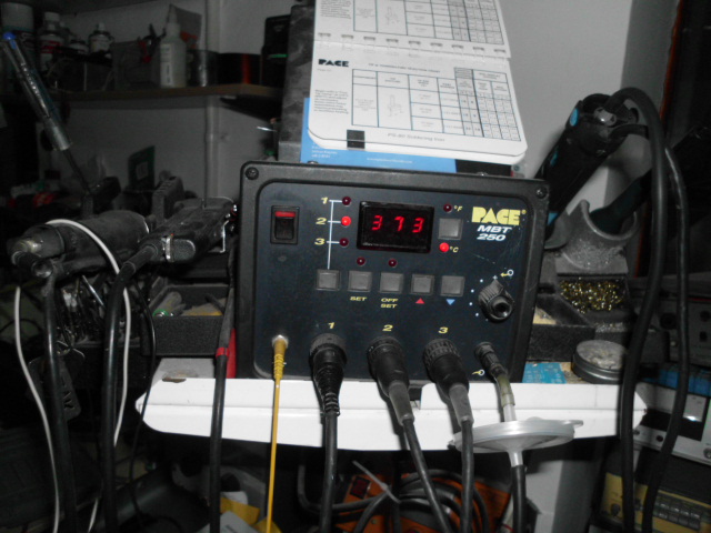

                                        If money is no object get one of these, as there made in the states you should be able to get a better price over there.
                                        I have ERSA irons as well but I prefer the balance of the pace to the ERSA.
