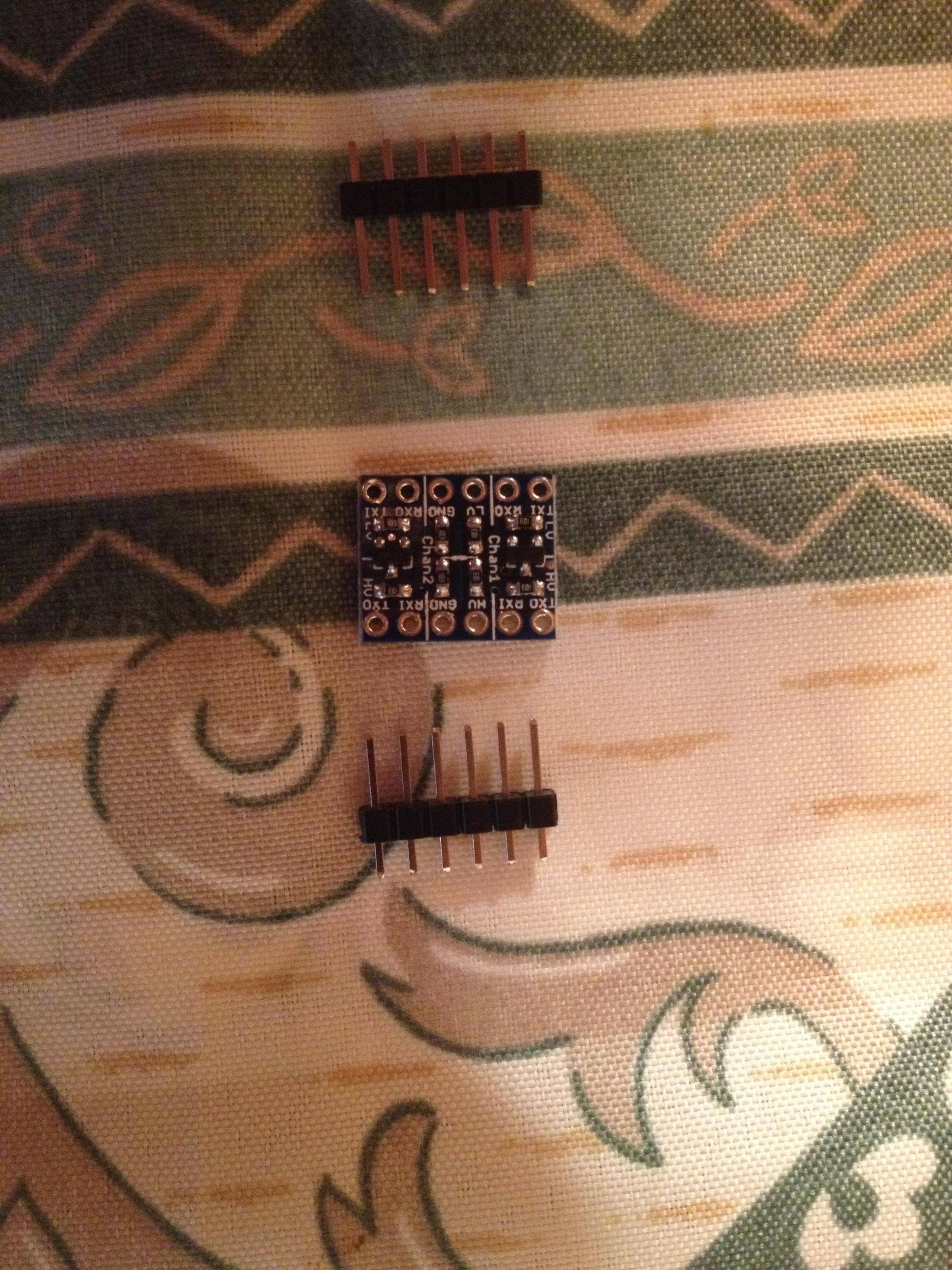

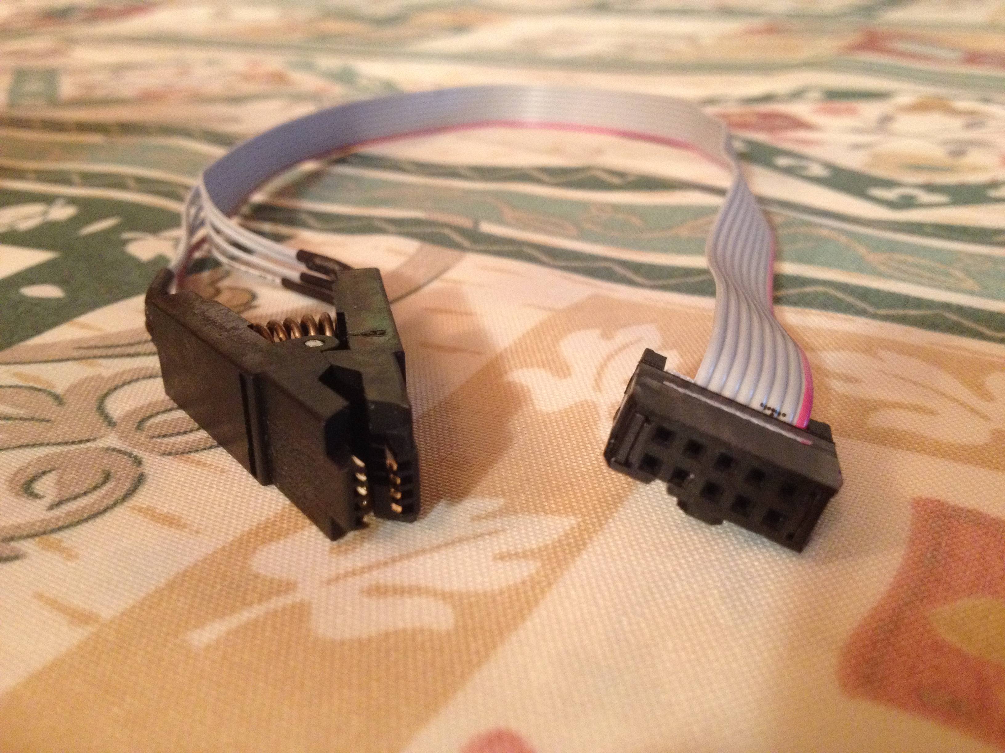

      Re: CH341a and logic level converter
      The tablet is a Chuwi Hi8 Pro
      The usb programmer
      The logic level converter
      and the soic8 clip
        https://www.sparkfun.com/products/retired/11978
        that's the board.
        you get the high voltage from the programmer socket, and the low voltage from the chip / tablet.
        but i dont think it will work.
        most flash chips use bi-directional data pin(s)
        what is the part number on the flash?

              the reference has nothing to do with it.
              those chips use one pin to send data in both directions - that converter wont do that.
              how do you know the chip is 1.8v and not 3.3v ?

                  • 31265
                  3.3 through a 100ohm resistor - maybe with a 2v zener diode to ground,
                  but NOT with a clip - you will put 3.3v into everything else and trash the cpu.
                  the chip needs to be removed first.
                                      1st. The Winbond chip has to be removed first!
                                      [Otherwise, unless you're an experienced electronic guy you will most likely kill everything connected to the 1.8V power rail]
                                      2nd. Forget the clip and that tricky voltage level converter;
                                      3rd. Use the CH341A programmer and a suitable voltage level converter, e.g. this 1.8V SPI Flash adapter around €4;
