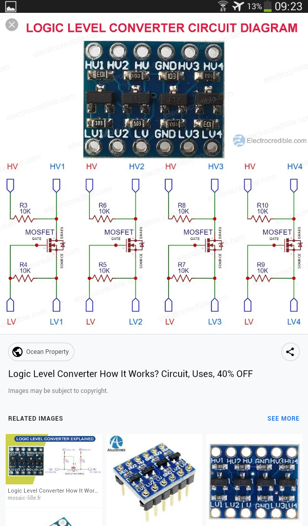

    Instead of doing the 3.3v mod, I'm thinking of converting the 5v to 3.3v with an 8 channel TXS0108E through the ZIF socket but I don't know if that would work, because it has to circulate voltage and also information.
    What I am looking for is something that will convert from 5v to 3.3v but without modifying the ch341a.

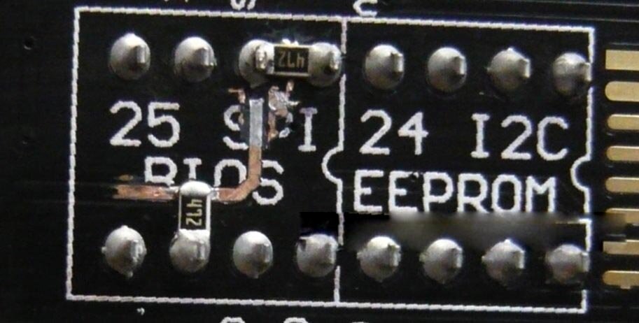

    Not covered on that eevblog page: the WP/HOLD pins (pins 3 and 7) must be held high via pull-up resistors, but on CH341A dongles, they are directly connected to 3.3V DC (continuity with pin 8). It is advisable to cut these two connections, to the WP and HOLD pins, and jump the cuts using pull-up resistors instead. A value between 1k to 10k (ohms) should be fine.
    In the event of a surge, like for example you connect the clip wrongly and cause a short circuit between two pins, lack of pull-up resistors on WP/HOLD could cause a direct short between VCC/ground, which would cause a lot of heat build up and possibly fire (and definitely damaged circuitry). On SOIC8, pin 3 is WP and 4 is GND, so a direct 3.3v connection there is quite hazardous for that reason; all the more reason to use a pull-up resistor.

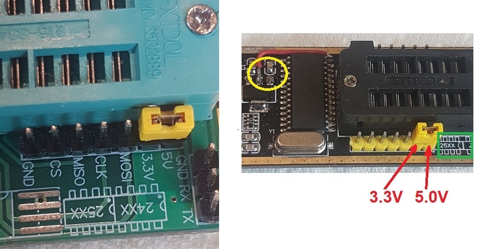

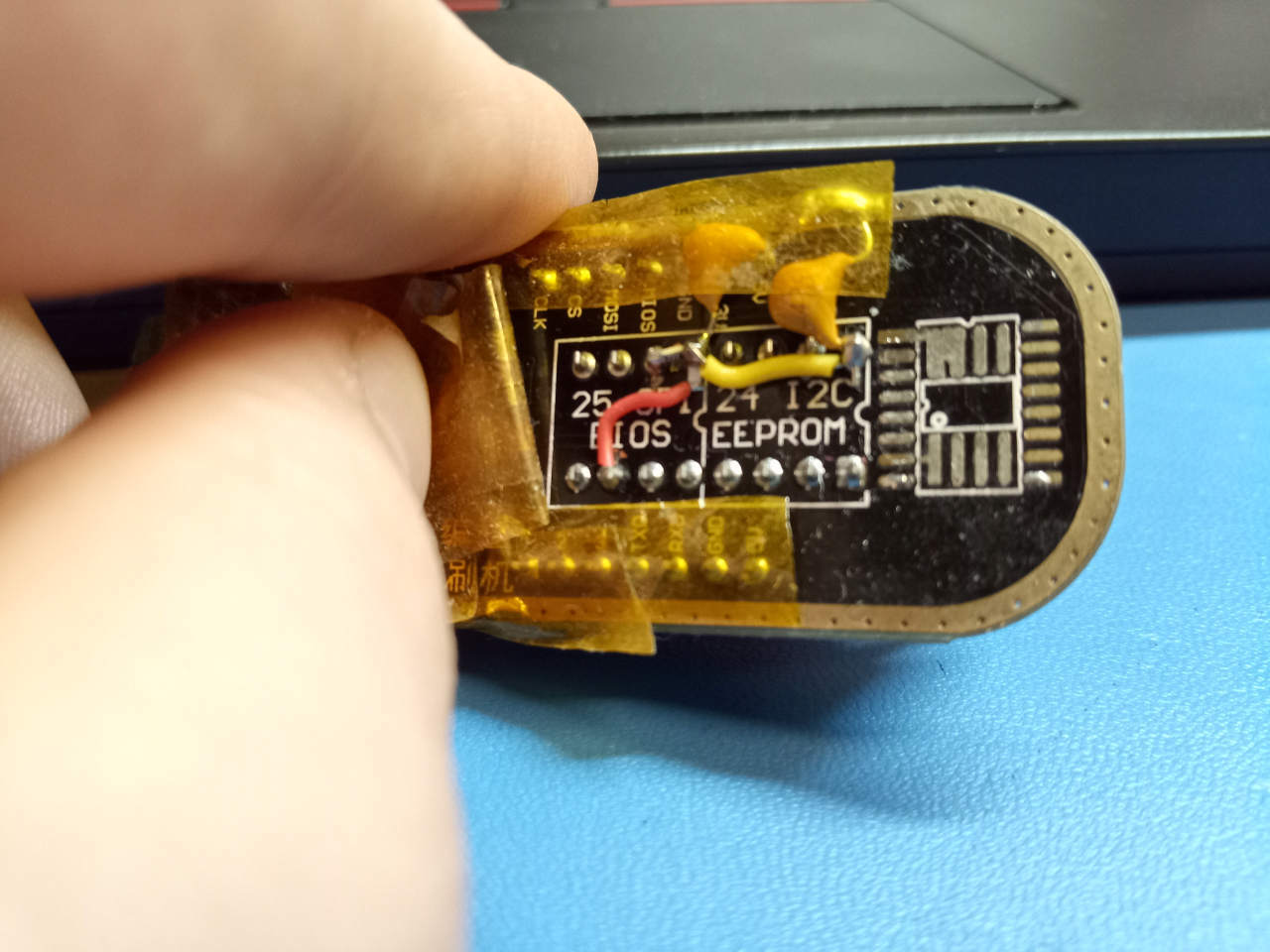

    • 31303
    like this?

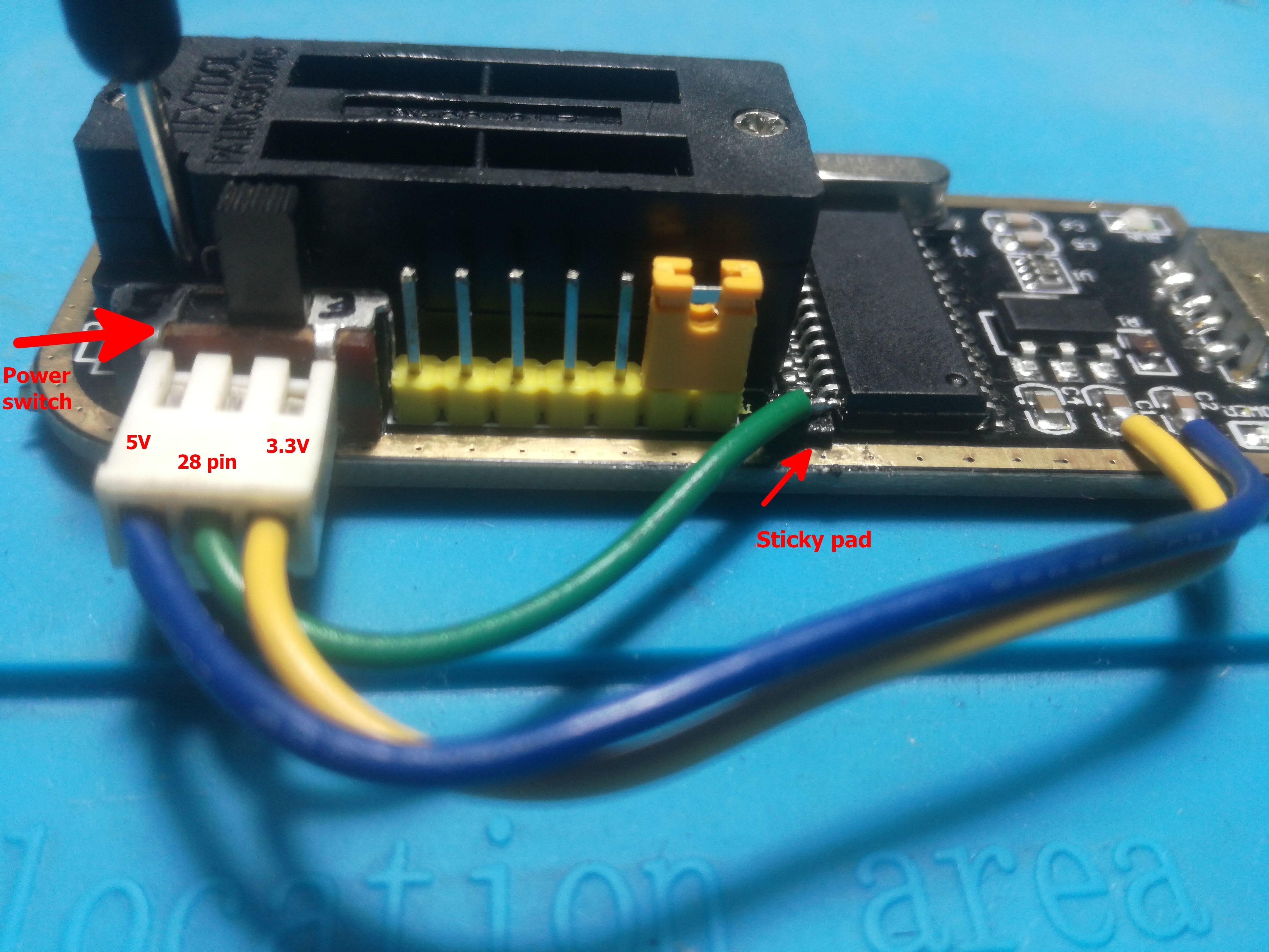

      Seems that are many ways to do the mod, i want to do a mod like this (with a 5v-3.3v switch with solder and lift up 28pin) to switch between 5v and 3.3:
      It will work? Or I would like to know if the logic converter also works as an alternative to avoid modify the programmer.

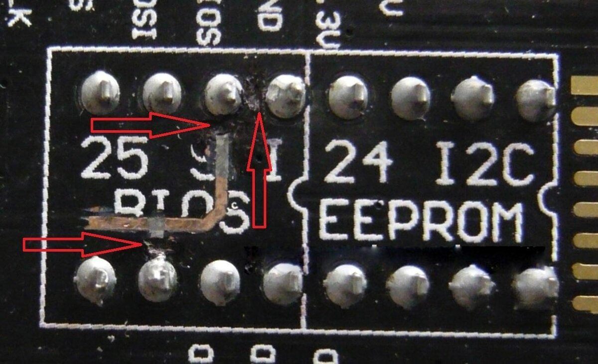

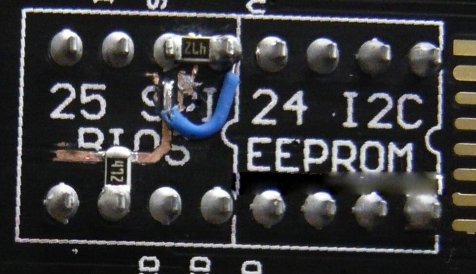

      Libreboot images seems confusing to do the WP/HOLD mod. The pictures is low quality and I can't see which pins/tracks to solder/cut. According to what I saw in the pictures, i understood the following and I modified the pictures (although I would require validation if what I indicated in the modified pictures is correct)
ID:	3278185 Click image for larger version
      Modified image to try to understand which pins/tracks to solder/cut:
      I hope anyone can help me, I understand that the questions I am asking are too basic....​

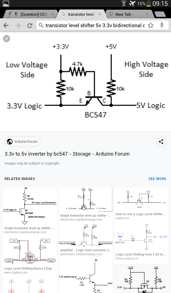

        Maybe this circuit for every wire?
        For 3.3v mod Sorin has the video about no point...? Current is so small that voltage easy drop, I guess.

          WP/HOLD mod

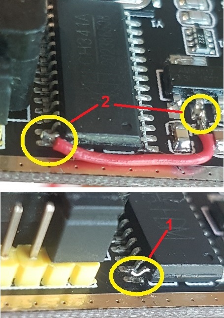

            • 31303
            the mod i posted doesnt need a switch, the 5v / 3v3 jumper selects the voltage

                • 31303
                i dont - lift 1 pin and add 1 wire and it's fully 3.3v compatable.
                to make it 5v just put a jumper between the 5v and 3.3v pins to bypass the regulator.
