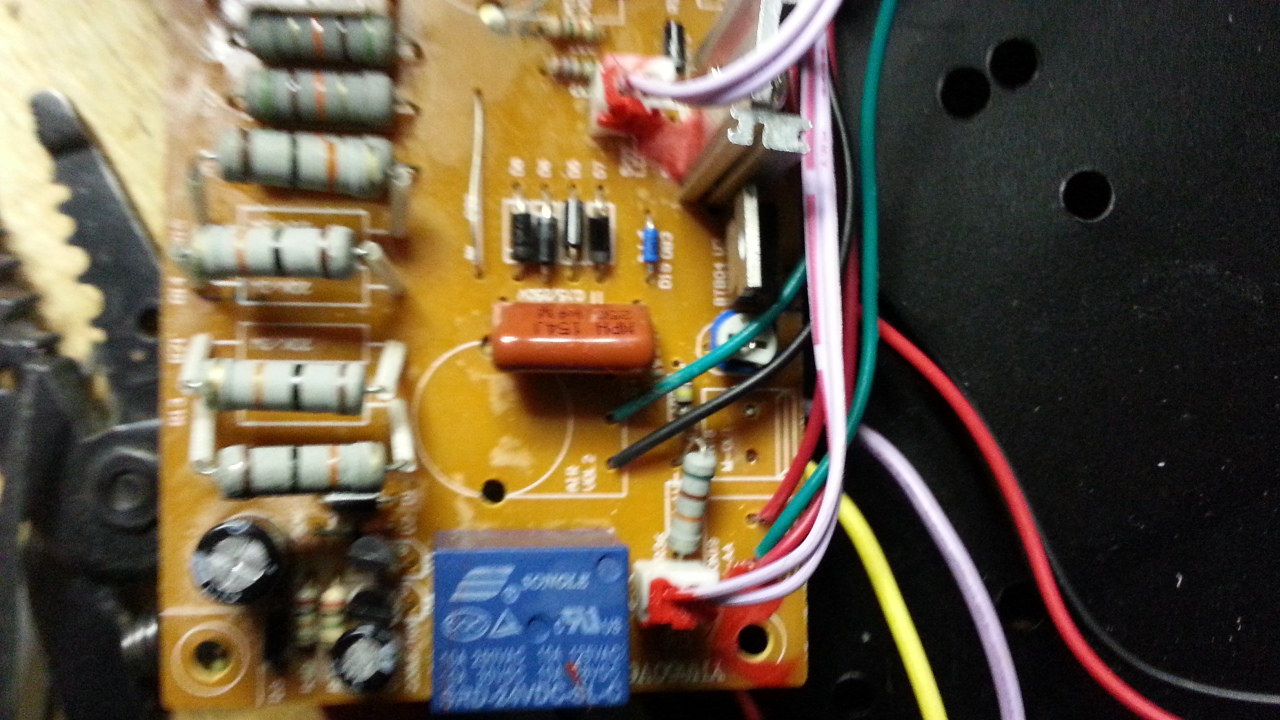

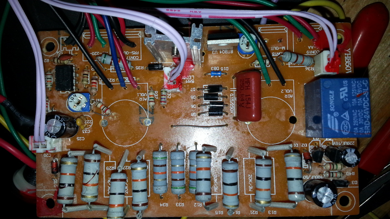

Rework Station Pump - Can They Be Repaired ?
    replied
    Re: Rework Station Pump - Can They Be Repaired ?
    i have a funny feeling the motor control is a phase-angle controller - like a lamp dimmer.
    you will need a scope to see what it does, BUT maybe replacing the pump with a low wattage lamp bulb would be a good test.
    Leave a comment:
  • mmartell
    replied
    Re: Rework Station Pump - Can They Be Repaired ?
    Resoldered the two triacs, the lm358 and several dubious joints. Reassembled the pump unit minus the back plate so I could see the movement of the piston.
    Fired it up and no change.
    The frequency was measured at 60hz. The a/c voltage changes with the air speed knob but the frequency remains at 60hz.
    I noticed now that the wand no longer heats up, don't know how long it's been like that or if it's a related problem yet.
    Feel like I'm chasing my tail with this one.
    Leave a comment:
    replied
    Re: Rework Station Pump - Can They Be Repaired ?
    resolder the power transistor or whatever it is,
    the center pin looks strange in the foto's
    Leave a comment:
  • mmartell
    replied
    Re: Rework Station Pump - Can They Be Repaired ?
    The two soldered to the back of the board in pic 4 and pic 5.
    Leave a comment:
    replied
    Re: Rework Station Pump - Can They Be Repaired ?
    so which pair of wires goes to the pump?
    Leave a comment:
  • mmartell
    replied
    Re: Rework Station Pump - Can They Be Repaired ?
    Here are some pics of the control board. It has two bt137 triacs and an lm358 on it as well as a/c input from the mains. Can anyone infer from the pics how this works ? And is it safe to put a scope on the two wires driving the magnetic coils ?
    Leave a comment:
    replied
    Re: Rework Station Pump - Can They Be Repaired ?
    put a microphone near it - if it's between 50Hz and 15KHz it should detect it.
    Leave a comment:
  • mmartell
    replied
    Re: Rework Station Pump - Can They Be Repaired ?
    Hmm.. will try with a compass though the frequency of oscillation may tear the needle off
    Leave a comment:
  • mmartell
    replied
    Re: Rework Station Pump - Can They Be Repaired ?
    I have verified with a magnet that the two magnets on the piston are indeed in the arrangement as posted above.
    I need to recheck the coils to rule them out. After that it's a problem on the driver board - will post pics of that board soon.
    Is there an easy way to test for the presence of an oscillating magnetic field ?
    Leave a comment:
    replied
    Re: Rework Station Pump - Can They Be Repaired ?
    start with a re-cap
    Leave a comment:
  • mmartell
    replied
    Re: Rework Station Pump - Can They Be Repaired ?
    Ok this image is from a patent filing and so the mystery is solved on how this is SUPPOSED to work. Now to troubleshoot if it's mechanical or electrical.
    Leave a comment:
  • mmartell
    replied
    Re: Rework Station Pump - Can They Be Repaired ?
    The coils are wired in series.
    Leave a comment:
  • harleyman58
    replied
    Re: Rework Station Pump - Can They Be Repaired ?
    Why are there different wires feeding each end of the coil? With the commons wired together?
    Leave a comment:
  • mmartell
    replied
    Re: Rework Station Pump - Can They Be Repaired ?
    Yes the coils are energized at the same time. Seems to me the magnetic field is perpendicular to the path of the piston though. Or is it ?
    Leave a comment:
    replied
    Re: Rework Station Pump - Can They Be Repaired ?
    no, both ends energize together.
    what may be happening is that you have a pair of magnets of oposing polarity's, so it will pull in the direction of the current flow.
    that just happens to change direction 50-60 times a second
    Leave a comment:
  • harleyman58
    replied
    Re: Rework Station Pump - Can They Be Repaired ?
    One coil energizes pulling the diagram to one end,then it shuts off and the other coil energizes pulling it to the other end. Then the coils just alternate off and on.
    Leave a comment:
  • mmartell
    replied
    Re: Rework Station Pump - Can They Be Repaired ?
    I considered this but I am not fluent in magnetics lol.
    If the two pieces in the piston are supposed to be steel (they ARE magnetized atm) by what mechanism does the piston move to the other end of the stroke ?
    Last edited by mmartell; 04-11-2016, 02:33 AM.
    Leave a comment:
  • harleyman58
    replied
    Re: Rework Station Pump - Can They Be Repaired ?
    The piston that has the diagrams on it will not be a magnet. The coil creates a magnetic field pulling the iron core in the center to one end of stroke then the other. If it was a magnet it would not move because of opposing magnetic fields.
    Leave a comment:
    replied
    Re: Rework Station Pump - Can They Be Repaired ?
    that's very different, but shares the same construction quality!
    Leave a comment:
  • mmartell
    replied
    Re: Rework Station Pump - Can They Be Repaired ?
    I couldn't do it either. I will pull the board and have a closer look and check some of the components.
    The magnets look good.
    stj there is a photo on the first page of the circuit board. Will take a better one when I remove it.
    Leave a comment:
  • shahnld
    wds-580 rework station issue
    by shahnld
    Good day.
    i received used bga rework station wds-580 which was not going above 300c despite the parameter was set to 350c, Everytime beeps at 300c so i did a factory reset and by mistake washed data and log etc. now the station boots to a white screen.
    Does anyone has a firmware for this station and want to share with me. i will really appreciate any help possible..
    kind regards...
    03-28-2024, 01:14 PM
  • minimania
    Need Schematic for jbc am6800 rework station
    by minimania
    hi all im looking for a Schematic for jbc am6800 rework station
    mine has stopped working fully
    it started with turning off when switched on then after a few off and ons it worked sort of for awhile
    now it wont turn on at all...
    01-28-2025, 03:44 PM
  • shahnld
    Seamark ZM-R6200 Rework station
    by shahnld
    Good day Experts.
    I have recently aquired a rework station SEAMARK ZM-R6800,. Is there anyone using this or some other similar station and give me some info about profile temp curve etc for removing leadfree soldered gpu chip..? just 1 profile will be enough to get started.
    Kind regards
    01-24-2024, 10:55 AM
  • petemanuk
    Help with IR6500 rework station
    by petemanuk
    I been playing with a recently acquired IR6500 rework station and watching lots of YouTube tutorials to see how to use it with not much success. I’ve only recently joined badcaps but going through the forums there is a lot of knowledge here, so though it best is if I ask my question here.
    1. Firstly is the IR6500 any good for BGA rework or should I be spending my money on a better one.
    2. The instruction manual is pretty useless on explaining how to set the PID loops (no information at all!!) both top and bottom heater for th Kp, Ki and Kd...
    10-14-2022, 12:31 AM
    ZD desoldering station pump rebuild
    by stj
    just did one.
    works great.
    so here's the discoveries.
    the pump "modules" have 4 parts, the main body, the outside bit, the inside bit - screwed to the main body, and the diaphram.
    the failure is the inside bit, it has a rubber coating for some reason that becomes tacky and breaks down - contaminating the diaphram.
    so you need to clean everything to get rid of all the tacky black stuff.
    then reassemble it.
    *BUT*
    you must put the 2 screws into the assembly only finger-tight.
    if you tighten it properly the valves dont work....
    08-21-2024, 05:59 PM
