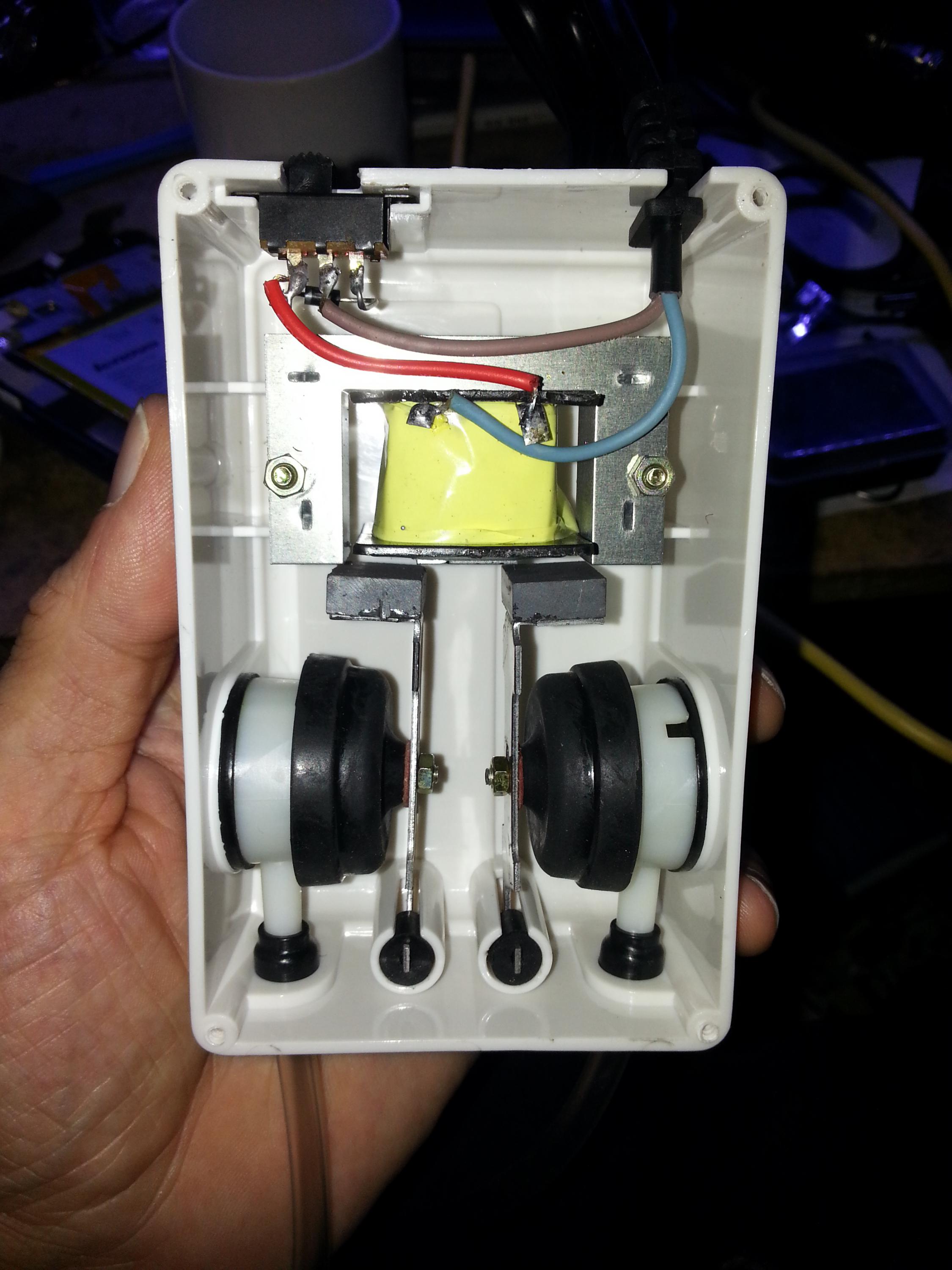

    I bought a cheeeeap smd vacuum device from China and thought i'd take a look to see inside. Seems a bit dodgy to me but what do you think ?
    Before i took the bottom off i was thinking i'd add a filter to one of the lines and see if i could use it as a desoldering pump. Now i'm not so sure i should even bother sticking a plug on it, although perhaps i should for research purposes ?

    Looks like an aquarium bubbler stone air pump

      looks o.k. other than the switch maybe - what's the switch got stamped on it - any voltage ratings?
      clever design.
      btw, it's never going to pull solder - the diaphrams are way to small.
      you would be better using a pump from a car airhorn - that's the type of pump weller DS80 used to use.

        It will probably work fine for what it was designed.
        Maybe if you gang the two pumps together with some one way valves you might get enough suction to pull solder. Maybe you could hook the hose up to a blunt tip hypodermic needle. That would give you high velocity at the business end and a chamber with lower velocitty to capture the solder.

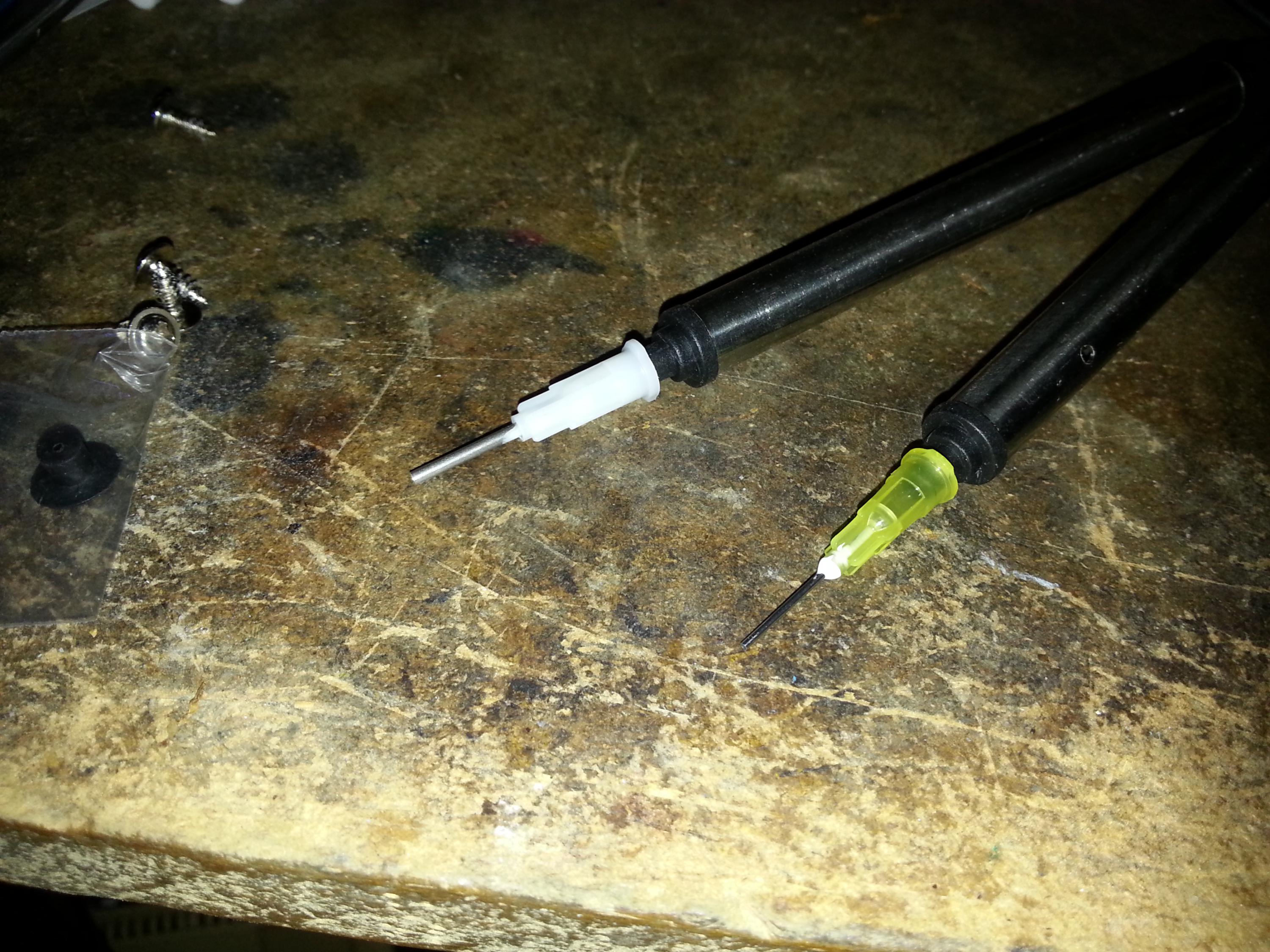

          Attached is a photo of the "suckers" with attachments.
          So maybe if i upgrade my pump and use the larger one with a filter.

            Thats total overkill for your application. Also, if those are the type of pump Im thinking it is (have 2 scientific pumps in the garage myself) they dont work well at atmospheric pressure. They are good at pulling a very deep vacuum over the course of hours. They also require pump oil (change after every use!) and looking at the condition, an expensive pump vane rebuild kit.
            An air horn pump, as mentioned by stj is your best bet.
            Edit: looked at your pic, those are hypodermic needles. You could easily buy a larger bore tip if needed. My only concern would be how to clean out the handles.
