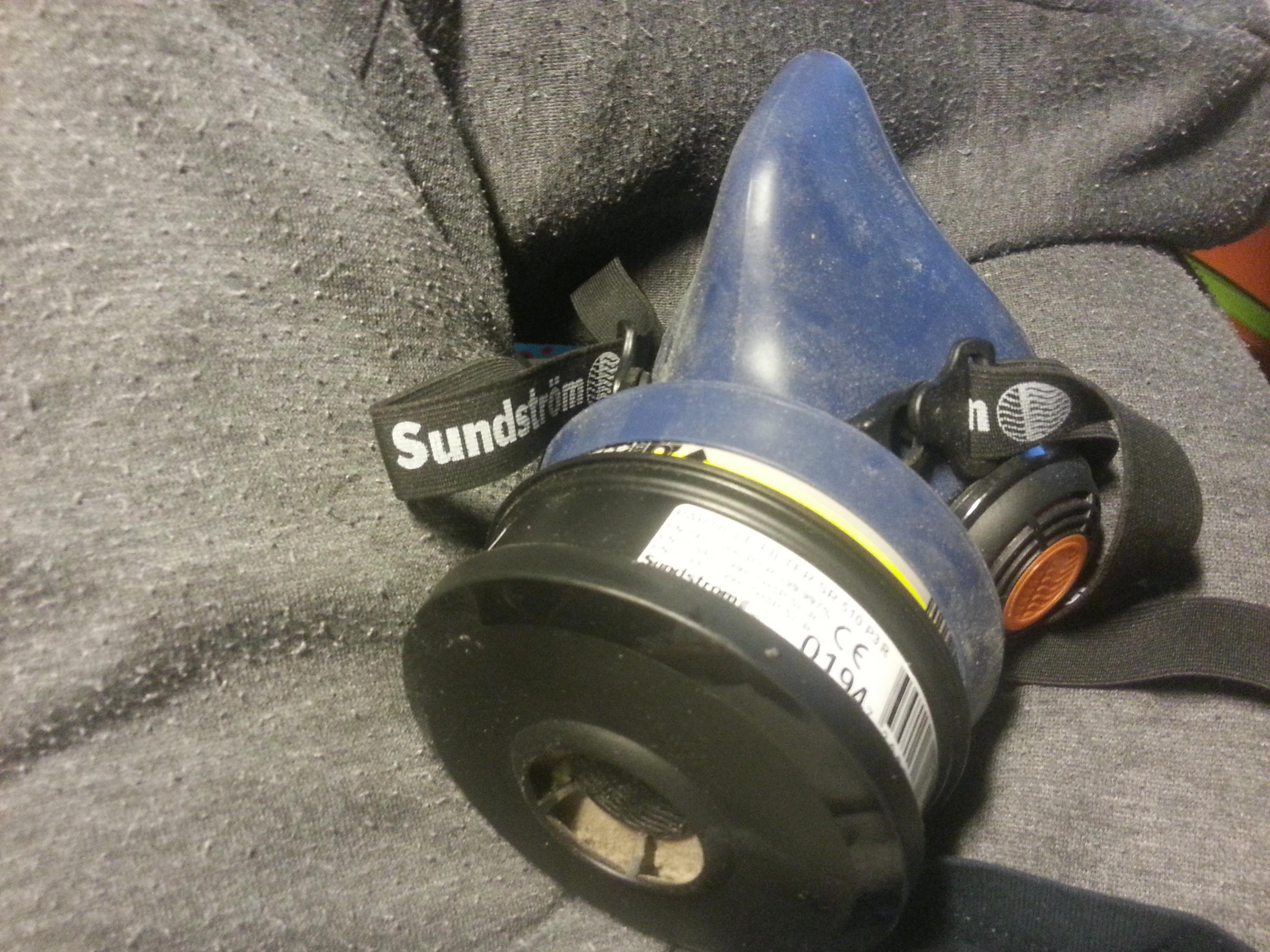

      I have a Sundström, with the particle filter SR 510 P3R and a gas one SR 315 ABE1.
      I have a protective work wear shop near me and i asked the salesman. After phoning up head office and telling them what i was doing, they ordered me the gas one.
      It's a bit dusty as i have been wearing in my loft whilst redoing the insulation.

        Then ABE1 is the correct filter norm to use when working with flux ? Did you never noticed any illness or disease using it ?
        Local professional tools shops around here don't have this brand but in 3M brand they provide ABE1 filter as well under reference number 6057, the only difference with 6059 is that 6059(ABEK1) is filtering ammoniac as well, but not really necessary for electronic I think, or perhaps for caustic soda.
        Thanks for your help, it was the information i was expecting.
