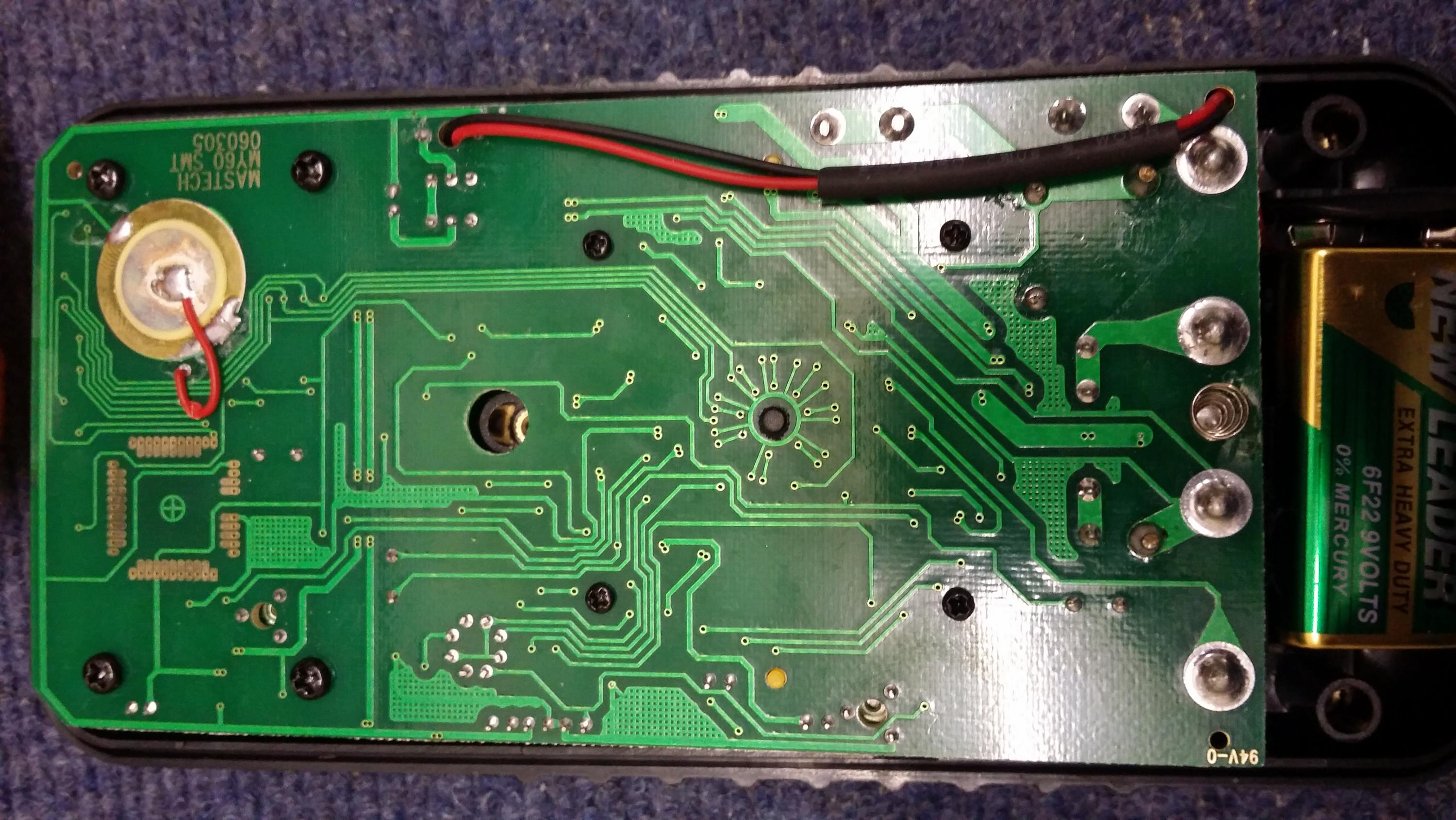

          • retiredcaps
            • Apr 2010
            • 9271
            Re: Multimeter problem
            Originally posted by quiggy
            I had it open earlier, I didn't see any visible damage, anyway I'll post pictures later.
            If it is a name brand good quality meter, there is a possibility that the front end input protection did its job and saved you and meter from harm.
            Testing the input protection components is fairly easy with another working meter and replacement parts can be found.
            Good clear focused pictures of the make, model and pcb (both sides) will help.

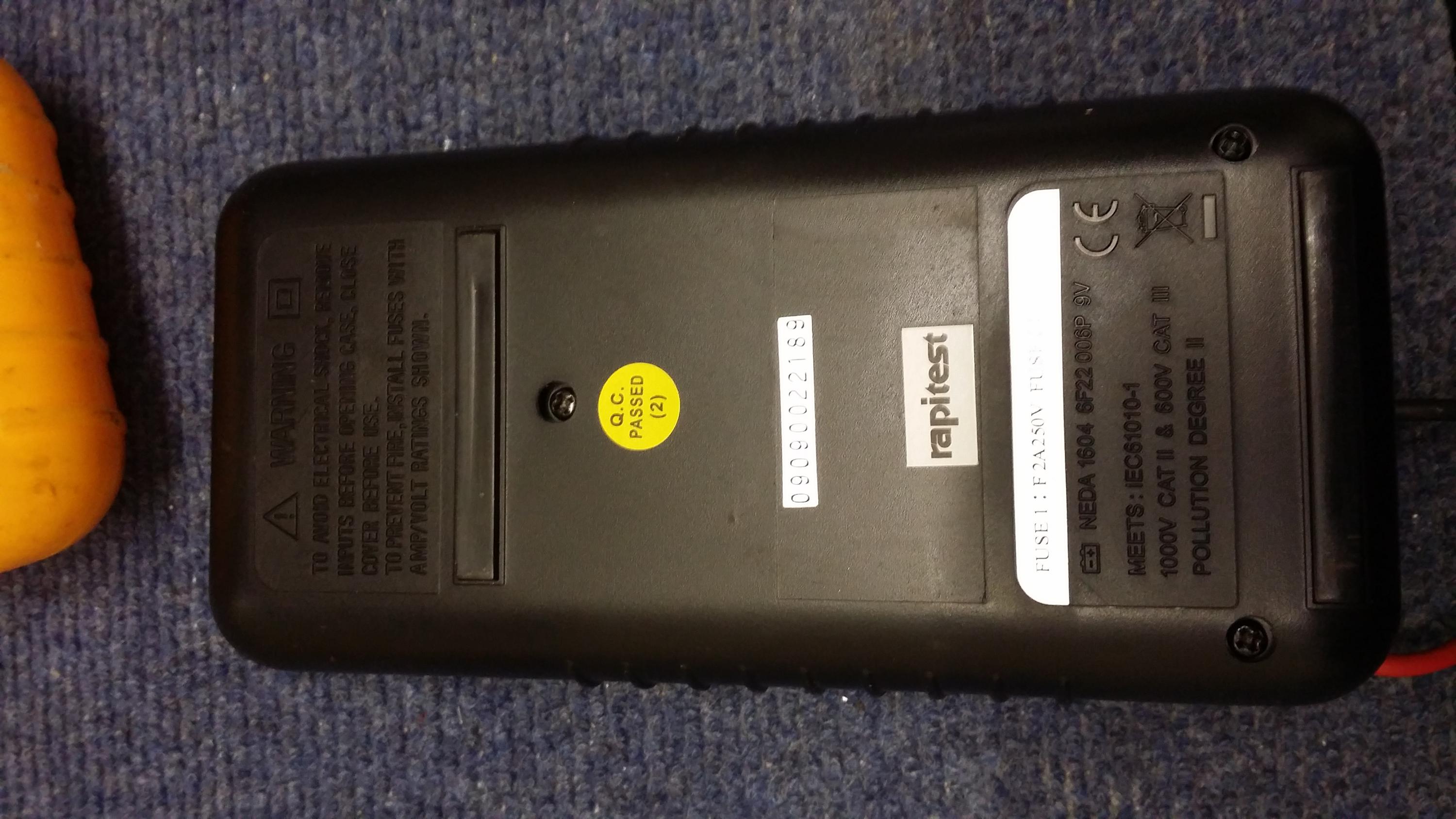

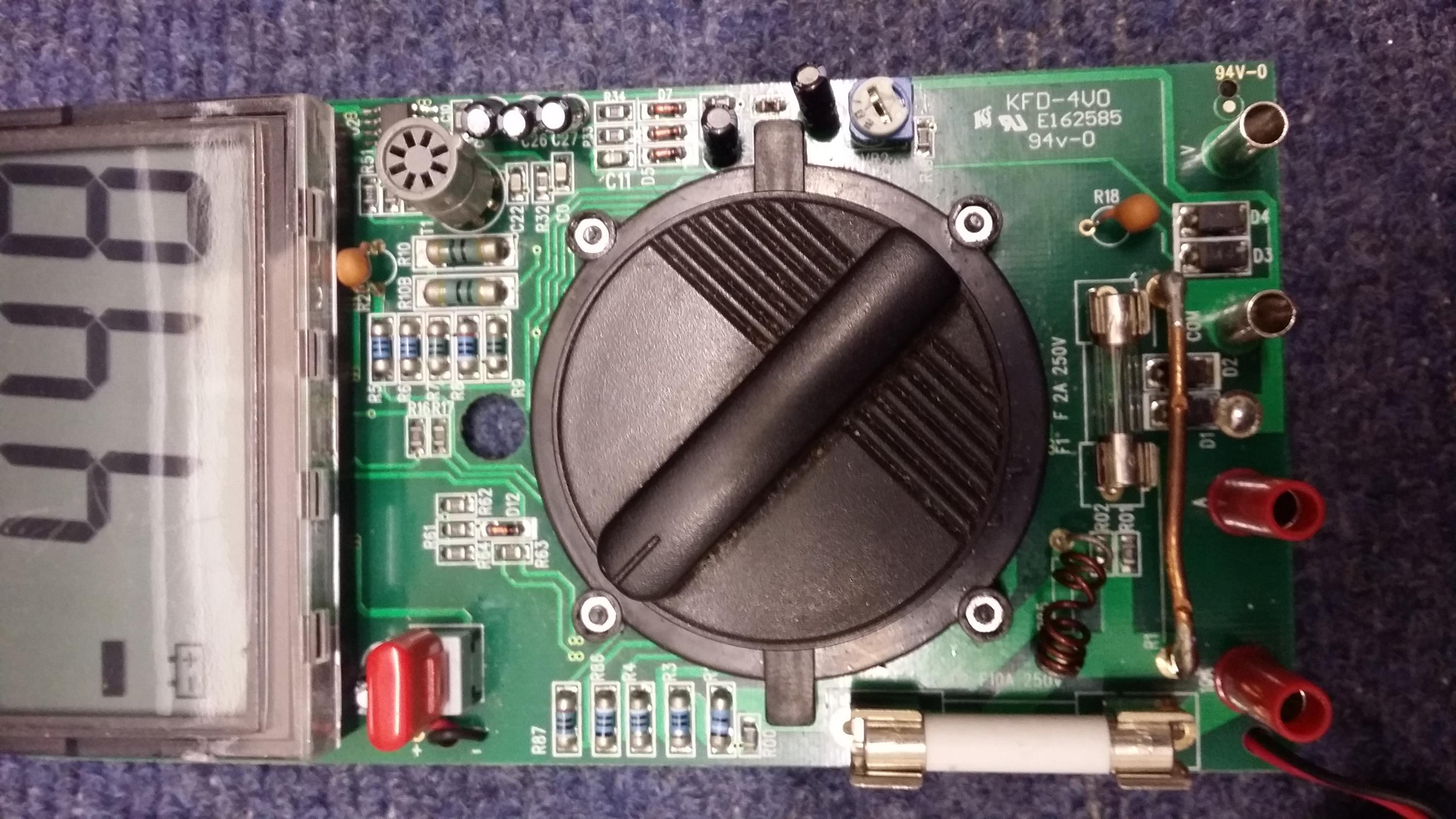

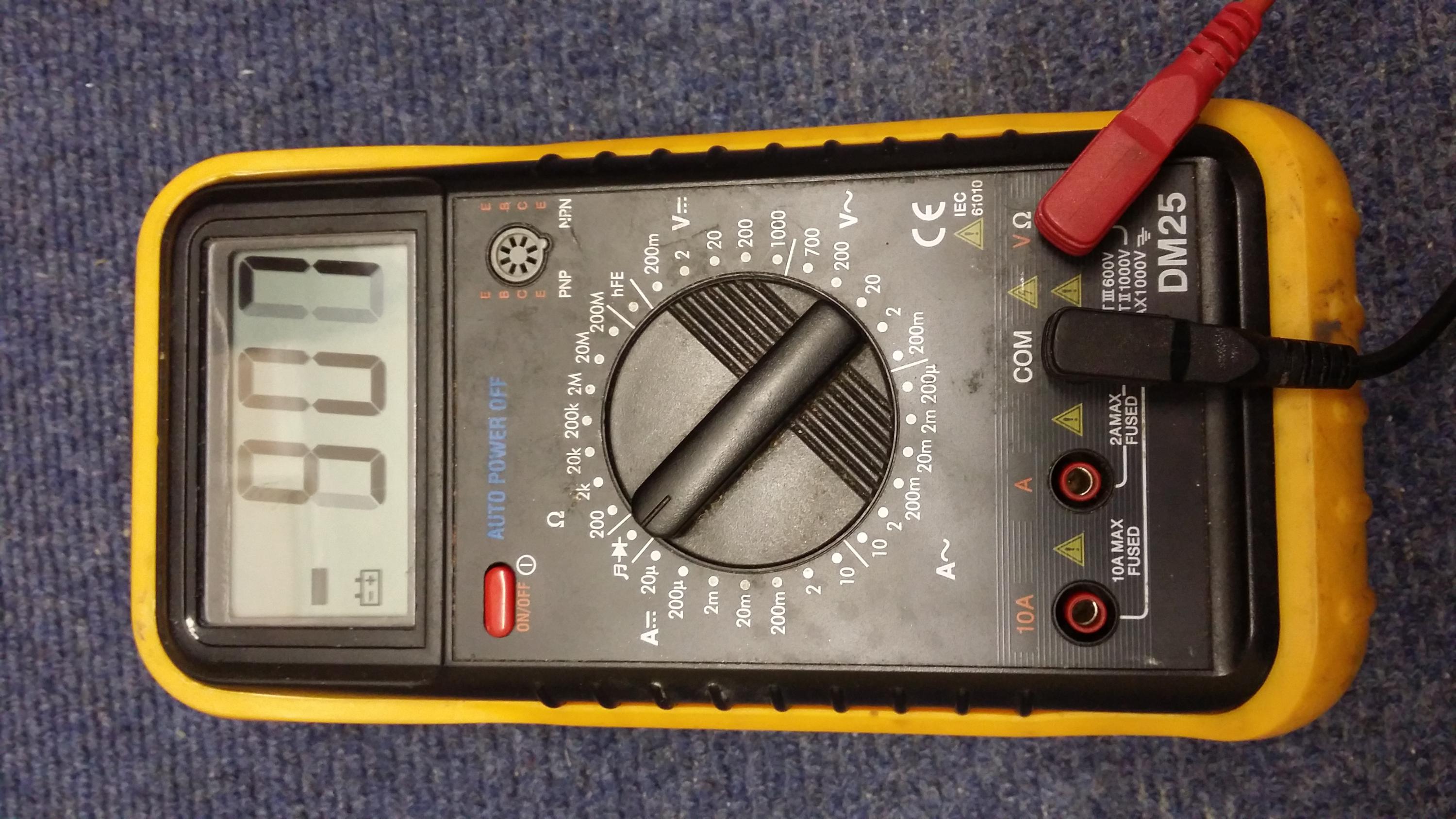

              Pictures of my meter, i can get close ups if needed
              • vinceroger69
                • Mar 2012
                • 6714
                • uk
                looks like you had it on dc volts then but was testing ac volts acording to ur post 1 maybe the white fuse has blown have you got a spare multi meter you can borrow to test the fuse.your post 3 says you had it on ac 1000v but looks like ac volts goes to 700 volts did you have it on ac symbol?
                  • 30983
                  the coil between the fuses looks cooked, the diodes near the probe sockets need a better look.
                  the tiny resistor or whatever it is to the right of the rotary wsitch looks fucked,
                  and i think that's a low battery warning on the display.
                    I would check D1~D4.
                    Wht position of the selector switch was it in when you were trying to measure the AC line?
                      Looking at it now it was probably an oversight on my part with 1000v dc and 700ac being 1 click away from each other. So totally my fault lol

                                Is it possible you had the probes pluged into the amp (A) or(10A) instead of the voltage (V Ω) when you measured the Voltage, that would do it.
                                  Auto range is not going to solve the AC/DC wrong setting. He was 1000VDC and still blew up by 230VAC (648V P-P).
