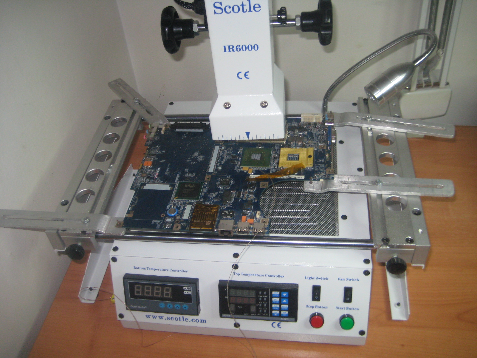

    Hey guys,
    I bought several repair equipment from a closed shop, unfortunately the equipment came without manuals and some parts, on site manuals are very incomplete and I'm getting frustrated because I can't fully understand how they work. Some help from users with similar equipments would be appreciated.
    Scotle IR6000 V4
    Configuring bottom heaters was easy, set H and L temps and it's done.
    -The real problem is configuring top heater, programs and respective heating ramps. I saw a couple of videos and I understand how it works, but I'm getting completely lost on the configuration. Complete documentation would help understanding how to navigate through the configurations.
    Also, if you have some remove and reball profiles you'd like to share for this device, I'd appreciate.
    -Another thing missing is the serial cable. Not all that serious, but I'd like to grab the opportunity and ask help on building a cable serial to USB.

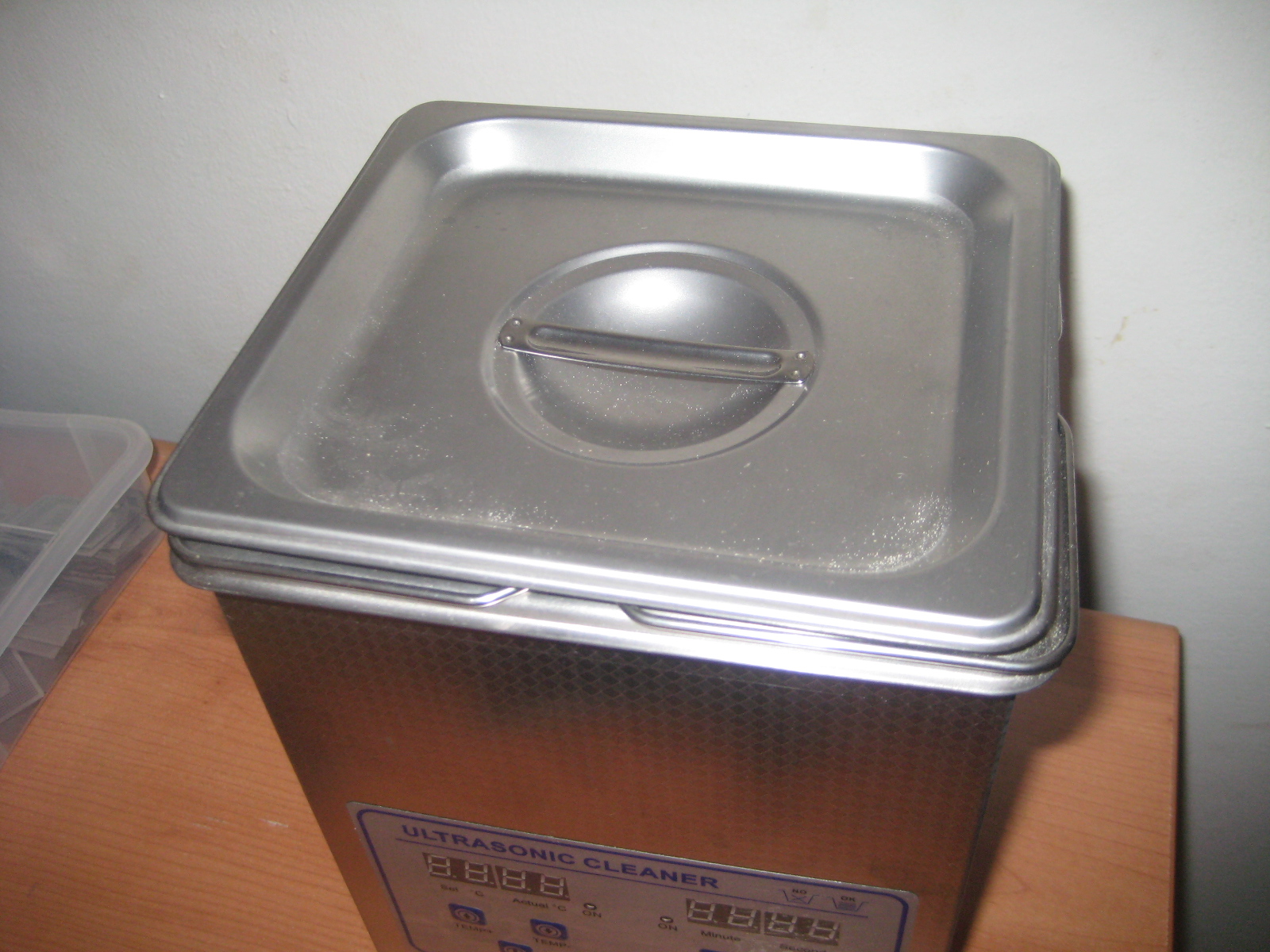

    Skymen Ultrasonic Cleaner JP-010S
    http://www.skymen.cc/product02/16/JP010S.html
    I want to use this mainly for phones droped in water.
    - What liquid do i use? It's so confusing, tab water, alcohol, solvent cleaner, mixes.. I can't figure out what I should use.
    - Also, any info on heating or ultrasound time profiles on this?

      Im using 100% IPA...
      But don't forget to buy cleaner with metal lid, otherwise the IPA fumes will melt it...
      But it's not only about cleaning...you need to rework all the corroded components...many times caps and filters going broken or missing after water damage... (Especially those in lcd circuit)
      You can't kill mobo in ultrasonic bath, however sometimes had ripped balls under pmic or other ic's which may have been corroded or had weak joint...but still better to reball in place than get return from customer after week or so...

          about the bga unit.
          nobody can give you the "profile" as we call it.
          the heatup, sustain and cooling ramps are dependant on several factors.
          the solder on the parts,
          the flux you use.
          the equipment,
          the board itself.
          you have to work them out from flux datasheets & experiments.
          on the console forums, people guard the profiles they use like they are made of gold.
          a good profile will fixx almost every reflow, a bad one will fail a lot.
          as most people use the same kit, the profile is sometimes the only way they compete for customers.
          i'll give you some hints.

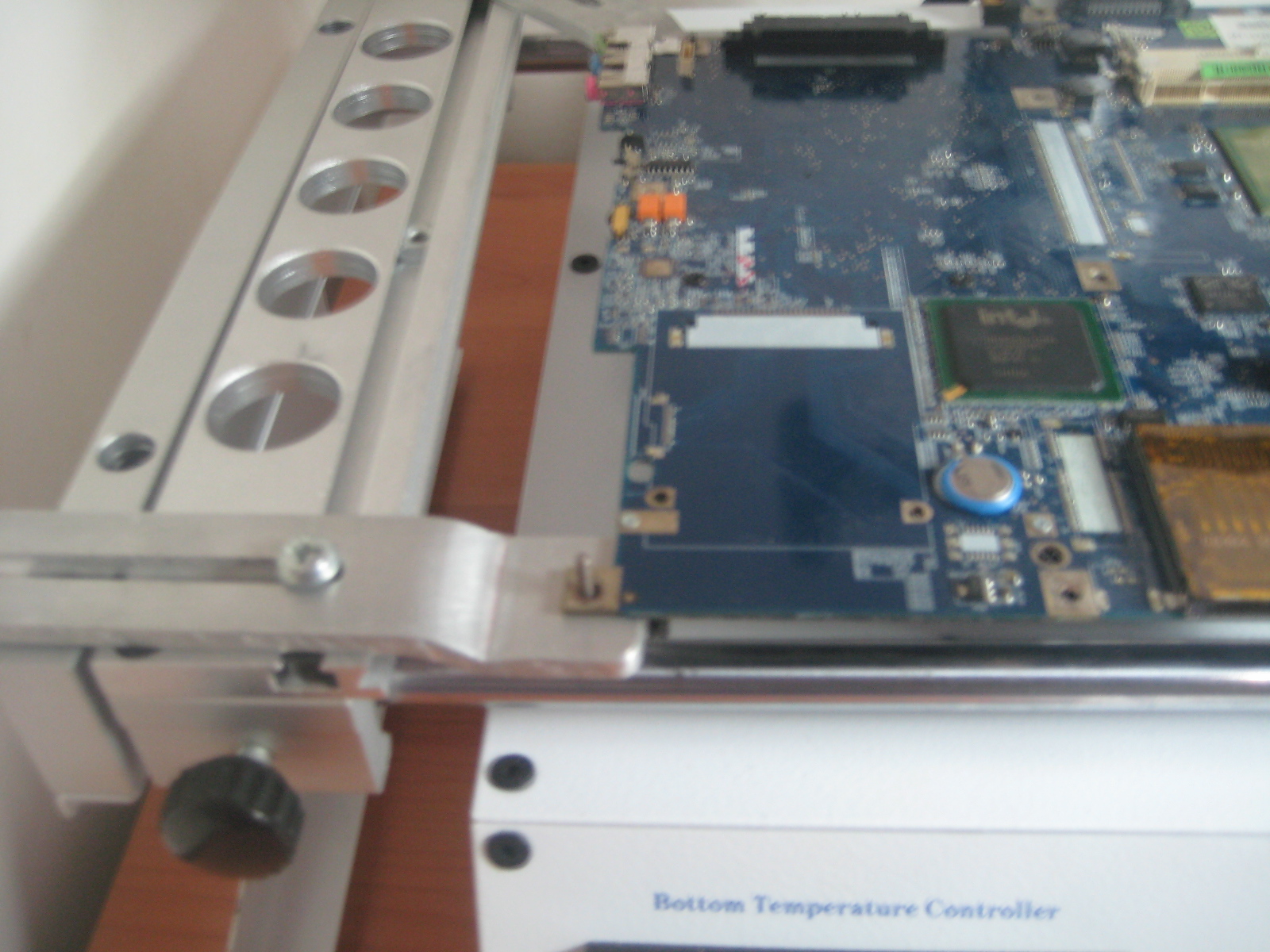

          1: bring the heat up slowly on the pre-heater.
          2: bring the main heater up to the temperature needed to melt the solder and sustain it for the minimum period to get a good liquid flow.
          3: drop the main heater down befoe you shutoff the pre-heater.
          it's al about not warping or de-laminating the pcb.
          and that's another thing, to stop warping you need a good pcb clamping frame.

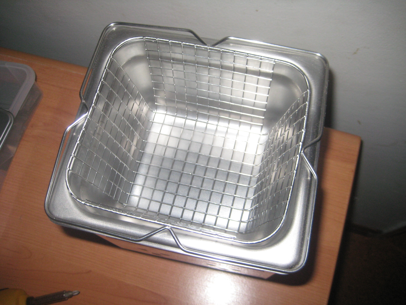

            I have other questions..
            My machine has metal lid and basket, using IPA should I remove the basket to diminish the vapors released?
            Do you use heat? If yes, what temp?
            For how long you use ultrasounds? I've seen some videos up to 10min with water, will it be the same on IPA?

            Nice tips on flux datasheets and clamping frame, all new to me. Will have to read a little more about flux, but regarding the frame, before I was thinking in stretching the frame and use corner holes to hold it, but now I've read your post I'm thinking that might warp the board.. Should I use a couple of straight metal rods to keep it as straight as possible instead of its original clamps? See pics for original clamps.
            I really need help in how to navigate through ramps configuration!
            I'm not being able to configure L1 temps after r1, much less r2,3, etc.. can't get to the nr. of ºC per second or configure the hold temp time, etc..
            And i have no idea how to save the prgrams!
            I know my main difficulty is understanding the menus navigation, if I could get some documentation on this it would do wonders for me!
            Thanks!

              Hey guys, I finally caught a video that made me understood part of the machine and how to configure the ramps. I successfully removed a chip but I believe I removed some pads (3 in the upper right corner), see pics.
              I noticed that my bottom heater and board temp came higher much faster than the video.. In the video the temp came up slow and nice, the board temp was pretty much side by side with top heater and just a tad slower. In my experience, board temp was already at 178ºC when top heater was still arriving at 110ºC ramp..
              http://youtu.be/i0sSvmNOaic
              My profile was the same in the video.
              r1-0.30, l1-110, d1-60
              r2-0.55, l2-150, d2-30
              r3-0.55, l3-190, d3-30
              r4-0.55, l4-225, l4-120
              r5-end
              bottom heater ah-300, al-280
              My question is, can I slow down the bottom heater heating time?
              Thanks.

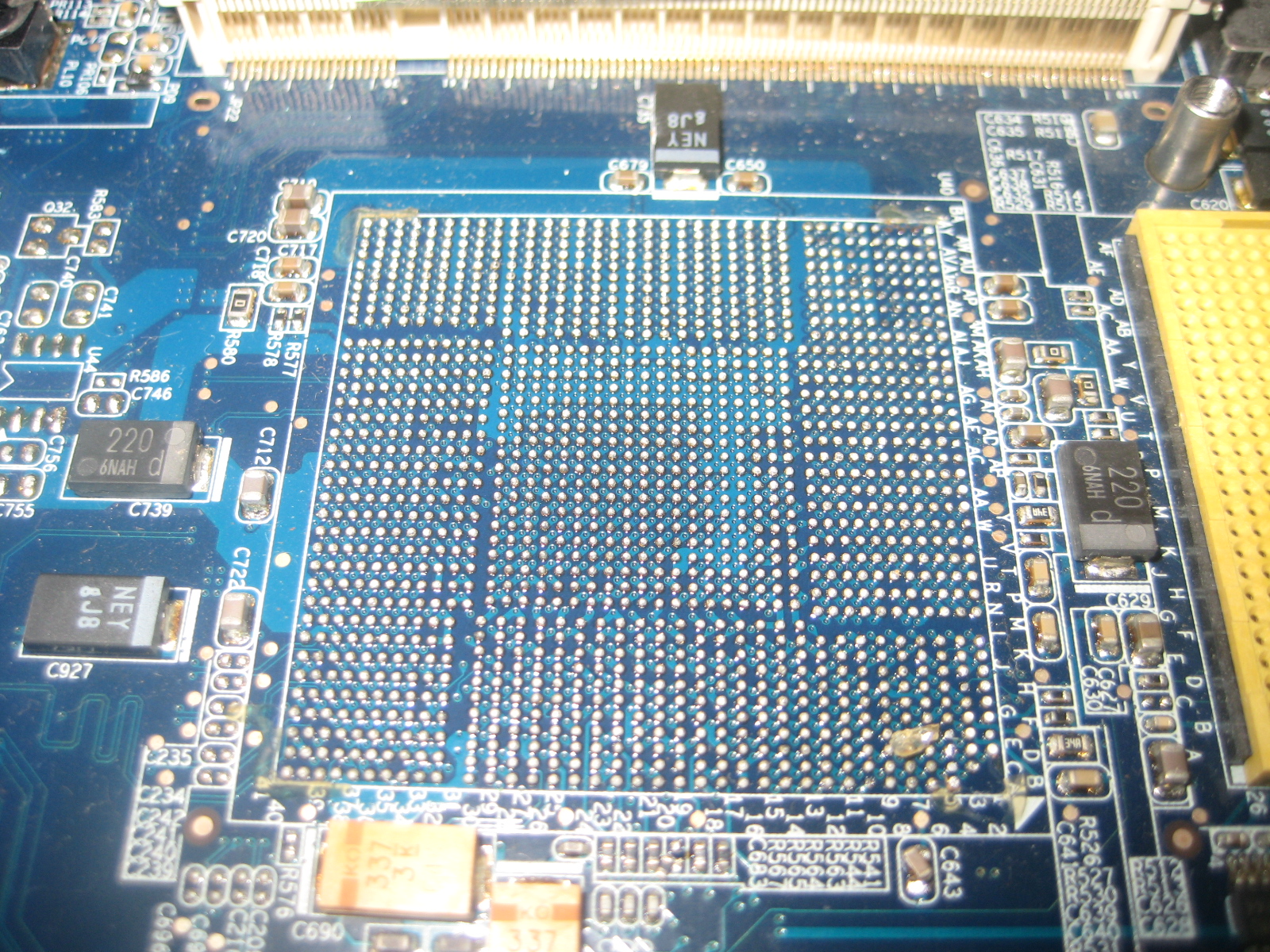

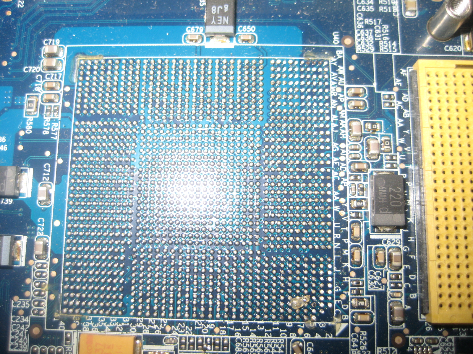

                hi, on the upper right of bga i see some pin missing..... were those a Nc pins or they had connection point? if nc is not important if you damage them, but if they weere conncted then you have to rebuind them and work get harder (except that board was for testing as it is your first job .
                Best to get 5-1' board damaged where to practice.
                also a good idea is to spread solder paste and see if a 185° it is all melt properly, becouse some corner can get lower temp respect center and so on.... better practive very much about that.
                about ramp rate... dunno what that value stand for... ° celsius to get for each second?
                if it's that ill go for 1° at second till 150° then 1.5 max till 185° for leaded,
                1° till 190 for lead free then 1.5° till 225°
                important thing is also time u keep that temperature.
                before remove the bga, move it and check if it's all desoldered.
                https://www.youtube.com/watch?v=sZ5083Wvh1A
                here is me removing a lga socket. as u can see my temperature sensor is really wheaked (the original one) but with practice you can do a good work.
                (im waithing to buy a better thermocouple).
                look on youtube for some bga video for testing the machine (liquid solder paste, temperature checking, heated area zone...)
                for chean the bga, get a good goodwick remover. i have had one that damage the solder mask because the wire weere too small (in the goodwick)
                when desolder, is always better to add kapton+ alluminium like in my video.
                good work with your good machine.
                edit: looking better your picture, one cap got moved... so better kapton+ alluminium

                    Oh and if you have a basket just leave it inside...if you got enough space between bottom tank and bottom of basket there's no need to turn the boars over...

                      Before anything else, thanks for such a detailed answer and all the help and advices given. I'm so grateful for your push in the right direction i might have to make a trip to around the world just to buy you a all beer.
                      Originally posted by dellxps15
                      hi, on the upper right of bga i see some pin missing..... were those a Nc pins or they had connection point? if nc is not important if you damage them, but if they weere conncted then you have to rebuind them and work get harder (except that board was for testing as it is your first job.
                      Yeah this board is for testing.. I want to make sure I dominated both removing and reball before I go on other boards.
                      will do, thanks.
                      r1-0.30ºC per second, l1-110ºC range, d1-60 seconds pause before proceeding to ramp 2.
                      isn't that too fast? I've read it's better to advance slowly to avoid warping or de-laminating the pcb..
                      keep what temp? max temp? right now i have 120sec configured but i wait about 30sec and give it a nudge to see if it's ready to remove..
                      I did noticed my goodwick remover might be too thin.. I removed the solder nicely but it fills really fast, forcing me to stop and adjust many times..
                      Yeah C643 moved but i believe it was the tweezers, not my aluminum tape.. Can you please upload a photo of your kapton+ alluminium and goodwick remover? I might not find those brands here but i can look for similar.

                        Yeah it seems my basket has enough space to clean both sides at once but lid doesn't close properly with basket in it..
                        Is it a bad idea to use duck tape to close it totally?
