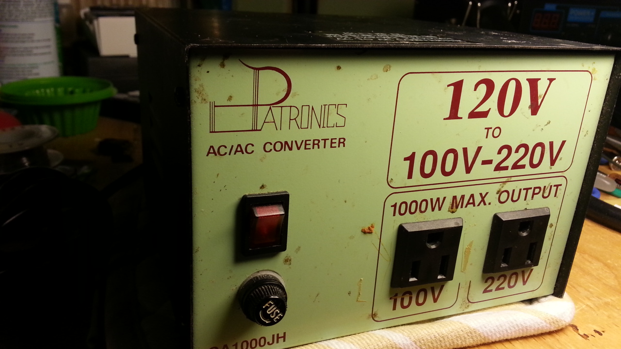

    Patronics CA1000JH. Two outlets, a switch, a fuse and a large transformer. That's it. Bought it for $8 at a resale shop.

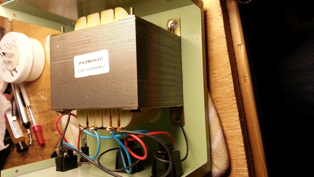

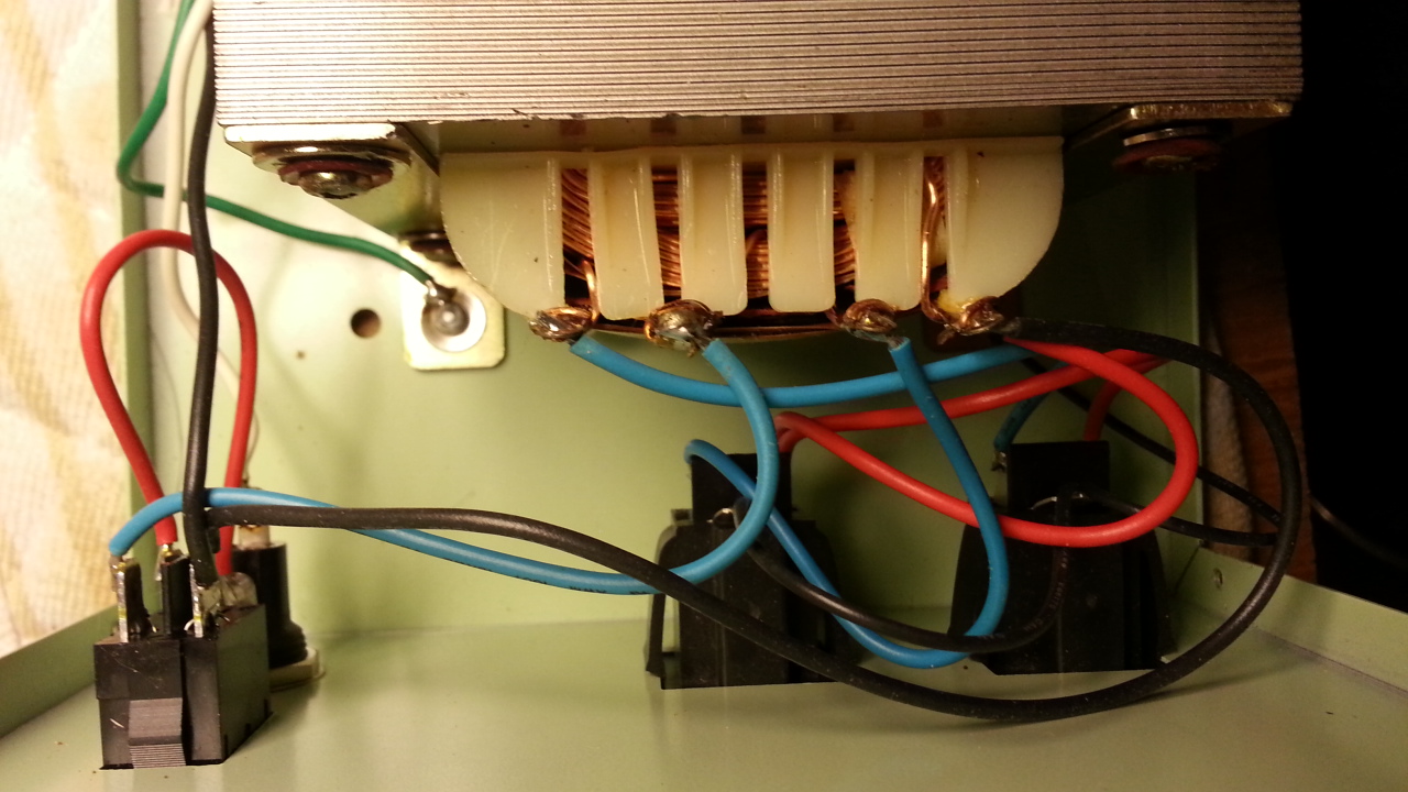

    No, the bad part is that, they put the AC power input fuse on the Neutral (White wire) instead of the Hot wire. You should verify that Hot and Neutral wires are properly wired up.

      How do I verify that ? I plugged a lamp into it at the store and the lamp came on.
      If it's not an Isolation Transformer then what is it ?

        its a buck/boost transformer. 220v for australian junk and 100v for old radios.
        (thats what i use mine for at least)
        Follow the white rabbit.
          Re: Is This an Isolation Transformer ?
          It is an multi-tap autotransformer. You can use you AC voltmeter and the measure the AC voltage between the Neutral and Ground, Hot and Ground to see what you get. In US, the Neutral is tied to ground at the circuit breaker panel, so Neutral to Ground should show 0V (it may show perfect 0V if there is load in the same circuit using that same Neutral wire.

                Yep autotransformer. There is no isolation - you can see that one wire of the input (120V) is connected to both outputs - that's not isolation.
                It's how to get 220V for European devices in the USA. I was wondering about Patronics, is that a Canadian company? They don't seem to be well listed on Google.
