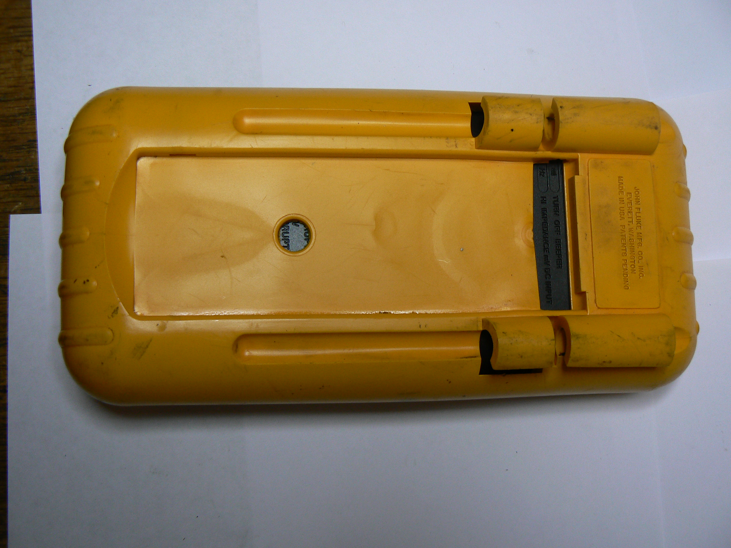

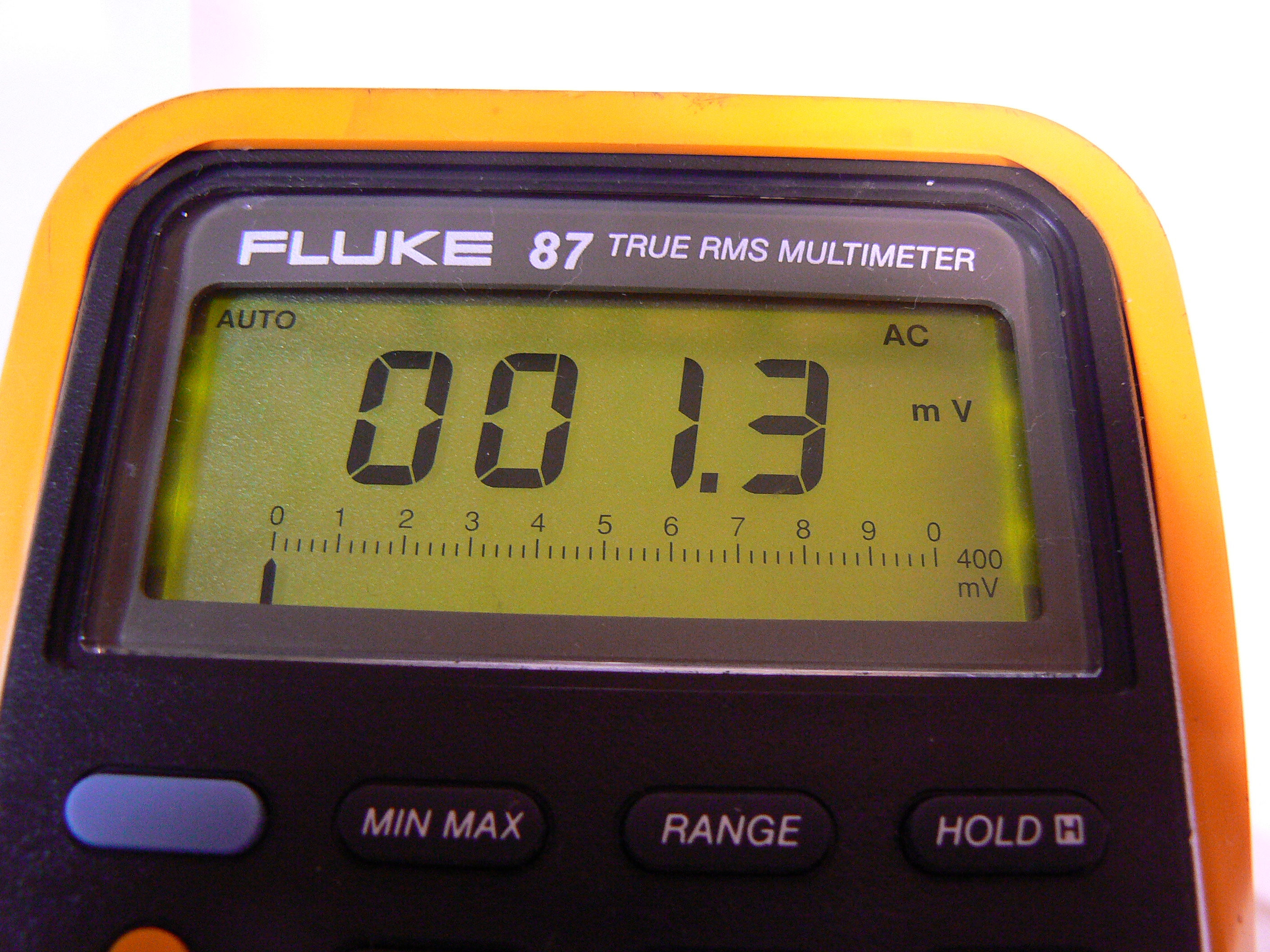

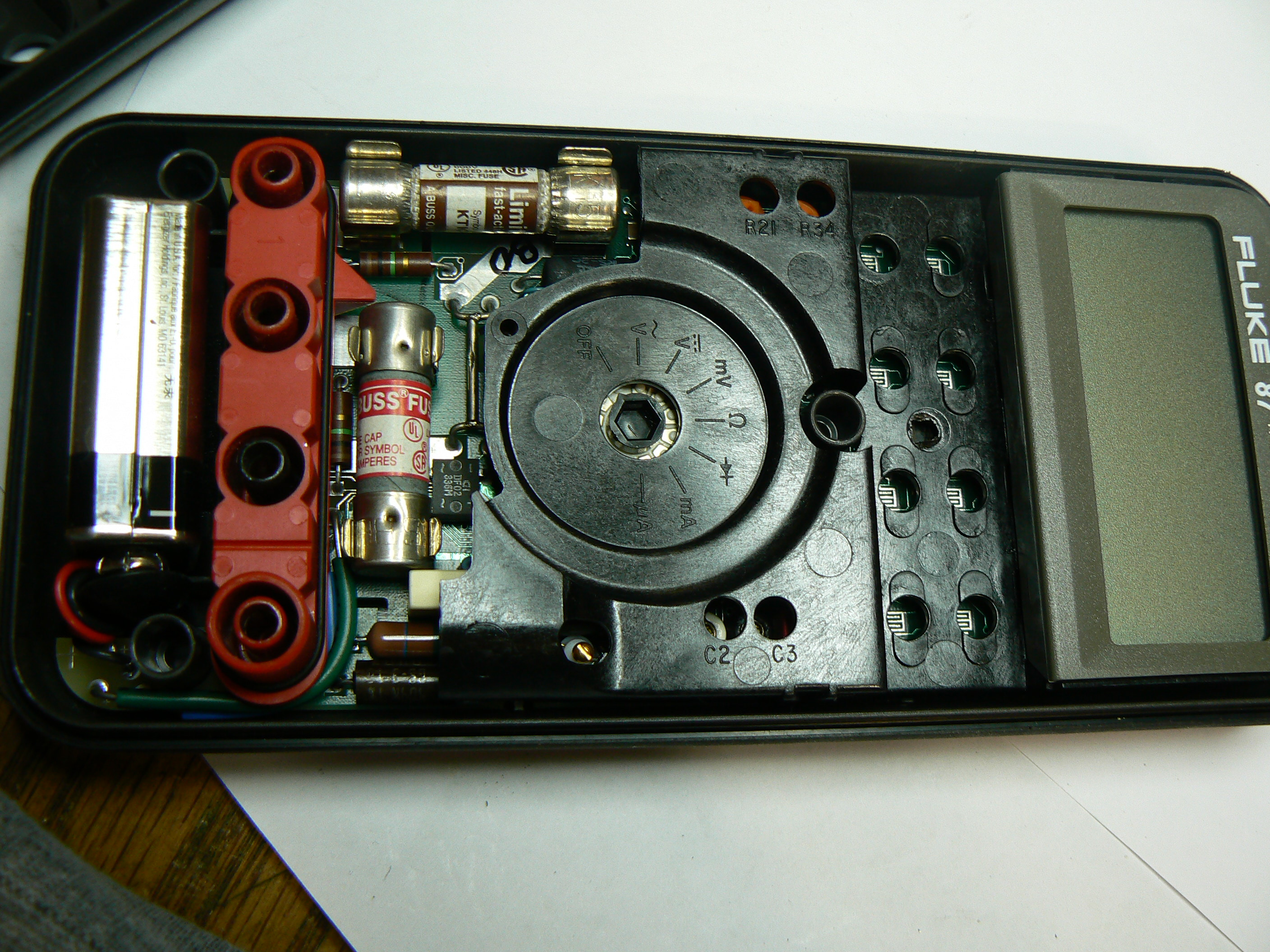

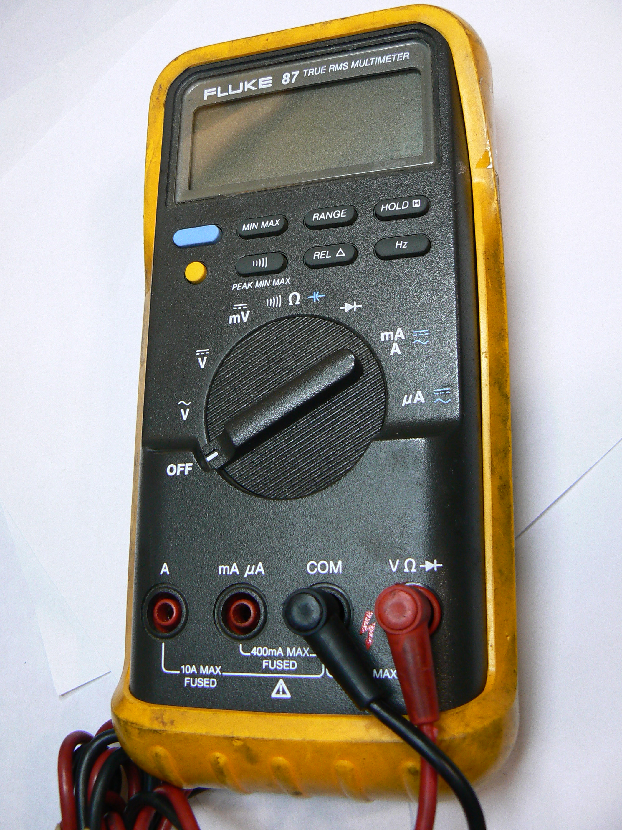

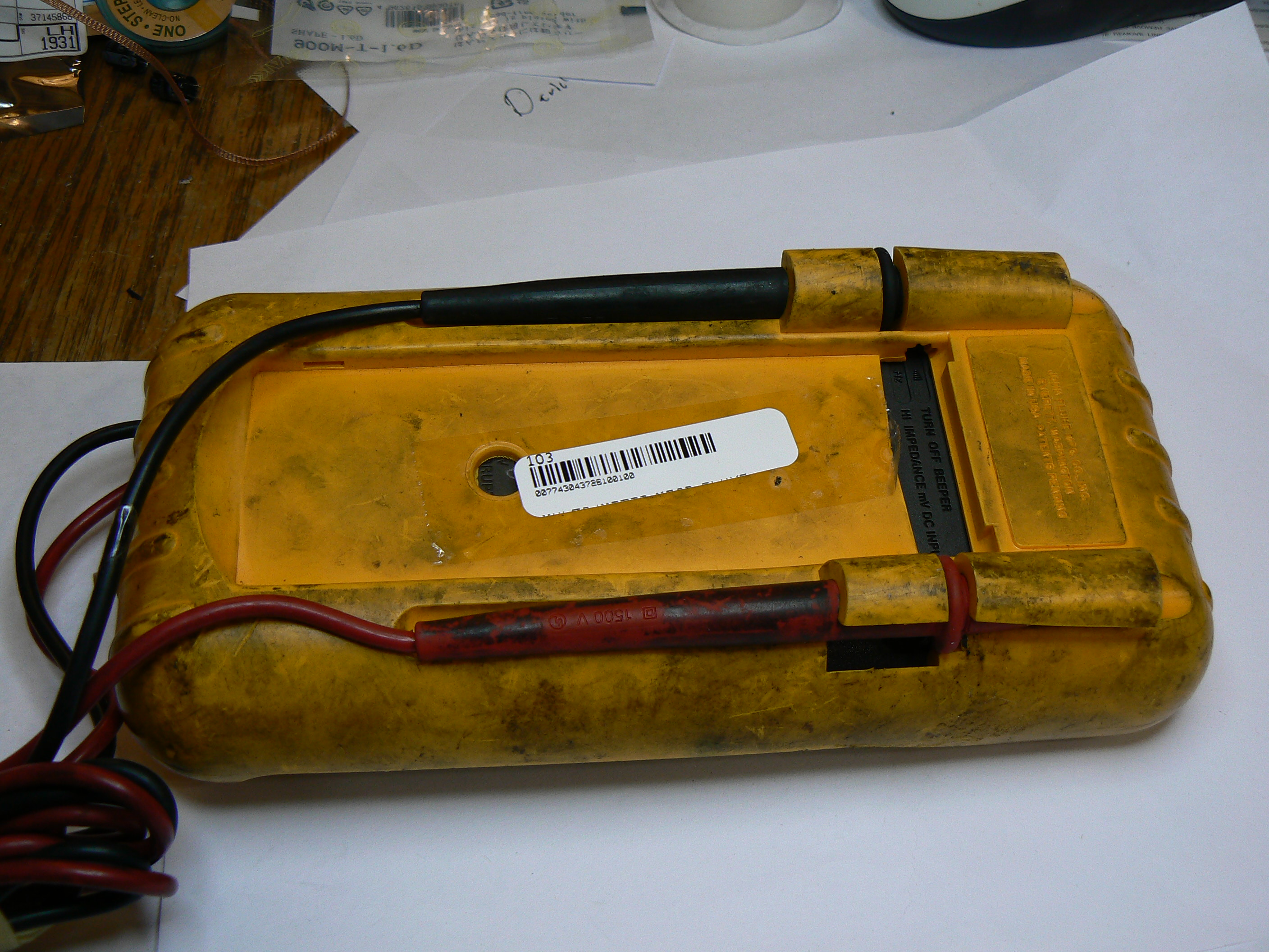

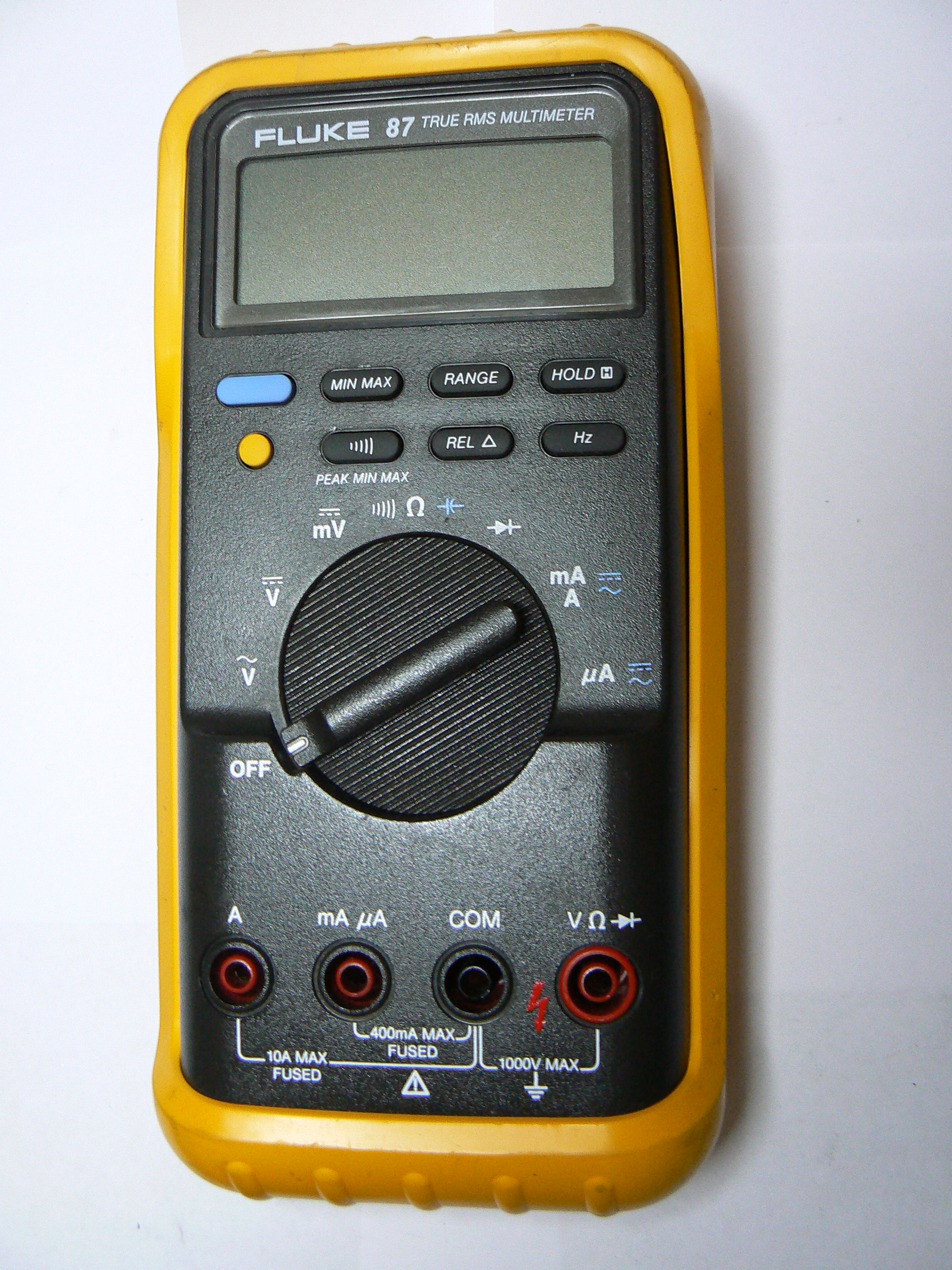

    I recently picked up another meter from a local pawn shop, this one is a Fluke 87. When I saw it I was immediately attracted to it because it had lots of features in one meter that I previously only had over several meters. I also liked the display but I later realized that it washes out really bad when viewed from the top. When viewed straight on and below it is bright and crisp. Although I knew there have been several iterations of the 87 model I was not aware of how old this meter really was, it was actually manufactured in the early nineties.
    It had a few other problems like the low current fuse was bad, the "kick stand" was missing and it was dirty. The probes it came with are Flukes but they were (as Dave says) very crusty. I think it cleaned up rather well in the end but you can judge for yourself as I have included some before and after pictures below. I have already made a crude wire kick stand for it but I intend to make something more permanent when time permits.
    The one thing I could kick myself for was that in my enthusiasm to rip it apart after getting it home I broke one of the clips that attaches the screen to the PCB. So far it has not affected the meters operation and I have an idea on how to bodge a repair when I have the time to do it.

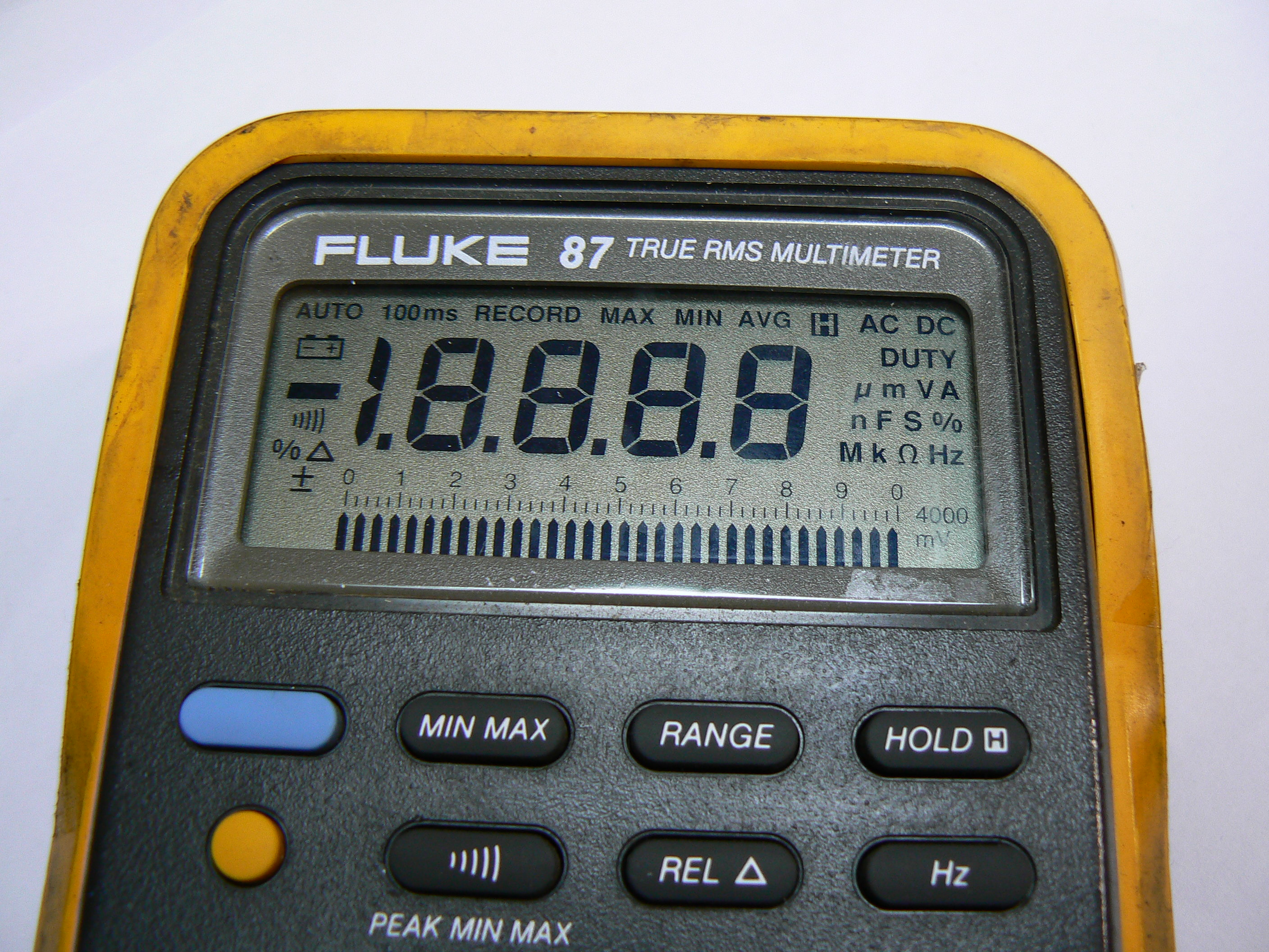

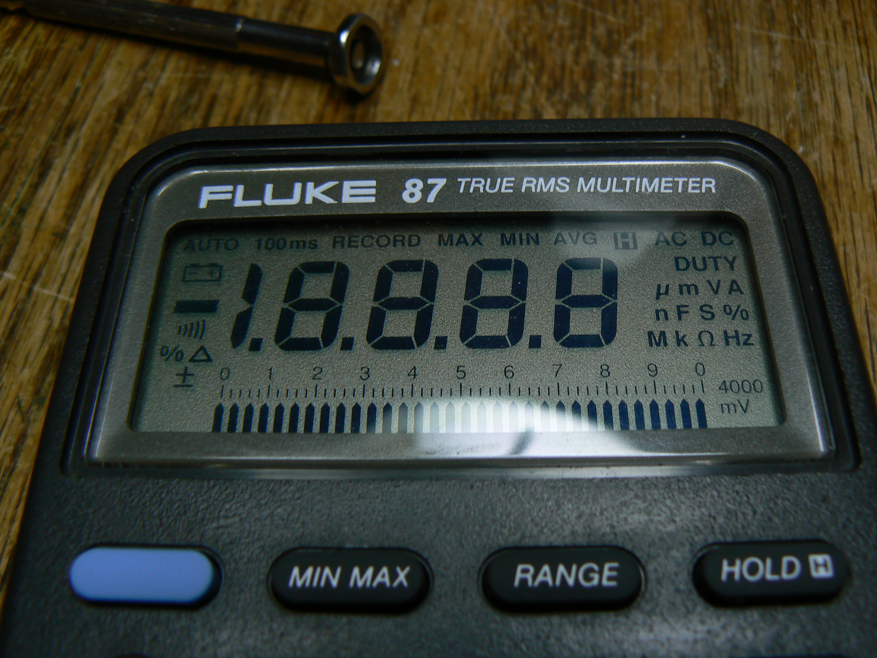

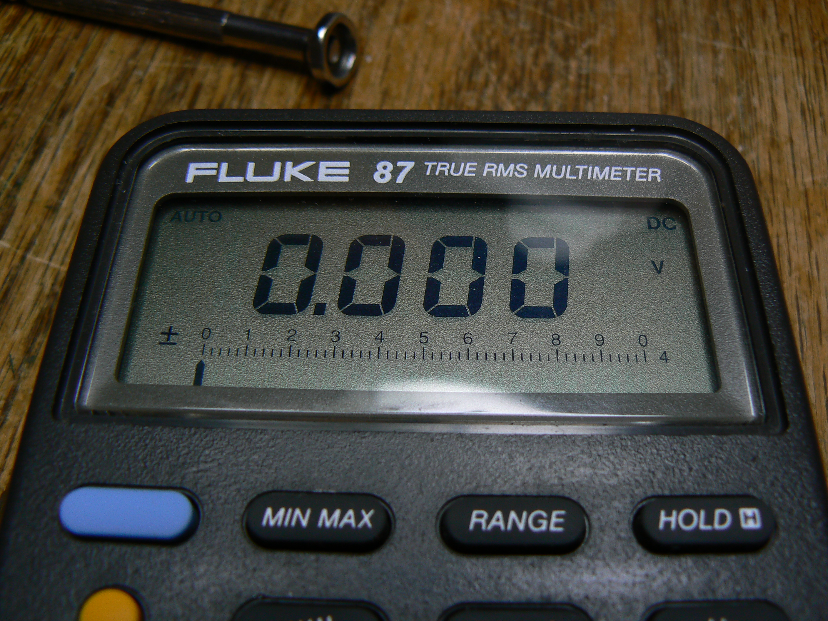

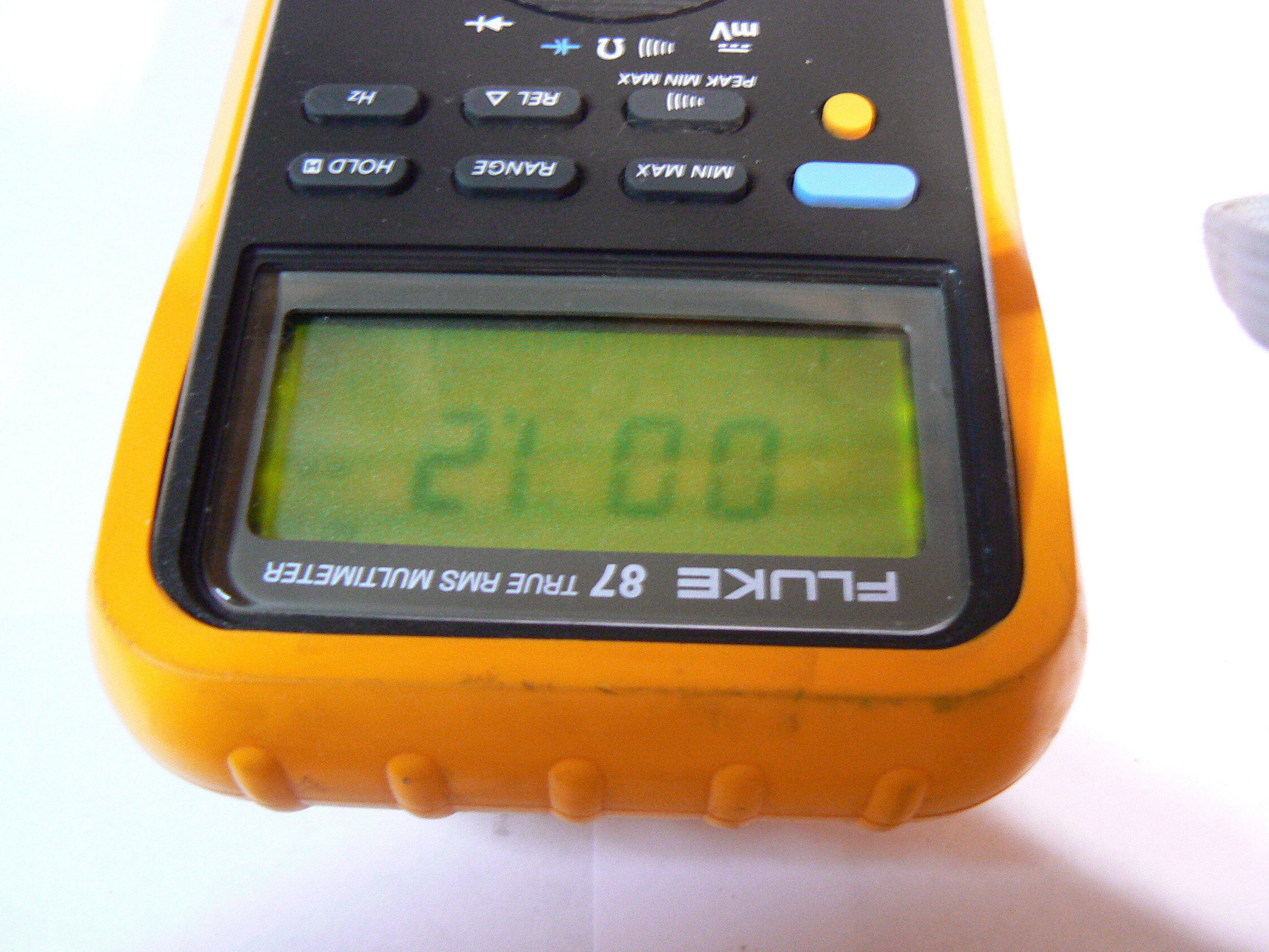

    Some of the older original Fluke 80 series suffer from the faded digits due to contamination of the elastometer. Modemhead has documented the cleaning procedure at
    http://mrmodemhead.com/blog/fluke-8x-faded-lcd/
    I have cleaned two myself with good results.
    Pumice hand cleaner works really well to clean up the holster. It almost looks new and all the markings are still on it!!

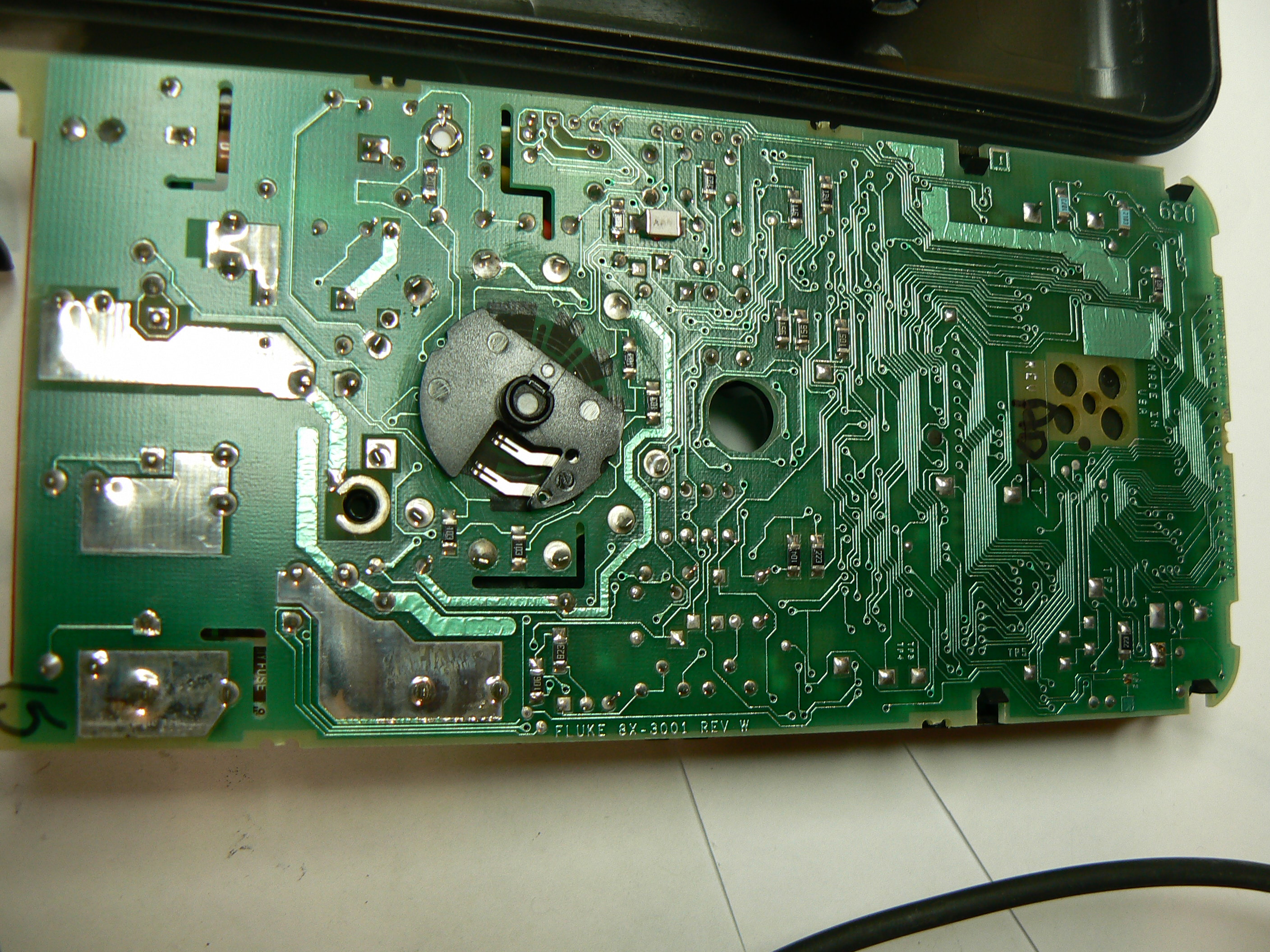

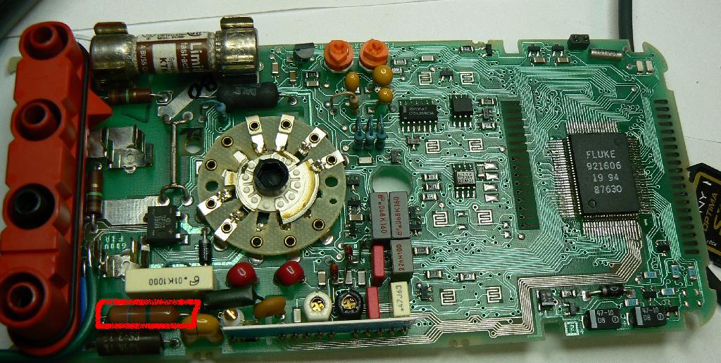

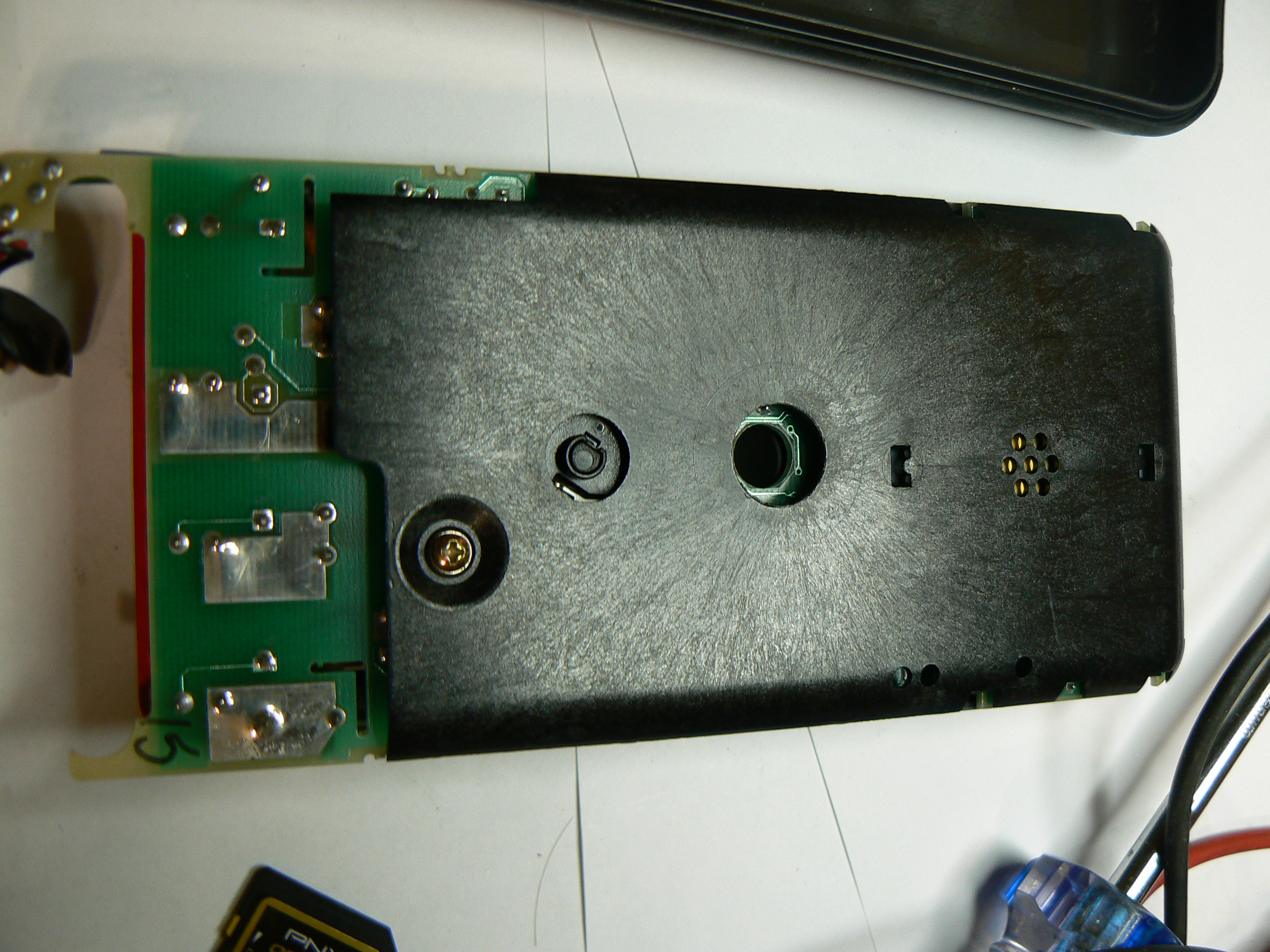

    The fusible resistor (circled in red) seems a bit toasty? Or is that a photo trick? I would measure it to make sure it is around 1 kohm.

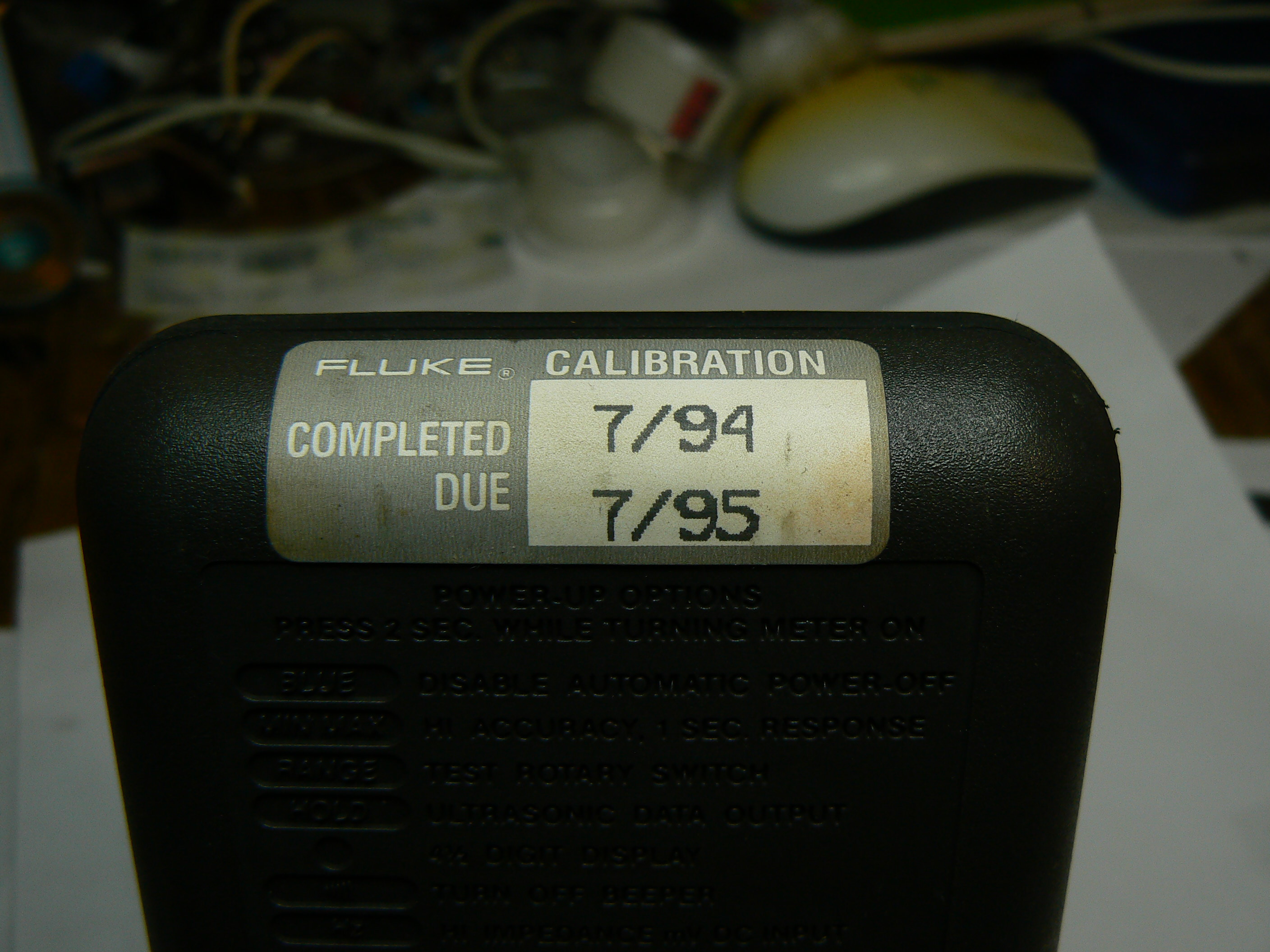

    Even though it was last calibrated in 1995, it is likely to hold and be within specifications.
      I will check that out as soon as I get a chance, but it did not raise any flags when I was looking it over. (Not that means much.)
      I compared it with my Fluke 175 using two AA batteries (~3V) and they both gave me the same reading. I have not yet done any other comparisons but I need to do so.
      I will also check out Modemheads blog, I have probably already read that article but it will have a lot more meaning too me now.
          Nice find! Looks to be in excellent condition, especially with the clean-up job.
          The viewing angle thing is just a property of that LCD. It has the best contrast at a slight downward angle. Somewhere in the fog of my brain I remember reading something about that being a design trade-off, bias voltage vs. minimum operating temperature and other things I don't understand. The III and V generation displays are improved a bit in this respect.
          Being new to using an 87, here's something to be aware of. It LOVES to take itself out of auto-ranging mode. For example, if you select Ohms and then enable continuity (beeper) mode, and then go back to Ohms, it will be in 400 ohm range and auto-ranging will be off. It has to be re-enabled by holding the range button for a couple seconds or flipping the dial away and back to Ohms. This happens for a lot of the functions, like Min-Max, Hz, etc. It can lead to some head-scratchers if you forget. Like measuring a 1K resistor with it stuck in 400 ohm range. "Why did this resistor go open-circuit?"
          Sorry I don't have a fix for the broken clip. Duct tape?
              I figured it was something like that, good thing I do not use my meters upside down very often.

                One of the ICs has what looks to be a 1994 date on it; as does what appears to be a factory cal sticker (which probably cost the purchaser extra). So whatever version of the Fluke 87 was made then would be what you have. All in all, a very decent handheld DMM.
                  I think the color in the picture is due to the lighting. It actually looks really nice in person. (I know that sounds strange, but it is one of the best looking resistors I have ever seen.) It measured 1.001K ohms on my Fluke 175.
                  Good catch on the date code, I did not notice it on the chip until you mentioned it. Since Fluke introduced the 80 series in 1988, it is not near as old as it could be.

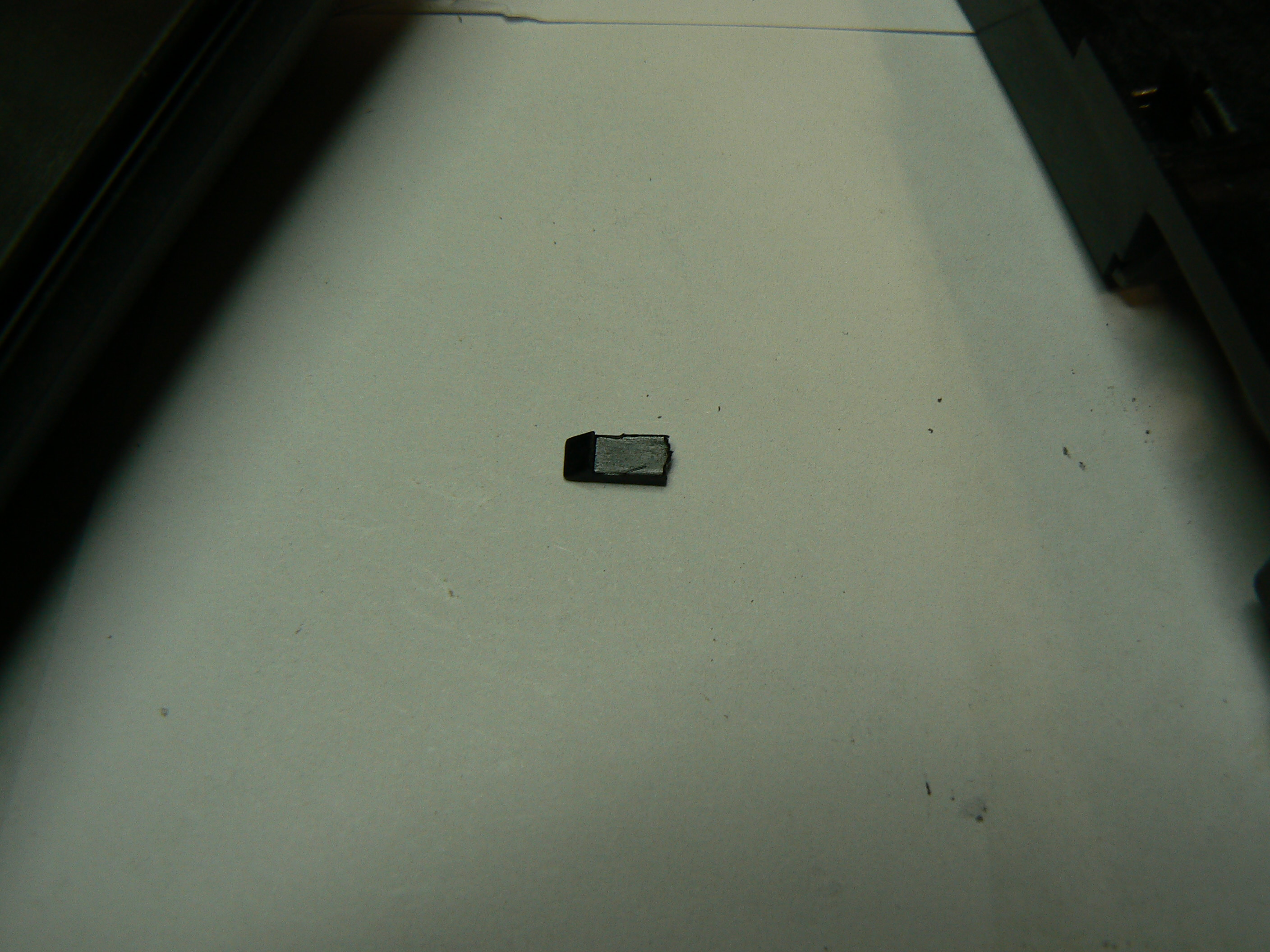

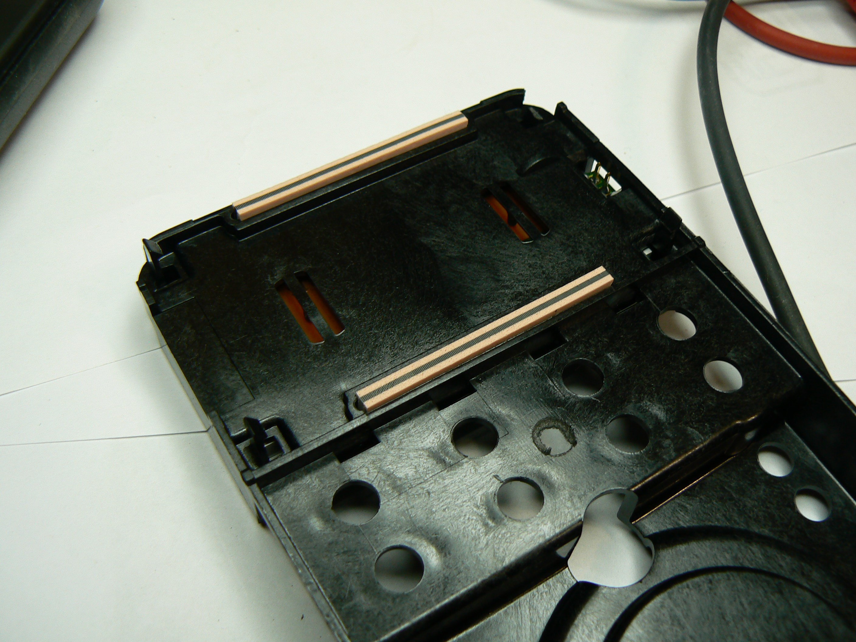

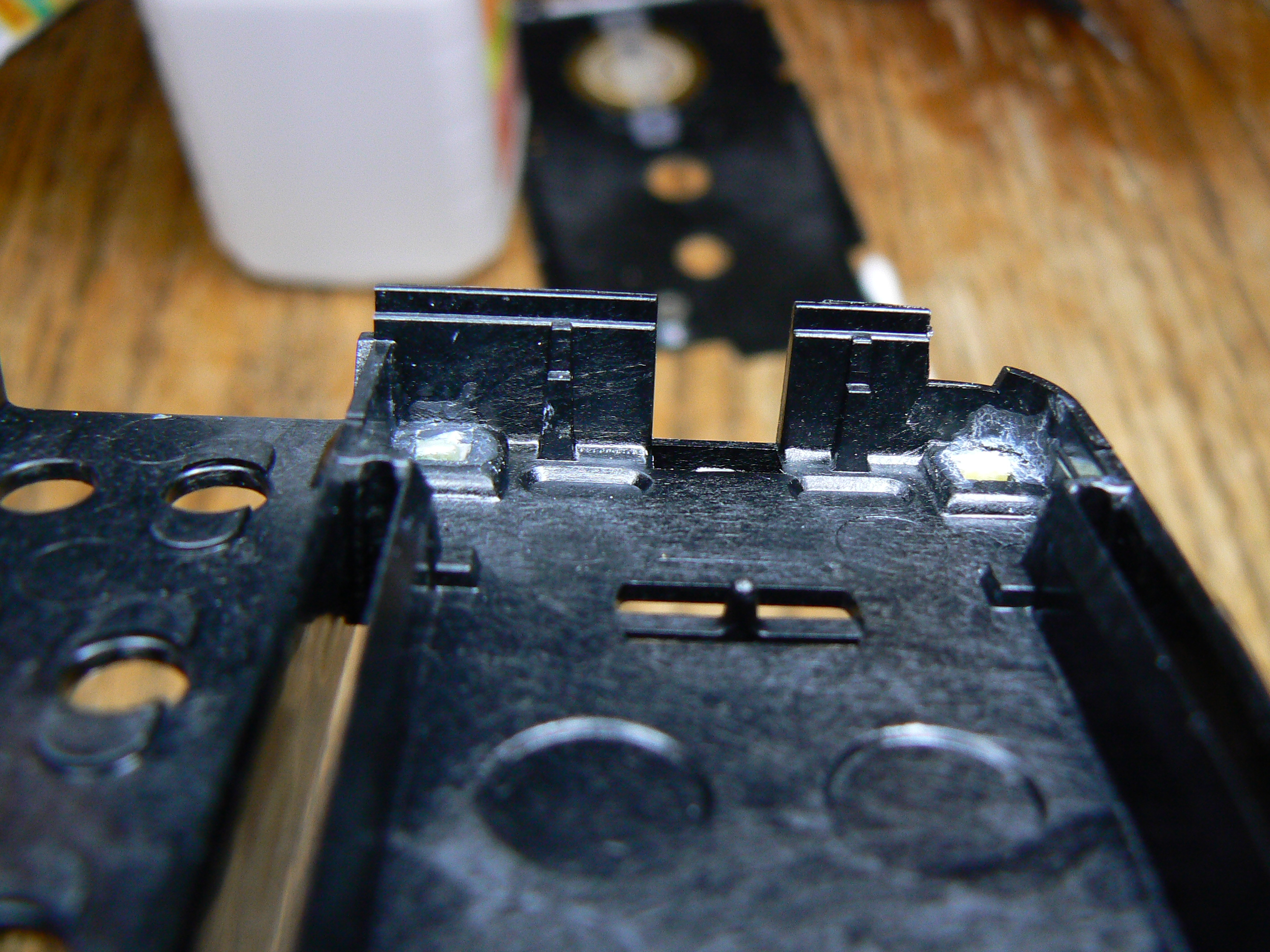

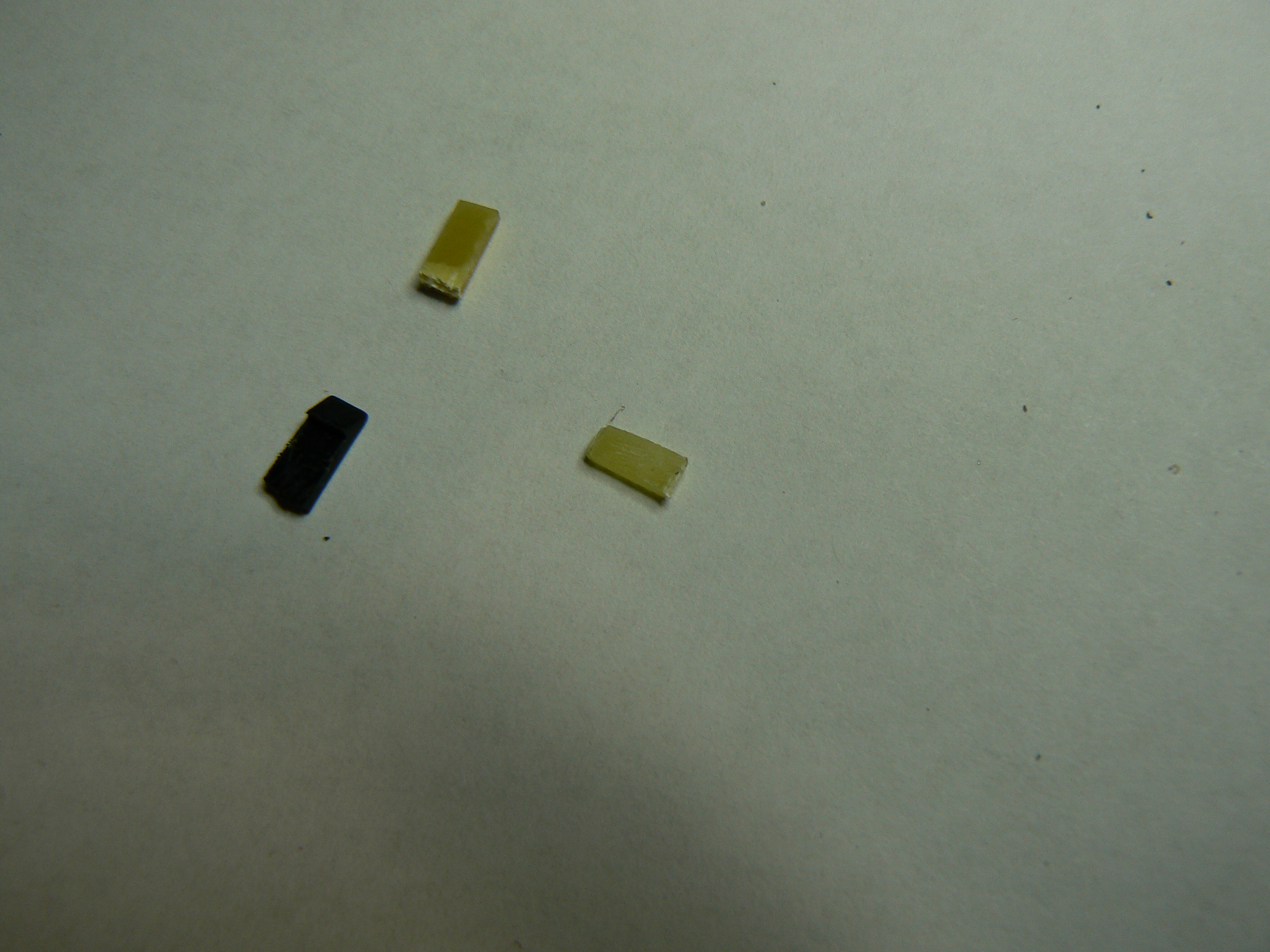

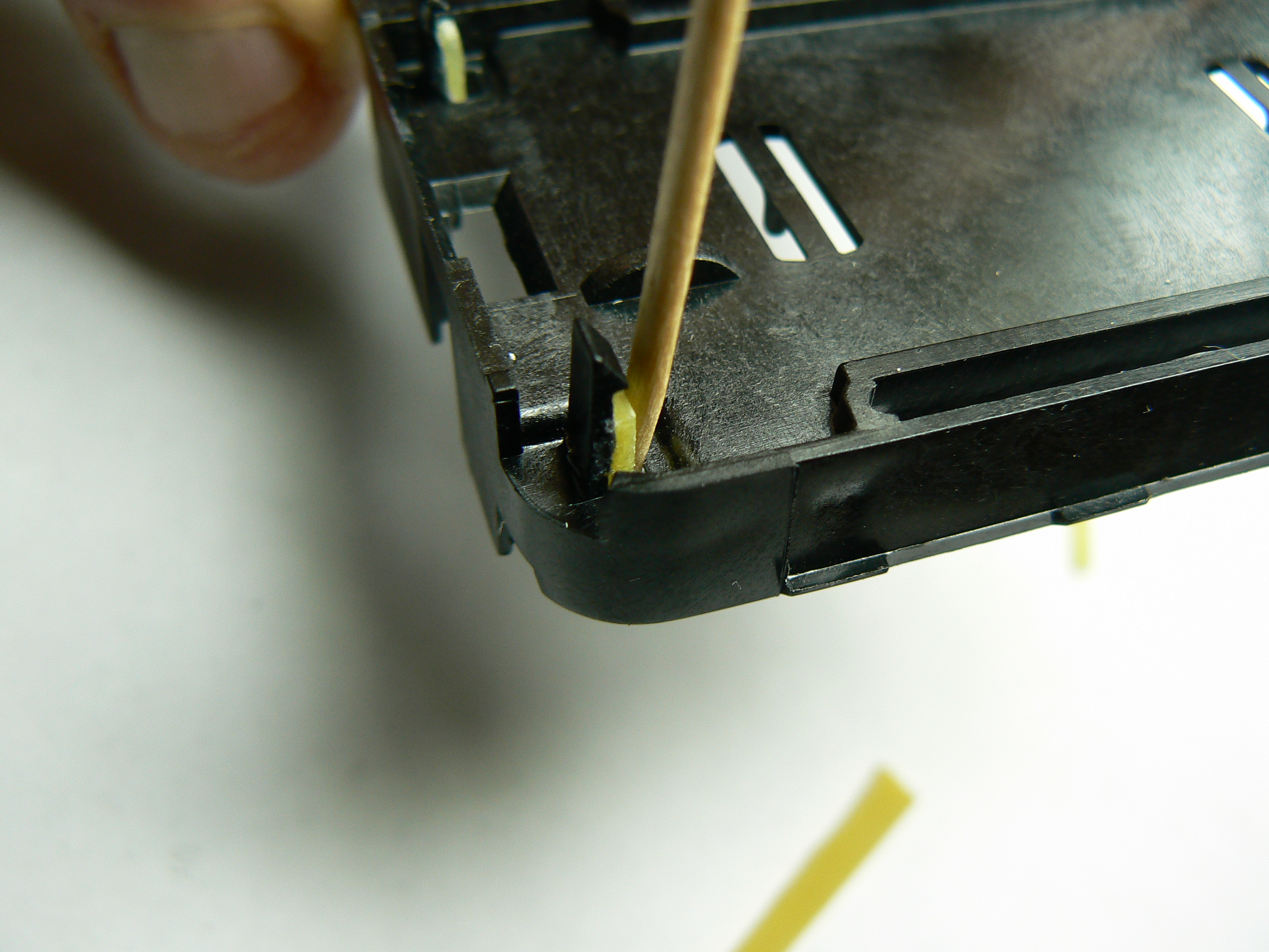

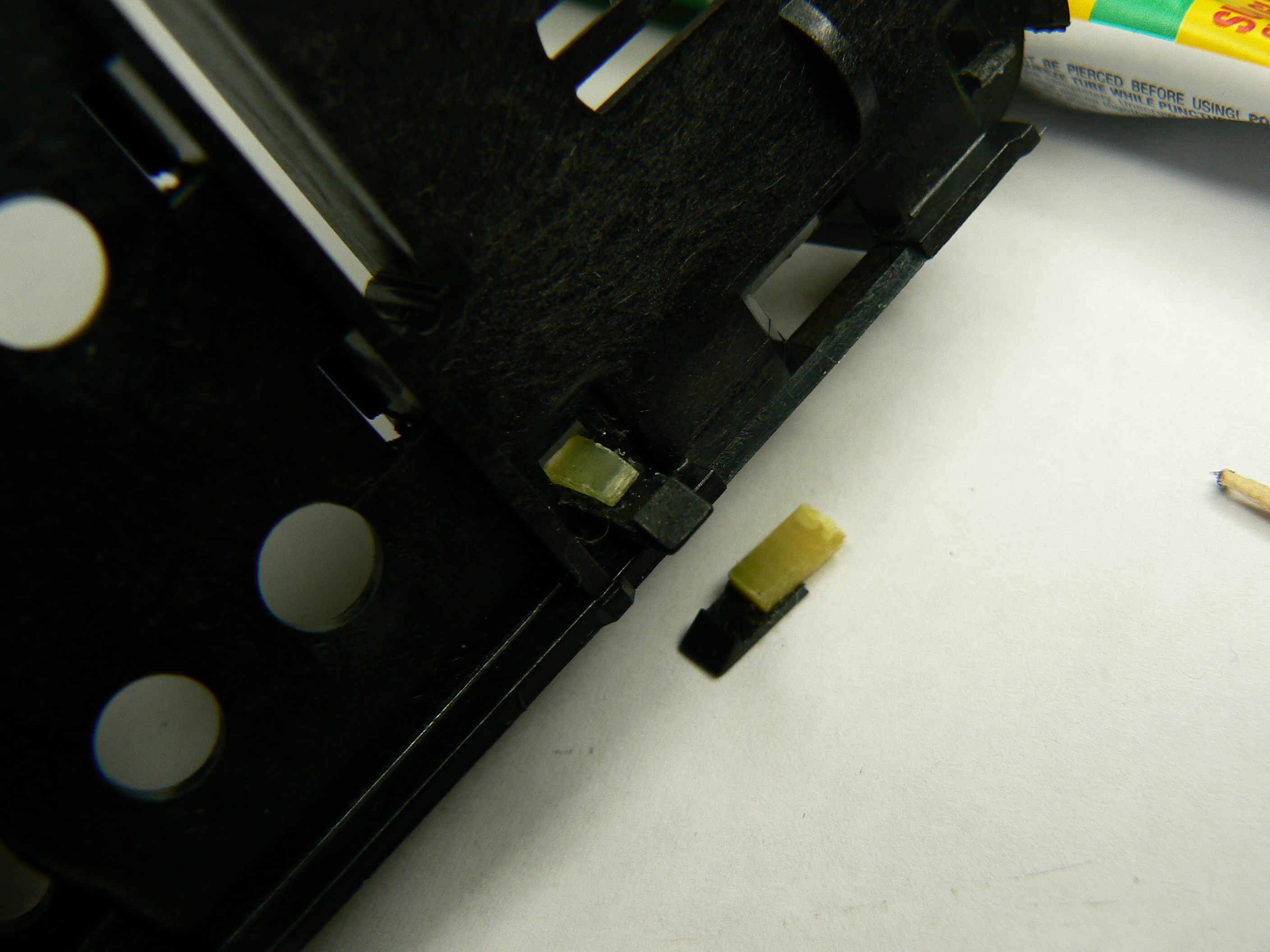

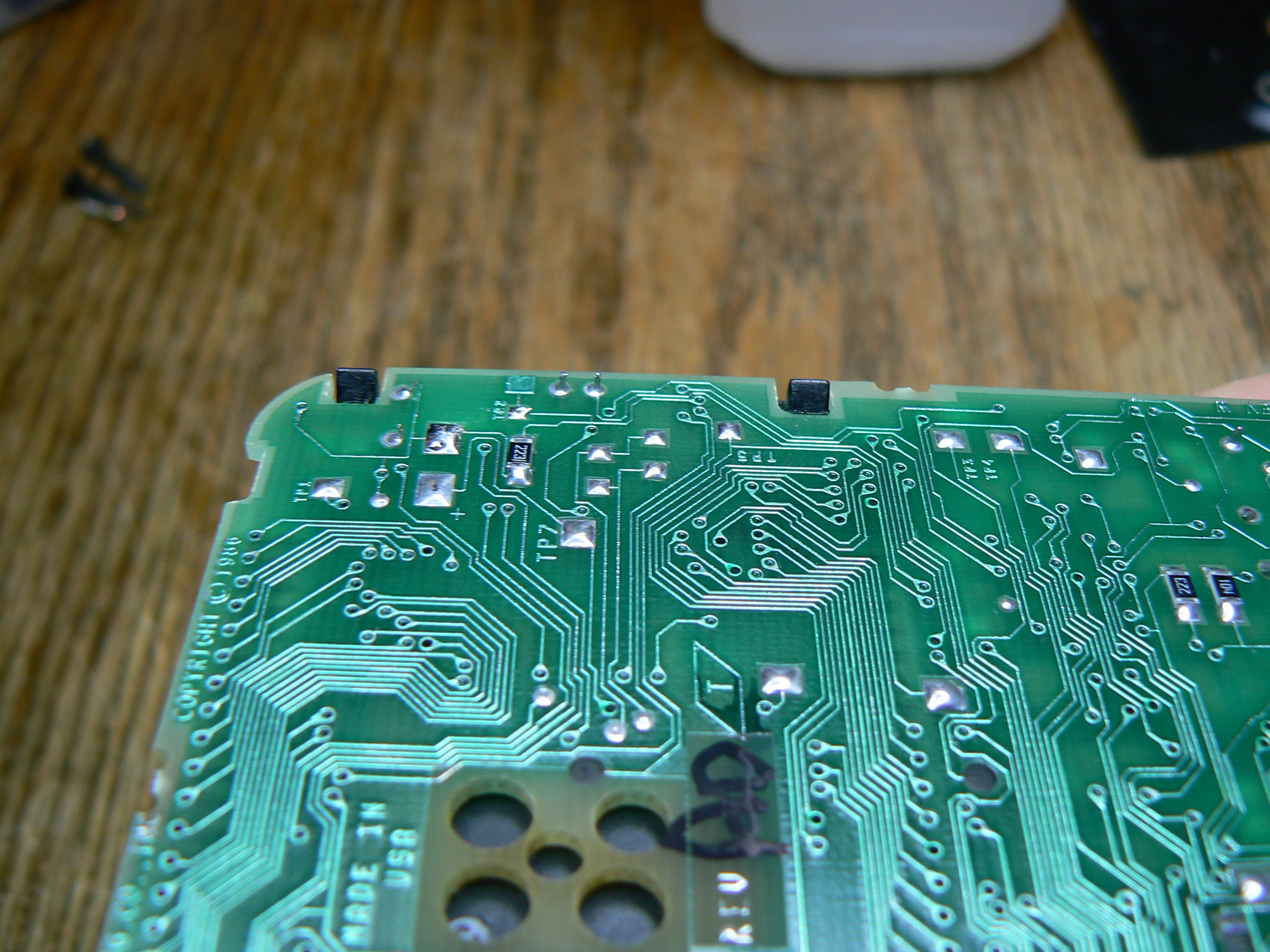

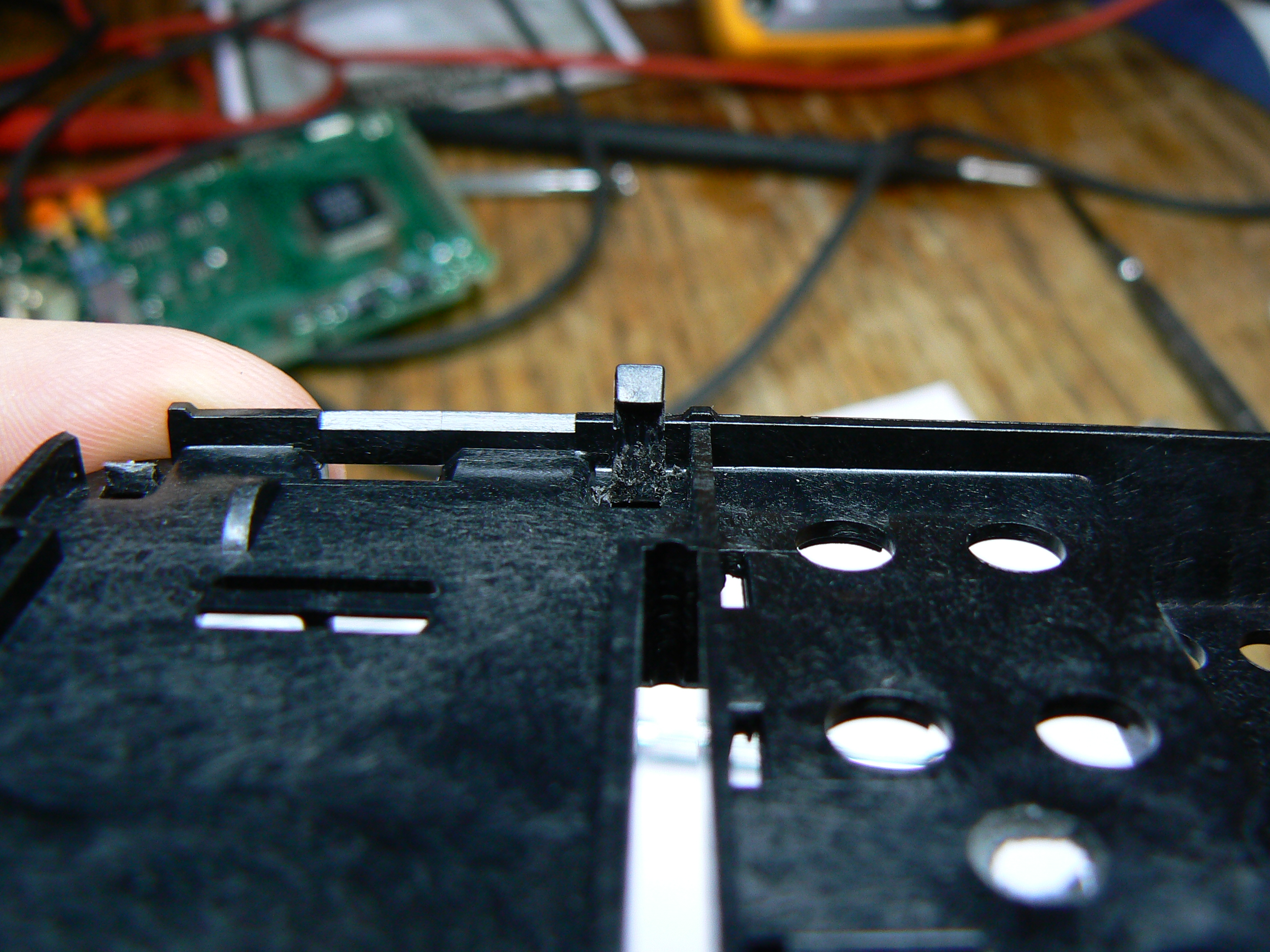

                    Stupid plastic clips.

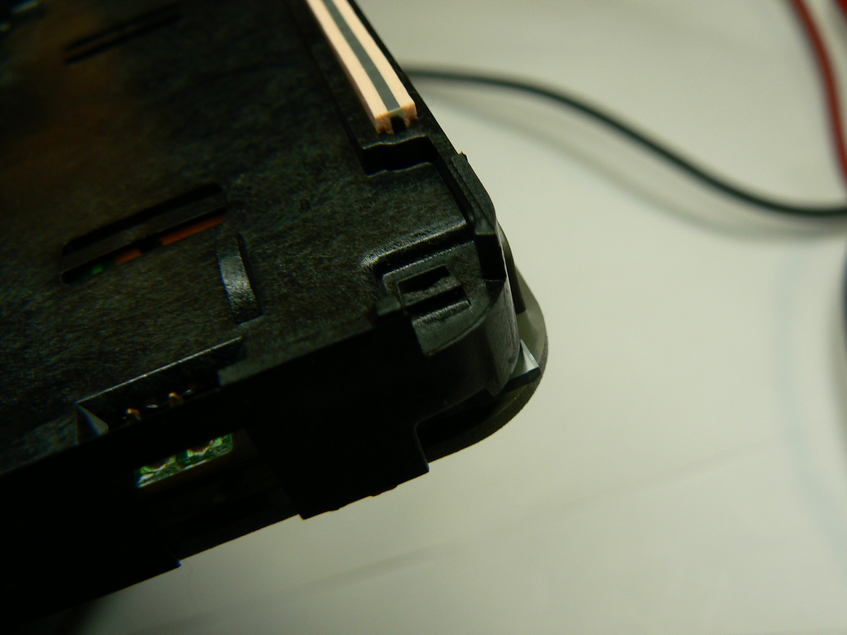

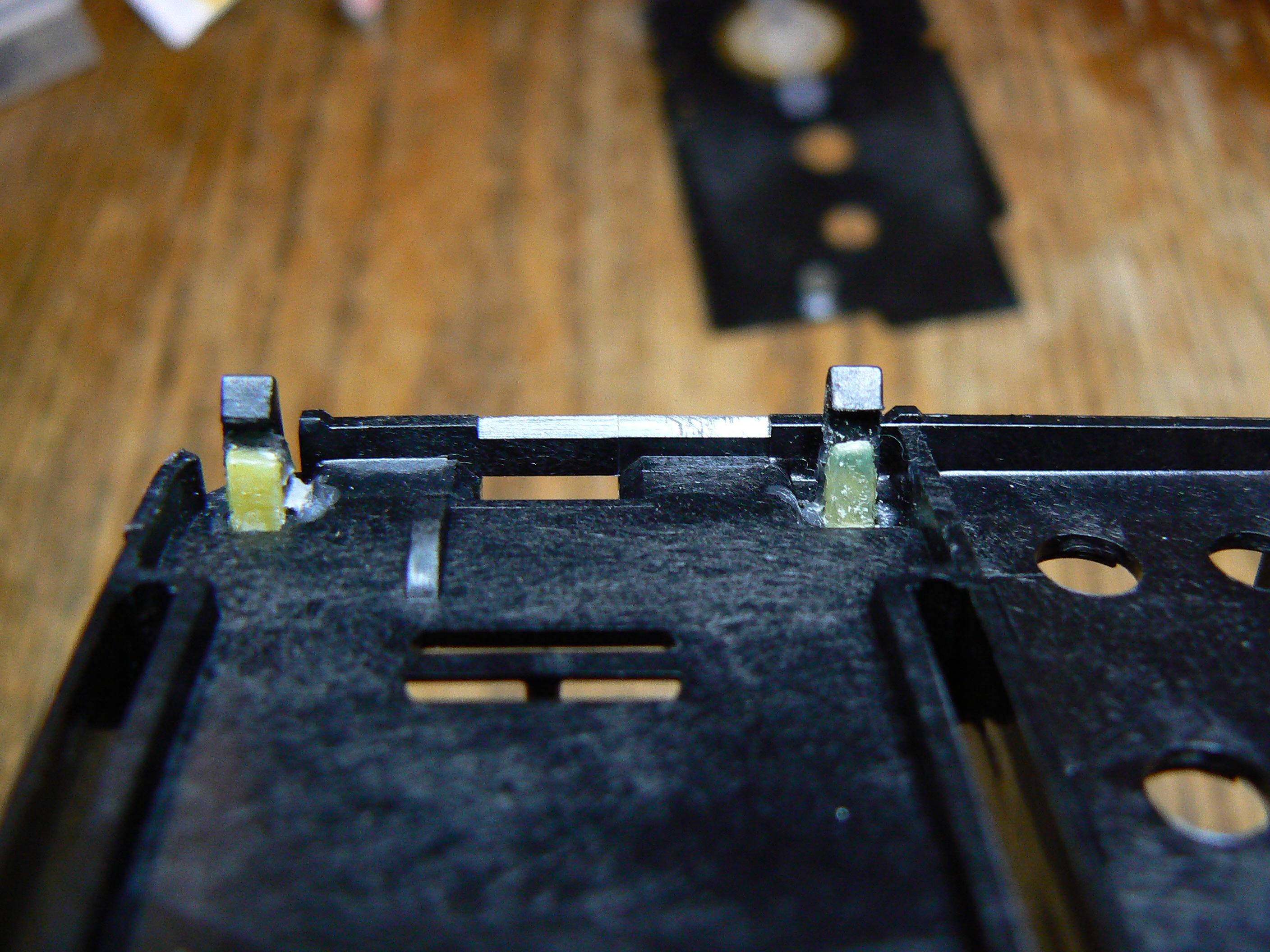

                    I took this meter back apart to attempt to repair the clip I broke the first time and I ended up breaking a second one. At least this time it did not snap completely off but it was close. These clips are way too fragile as I was very careful when I was removing the frame. So I had to repair two clips instead of just one.
                    The attached pictures show the repair job. I used the trimmings from PCB's that I previously etched for the bracing and CA gel adhesive as a binding agent. I waited between 12 to 24 hours between each step to make sure the glue was cured. I had to make sure to leave enough gap between the bracing and top of the clip so that the meter's board would fit between them. So far the repair is good, I just hope the glue does not let loose.

                      Re: My new (used) Fluke 87
                      You can buy an entire new assembly on ebay, but the asking price is around $30 USD.
                      http://www.ebay.com/itm/370869182615
                      I believe the 87V now uses screws instead of plastic clips.
                      I suggest leaving the holster on 100% of the time to cushion any falls to protect your repair. When you change batteries or fuses be careful not to drop it as that is when it is most vulnerable.
                      The attached pictures show the repair job. So far the repair is good, I just hope the glue does not let loose.
                      Maybe modemhead will include this repair in his user submitted section?

                          With glue-type repairs, you never know how it's going to hold up, but yours looks good. The reinforcing material is a great idea.
