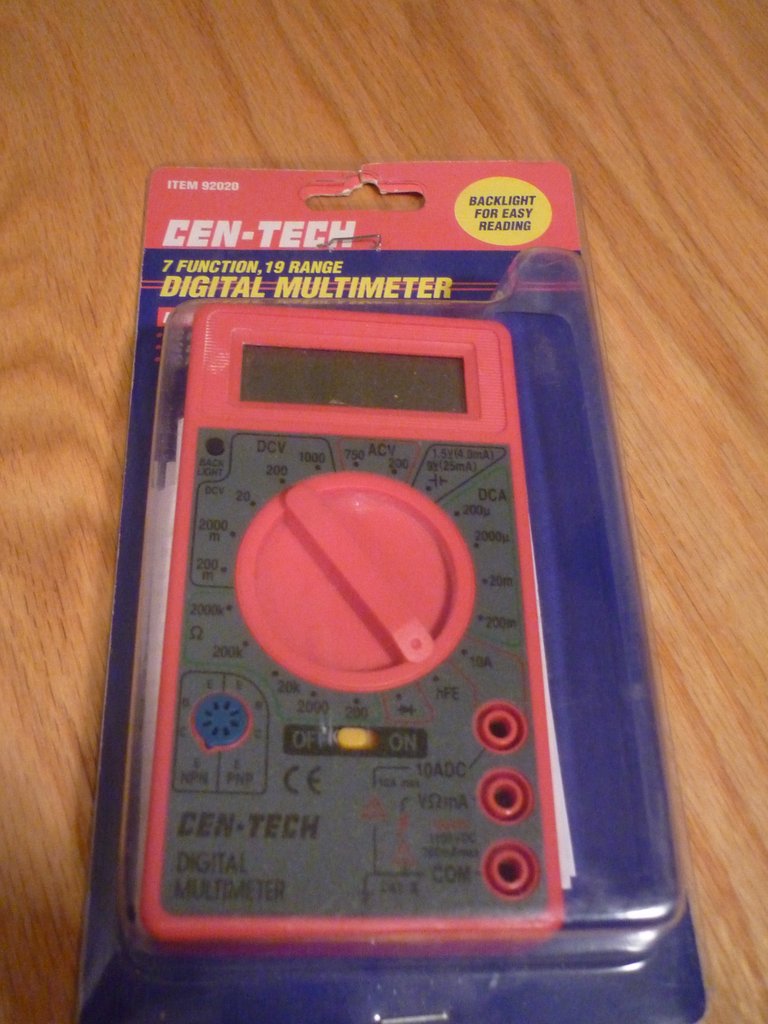

          It looks shockingly similar to the one sold at HazardFreight...

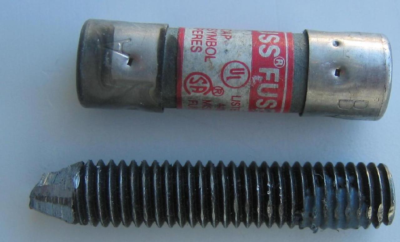

                      2) I bought an used Fluke locally. I did my usual fuse check by putting the red probe into the A and mA jack. The A read 0.2 ohms and the mA was 0L.
                      When I got home and opened up the multimeter, the 10A fuse was a metal drill bit. Needless to say, I was pissed!
                      Had I not checked and decided to use this multimeter in a high current situation, the multimeter and my hand might have went
                      If I lend out my multimeter, I will only lend out ones that have no current measurement capabilities.
                      3) Reputable name brand multimeters are not a substitute for working safely and using common sense.
                        This is a great story, and the one who did it deserves an Oscar award.
                        The most commonly similar story is the dead fuse rapped up with aluminum foil.
                                Was it a whole length drill bit?
                                  Picture attached. The fuse shown is the blown mA for size reference. As you can see the 10A "fuse" is a bit longer.
                                  What pisses me off is that the metal drill bit is heavy. If I had dropped the multimeter, the fuse could have moved every so slightly and made contact with the components on the pcb.
                                  If I tried to make a current measurement, it could have went

                                        I guess retiredcaps isn't that lucky after all. That's not even a drill bit it's a bolt cut in half
