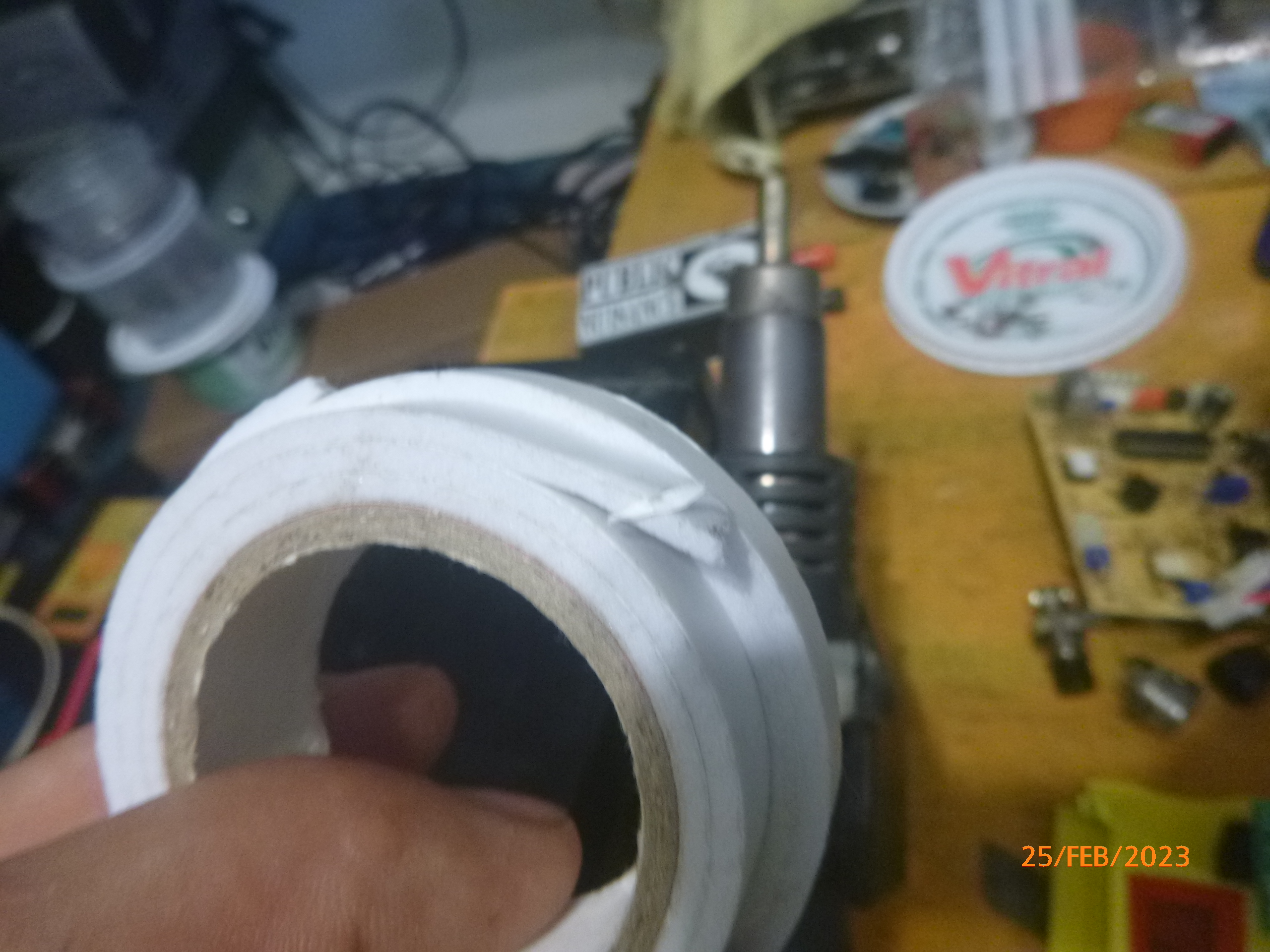

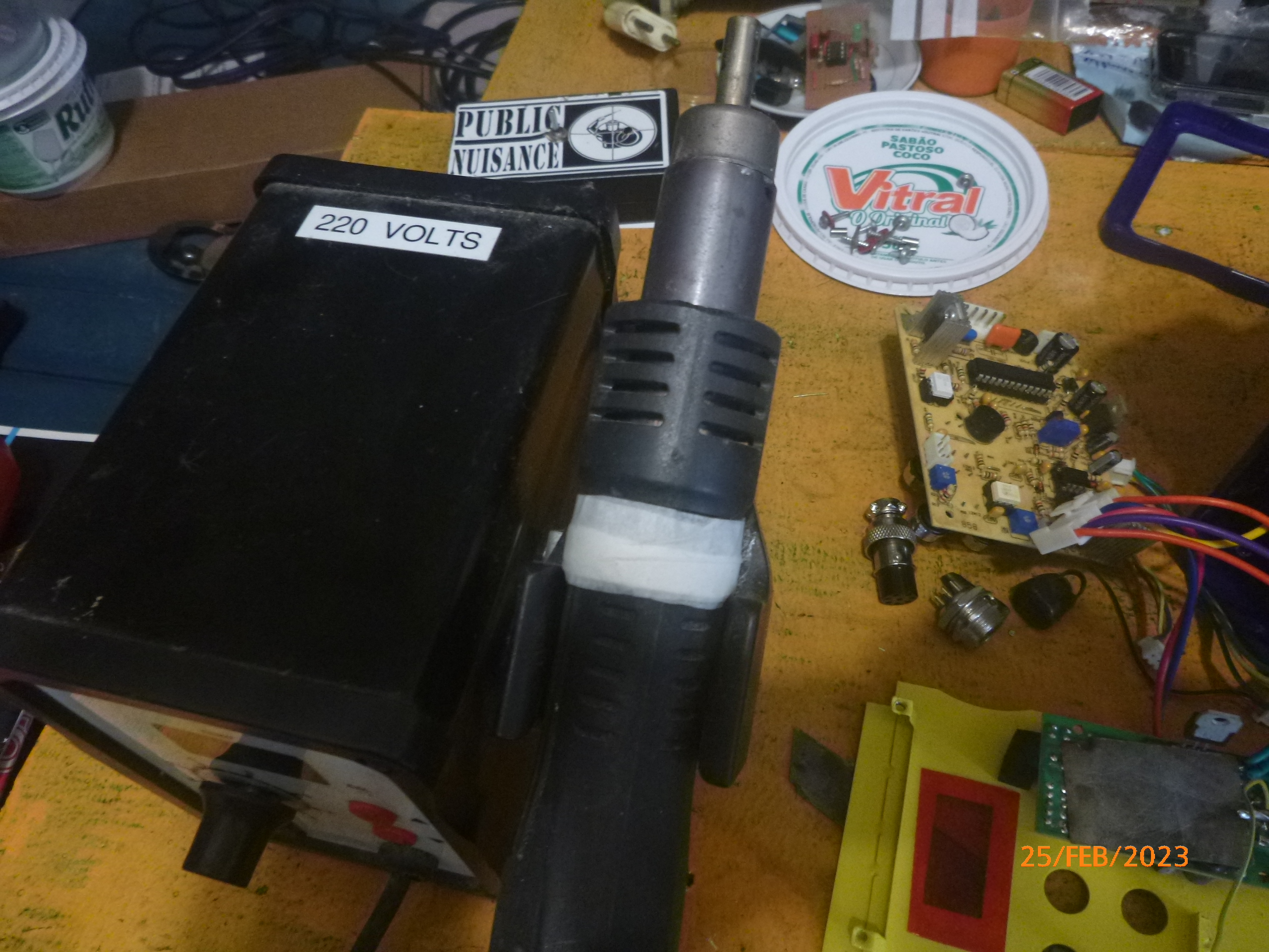

                      I realise this thread is somewhat old, however I have had problems with an Atten 858D+ which stopped entering sleep mode, and found a solution which might help someone, someday?
                      The problem started after the unit was lent to a friend and the only way to get the heater to chill out was by holding the heater gun above where it was sitting naturally.
                      After failing to locate the reed switch, the situation was resolved by putting a thick band of tape onto the heater handle so the the gun sat about 20mm, or 3/4's of an inch, higher up in the saddle.
                      It's not pretty, but it was done about two years ago and it is still working fine.
                        • 31300
                        #51
                        Re: [FAQ] Atten 858d problem S-E (or 5-E) or stuck in 498'C.
                        maybe the plastic moved on the metal bracket?
                        or the magnet got loose inside it.
