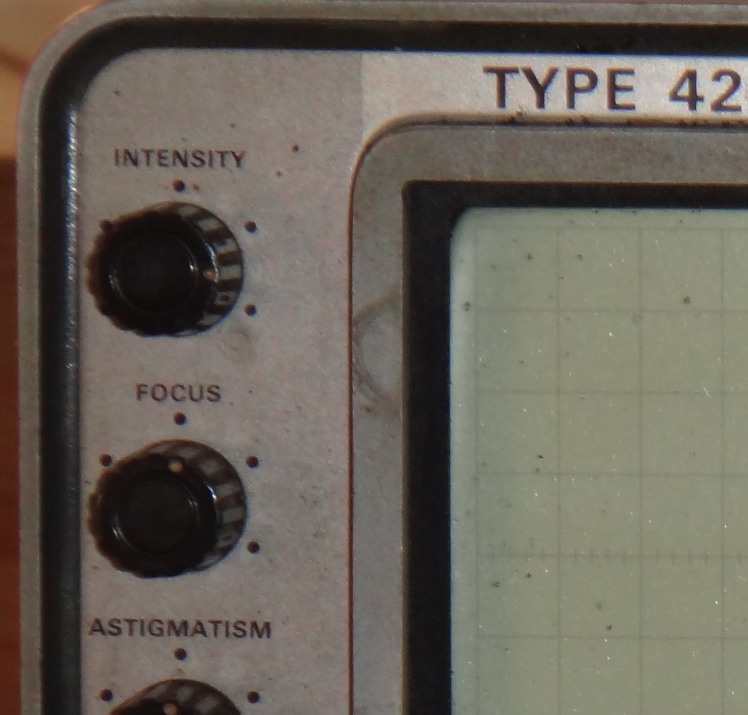

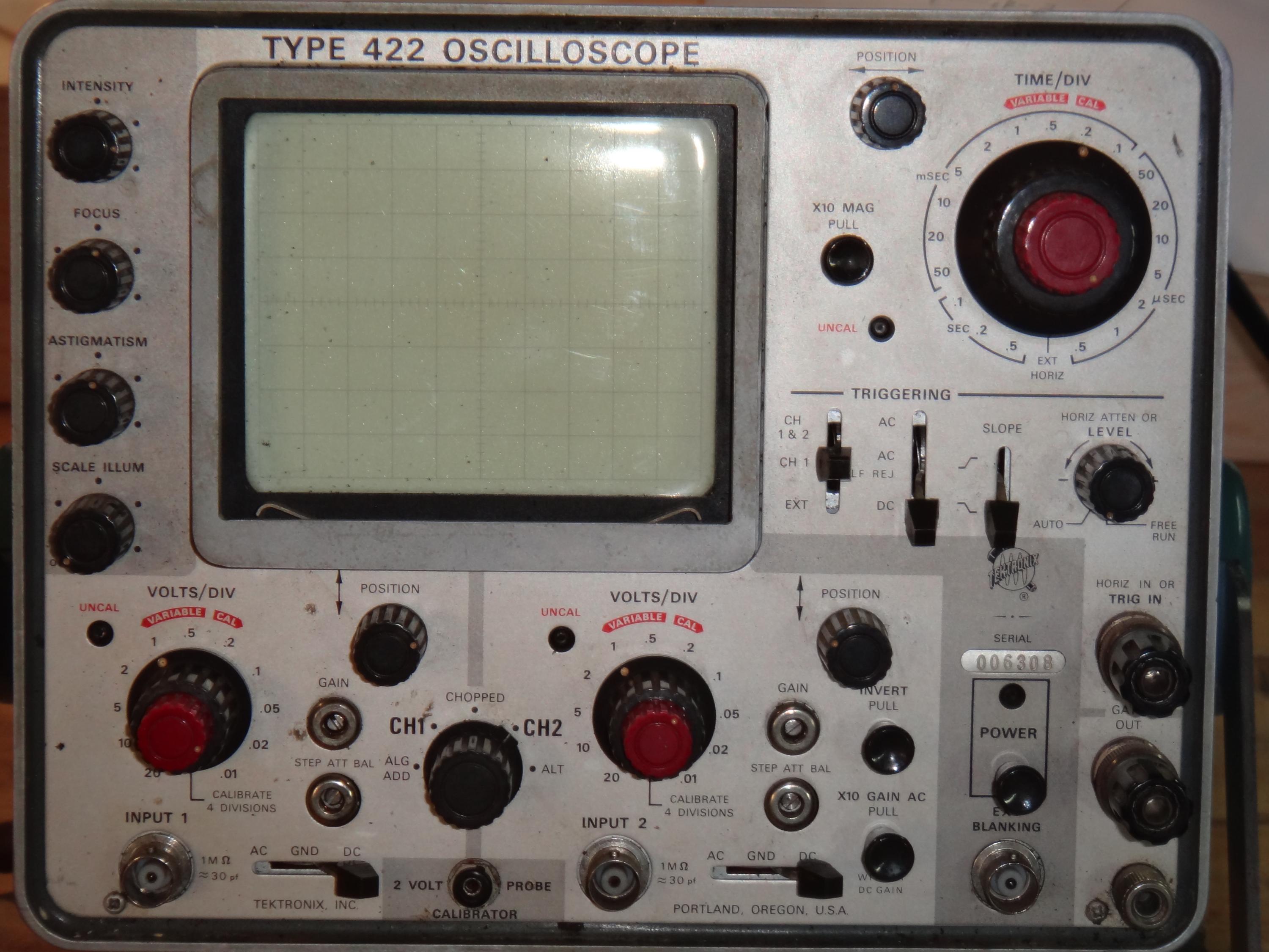

    My Type 422 Tektronix scope intensity knob needs to be near or at max clockwise to be able to have a trace.
    Any suggestions on re-establishing full range intensity?
    Do I need a new CRT?

      try cleaning the pot ,i had a freind had the same issue with an older scope,wouldnt show trace until it was fully clockwise,i cleaned it with contact cleaner and it worked fine after ,wasnt the same make as yours tho.

            Your posted a link to the Tektronix 422 service manual that is for serial No. 1-19,999, do you have a link for serial No.'s 20,000 and above? The two manuals are not the same. Serial's 20K and above do not use Nuvistors.

              Usually the dimming is mostly irreversible and a new CRT is needed. About how many hours has it been used? (if the answer is "I don't know" assume tens of thousands of hours. Half life of regular CRTs are only around 15K hours!)
              With the service manual you should try the CRT calibration to see if it helps a little, make sure all the pots are good, and at least see if the voltages are good. There are some internal adjustments that may help, but once those are at their limits... new CRT time.
              There are some rejuvenators out there that may help the CRT for a few hundred hours but ultimately again a new CRT is needed.
              One question is whether focus is still good? then perhaps it could be a different problem.
