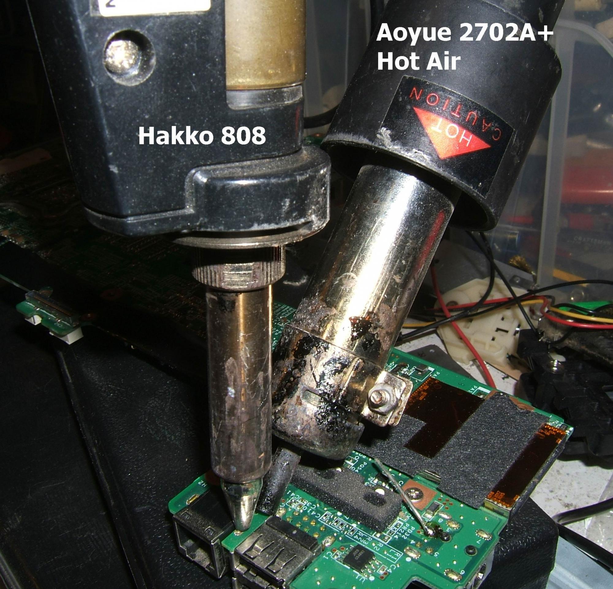

            I have a Aoyue 2702A+. I don't use the sucker or the soldering iron any more. I only use the hot air. Turns out separate tools are much more useful because on boards with heavy copper planes the solder and desolder tips destroy the board before supplying sufficient heat. Hot air must be used along side to provide the heat. The 2702A+ hot air and suction run from the same pump. When the hot air is on, the sucker is on. Desoldering doesn't work if the sucker is on all the time and desoldering doesn't work without the extra heat. A small tip on the hot air gun reduces suck volume.
            If you ain't packing this much heat (see picture) you won't get jack.
              Neat idea with the hot air gun and 808. I've got just the board to try it on.
              But I "get (laptop) Jack" all the time with the 808 all by itself. That's usualy relatively easy. Have you got yours set hot enough and is the tip tight?

                Re: Soldering/De-soldering stations...again...
                Flux would make desoldering easy but flux is no good with desoldering because it quickly clogs the filter. The filter collapses and lead dust ruins the pump. Without flux the desoldering gun tips don't last long so I turn the Hakko 808 all the way down to make them last. It's still too hot. Without flux the desoldering tip must be mashed into the board to get a little heat to transfer which destroys the board and tip.
                The solution is to get the bulk of your heat from hot air which is non contact and heats the same with or without flux. Once hot a quick touch from the desoldering gun melts the solder with no board damage if the tip is good.
                All too often on the tough boards desoldering only removes the top half of the solder leaving the lead firmly soldered in place. The solder bead that pulled all the heat from the tip has been sucked away. Without hot air all you can do is add new solder to get your bead back and try again. It may take several tries to remove the solder all the way through. You can't see whether the solder at the bottom has melted so you heat more and more with every new glob of solder risking board damage. Lots of wasted time and solder.
                Hot air eliminates this problem. Unlike a solder gun that requires a solder bead to draw out the heat, hot air heats everything it touches right down into the partially desoldered hole. Heat , touch down, suck as many times as necessary. No solder, no flux, no board damage.
                The modem jack I showed looks doable with gobs of solder and a desoldering iron. Hot air assist makes this practical (see picture). Once the board is hot the solder melts instantly on contact and desoldering a large number of pins resembles a fast game of whack-a-mole. Since all of the solder melts the holes clear completely more often making removal easier.

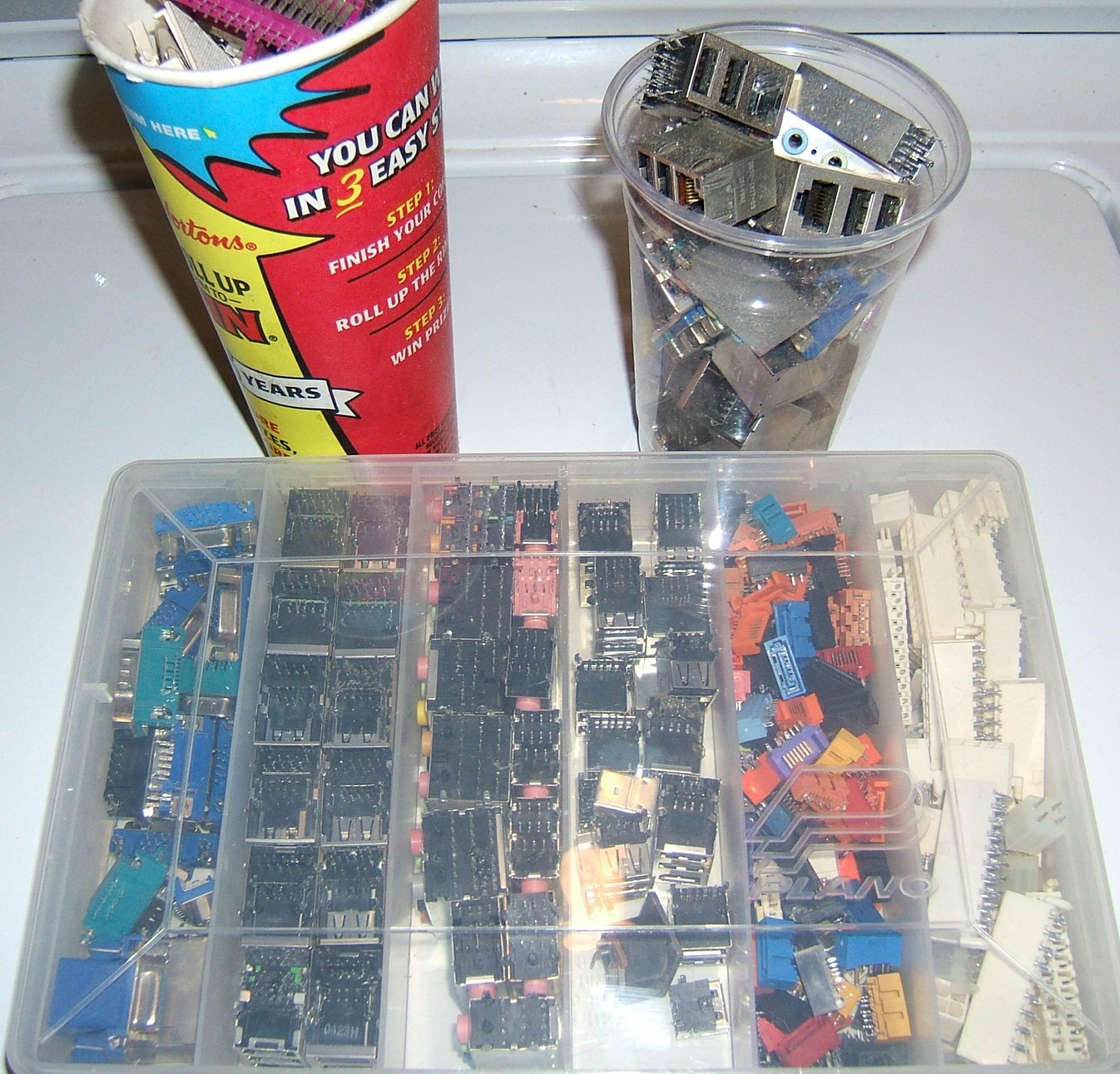

                Picture: reclaim ATX PCB I/O port risers for VGA, serial, parallel, Ethernet, audio, USB, firewire, SATA, PS/2, eSATA, and power.
                Laptop power jacks can be very hard. HP has a few models where the jack is suspended out on two narrow pieces of PCB and HP often uses that impossible to melt solder. Touching anything risks destroying the board. It's not even safe to cut the jack off. These are so difficult that I take every advantage I can and ignore the risk to the filter. I add hot air, solder, and flux. It works!

                  Some fantastic advice severach... I have some questions:
                  1) How do you blow and suck alternately when you only have one pump!? Doesn't it take too much time to switch functions with that station?
                  2) Could this be done with a heatgun or do you need to specifically use a reflow tip to heat that specific area?
                  3) Why don't you use a solder pot for that kind of stuff?
                  4) What do you use for fume exhaustion?
                  5) What do you need all those motherboard ports for?

                    The Hakko 808 is a completely separate desoldering gun. You couldn't do that job with a combined tool that only has one pump.
                      An unregulated wide mouth heat gun is too much of a loose canon. The narrow tip focuses the heat where it is needed and the temperature control helps avoid burning things up.
                      Though I've never had a solder pot they seem like high maintenance. Solder is easily contaminated and I'm not too keen on discarding large amounts or constantly adding flux to keep it clean. A solder pot wants to fill all holes so won't do much for hole clearing.
                      Flux allows me to solder at low temps so I don't produce enough fumes to need exhausting.
                      Each time get a board with a new thing broken I start collecting those off the easy boards. I don't care to discard a board because the VGA port is damaged but I need to take a bunch off to learn how to do it without damage. There are too many different styles of ports. The initial heating takes a long time so removal of the first component is slow. Once hot I just push the heat across the board and the remaining components go fast.
