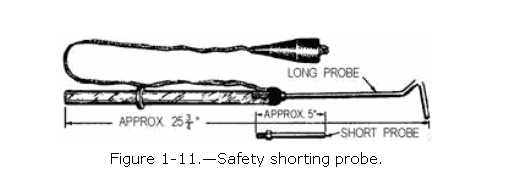

              The standard one in the Navy was a bent 1/4" or 5/16" diameter copper rod set in a glass handle with the lead/clip I talked about attached to the rod near the handle.
              [The insulation was clear so you could visually check the braided cable before use.]
              They didn't have a resistor. [Their thinking was that you can't visually check a resistor and it might be open.]
              .... And they didn't work that way.... These are for HV caps not like 25v. NAV considers HV as 30v or more.
              The jumper goes to ground.
              You short the cap with the copper bar across both terminals/leads. [Not bar to jumper,,, bar to bar with a grounded bar.]
              Procedure was to short the cap 3 times then check for volts with a DMM.
              I managed to find a NAVEDTRA manual online that has a pic. [attached]

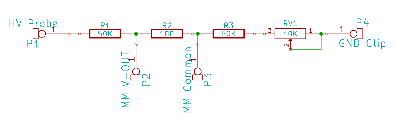

                I see. my multimeters max out at 600v (digital) or 400V (analog). mess up and bye-bye multimeter.
                However, I think I may know how to make a kinda crude 1000:1 probe:
                the Idea is to make a voltage divider using a 100Ω resistor, either 2 50K resistors (shown) or a single 100K resistor, and a 10K pot to tune the probe. I plan to put the circuit on a PCB in a small plastic project box. I also plan to use 1/2W resistors as a safety measure. for the probe, I will likely get a cheap screwdriver at HF and solder my wire to that.
                Look good?
                  You trust some probe or a resistor and don't double check with a meter and it's bye bye YOU instead.
                  Most meters have fuses and meters are replaceable even if the fuse doesn't work.
                  Not to mention you can pick up a cheapo 'burn meter' to use for that for like $2.
                  - Use a meter.

                    I've redesigned my probe circuit to use a 100K 1/2 w resistor hooked to the probe. in series with that is a 1K pot and a 100 1/2w resistor. the meter hookups are between the 100 and the pot.
                    some math:
                    voltage diveder equation (for series circuits):
                    V = E *(Rv / Rt)
                    *E is the voltage source*
                    in our case, we will assume a 1000V input (E) will be read as 1V (V):
                    1 = 1000 * (( 100 + pot)/ (100000 + 100 + pot)
                    pot = 0.1 ohm
                    not much, but the pot is also to acommodate tolerances in the resistors.
                    I will calibrate it using a 12v bench PSU I have.
                    any questions?
                    also, any input from anybody else?

                      You need to study you physics a little more.
                      Voltage + a path is the cause of current.
                      You can't have current without voltage.
                      Thus you can't blow a fuse without voltage.
                      If you have a little bitty voltage you will have a little bitty current and you won't blow the fuse.
                      If you have a great big voltage [on the same path] you will have great big current and blow the fuse.
                      Thus voltage does blow fuses.
                      And no - you are NOT talking about much voltage AFTER you have shorted the cap.
                      OMFG: If you can't tell if you shorted a cap or not then you shouldn't play with electricity.
                      LEAVE THE CRTS ALONE.
                      It's just not that hard to tell if you connected two points together. - JEZZZ!
                      If you connect a copper bar across 10kv and you can't tell if there is voltage there from the noise, sparks and the smell then you REALLY shouldn't be playing with electricity.
                      LEAVE THE CRTS ALONE. - By what you've said you have no idea about what you're playing with.

                              In your little gadget if R1 opens the cap will look like it's discharged when it isn't.
                              That's why you use a shorting bar and suck up the fact it will spark.
                              It will keep you alive....
                                Look good?
                                Correct theory, but incorrect implementation. Standard resisters have a voltage rating of 200 to 600 V, You would need many more resistors in series to be sure the high voltage wouldn't arc internally and present a much higher than expected voltage across your meter.
                                Assuming 600V resistors, we're talking about 40+ resistors in series. These resistors should be placed in a PVC or similar tube, and the tube should be filed with RTV sealant.
                                Of course ebay is a good source of modestly priced high voltage resistors, assuming a 5KV resistor, you could get away with using 4-10 resistors in series, and a WAY shorter tube.
                                    that schematic is outdated. I since modified it (been too lazy to redraw it).
                                    as it is now, a 100K resitor drops the high voltage and a pot/100ohm resistor drop the rest.
                                    I saw no voltage ratings on the pack I bought... stupid me for thinkign it was irrelivant.
                                    with this one CRT, I need to rivet metal to the frame (the back plastic failed on it) and it was more for safety. the next is an emac that needs some work around the cdrom done. the last is a mitsubishi monitor that has an unknown issue.
                                    what I don't get is all the homebrew guides I saw showed the use of standard resistors...
                                    the part that will be dropping the high voltage is one of these:
                                    http://www.radioshack.com/product/in...lue=RadioShack
                                    which says it is a 350V resistor. I wish they put that info on the package...
                                    from what you made it sound like, what I built will have to be chucked away... it is in a plastic project box on a PCB... I designed the HV part so the traces were 1.25" away from each other at least.
                                    so, what to do?
                                    A. replace the existing 100K resistor with a pice of wire and and add an external battery of HV resistors.
                                    B. chuck the existing setup and build another probe setup
                                    C. chuck the existing setup and buy a name brand probe in a few months
                                    right now, I am thinking of either choice C (the battery of resistors bit sounds like a massive PITA)

                                    • LLLlllou
                                      • May 2011
                                      • 201
                                      Re: HV Probe Suggestions
                                      Not every home brew circuit you find on the net was designed by an electrical engineer.
                                      With rat shack parts it's lucky you get ANY useful info.
                                      With voltages as high as a CRT uses, it's a whole other world. You need special high voltage wire with insulation rated to 30 or 40 KV, super rounded solder joints so sparks, arcs, and corona discharges don't occur, etc. Or you just pot everything up in high voltage RTV or epoxy.
                                      so, what to do?
                                      Assuming you're just worried about discharging the CRTs, and don't need to accurately measure the voltage, a 5KV or 10KV resistor of just about any value soldered to a piece of 10 or 12 gauge copper wire as a probe on one end, and a piece of wire with an alligator clip on the other end should be more than good enough. Stick the resistor in a piece of 1 or 2 inch diameter PVC or ABS about 8 inches long, and fill it with RTV. Attach the alligator clip to the CRT ground, hold the probe by the PVC handle, and CAREFULLY touch the copper probe to the anode cap's metal clip.
                                      Actually, all you really need is the wire and the handle, it's not like discharging an electrolytic cap. where you have to worry about discharging it to quickly. It's essentially a giant PF range cap with a glass dialectic. The insulated handle is the only critical part so you don't wind up with a Flock of Seagulls hairdo.
