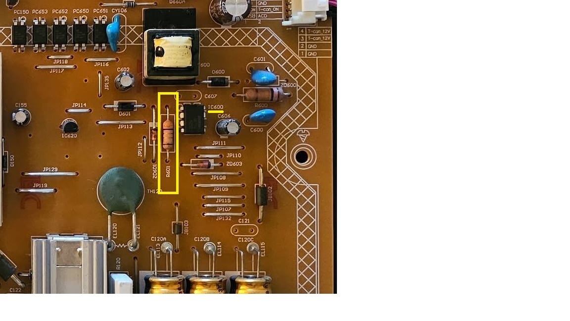

    I have a Sony Bravia KD-60X6700E which has decided to stop working. To describe the symptoms - it just decided to stop powering on one morning. No standby LED, no sounds, no picture, no startup logo - nothing. Doesn't respond to the remote nor the physical power button on the unit.
    I have tested the power cable for continuity. I have also tested the fuse, and that too, has continuity. However I haven't gotten much further with the probing. I've prodded the secondary side of the power supply where the connector connects to the main board, and there's no voltage on any of the pins there. I'm hesitant to probe on the primary side, as I don't know which cap I should be using for my negative probe, or what the useful points to probe might be.
    My reading suggests that the EMMC is a frequent issue with these boards, and based on the lack of visible issues on the power supply board (or the rest of the TV for that matter) that this is a likely cause - however I assume I should have voltage measurements on the lead going between the PSU and mainboard. Any suggestions on where I should poke next?
    Photos are attached. Please let me know if they should be clearer, and I'll take fresh ones.​

      For anything to work, you need to have at least standby voltage, if you do not have +5vsb on CN201, pin1 or D660a, cathode, (use chassis as ground or JP216) it is likely the standby smps ic600 is bad, check R600, if it is open IC601 is likely shorted
      You should have about 385vdc across one of the primary caps, C120A, B, or C (all 3 are in parallel)
      There is a checkered stripe that separates Hot primary from cold secondary side

        Check TH100/101/120, VM100, they are resistors, in see a kind burn mark on the small standby transformer (ahi), check their winding resistances.. (pins 1-6, 3-4, 7-10)

          It's probably hard to tell from the angle of the picture, but the burn mark is actually one of the "EC"s you can see printed on various parts of the board.

            I think R J was attempting to make you check for shunt isense resistor but here there's all in one circuit a into IC601 and the R is inside, so you must check in diode mode IC601 pins 5-8 one way+reverse, if you see a short or an open c. then it must be replaced, if you read a diode then it's ok and the fault is in the PFC or input filter... bye..

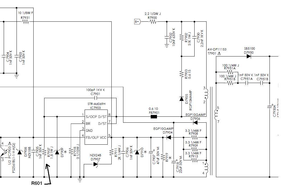

              Thanks! So using the schematic as a reference (the chip is one of these - an A6069H), I measured IC601 (you guys mean IC601 and not IC600, right? I can't see an IC600) between 5 and 8 in diode mode. In that mode I get a very brief blip before the meter goes to open. If I swap my probes around, the same thing happens.

                    Yes i confirmed in the past post, i do not think you have other burnt components around the IC but if you check them rapidly is better
                    PS: wait wait wait.. i noticed one strange thing!! watching the under side picture i see that probably this piece of s*** has a different pin out of the similar components, it seems the gnd pin is not pin 5 but pin 3!! so the check must be made between pin 3-8, better to find the datasheet but from the board is very clear..

                      Looks like I made a mistake on the resistor to check, it should have been R601, It should connect the internal ic600 mosfet source (pin1) to hot ground, if the internal mosfet shorts it should open this resistor. There is also a zener diode across this resistor so one end of the resistor would need to be lifted to check it and also check that the zener is not shorted.
                      Here is a "similar" circuit

                        So I lifted a leg on R601. Measures 1m ohm across. Checked ZD601 - shows a reading one way, and open the other.

                          What is the value of R601 or its colours? So looks like this chip is diffrent from others, and the diode check must be made from pin 1 to 8

                            If R601 is 1MEG Ohm it is open and the ic internal mosfet is likely shorted. Usually, 1m ohm would be 1 milli Ohm, (basically a short) based on the color, it looks like the resistor should be around 2 or 3 ohms

                              Shows as a diode with positive lead on 3, negative lead on 8. If I swap the leads, it shows as open.
                              Sorry, both R601 and I601 pin3 are connected to GND so the said test tells the IC601 has no burnt inner MOSFET nor the R601 is burnt.. so we must move as said to the PFC part, that is especially Q120 (heatsink),D122A/B (THT), D120A/B (SMD), R120 (BIG, WHITE), ZD120-121 (Zener, THT, under heatsink), etc..
