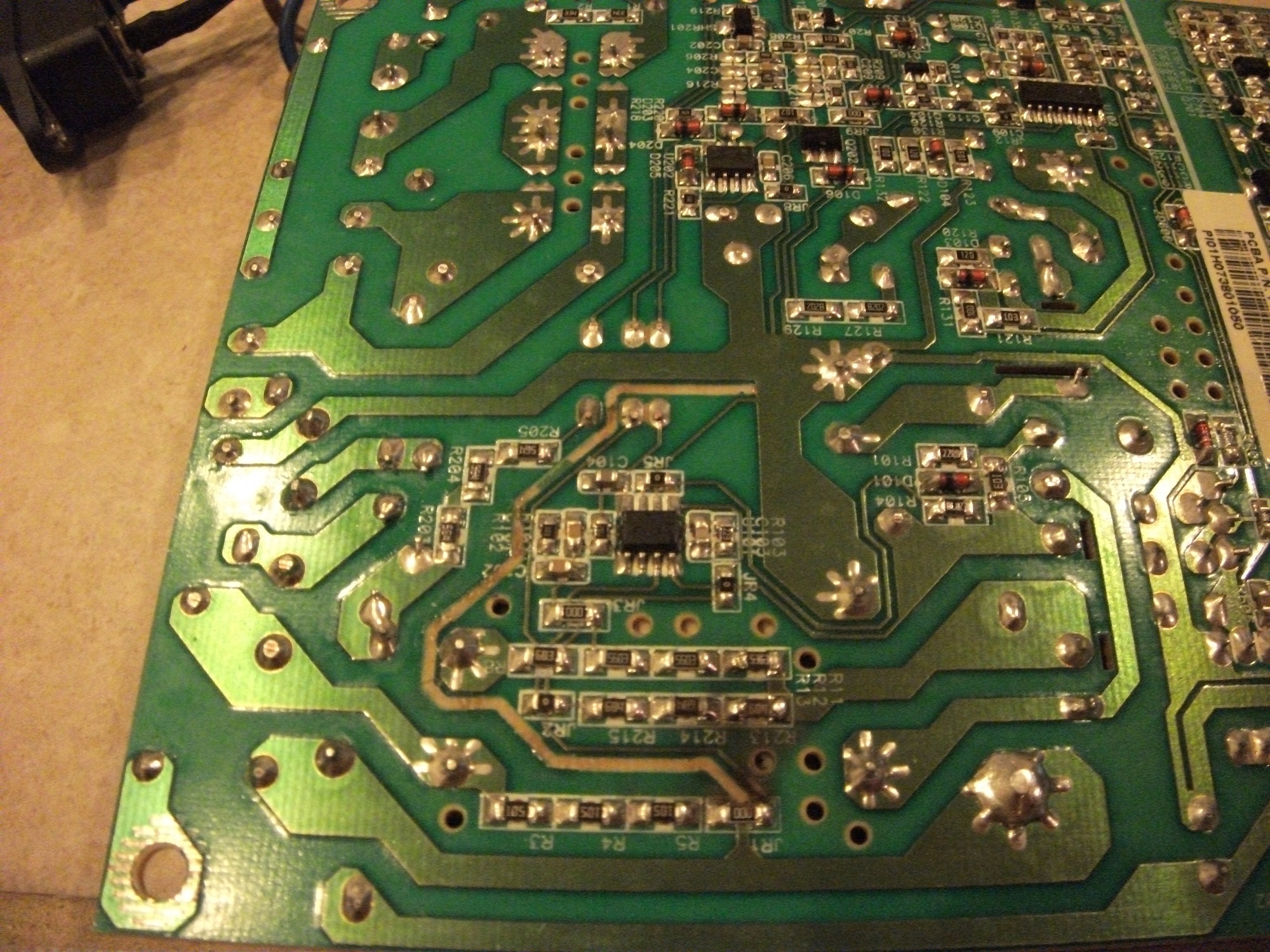

      The path from JR1 to where the "negative end of the big cap in the middle connects" curled up and peeled off in parts. --See pic
      Is this repairable (solder a 23 guage wire from the JR1 to anotherpoint -- or am I screwed for this board?
      -Jake

        Originally posted by cyberndj
        then POP!!!!!! right when I plugged the power cord in.
        Check your fuse, bridge rectifier and power mosfet.
        A good fuse should measure less than 1.0 ohms.
        Check bridge rectifier and power mosfet to see if they are shorted.
        See if there is continuity from the JR1 component to the cap. If not, then jumper it.

          Definitely something shorted if you can blow the whole track like that!

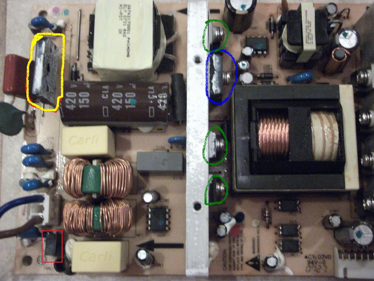

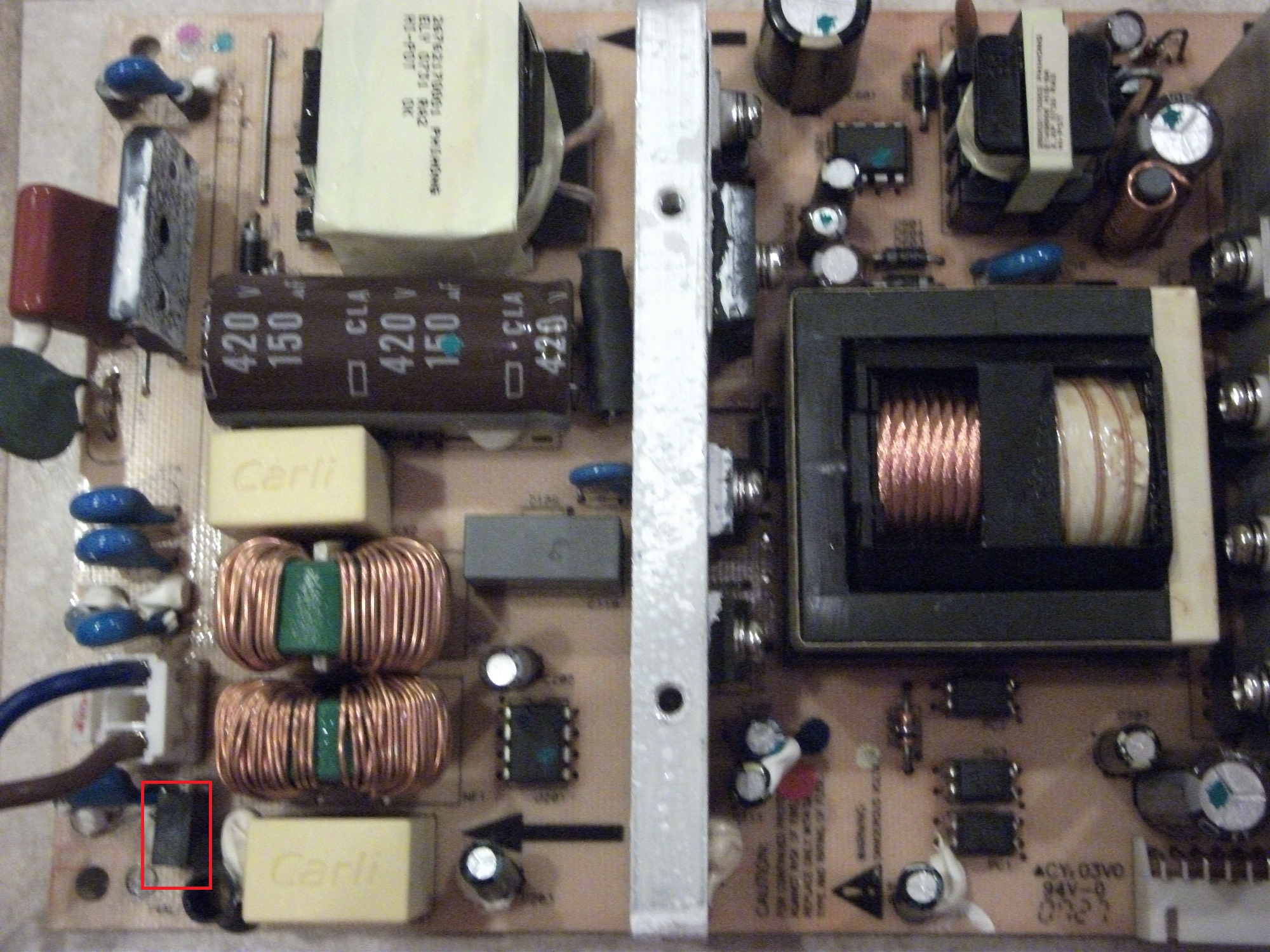

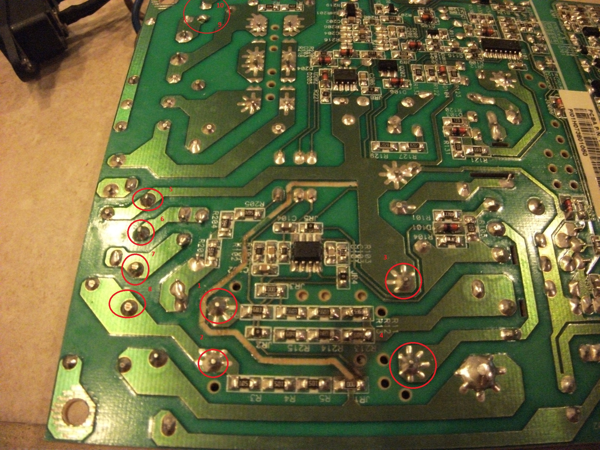

            If the fuse is the rectangular box in the picture, then yes its blown, no continuity across it. It reads "T4A 250V CQ" (4 amp fuse at 250V I assume). F1 is printed on the PCB and there is a burn mark right under it as well.
            Just want to make sure, but Points 1-4 is the bridge rectifier, 5-8 the MOSFEt and 9-10 the fuse?
            Thanks again!

              Re: Help with DMM Fluke 12B Cap Reading
              Yes, fuses are usually marked with Fx part designations, and the 'T4A 250V' confirms it.
              Points 5 through 8 is the bridge rectifier
              Points 1 through 4 look like a transformer.
              The MOSFET will probably be on the heatsink directly to the right of the mains filter capacitor (big 420v brown one) - I can see at least 4 devices attached to that heatsink, you'll need to trace the circuit and\or look up each part number and find out which one is correct.
              -David VanHorn
                Yellow spray paint is your bridge rectifier. The pcb might say BD or BR.
                Blue spray paint might be your power fet. Green might be dual diodes.
                For all the above, you can test every possible pin combination in circuit. Any reading under 30 ohms suggests a short and requires you to verify out of circuit.
                For example, number the bridge rectifier pins 1, 2, 3, and 4. Measure the resistance between pins 1-2, 1-3, 1-4, 2-3, 2-4, and 3-4.
                PS. Remember that the heatsinks are "live" when power is applied. If you have to do board acrobatics to get a measurement, use cardboard for insulation. You could have shorted something and maybe that is why your power supply went pop?
