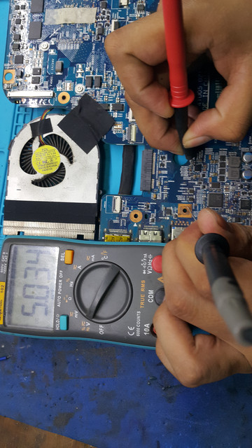

Hi my board is HUSK MB 11309-248.4TU05.021
The board is plugg and consuming 13 milliamp
measuring the 3v coil no reading and the 5v coil no reading
Ive measure the pins in PU4103 ( RT8223M)
1- NO READING
2- NO READING
3- 4.4V
4-NO READING
5- NO RADING
6- NO RADING
7-3.3V
8- 5V
9-19V
10- NO RADING
11-3.3V
12- 3V
13-
14
15
16-4.4V
17-3.3V
18- NO READ
19-5V
20- NO READING
21-2V
22-2V
23-NO READING
24- 5V
i really need how to identify if the PU4103 is faulty or not
