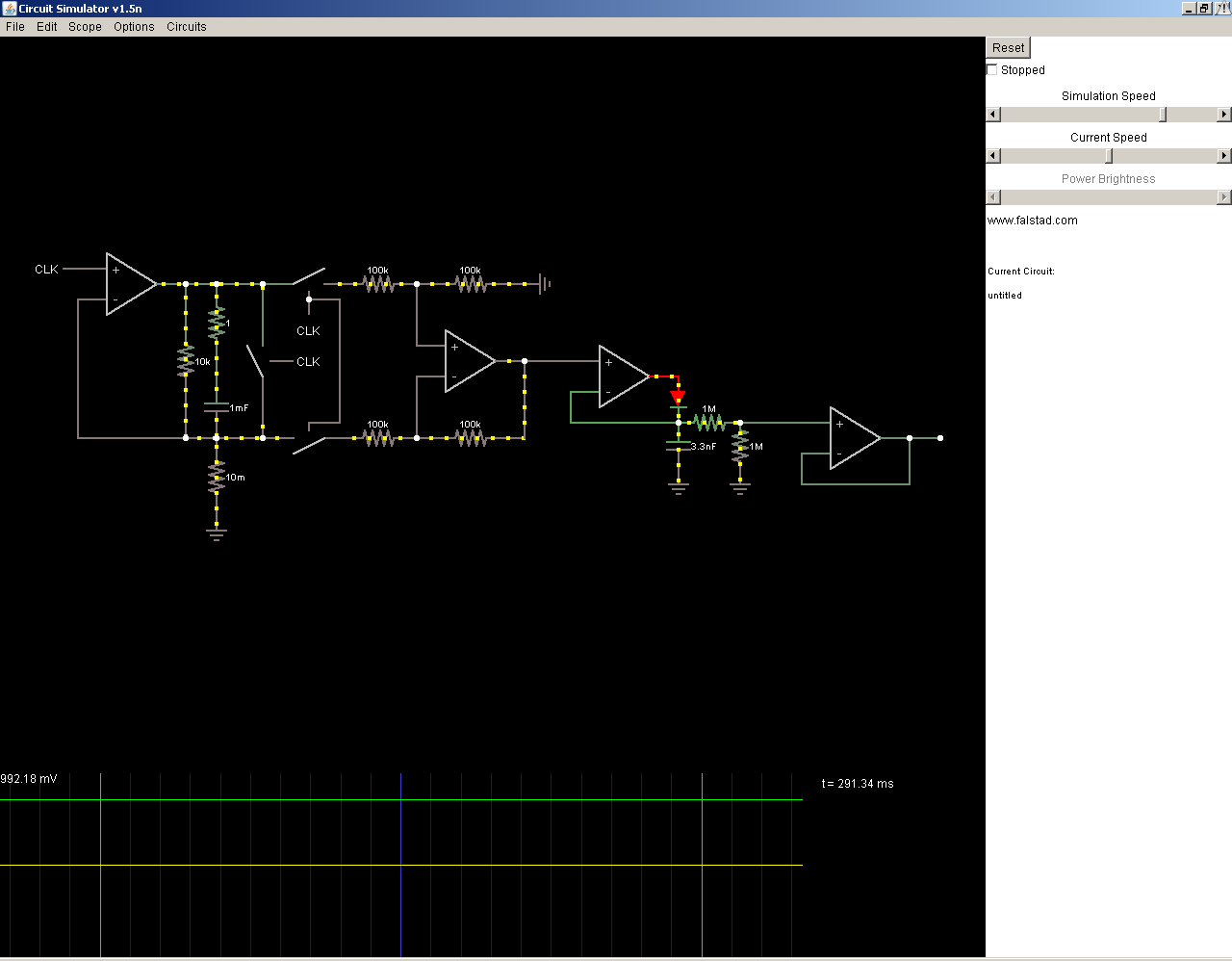

- First we have an oscillator, which should be 100kHz as that's where today's SMPS caps are spec'd at, but there are designs on the net operating at various frequencies which will be more or less accurate depending on the type of cap you are measuring...
- Then we have a current amplifier which makes this AC signal low impedance, so there is no voltage drop due to the source. This has been implemented in various ways - opamps, transistors, transformers, and so on. Sometimes the oscillator and amplifier stage are one and the same.
- Then we have a sense resistor in series with one of the probes, which drops a known voltage. When you short the probes, there's only this sense resistor in the circuit, and you use this to set the maximum indication of your meter movement. The capacitor to be tested is put in series with this sense resistor.
- And finally we have a rectifier and filter, which converts the AC to DC so that the meter can read it. These ESR meter designs typically use a 50 or 100 uA meter movement.
- Sure there's other things such as input protection and such but the four building blocks i mentioned above are the foundation of any analog ESR meter.
Now, the first thing wrong with most ESR meter designs on the web is that the sense resistor is way too high in value, so low ESR caps cannot be read accurately - when the bottom of the range is 50 ohms there is no way you're gonna spot a 0.1 ohm difference let alone a 0.01. So let's drop the value of the sense resistor. If you do this without changing anything else you'll quickly notice something funny - the meter will not go to max scale anymore! That's because by lowering the value of the sense resistor, less voltage gets dropped by it, so there's less voltage available to drive the meter. Some designs try to get around that by adding a gain stage to feed the meter, but this opens a whole new can of worms as the whole thing becomes extremely sensitive to outside interference.
So, what's the quick and easy solution? Increase the current, duh!
1. It eats battery. Most meters on the web are designed to be powered off a 9 volt battery. That won't work if you're trying to draw a few hundred milliamps.
2. When applied to a cap with high ESR (almost open circuit) it will develop a voltage that will turn on semiconductors, causing erroneous readings.
Point 2 can be gotten around fairly easily. As for the first one, not quite doable... So, what i'm going to do is design a bench meter, that runs off 12 volts. Or if you have a NiMH pack handy...
Everyone post their wishlist here, and i'll see what i can make of it.
