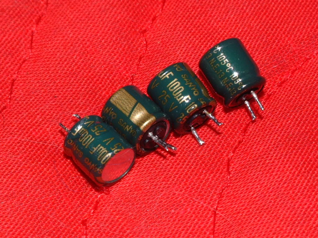

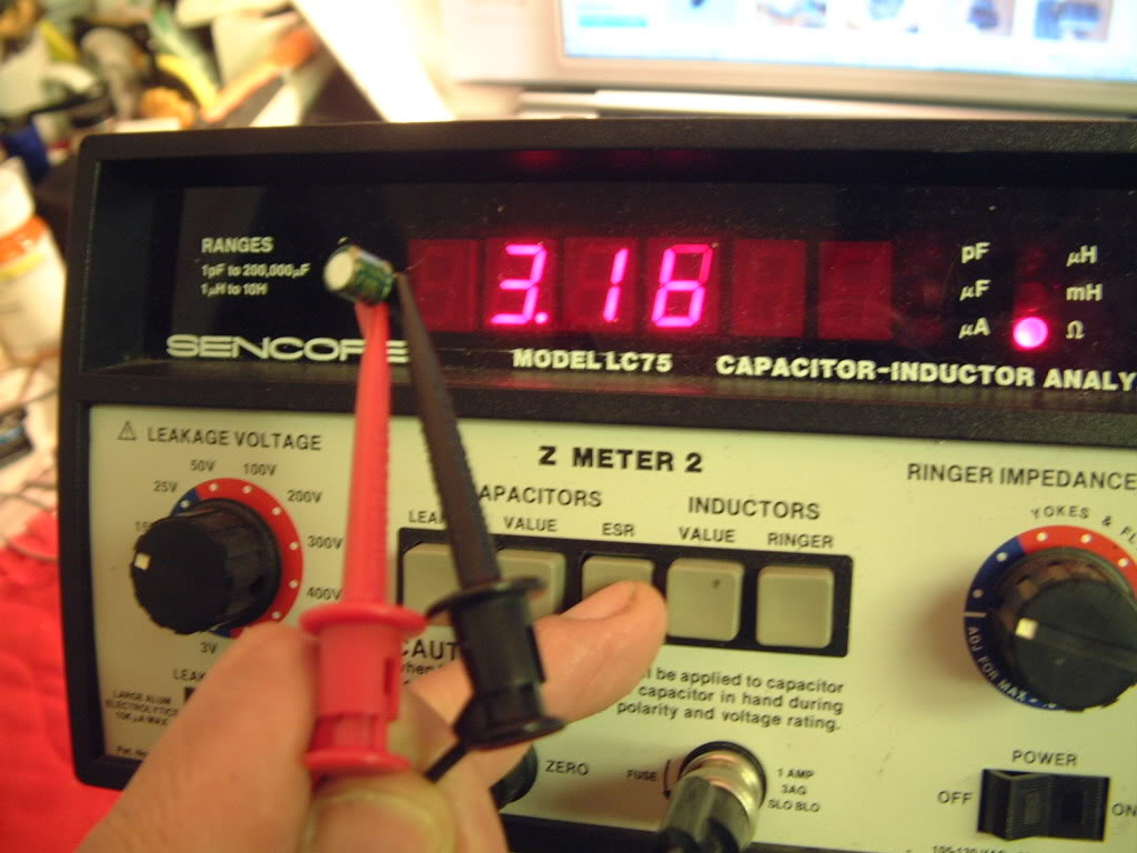

                Re: How to test bad capacitor with digital multimeter?
                Cap meter that can read the capacitance will not be good enough unless it can at least read the ESR.
                For example:
                this cap is rated at 100uf, the meter reads 96uF (within +/-20% for electrolytic caps), but the ESR is more than 3 Ohms. These bad caps were from GATEWAY monitor with no backlights problem.
                http://s807.photobucket.com/albums/y...t=DSCF0261.jpg
                http://s807.photobucket.com/albums/y...t=DSCF0262.jpg
                  For example:
                  Exactly. While basic tests from a multimeter are OK for some things, you MUST have an ESR meter to know the real condition. Most of the time it's the ESR that's gone bad.
                  They say that sometimes capacitance can fall drastically while ESR stays good, so having something that can measure capacitance is not a bad idea either, however this is apparently not common.
                  About the only thing a multimeter will tell you is if the capacitor is shorted. An ESR meter can't tell the difference between a dead short and a capacitor with really low ESR.
