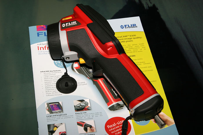

    Infra Red Thermography Digital Camera

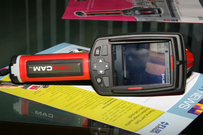

    Today i got a chance to play with another infra red thermography digital camera. I love this kind of technology. It actually would be great to have one of these for validating cooling solutions, overclocking and checking for failure or expected failure of components.
    Basically what it does is show you on the screen the temperatures of what the camera is seeing. It does this by identifying the temperatures in colour and provides a colour bar at the bottom of the screen so you can see what temperatures are what. Of course the bar will change based on the highest and lowest temperatures that are being measured at that moment.
    The cursor in the middle of the screen also does a fixed measurement and shows the temperature in text on the screen so you can take a precise measurement.
    It is also a digital camera so you can take shots and download by usb. Unfortunately this is the budget model (5000 euro) so it has storage for 50 pics at 240x240 pixels 72dpi. The more expensive models have better resolution and more storage. This one is more for on site troubleshooting rather than surveys and inspection.
    We dont really need to discuss the usage for cooling solutions, it is obvious how you could validate cooling solutions and better understand the cooling situation with one of these devices. Actually the suppliers of this product assist Greek computer magazine product reviewers by taking thermal photos of notebooks and other stuff to see how effective the cooling is.

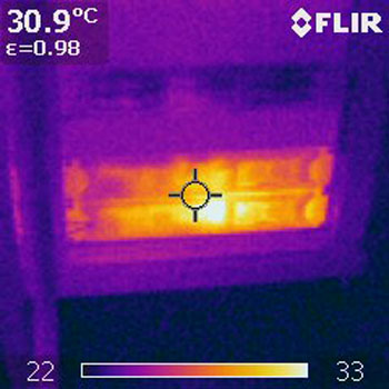

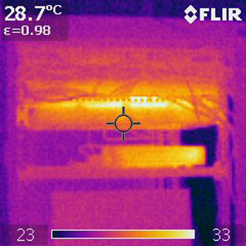

    if we start at the top we can see the cisco switch is quite hot, some areas are 33oC. Below you can see the kvm and in the middle of the pic the zyxel router.

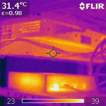

    here is the rear of those units. we can see a chip in the zyxel adsl router is at 39oC.

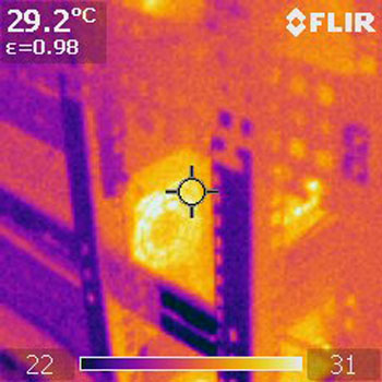

    This was something quite suprising to me, although it should have been obvious. At the bottom you can see the two apc 1000va ups units. They have a cutout in the case for a rear fan but alas those budget units do not include one. You can see the centre cursor taking a reading of 30.9oC and there is also seen components with 33oC temperature. Nothing really to worry about. However if you look above those units you can see the HP DL380 server with its incredibly noisy and powerful multiple fans is quite cool. In fact it is so cool i was suprised.

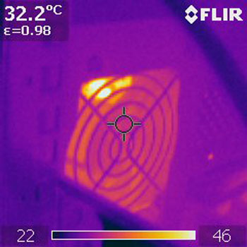

    and so on we go to take a look at the outlet fan of a psu from one of the 4u servers. When i showed the pics of the FSP460-60PFN
    which is in the mailserver, dood commented on how could it be possible to get good airflow through that packed unit.
    however i could see with the camera that the Macron Power MPT-350P 350W which is currently in the print server and shown below, is in fact a much hotter running unit than the fortron . I was suprised.

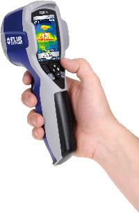

                                    FLIR has a new camera, the i5 which is gonna be about 2500 euro. Its a bit dumbed down though with image quality only 80x80 pixels which means its really for on the spot inspection not reporting.
