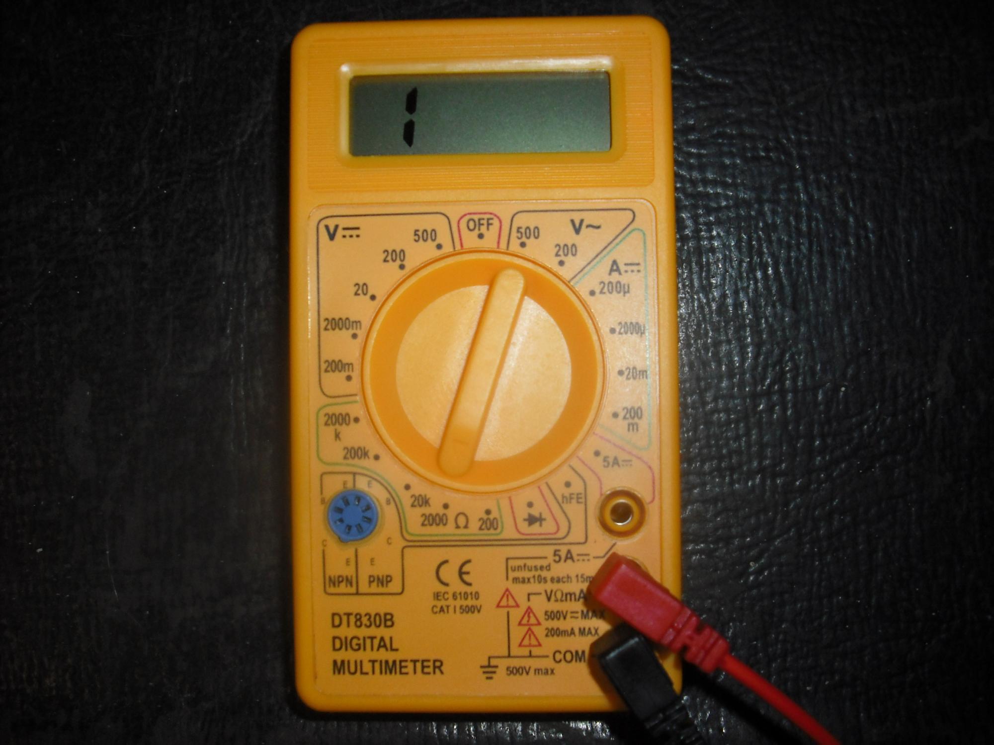

    I'm new to multimeters so this may be a stupid question: I have a new DT830B Multimeter and when I set it to the ohm function it just reads "1". No matter what i'm testing or what range I set it to, it's always at 1....even when not used. Am I doing something wrong or did I buy a bad unit? I do have the red lead in the VmA and black in COM and I tried touching the two leads together to zero it out but still just a "1".

    Re: Defective Multimeter?
    "1" means it is out of range or infinite. If it is on any ohm range, it should say "1" because your probes are not touching anything.
    Put your multimeter on 200 ohms setting. If you touch the two probes together you should get something like 0.2 ohms. If it reads "1", you probably have a defective multimeter. Check the internal fuse.
      Dose it work normaly on a voltage setting?A single flash light battery should read 1.5 volts.
      How about fuses are they good?
        Yes it works in voltage......i tested a AA battery and it read 1.6. I just got this in the mail yesterday so I don't see how it can be a bad fuse, unless it was just cheaply made.
          Maybe they forgot to put it in, wouldn’t hurt to check.

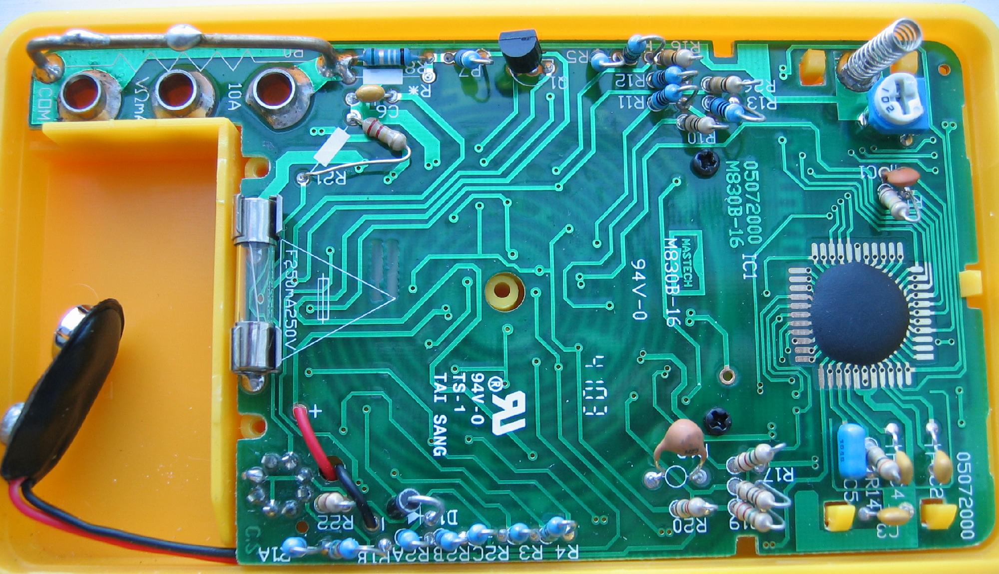

            Back in June 2010, I started down the multimeter path with a generic 830B knockoff. It was 99 cents off ebay. When I received the package, it wouldn't even turn on. More details at
            https://www.badcaps.net/forum/showthread.php?t=7557
            Here is a picture of the Mastech 830B unit I received yesterday. It won't even turn on. The fuse was blown (I replaced it) and it still won't turn on. So I'm trying to fix it as a learning exercise.
            I have sinced learned to stay away from the 830 knockoffs or anything that looks like it. The feedback on amazon.com for this Mastech is not great. Most complaints are that it fails shortly after being used a few times.

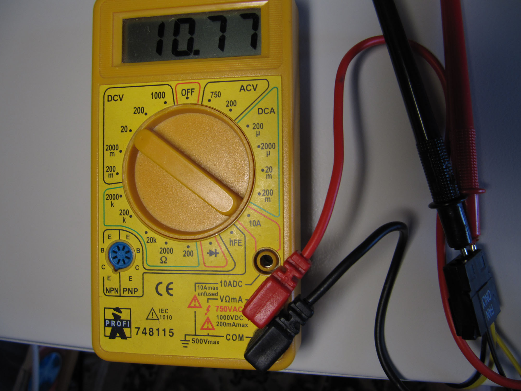

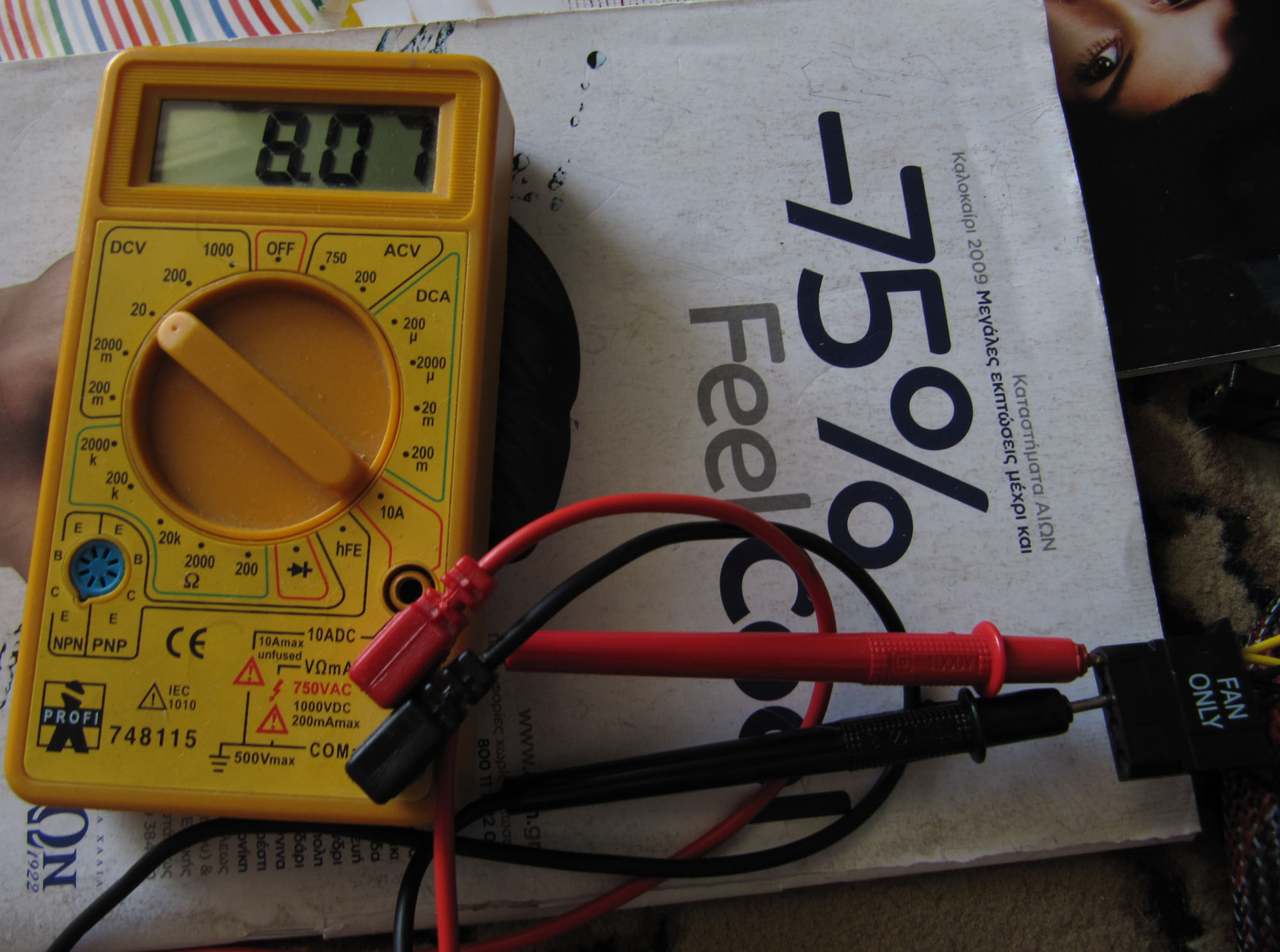

              Here is my multimeter. You say that it is bad??
                        I don't know what your reference voltage is from the fan to say if it is accurate or not.
