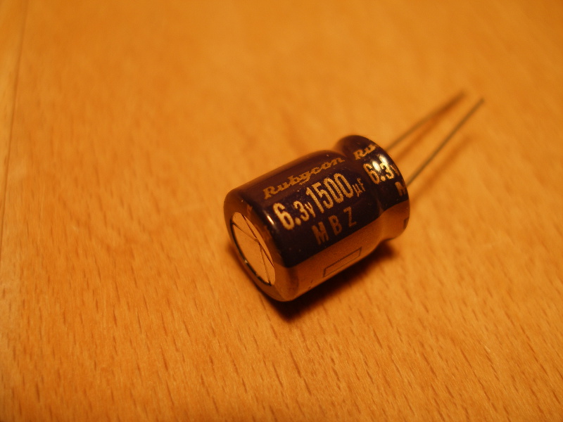

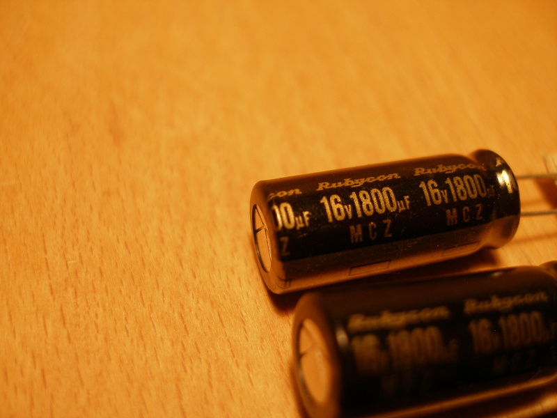

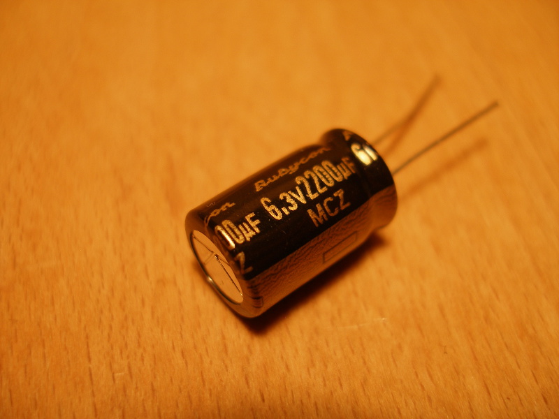

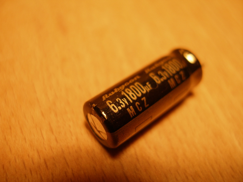

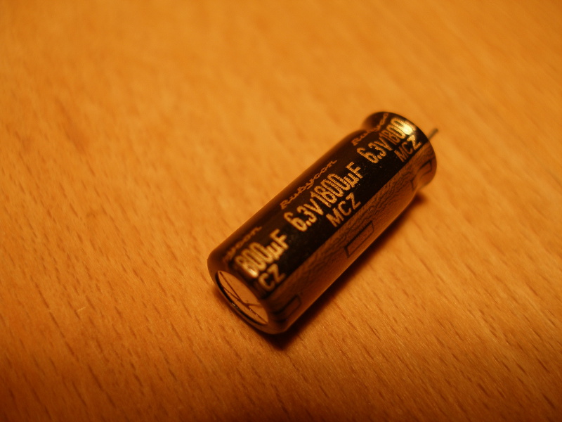

          those are the most obvious fakes i have seen!
          Originally posted by long_double
          It's me again. Here are the photos of the caps in question.
          Is there a FAQ on how to identify fake Rubycons?
          Does anybody know if MCZs can be grey (as on my photos) or they should always be gold-colored?
          I measured capacitance rating of these fake-MCZs and on most of them it is around 1480uF (nominal is 1800uF). But on some it is 2200 or sometimes 2400.

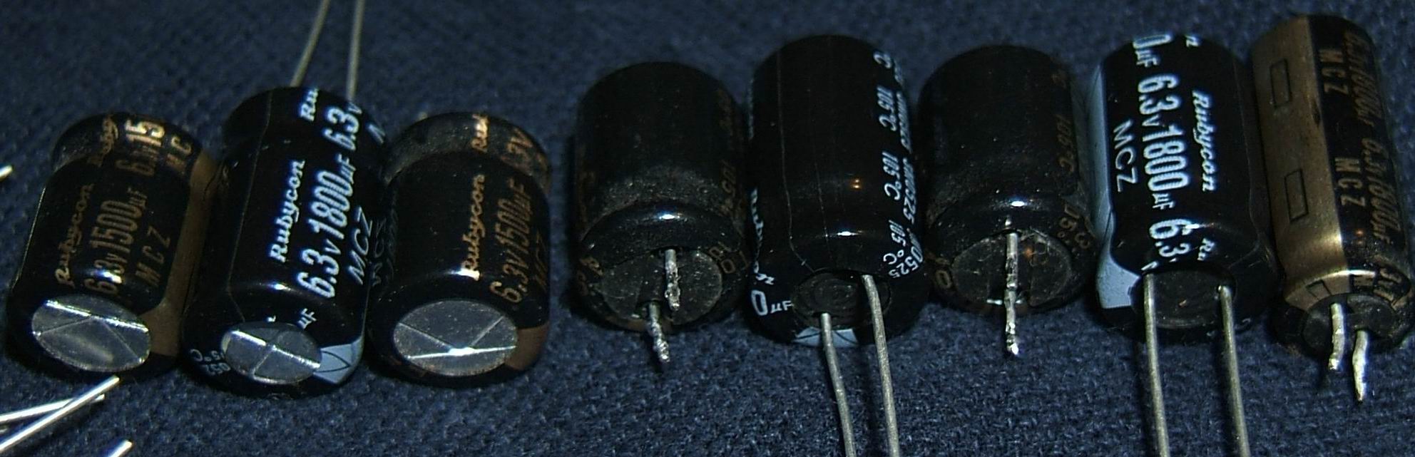

                        Well, I've received capacitors from http://myworld.ebay.com/audjade_chn here are the photos:
                        • ratdude747
                          Black Sheep
                          • Nov 2008
                          • 17136
                          #32
                          Re: How modern Rubycon MCZs look like?
                          possible fakes... pics pf the bungs (bottoms wit the leads sticking out? it seems that the amount of sleeving on the vents is a bit too much...

                              I have some Rubycon MCZ purchased as a Mac G5 kit from eBay that look counterfeit. White on black with a cross vent. Included are some real Rubycon MCZ Black/Gold for comparison. The counterfeits do not have the aluminum shine that the used real ones have. The fakes cost as much as real ones so someone is making good money.

                                would be nice to see the bungs too but we all know they are fakes already.
                                btw badcaps.net has that kit and the parts will be genuine!

                                  The bung picture was a bit too large the first time.

                                    The ones with the X vent definitely look fake! O_O

                                      i think we have seen those before.
                                      https://www.badcaps.net/forum/showthread.php?t=9890
                                      exact same fakes... same vent and fake text.
                                      i would not trust ANY of those caps, they all are suspect.
