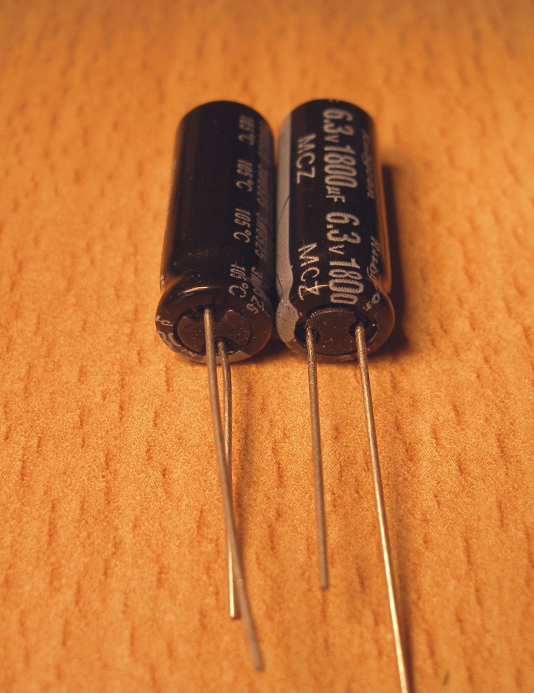

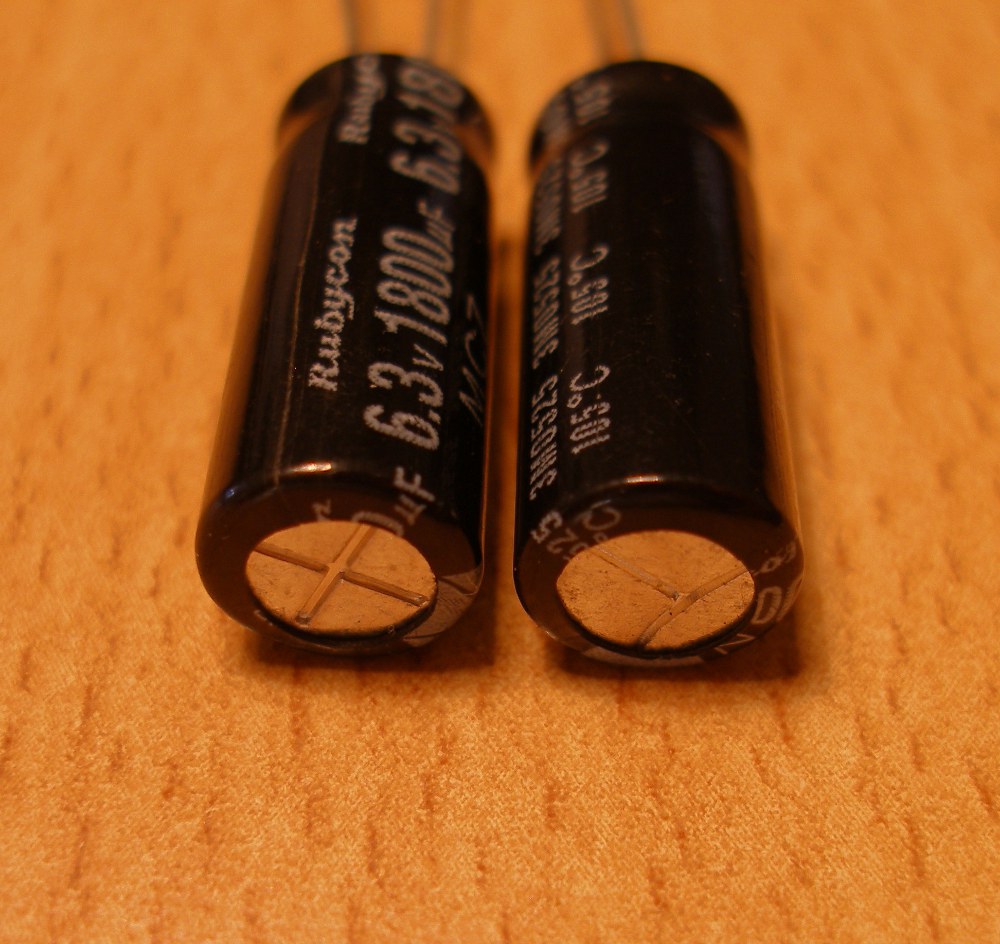

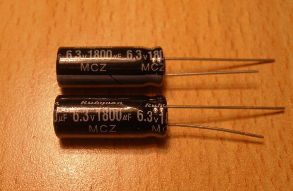

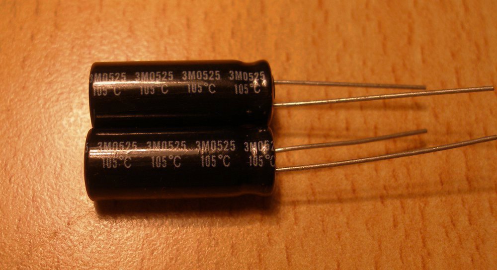

                It's me again. Here are the photos of the caps in question.
                Is there a FAQ on how to identify fake Rubycons?
                Does anybody know if MCZs can be grey (as on my photos) or they should always be gold-colored?
                I measured capacitance rating of these fake-MCZs and on most of them it is around 1480uF (nominal is 1800uF). But on some it is 2200 or sometimes 2400.
                • Wizard
                  • Mar 2008
                  • 2296
                  Re: How modern Rubycon MCZs look like?
                  All are fakes. Wrong look of printing (especially MCZ) and capacitance all over the map, cross and T scorings. The true Rubycon is K scoring and slightly bold printing with stylized script of "Rubycon".

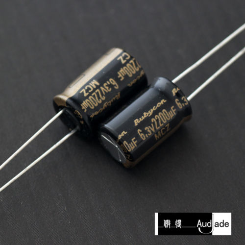

                      OK, here are more photos. They are taken from one auction on eBay. Is there fakes among them?
                      I personally doubt about 2200uF, because V in 6.3V is too big.
                      • Wizard
                        • Mar 2008
                        • 2296
                        Those are genuine caps in that photos. You have been taken or the seller was not looking very closely at his stock or knowingly selling fakes.
